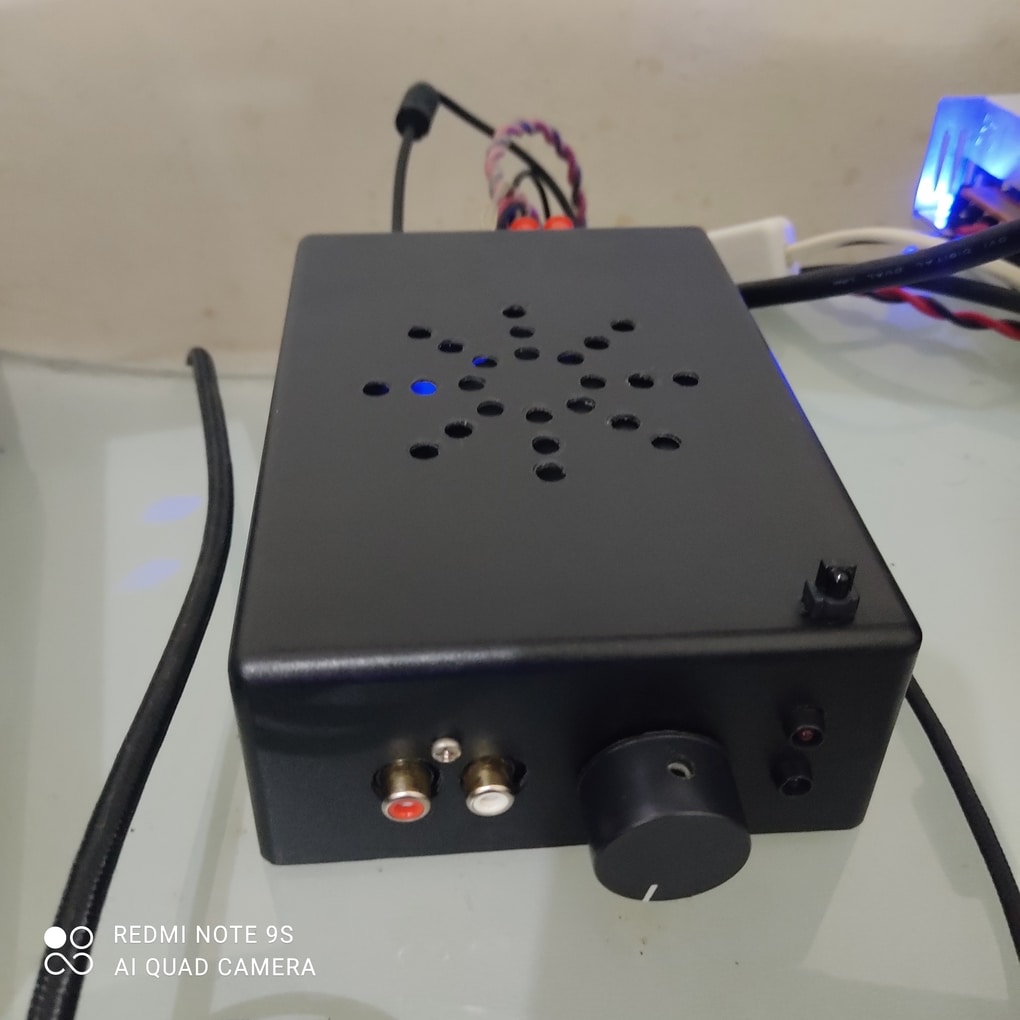

My first project is almost done here, are pictures welcome here? 😱

There you have some, and an extra.

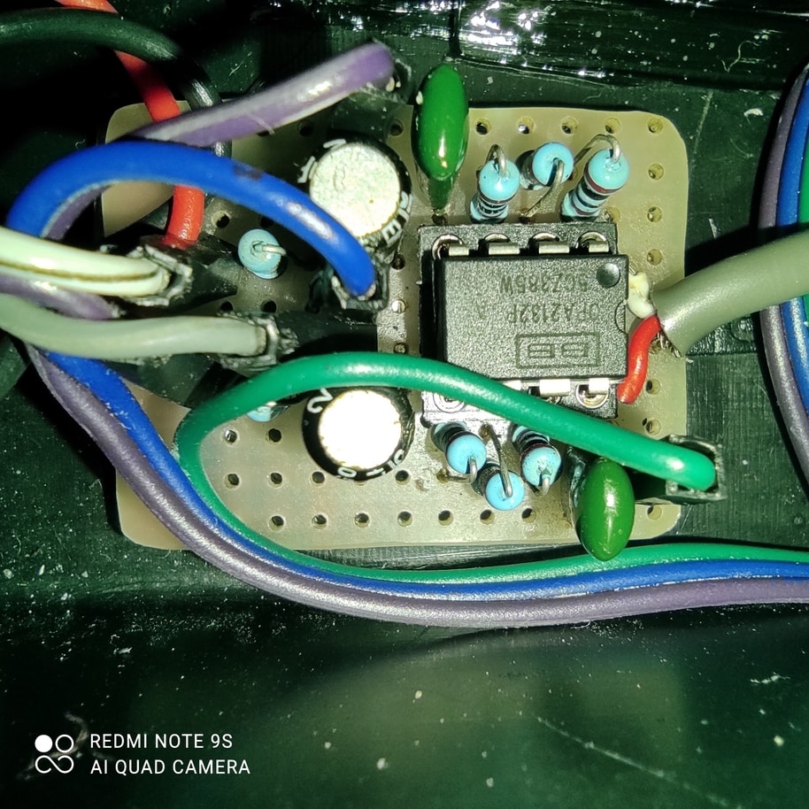

I was able to get my hands on a original OPA2132 and 2 TPA3116's, they're all in use in this one.
I think I will remove the pot from the board though and move it before the signal reaches the Pre-amp to avoid noise. The only noise I hear is when the pot is between mid point. Near low volume or maximum there's no noise at all (even placing my ear over the tweeter). Kinda impressive as I think my wiring is pretty cheap and simple.
To me it sounds amazing right now. I wish I had an scope to measure things right.
What would you look for in testing it with a Multimeter? 😛
Nice compact build! I believe it is better to buffer the signal first using an opamp and then have the volume pot between that and the amplifier input.
How do you power the opamp? Using a separate dual power supply?
I think the way things are it's pretty much like that regarding the pot? The signal comes in, goes through the pot before reaching the 1,5uF filter caps on that board, it's what it seems.

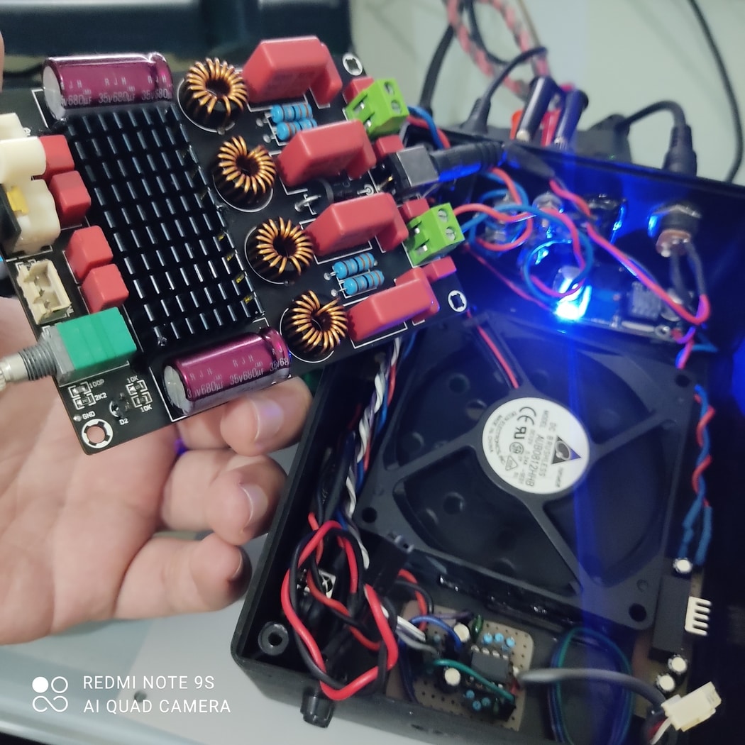

I am using one of those Converter/Isolators. You can see it on the second picture, it has a tiny heatsink on it's side (bottom corner on second pic).
It takes 24V and converts to simmetrical 12V (+-12). I think it works similarly to some voltage regulator setups, but provides only low current. More than enough for the OPAmp. I also have a 5V one for the bluetooth board.

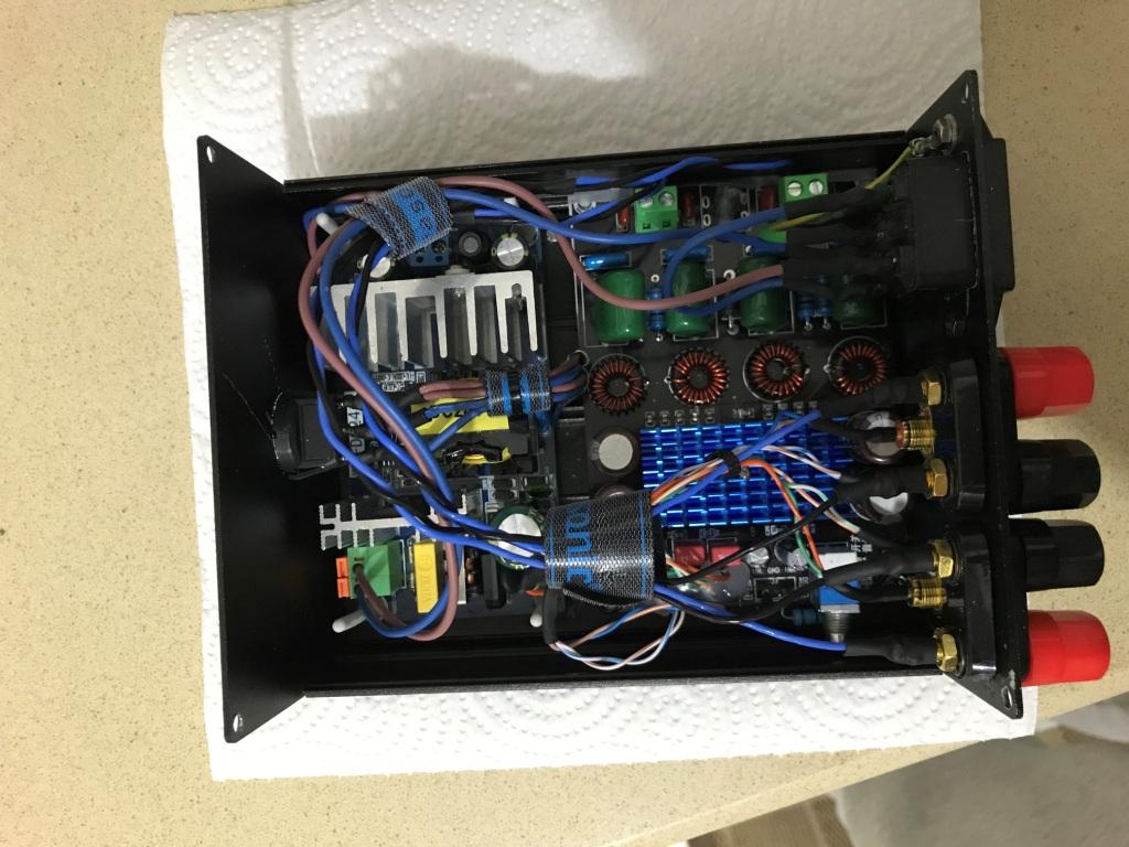

Be careful if you try to remove such a stereo-potentiometer with ON/OFF switch. My personal experience is that the potentiometer may survive but some of the PCB pads and tracks near the potentiometer may not. My solution is often to let the potentiometer stay and turn it fully up. That way it bothers nobody.
I use a multimeter (Ohm-meter setting) to check that the connections are correct before putting power on. It is easy to make a mistake and in particular wrong power connections can be fatal. Such a check lasts 10-15 minutes and can save you hours later on.

Never done the Ohm meter thing. I just have a thing about checking my wiring about 5 times over before plugging in.
When I do plug in, I use one of those voltage converters to limit both the voltage and current in case there's a massive fail, limiting the voltage to 9~12V before plugging into my 24V SMPS. It's just as much work I guess, but I haven't done a big fail yet. 😀
In my very limited experience, a couple of the potentiometer-equipped XH 3116D2 boards I've used (M577) do not supply ground to the cases of the potentiometers. I was able to solve all of my potentiometer noise issues by running a jumper from the audio ground at the input to a groundplane connecting all of the pots. Might be worth checking on your board.
Oh that was a good hint! I gave a look at my board and noticed there's a small "ground" point near my pot. I wrapped a wire around the pot's metal part and soldered it to that ground point.
It did help quite a bit, not entirely, but there's definitely less hiss and the volume seems quieter during change.

I'm glad to hear it helped. I suspect that the people designing the boards assume that integrators will panel mount via the pots to ground them... either that, or they just don't give a toss 😉

I didn't know these existed. This makes it so much easier to run an opamp from the same dc power supply.
The datasheet provides no schematic for typical application, but states that a capacitor on the input and output is needed, as well as a resistor parallel on the output to provide a minimum load.
It also states that for 'extremely low ripple' an LC network should be used on the input and output.
Did you use an LC filter? And if so, how are the values calculated?
I am a beginner in electronics, so I still have no idea on how to calculate those yet, sorry.
Those modules are great though. I found them looking for a way to isolate my bluetooth board (B series) and then found the simmetrical designs (A Series). Some big brands such as Wurth has some of the B type isolators/converters and they're completely external component free.
My setup is only using near the recommended capacitors. It asks for a 2.2uF in 12V and 1uF in 24, I just used the 2.2uF in both, had no issues so far, mine is also sending power directly into my OPA at turn on, so I think I don't need a load resistor, but I might be really wrong here, not sure.

Yeah, I believe my problem is that I am using a plastic housing. It was the cheaper method I found, to just buy a normal box and drill the holes I needed into it 😛
