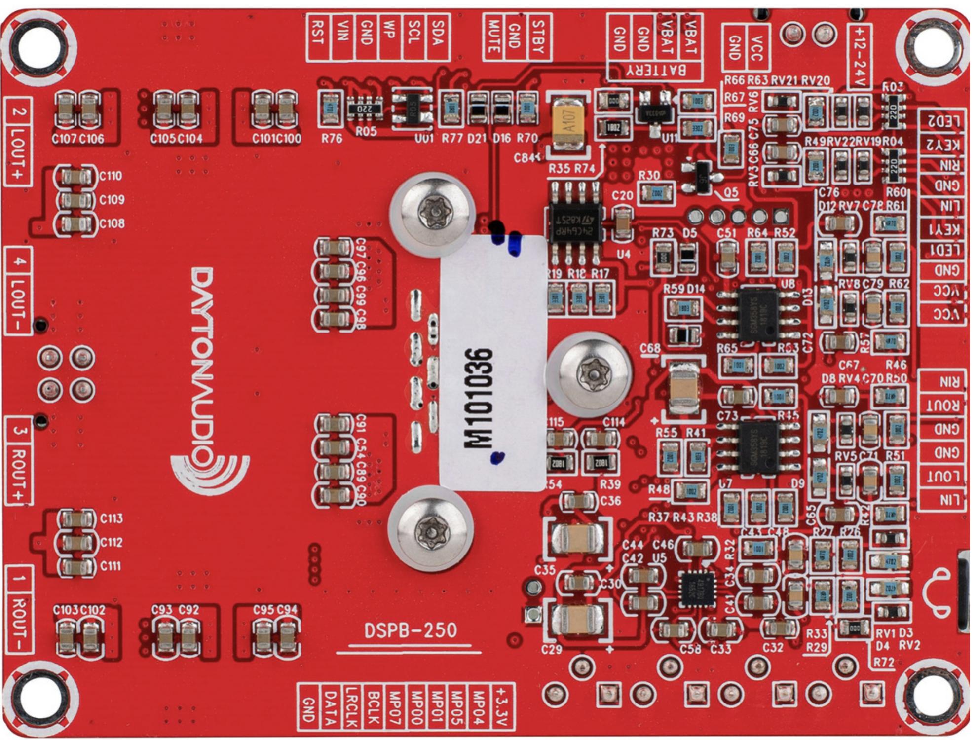

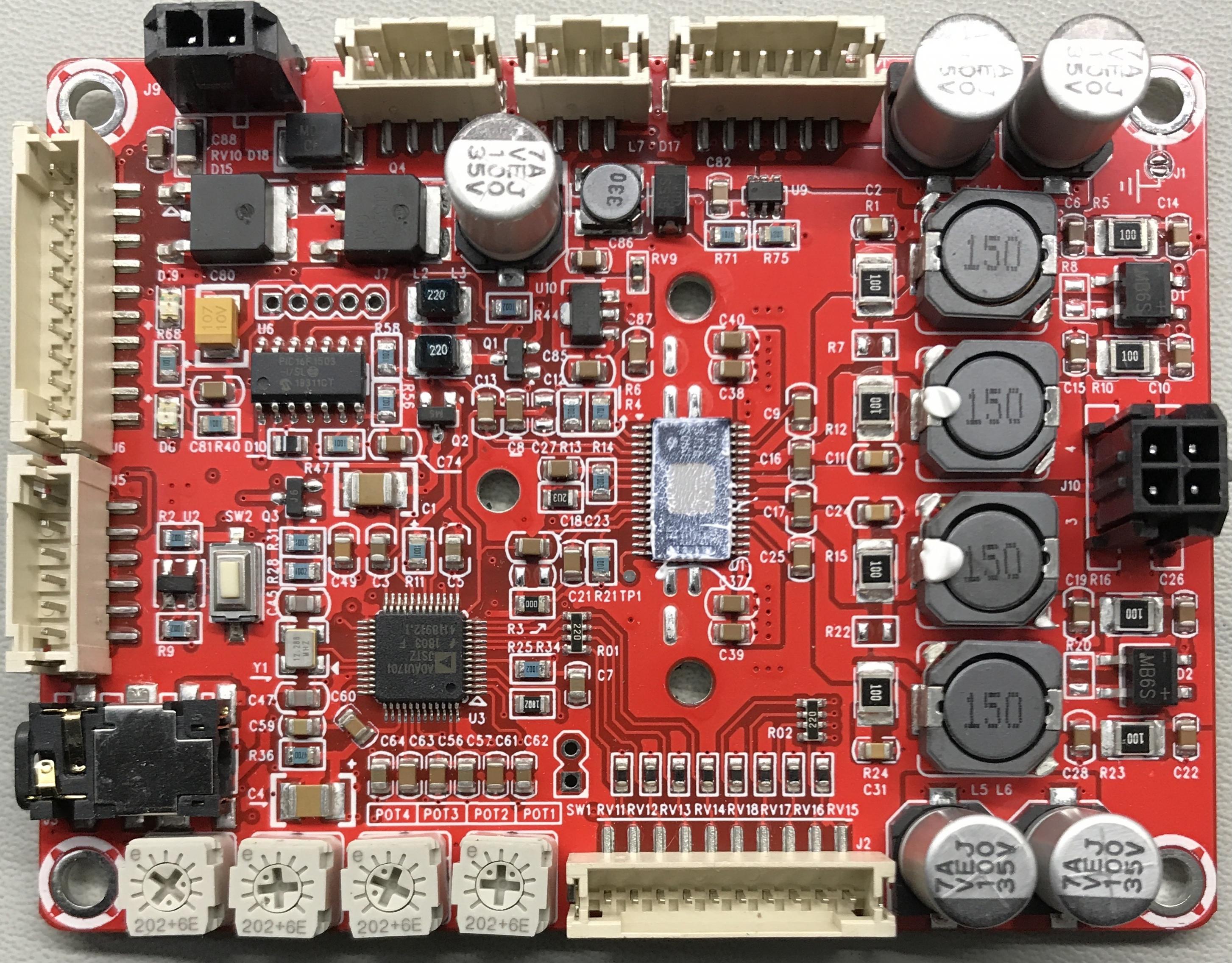

Hi TPA3116 gurus:
I’ve changed direction in my project slightly and decided to go down the avenue of the Dayton audio/wondom/sure dsp-enabled TPA3116 boards.
I finally had a set of mods that i liked on my last set of boards (random amazon vendor) and i’d like to move them over (wima input caps, correct bootstrap caps, etc).
The problem is, I don’t recognize the circuit well enough on these boards to find the input and output caps. I have no problem finding the bootstrap caps, but the output has a huge wide resistor where i would have expected the output cap. They are also doing some strange stuff with diodes in the output filtering as well. Alongside smaller inductors than i was expecting.
Do you guys have any experience with these boards?
I’ve attached the images of the boards. I’m happy to beep out any traces you need to figure it out.

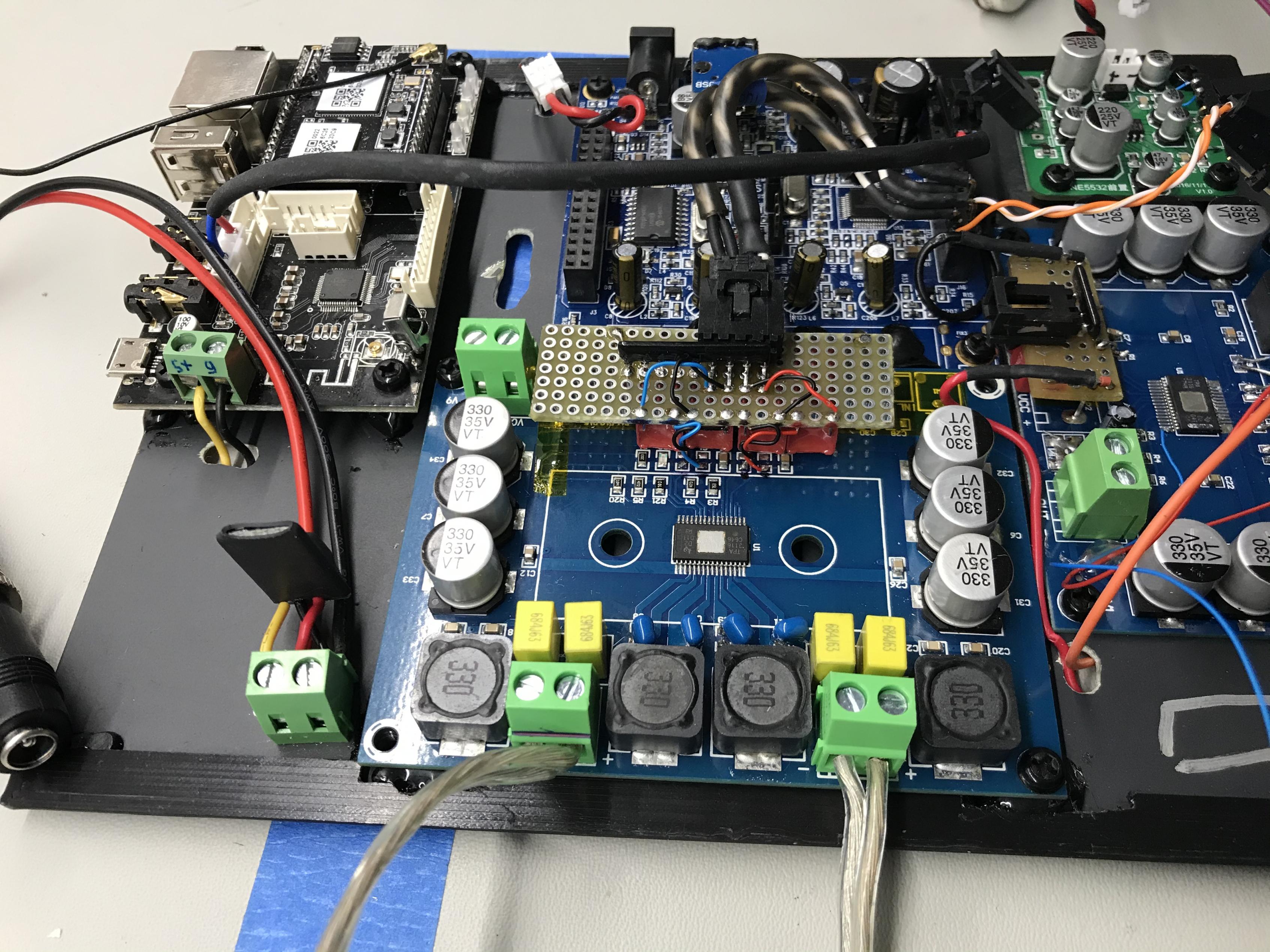

I also added the last known working configuration of the board i am trying to use as a reference (foreground in the center)

Those populated boards must be a nightmare to find stuff if you don't have a schematic for it. Maybe Dayton can provide you a schematic? Try contacting them, it could be a lot easier this way, or just ask what capacitors are the input ones, sometimes they might not share the schematic but could give you this info.
On that blue board you have, you could take a look at this link:
TPA3116D2 2 channel Amprefire Modification
This was done by CyberPit, but it describes a lot of modifications that board can receive. Although, if there was a single recommendation I can make, is to change those 33uH inductors, otherwise you'll have no detail in high frequencies. I can recommend these, that should fit that board well:

Thanks, I think you may have misunderstood. I have already modified the blue board, but I'm trying to move the mods to the red board. It appears to have a strange diode-based output filter on it that I do not recognize.
Hey, my apologies, it was more of a recommendation to improve the high frequency on them, I have a similar board.
On that Dayton board, when tracking back from pins 4,5,10 and 11 (inputs to 3116D2) the capacitors C13 and C8 seems to be the Right Input and C18/21 for the left side.
At least, those are the closest ones to the chip. If they're 1uF, theres a good chance they might be the input filters. Then again, that board is very complex and I might be wrong, could be worth checking those out.

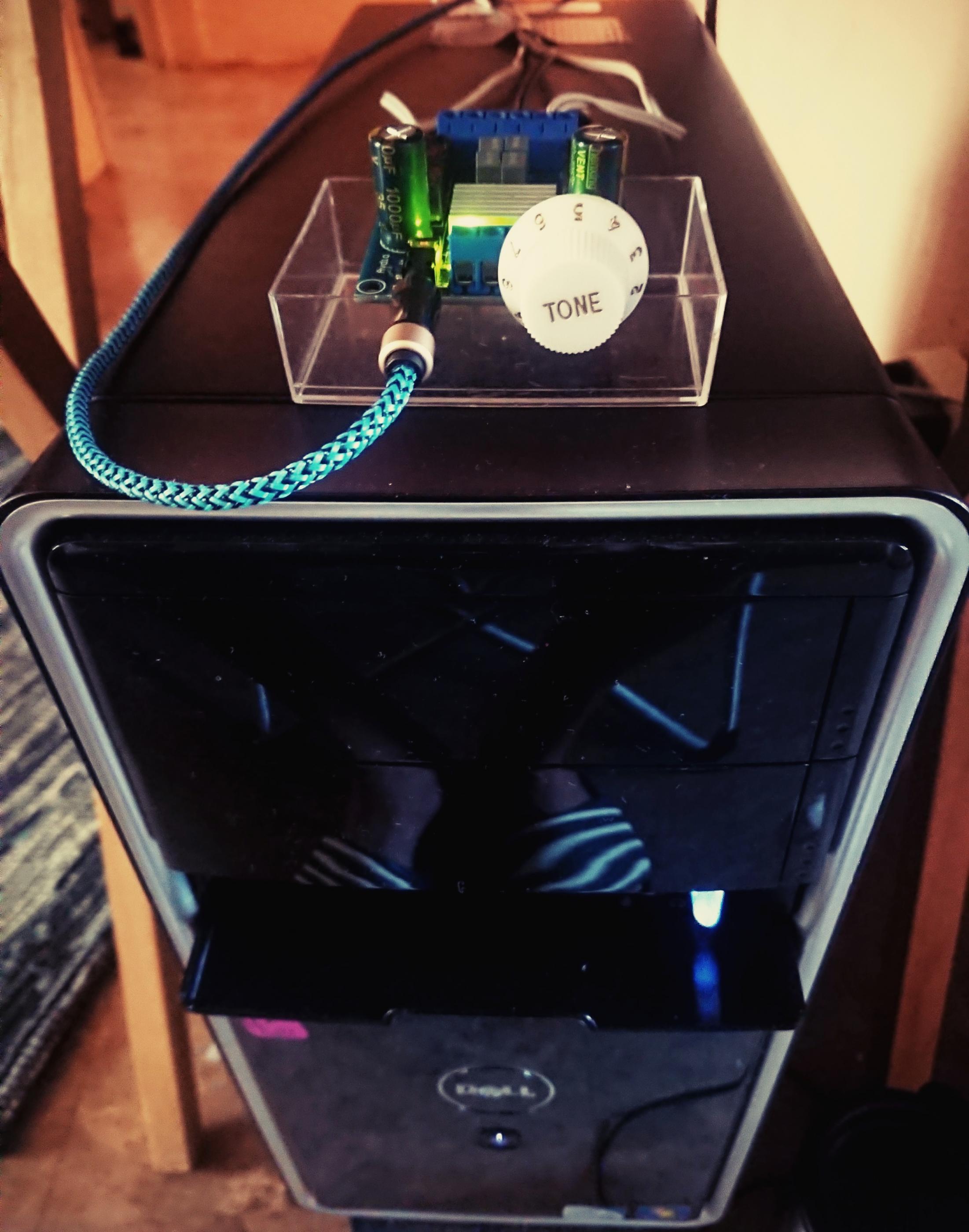

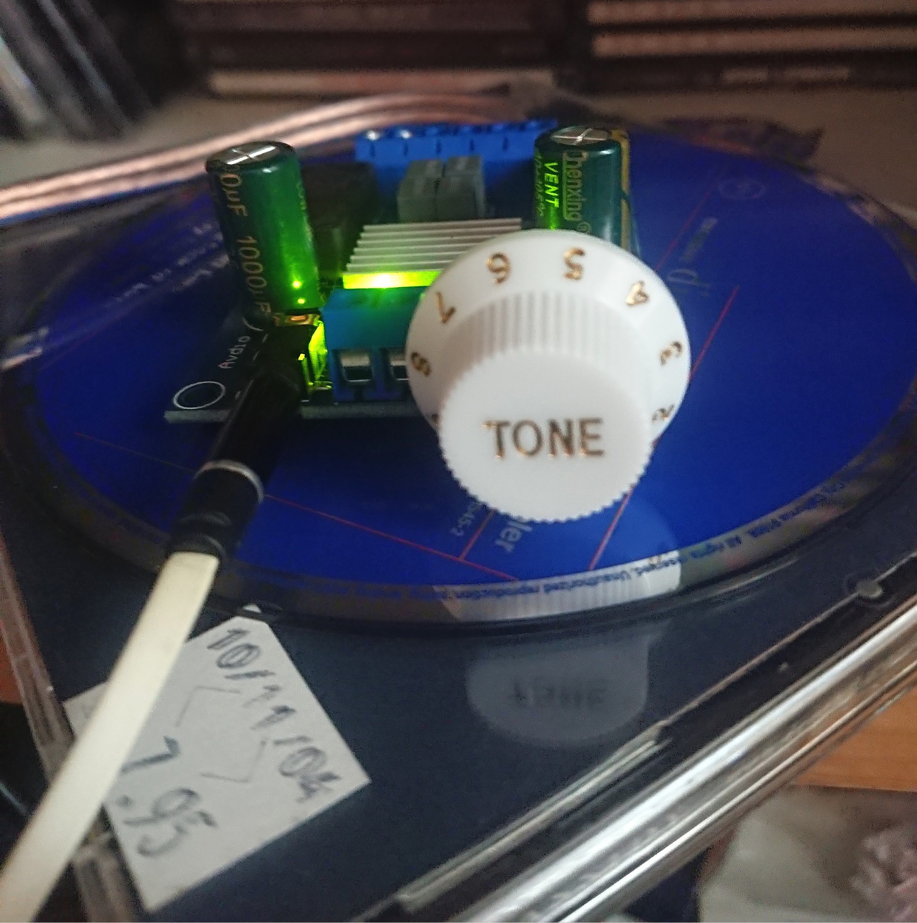

Got this 2 for 1 sale on amazon US for $13.49. Some pics. I just got it and sounds great at half volume. Only one speaker(not really great sounding more of surround speaker, but clear enough) hooked up for listening and used my player with Flac files. Used a 12volt cable I had laying around and spliced it. It can take 24v, so it can go louder! Used a guitar knob I had and looks neat. I'll make a DIY case later.
