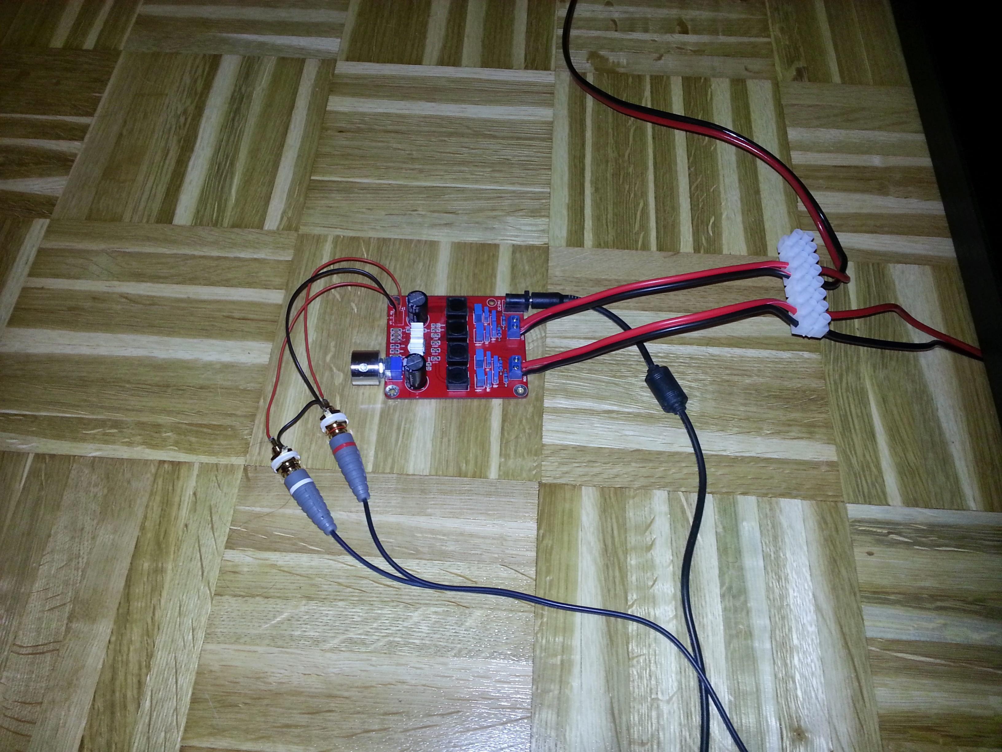

Wanted to put the board into a lego box earlier, but when I hooked it up to check if the signal connection is soldered okay, I just couldnt unhook it. Still listening to the thing😀
The topping tp20 was not only too weak for chr70's in a fh3 box, but the sound also lacked some "body". This is THE thing. I don't really see why, but I may try some stingy mods. Someday. If I manage to give it enough off time😛
Here's the photo I'm not proud of..😛
