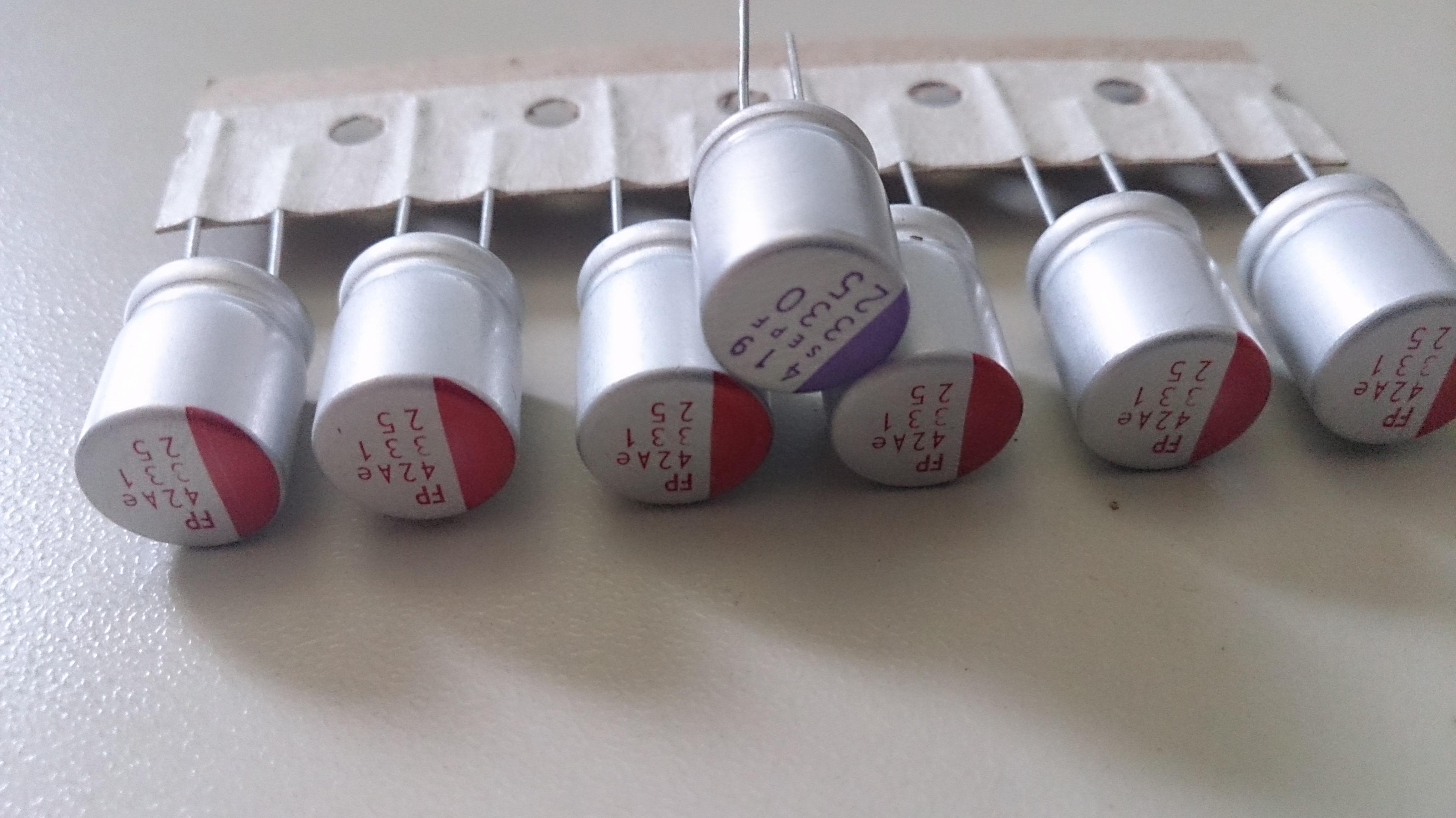

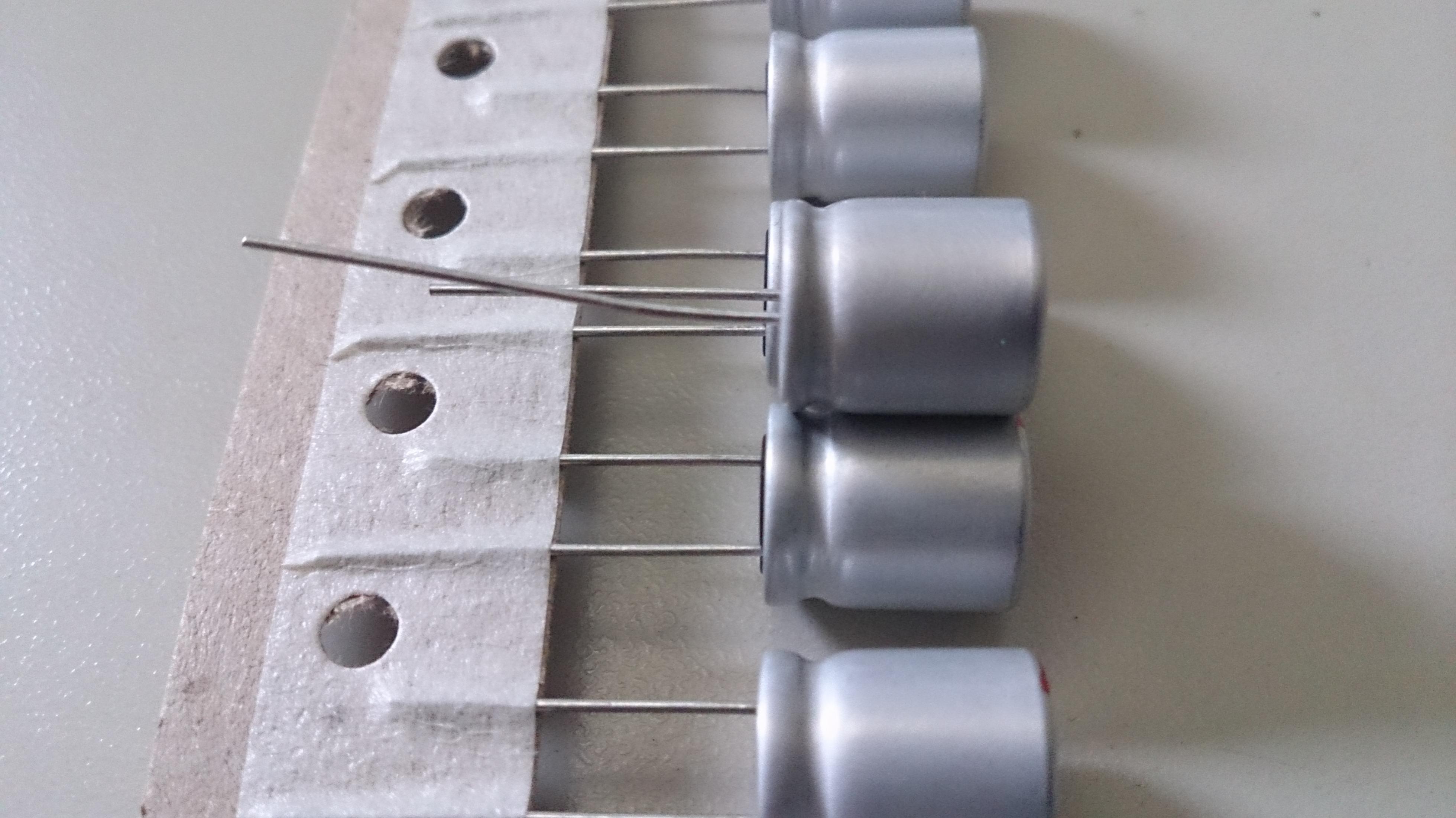

For those wanting to try the same value cap but a different mfg other than Panasonic, here is the Nichicon and Panasonic data sheets to compare.
The Panasonics are a few bucks cheaper. But one has to wonder, the specs are exact from what I can see, im thinking Panasonic might be private labeling this cap for Nichicon...
http://www.mouser.com/ds/2/293/2012fpcap_catalog_nu-5085.pdf
http://www.mouser.com/ds/2/315/SEPF_OS-262370.pdf
Datasheet tell you the Oscon is a little bigger, but in real life the Nichicon is a little bigger then the Oscon 🙂

Interesting, in the pic the Oscon looks fatter.
Let us know which one sound better, probably only a bat can tell the difference between the two 😛
Lenght is most visable size difference, diameter Oscon also is a little less, but closer or further from camera does have impact on photo 🙂 Oscons rest on metal can on PCB, on Sure3116 that is on + and - soldercontacts for SMD, so plastik can-wrap becomes isolator, possible trouble there.

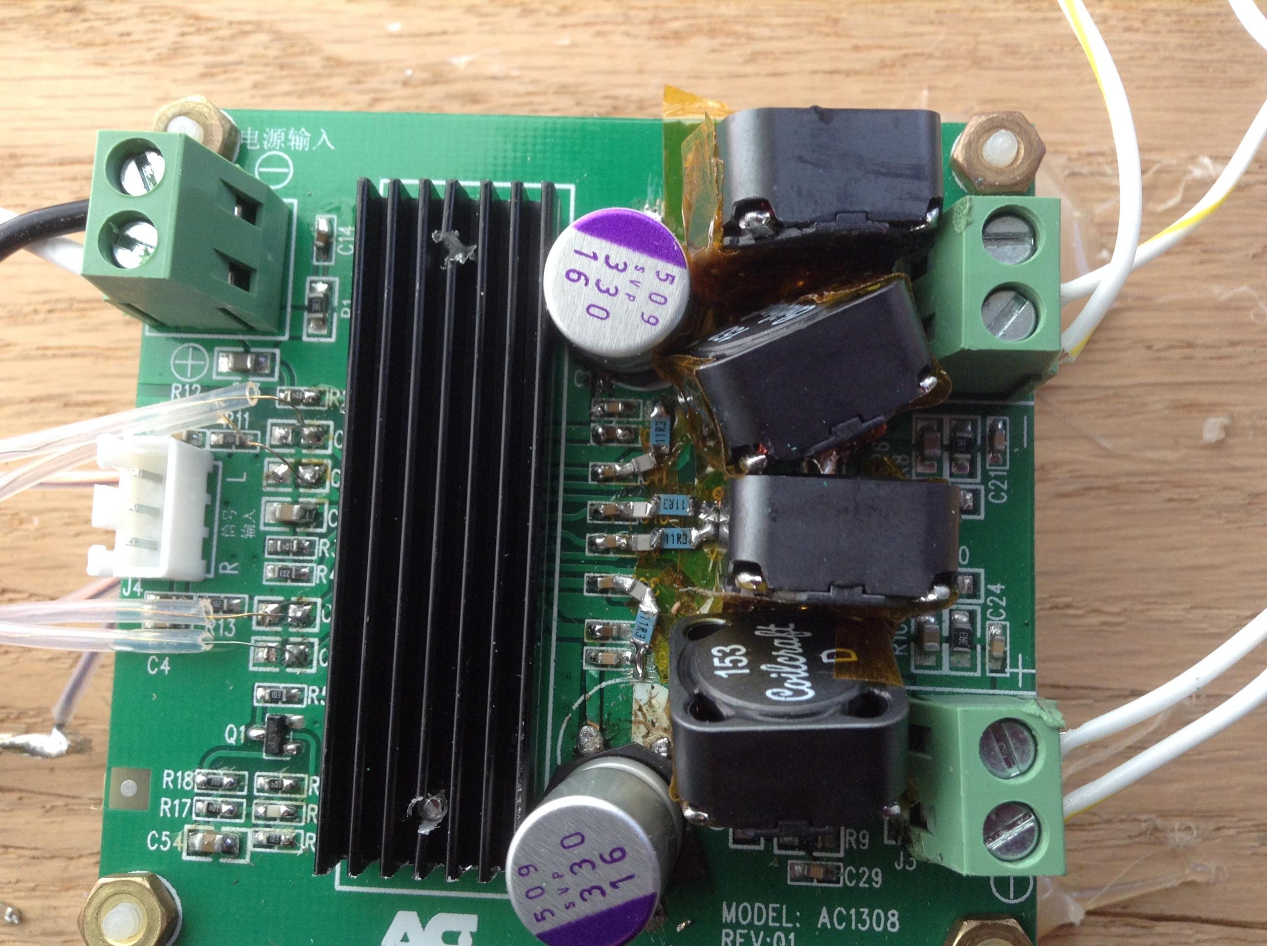

Matt - The cans are aluminum with a microscopic layer of plastic on them. i scraped off a small spot, and they are conductive. All 8 of mine were pressed tightly against the SMD pads on my TPA3110 Sure board. The thin layer of insulation bothered me more than I want to live with, so I melted the solder on each lead (16) just enough to lift the can off the pads slightly. I then dabbed hot glue on each pad under the cap. Problem solved 🙂
This may never present an issue, but everyone should be aware that the Panasonic Oscons could possibly pose a problem 🙁

Is that unique to the OSCONs though? I would assume (just guessing here) that most electrolytic caps are built this way?
Can you elaborate on what you mean?
Are you suggesting that the exterior can of the OSCON caps are conductive?
I just put my DMM probes on the can, at the highest resistance sensitivity. Though the OSCON cans look like metal, they are not conductive.
I also checked:
- Two probes on the can
- One probe on can, one on + cap lead
- One probe on can, one on - cap lead
In all cases, I get infinite resistance.
The can is conductive, like many electrolytic can, but like many can it has a plastic wrap/foil, like any datasheet mentions this is not for isolation.
It is crimped on by heat... warnings in datasheet/application notes say you should use isolation or leave room or mount them differently (indeed other side of pcb is an option).
