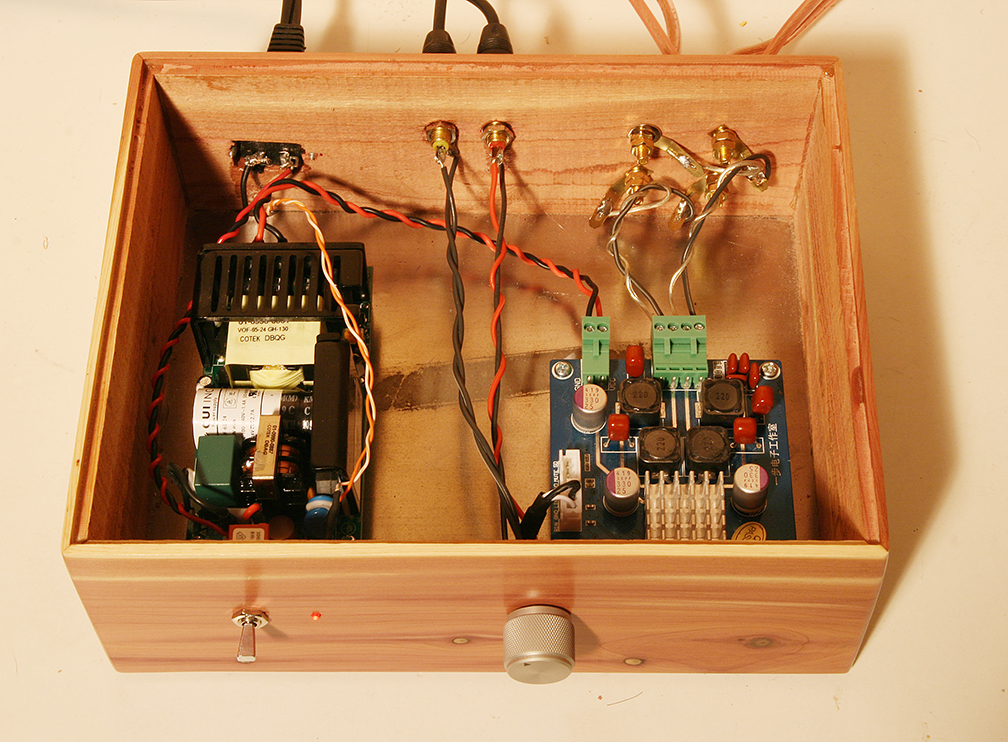

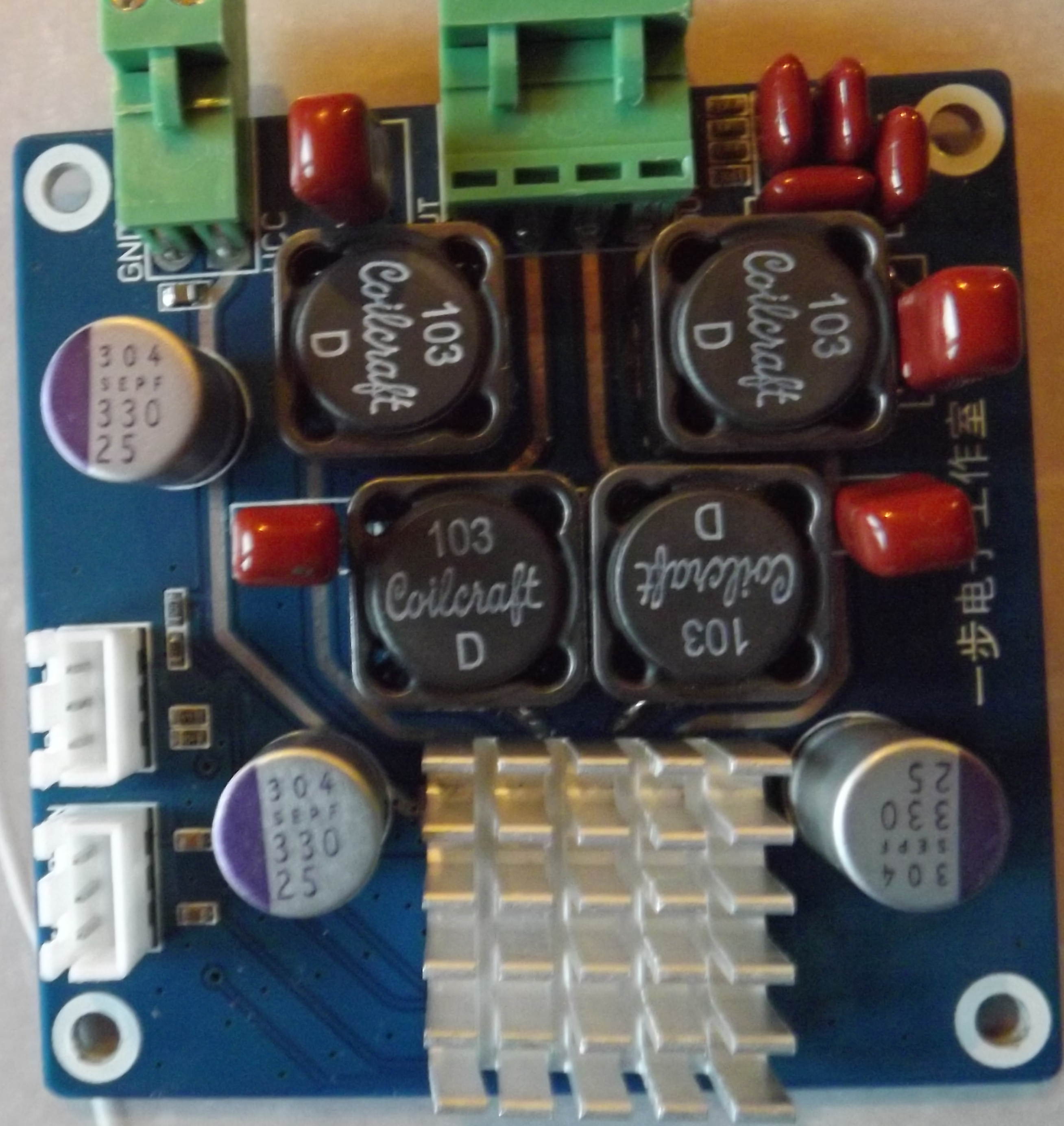

Here is my latest TPA3116. This one is the so called weiner. I'm not sure how best to ground it; any advice would be greatly appreciated. The only mods are the OSCON caps. Specs for the power supply from DigiKey are attached.
I have only played it with a pair of modified Harpoons from Wooden Design. All I can say is the amp sounds better than the YJ red board with the same speakers. I haven't tried any other comparisons so far. The overall sound is very pleasing but seems to lack the power of the YJ blue/black boards but that is probably due to the different power supplies.
I am having a great time building these little amps. Thanks to all you guys for all the help. 😀
I forgot to add- these boards are subject to the dreaded power up pop that seems to plague the 3116 amps 🙁

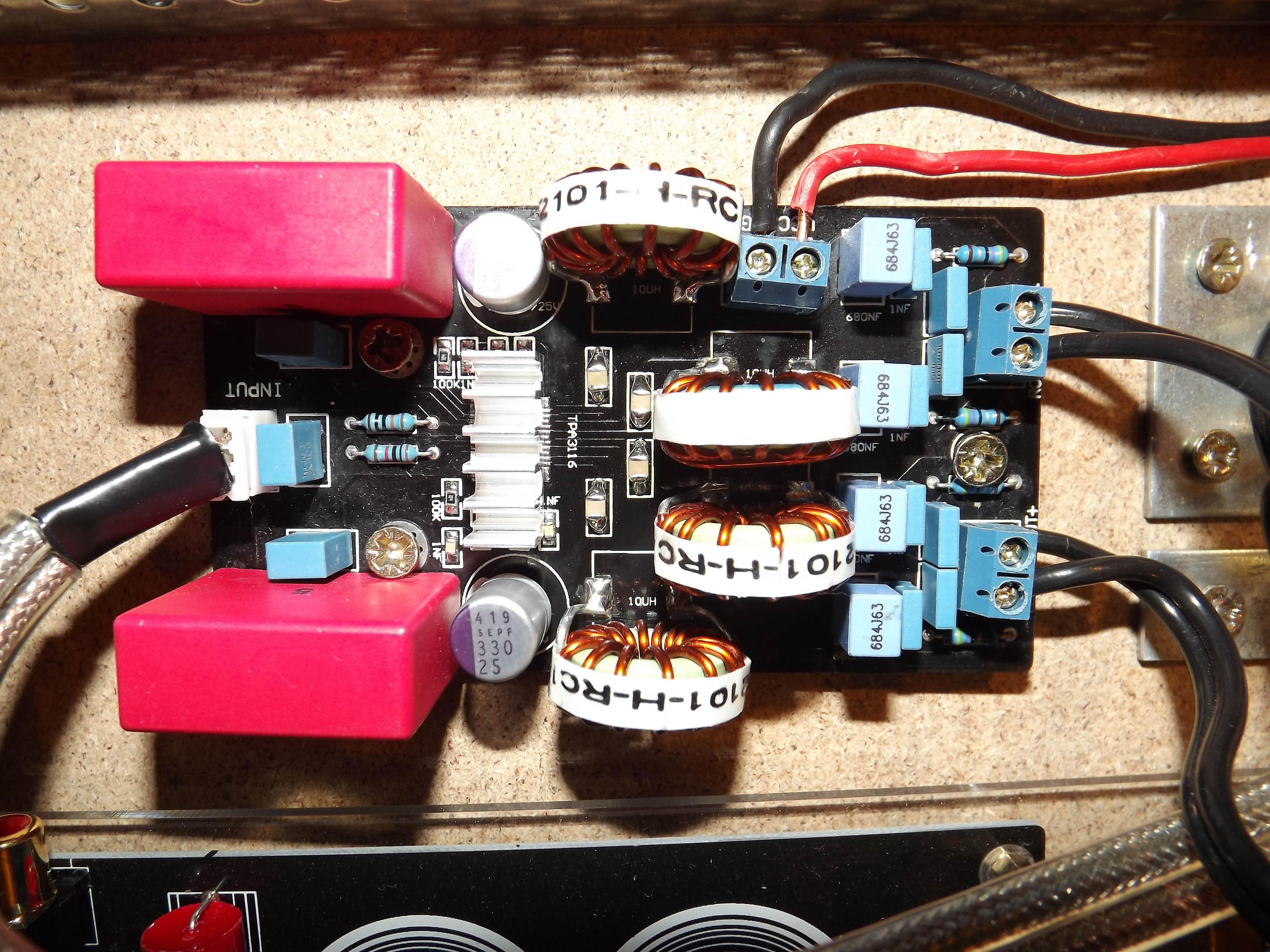

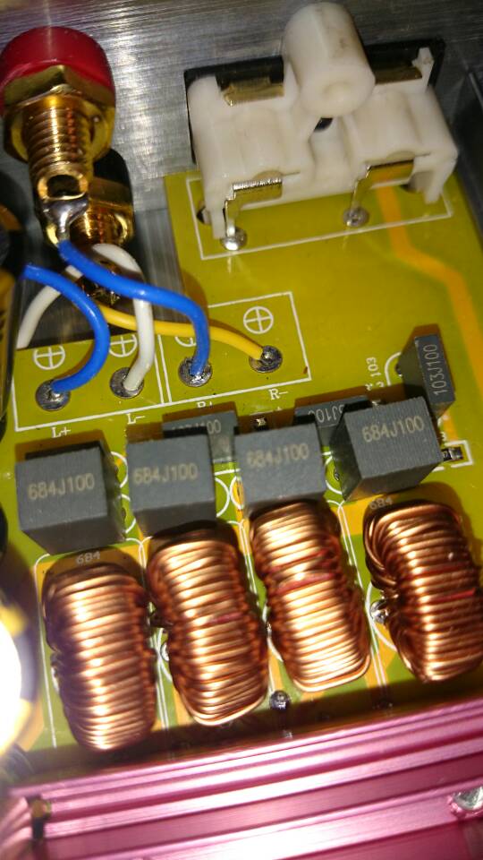

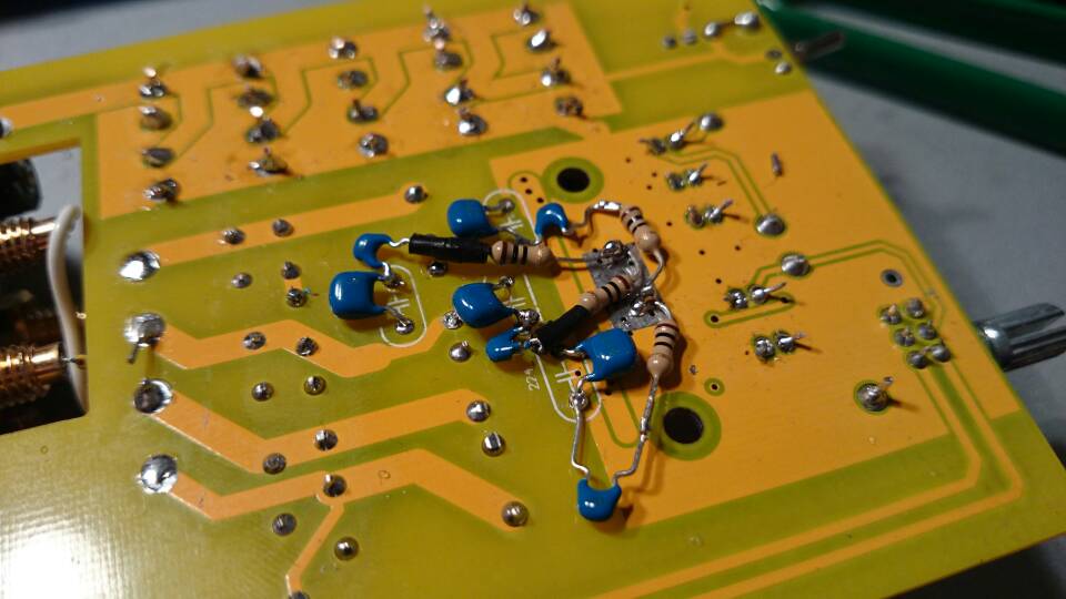

Did the bootstraps and snubber mod on the hifi 2.0 wlx board, I got a recent revision that uses these grey unknown branded film caps all over. See photo 1
Swapped the bootstrap caps for TDK X7R ceramic caps, and did the bootstrap mod below. Definitely tamed some of the harshness and the sound is a little 'sweeter' for lack of a better term.
I didn't have any panasonic FMs available so I went ahead with Nichicon FGs on the DC power caps. I know they are an audio cap but it was all I had (I had lots of them lying around actually)
Replaced the little input caps between the heatsink and the Wima caps with nichicon FGs. This helped a lot because prior to that the amp sounded a bit duller than I remember.
View attachment 442269View attachment 442271

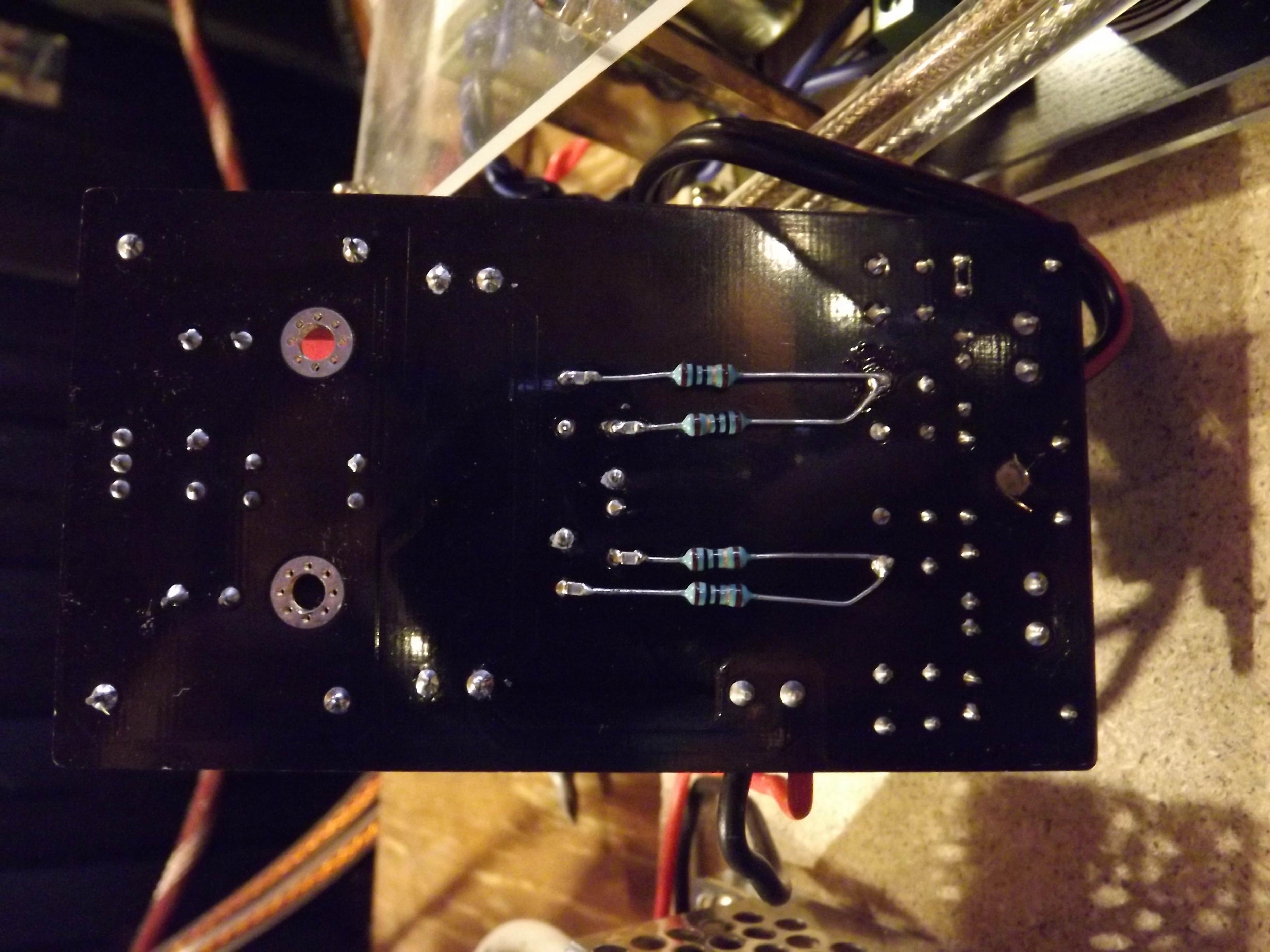

I used silver mica for the snubber cap since I got a few around and use input transformer and this board sounded very sweet.

2101-H-RC, 10 uH , 10.8 Amp, High Current Toroid Inductor, J.W.Miller Magnetics (Bourns)[/FONT]
The sound quality improvement is obvious especially after bootstrap snubber mod, OSCON and the Murata.
It is not final Am am thinking for some better Input Signal DC De-coupling Caps and Output Filter Capacitors. and maybe those big Coilcraft Inductors

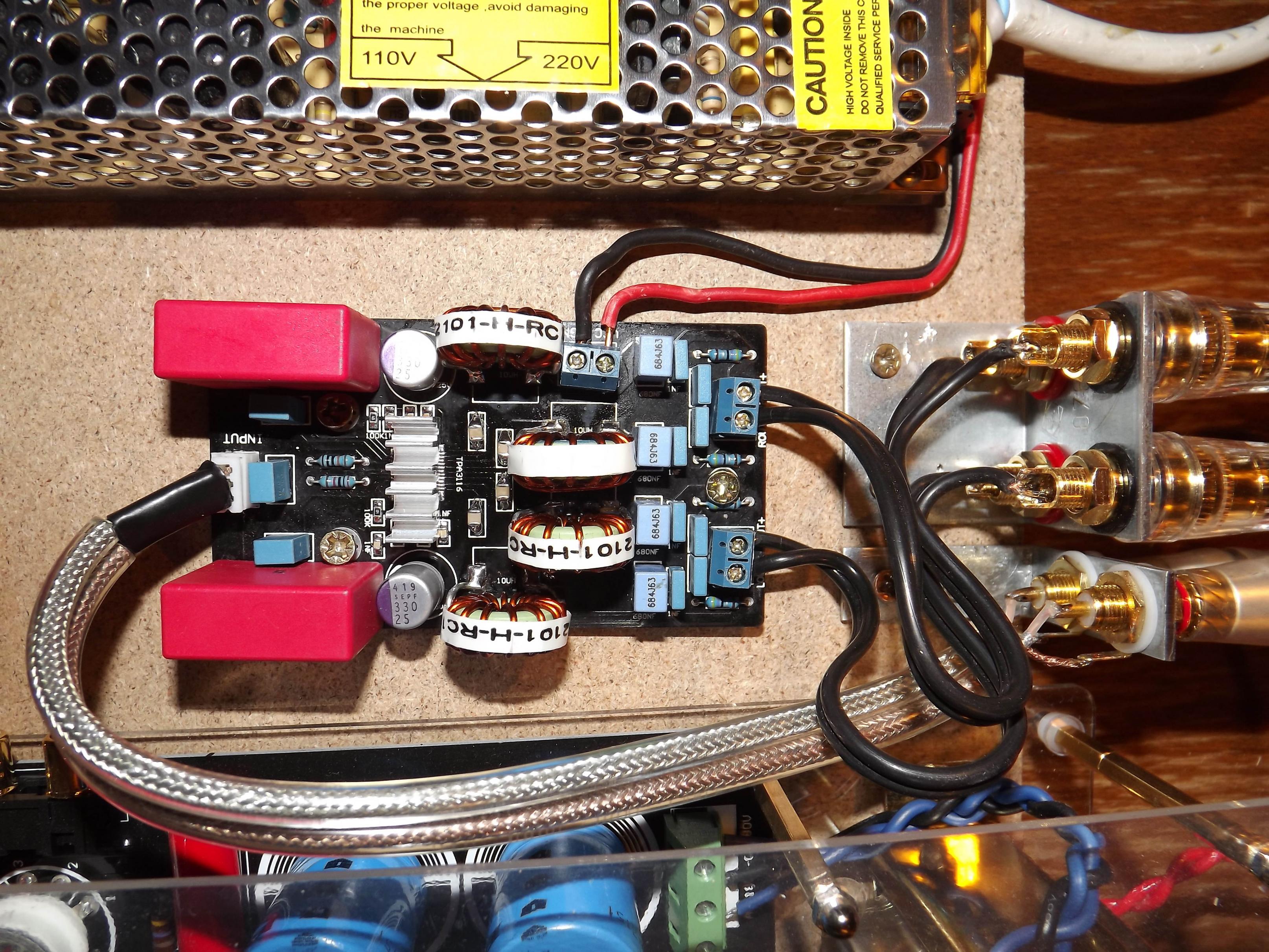

And the Danzz Board:
Panasonic Oscon 25SEPF330M
Murata GRM32ER71C226KE18L
Bourns Inductors
Bootstrap Snubber Mod
WIMA MKP10 1uF (1µF) 250V 5%
Murata GRM32ER71C226KE18L = 22uF ??? I am interested how it sounds but Texas Instruments warns that anything above 0.22uF will shorten chiplife
