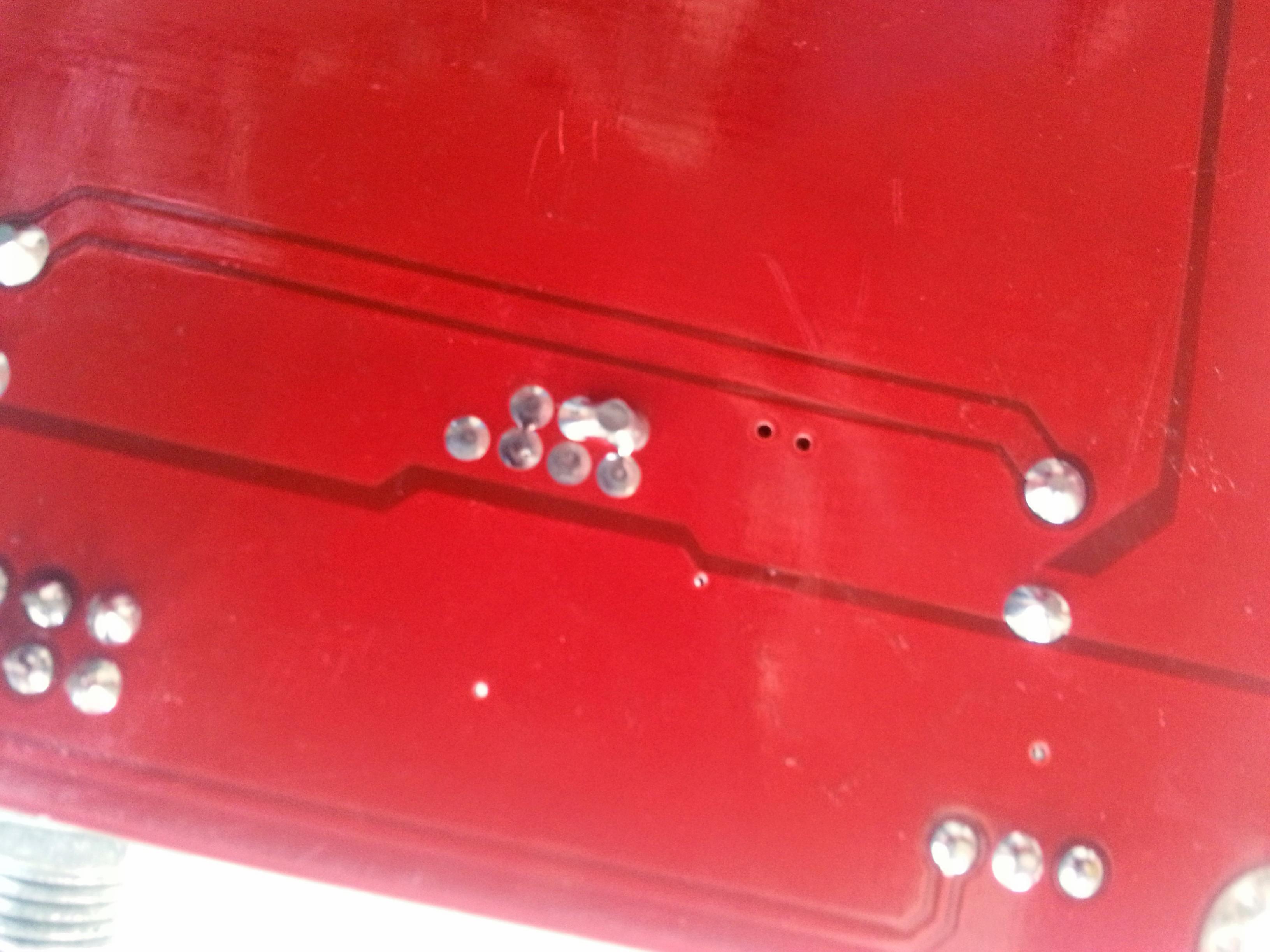

Just recieved my tpa3116 on the red board.
However, connections under the board look like this. (See attached photo)
Are they supposed to be like that, or do I better resolder in order not to burn anything?
Seems to be located under tpachip ?? Are just holes if under chip.
It is under the chip, yes. 3 connections "flooded" together with solder.
Are all in groundplane, don't know if they are open on YJred normally or filled, on other boards mostly just open vias, you could suck all solder out or leave it like it is.
"connections" that connect something already connected here, no connecting function

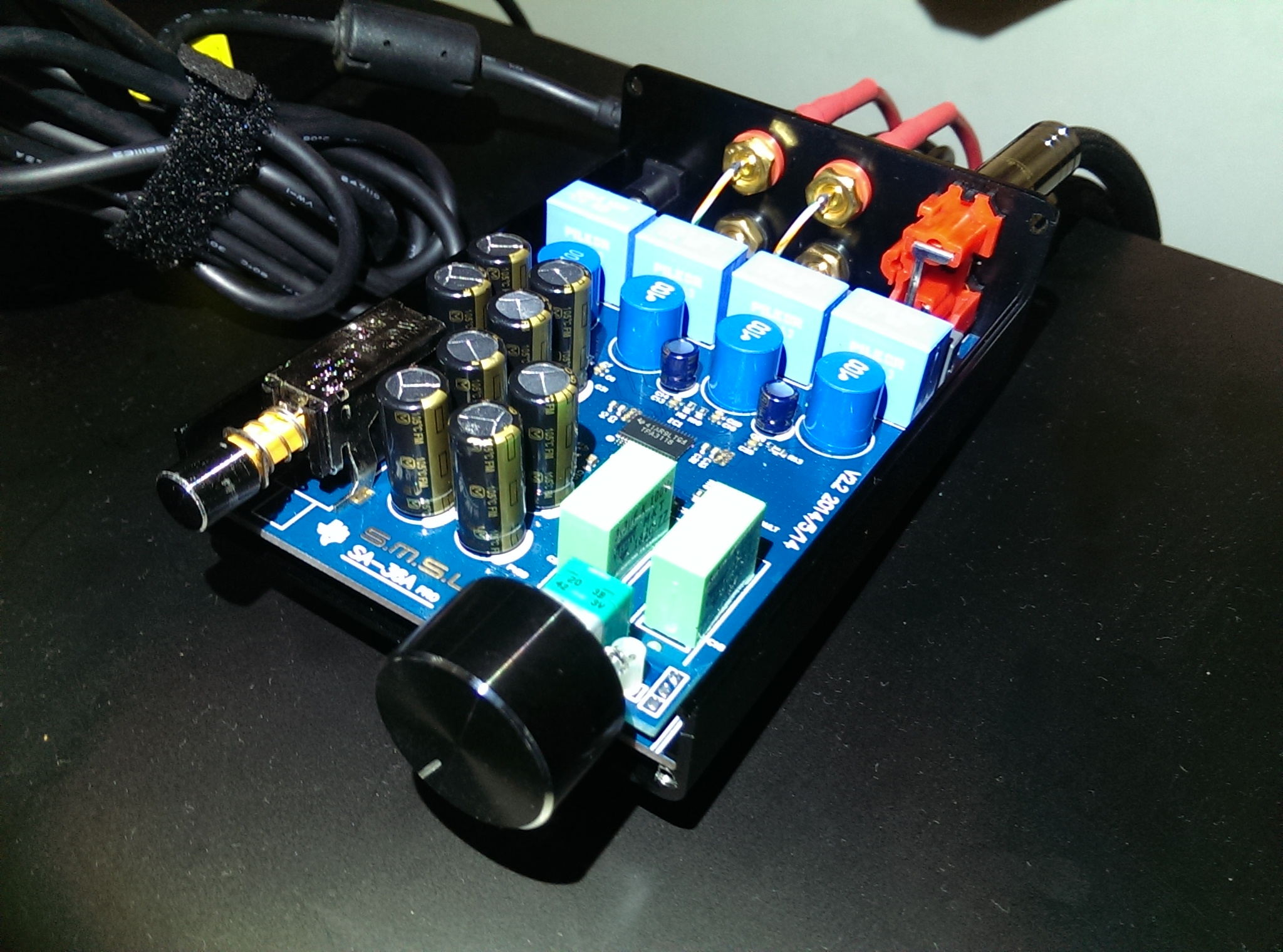

Hello, I have just received my SMSL 36a Pro after had been waiting for 40 days shipment from China to my country.
My board version is 2.2 with 3.3uF input Vishay MKT. Board looks fine except for the components that look fake.
I use laptop brick 19v 4.5a powering the amp. Completely stock it sounds ok, but the music is too slow for my liking. The singer voice is too backward, instruments sounds fine. But what impressed me is grand soundstage. There is no turn on pop, but there is a turn off pop.
After listening for about half day, I couldn't wait to change caps:
- unknown cap 47uF 35v changed to BG Hi-Q 47uF 6.3V.
- Panasonic M 470uF 25v to changed to Panasonic FM 680uF 25v
Now the amp so far sounds so much clearer, cleaner, better separation, faster music than stock but not too fast, sweeter sounding and more forward singer's voice. Low is well controlled, mid is improved and high very clear. I'll post some more after around 100 hours of playing and doing some more upgrade (sigma11 linear regulated psu on the way, changing input caps and a new casing).
Couldn't believe this class-d amp sounds so good 😀

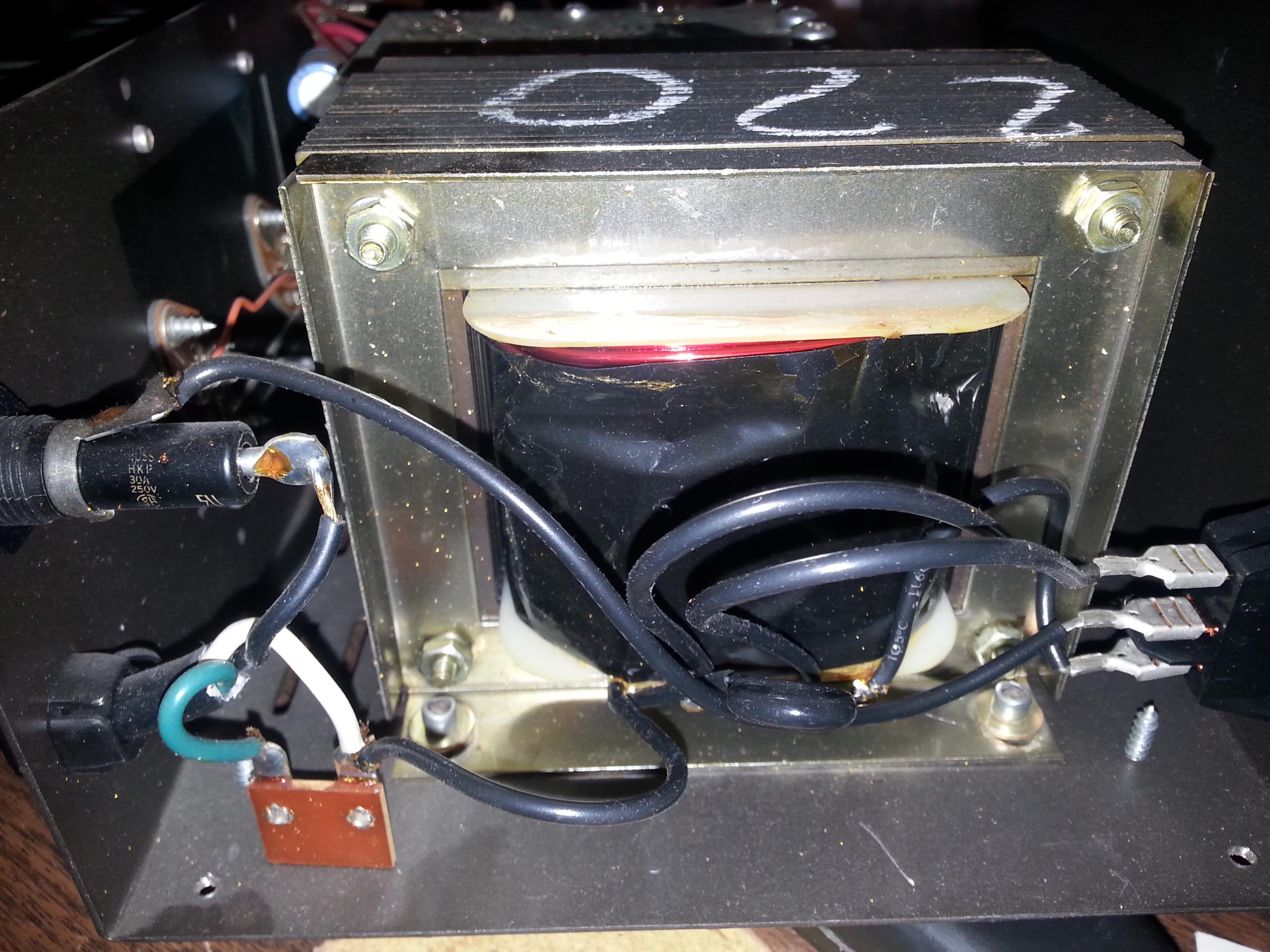

For those of you wanting to drive the TPA 3116 with the Astron RS 12. If you run across like I did the 220v version for $5 bucks. These are less desirable, for the simple fact its 220v input. But here is the secret, its the same transformer, same caps etc as the 120v version. Just take the 4 wires off the transformer and move them. 1 to 3 and 2 to 4. And youll have 120v. Cheers

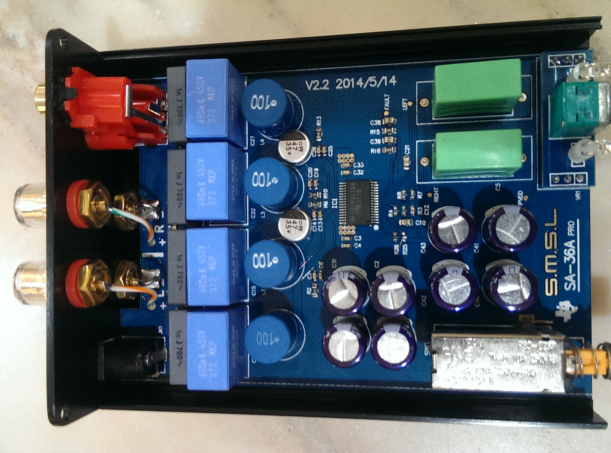

How long till BG Hi-Q 47uF 6.3V will explode with 19V DC applied???
