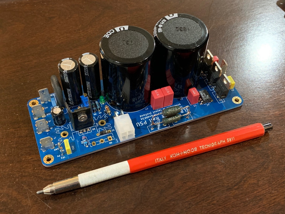

Please note that these are v1.2 boards and no longer accept the 90 deg Molex Minifit plugs. They are the vertical ones now. This was to make the board lower profile.
The PCB 4-pin connector jack is actually made by Wurth (part no. 64900421122), compatible with Molex Minifit. 2x2 pins:
64900421122 Wurth Elektronik | Mouser
Please note that these are Gen 2 boards and no longer accept the 90 deg Molex Minifit plugs. They are the vertical ones now. This was to make the board lower profile.
Just like to assure people that the vertical Molex sockets work fine on Gen 1 boards. 🙂
That's what I used, as I am mounting my SLB boards vertically - so couldn't have the wires coming off sideways to the boards.

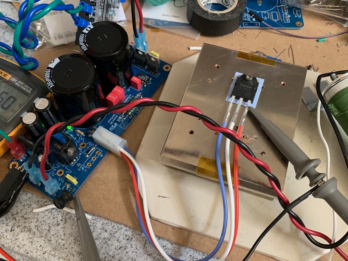

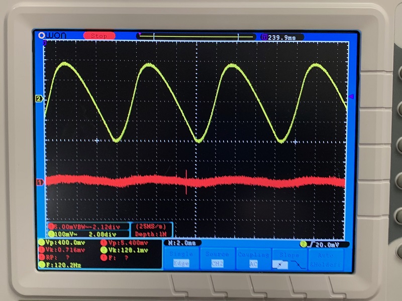

I don't think I ever posted this, but a while back, I tested out the SLB single rail at 30v and 3.75A using a big 8ohm wirewound dummy load. It showed excellent performance with sub 1mV rms ripple. This is perfect for a single rail Class A amp like the MOFO.
SLB SR fully assembled:
Test setup:
Measured ripple upstream of the ripple eating BJT and after it:
