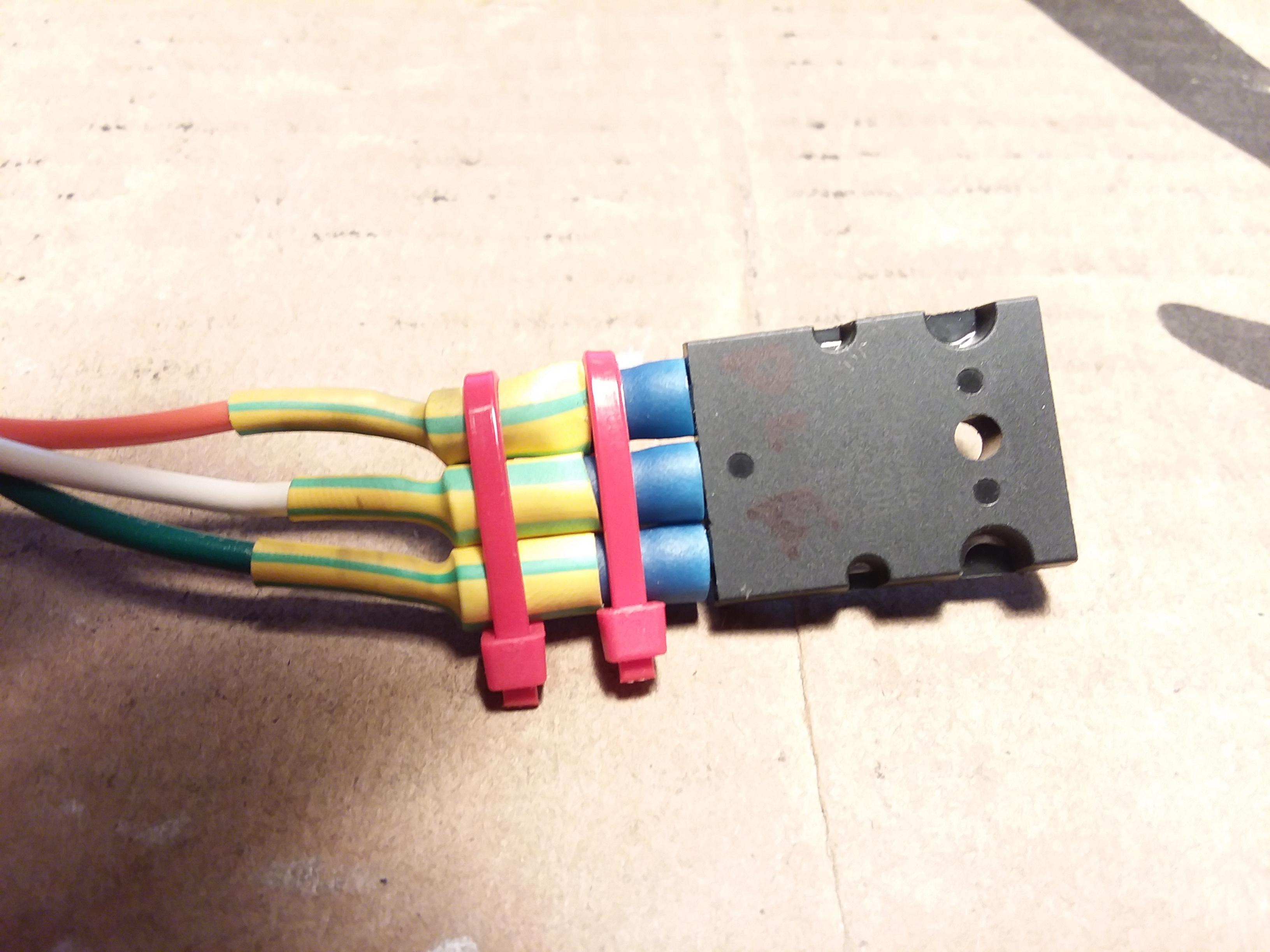

Hey people... have a little tip for you for the flying leads. You can see the way X did them and it's fine, but a little change can make the leads much more stable. The way they are lends to them getting bend very easy.
Take a butt connector sized to accept the lead and the wire you want to use. Cut the insulation back to the actual butt connector on one side. Th other side leave alone. The side you cut back will be the solder connection side. Slide the connector over the lead on Q10 or Q12. 1943 or 5200. Now you should have Q10 leads sticking slightly out the end where you trimmed back the isolation, stuff your wire (don't forget your properly sized shrink tube) in there (tin it if ya like) and solder it in place. Repeat for all leads.
Make sure when you set the completed package on a flat surface the zip tie doesn't prevent it from sitting flat on sink surface. If it does, carefully give them a slight bend until the no longer obstruct proper sinking.
For the next step you will be adding two small zip ties spaced apart a bit, see picture. Now when the zip ties are in place, it makes the leads on Q much more rigid. You could even remove the insulation from both ends and trim the leads back a bit....

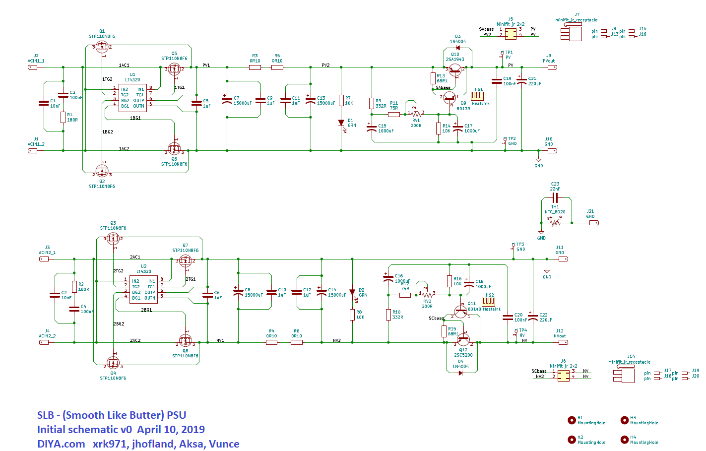

Hi folks, I should state that the purpose of the pot was to allow some adjustment of the voltage drop to obtain suitable ripple rejection. Typically that will be about 3v.
I get a max of about 2.5v difference in the output, winding the pot fully up to fully down.
I would not go in and change the circuit as it has been tested and verified to be oscillation free. The CFP topology is very sensitive to changes that could set it into oscillation.
Sure but with the pot, you've allowed a resistance range of 75 - 275 ohms. Do you think I really have to change the 121 ohm res I substituted for the 75 ohm res ... back to 75 ohms? (Given the range is now 121 - 321 ohms.)
In hindsight, we should have just installed a fixed value at the pot to give about 3v drop which seems to handle even large 4.5A of current.

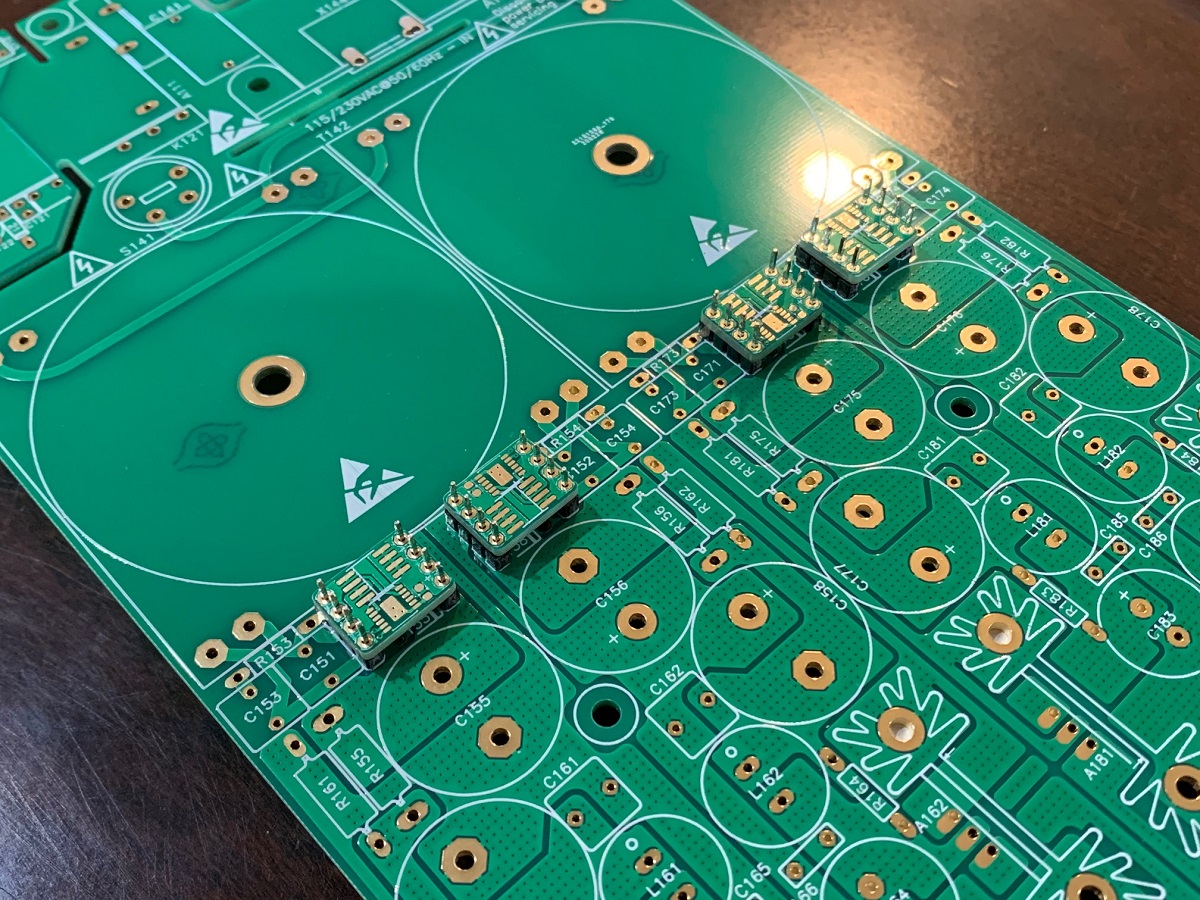

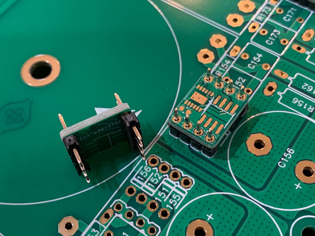

Here are the new LT4320 bridges (13mm x 10.5mm ea):
More info on the new Yarra PSU with LDO regulators here:

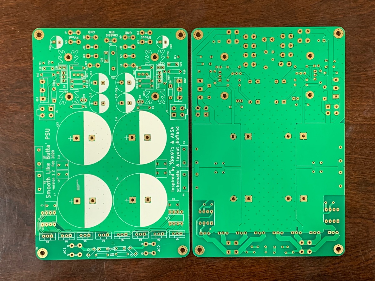

A new generation of SLB’s, now in green!
Rotating the trimpot 90° and changing to a vertical mounted Molex Minifit header are subtle but very welcomed revisions.
