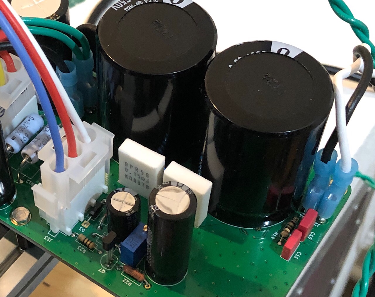

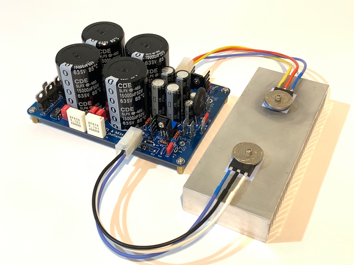

Here is a photo of a single rail SLB portion of the amp (we integrated it as part of the amp for testing). You can see how small it is when using SMT variant of the active MOSFETs (mounted underside). Those are 15,000uF 50v bulk capacitors. Compare that to how usual Class A CRC or CRCRC supplies are using 22,000uF or 33,000uF caps. The large 3pin Molex connector allows us to place the cap Mx pass transistor anywhere we like and allows snappy assembly/disassembly from the chassis or heatsink:
748769d1554898242-slb-smooth-butter-active-rect-crc-cap-mx-class-power-supply-gb-1e957870-29cb-40a4-aa73-0b423e234972-jpeg

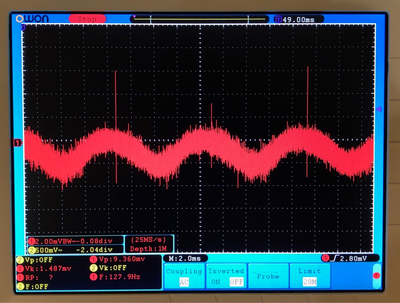

Here is the measured ripple (1.4mV rms) from the Darlington cap Mx with 4.35A load (37.5vdc output) with an 8ohm resistive load:
748770d1554898242-slb-smooth-butter-active-rect-crc-cap-mx-class-power-supply-gb-1ccef4ec-897d-4006-8cc8-b27dbede3f78-jpeg

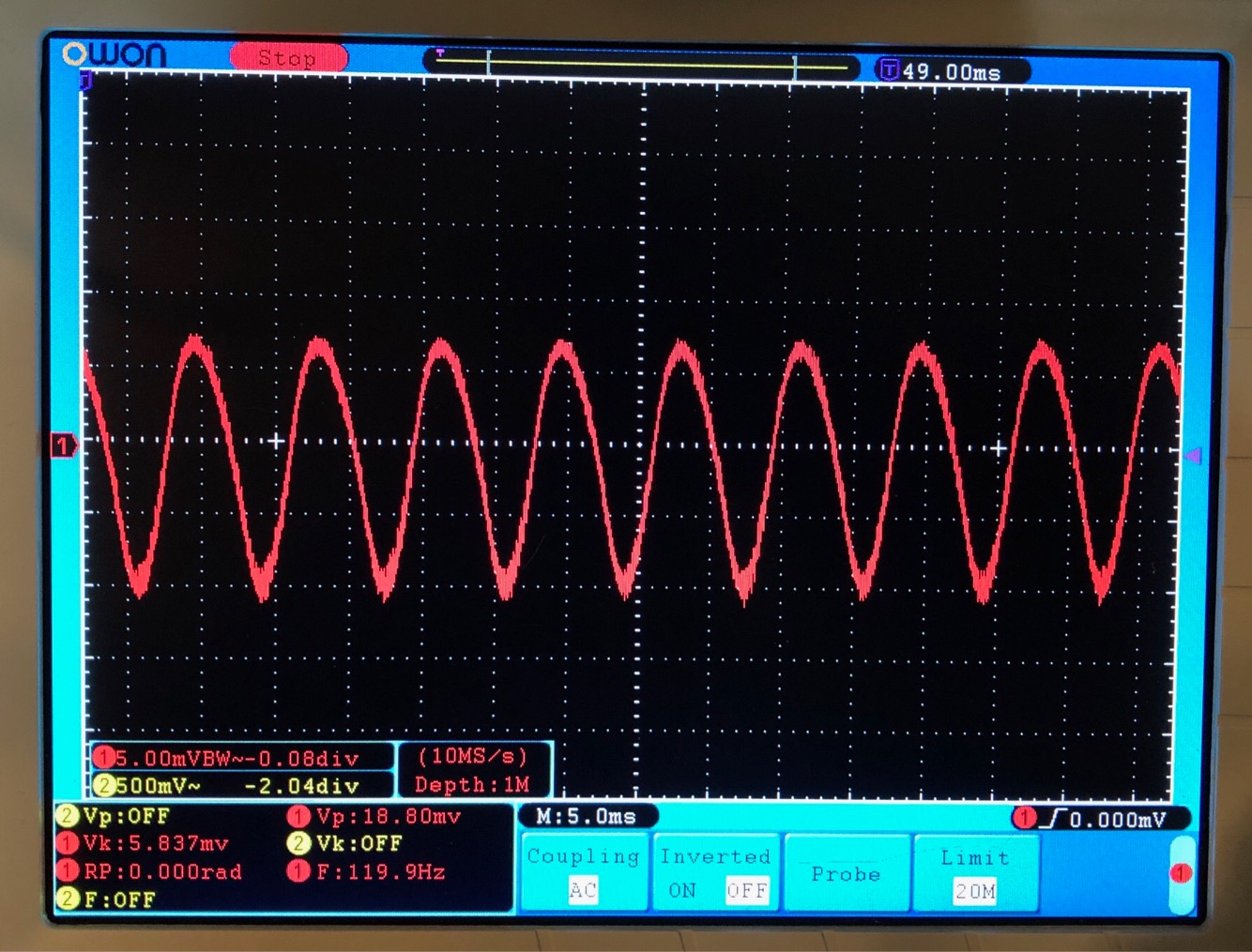

Under a real SE Class A amplifier load, the ripple is a bit higher at about 6mV rms with the Darlington topology, but still very respectable given a 4.35A current:
748771d1554898242-slb-smooth-butter-active-rect-crc-cap-mx-class-power-supply-gb-7dbfdc78-43d4-4d83-852b-7b5ba62a34b2-jpeg
Our simulations show that the CFP topology should be even better. The LTP differential topology will be tested soon (tonight perhaps).

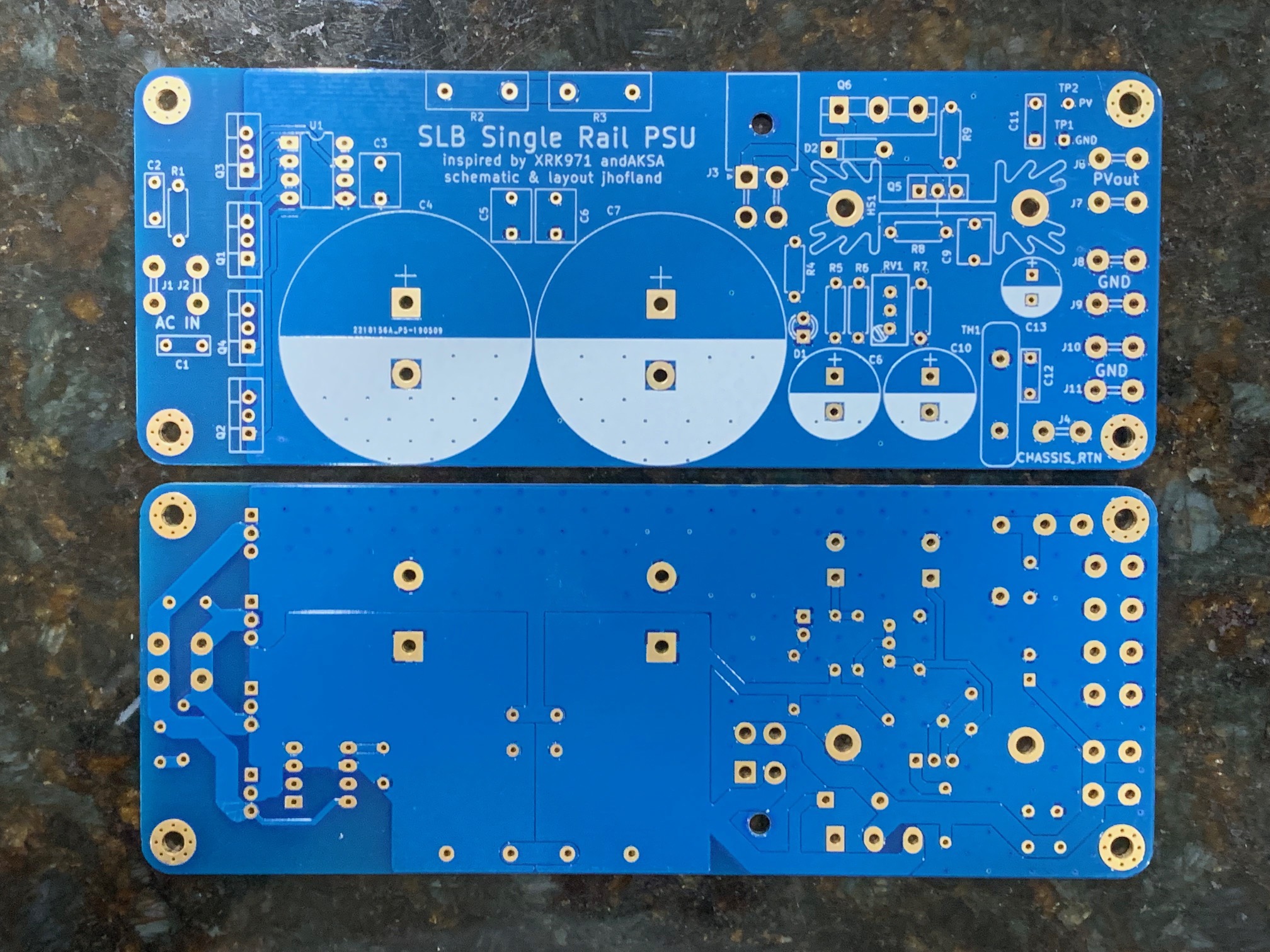

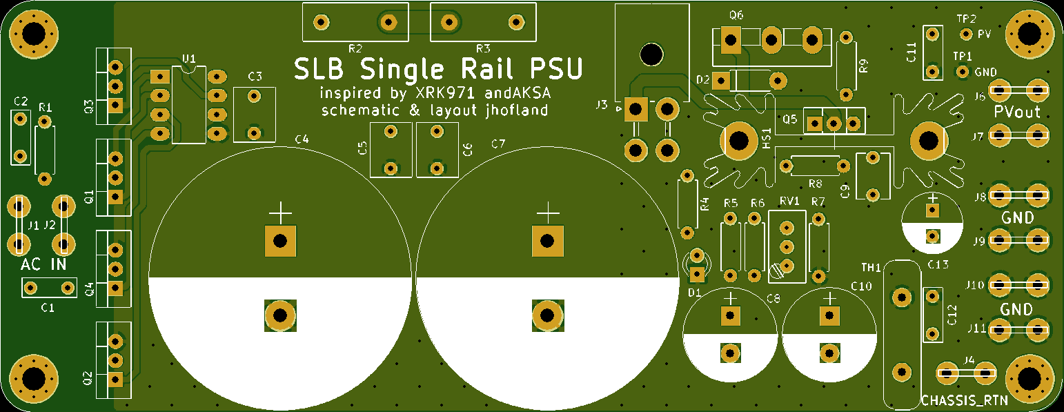

Edit May 6, 2019: Here is the SLB-SR (single rail version). BOM and Schematics here. Pricing on SLB-SR is $18ea (also 2mm thick FRP, 2oz Cu, ENIG finish, blue mask):
754794d1557149681-slb-smooth-butter-active-rect-crc-cap-mx-class-power-supply-gb-slb-sr-pcb-top-view-png

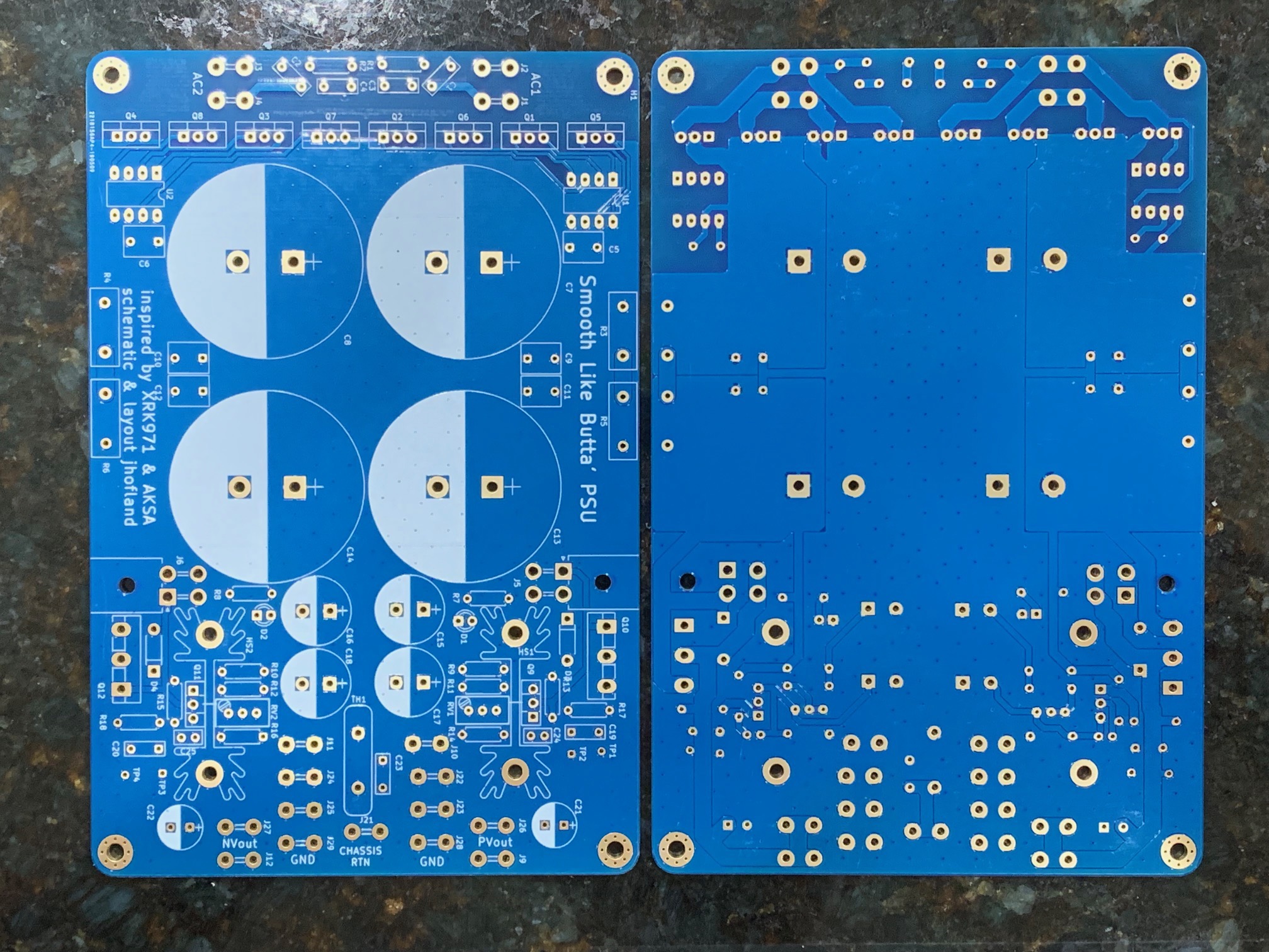

Edit May 23. 2019: Production PCBs arrived.
Dual Rail
758461d1558568508-slb-smooth-butter-active-rect-crc-cap-mx-class-power-supply-gb-5431d4ee-3959-435c-8995-c93eefaac2d2-jpeg
Single Rail
758460d1558568508-slb-smooth-butter-active-rect-crc-cap-mx-class-power-supply-gb-847aa044-022d-4e64-80ce-c7b43ac92120-jpeg

Looks to me like a couple of ferrite beads, installed in the right places, would do quite a bit of good. For the scope traces presented here you'd want to select "low" frequency ferrite cores not the cellphone frequency cores. It's a cheap and easy experiment which can be done on non-modified PCBs, i.e., not requiring relayout. If you like what you see then you can weigh the pros and cons of relayout versus retrofit.
Is the intent to have just a single-rail component, or is this just proof of concept?
Proof of concept was single rail. Final here for GB will be dual rail. The proof of concept also used an all SMT implementation of the active bridge rectifier for compactness. However, for a general purpose DIY PSU, we have decided to go with all through hole. This means that qnty 8 x TO220 MOSFETs will be used, but since they will not be dissipating any heat really, no heatsinks (or associated insulator pads, bolts, bushings, nits, etc) will be required.
I have a lot of noise pickup from something in my lab. The low level hash that makes that fuzzy trace is there even when I switch the PSU off. But perhap some ferrite beads may indeed help.

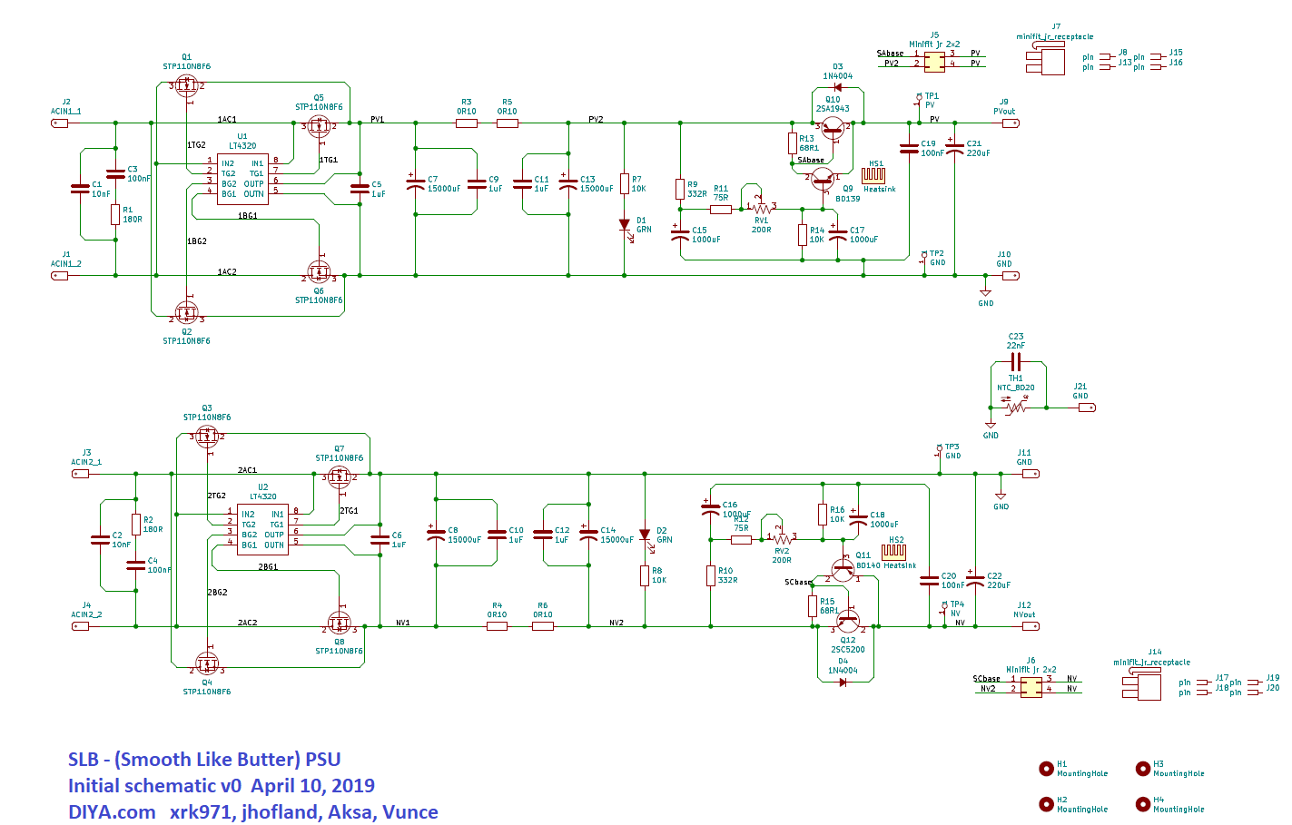

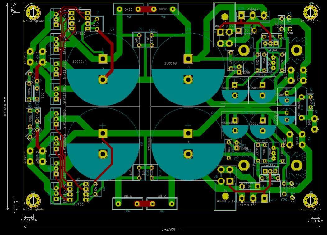

I'd lay out a suitable wattage resistor in series with the emitters of the high power pass transistors Q10 and Q12. Just in case your CFPs on your board, earn their reputation for unwanted oscillation. A good way to choose the resistor value is to pretend you are connecting "N" number of CFPs in parallel to spread the heat load across N devices. Then these emitter series resistors effectively operate as ballast resistors, which guarantee equalized current-sharing among the N parallel CFPs, despite each transistor having a slightly different VBE. The emitter resistors prevent thermal disaster via current-hogging.
Whatever emitter resistance you would use for N=3 parallel CFPs, to prevent current-hogging, just use 1/3 that resistance in a single CFP. Bada bing, oscillation is tamed.
You can build a test board with the resistor jumpered out, to see how badly the circuit oscillates with no resistance.

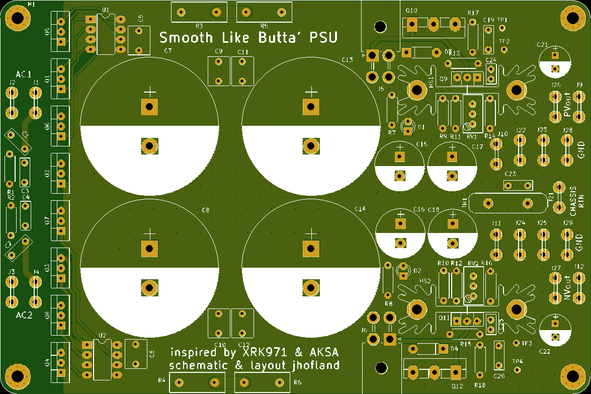

Here is what the board layout will look like. Note the exclusive use of through hole parts. The pass transistors have the option of on board underhung mounting or externally mounted via flying leads on 90deg Molex locking quick connects.
CFP has a widespread and universal reputation for unwanted oscillation. Take a look at the Tektronix power supplies that use CFP, they've got lots of oscillation countermeasures. Then ask yourself: is Tektronix the kind of company which bothers to expend board area and parts cost, to solve a non-problem?
Me, I've experienced CFP oscillation when I foolishly used (a) no ballast resistors; at the same time as (b) BoHunker large beefy output transistors with lots of phase shift (low fT), simultaneously with low current complementary devices in the CFP, having high fT. I don't know whether this combo oscillates every single time, or only every time somebody doesn't bother to prototype it in a debug and tweak period into their project schedule. No data on that.
Evaluate the odds, then take your chances and roll the dice. Try not to remember the junior engineer's lament, "There's never time to do it right but there's always time to do it over".
You should try a bunch of different MOSFETs. The gate drive on those monsters you've selected will create tons of HF hash. No gate resistor even! The driver/MOSFET circuit should be treated as a high frequency circuit (due to fast edges and high current spikes on gate drive)

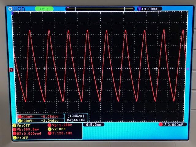

For reference, here is data from an initial test that I did with the active bridge and CRC but no cap multiplier. You can see a sawtooth at 120Hz but there are no spikes ornringing artifacts. This was using a 25V 250VA trafo to make 3.8A continuous at 32v into an 8ohm resistive load. This was giving 390mV rms ripple.

The manufacturer’s recommended circuit doesn’t call for a gate stopper resistor even (perhaps they are internal to the chip). They are trying to make the package as easy to use as possible and then only required component aside from the said MOSFETs, is a 1uF bypass cap across the output pins.

Well there may be no issues at all, but fact is gate drive is full of HF hash. Unless there is some resistance in the chip and there may be. You may have high frequency EMI radiating from the MOSFETs, but the magnitude and frequency may be of no real issues. The rectified sines are nice, and zero volt switching is probably the reason as you say, but at zero volts on the drain the gate capacitance is at it's most, it is huge! But there is no miller, so perhaps not so bad after all. I would treat the gate drive as a HF circuit, but as you have experienced, there may be no real world problems to worry about. But why not experiment a little.

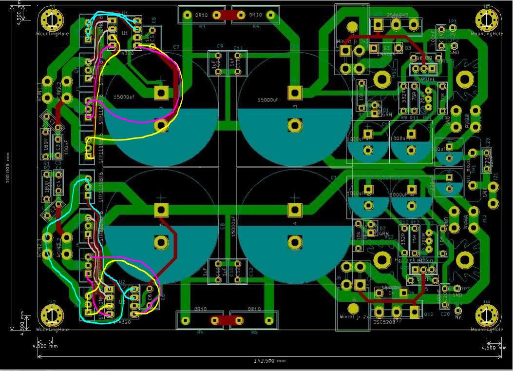

The gate drive send and return paths should be as tight as possible, and it doesn't hurt to have a resistor to slow things down. Those should be SMD, 1206 is easy enough to work with and small enough.
These are the loops I mean, see picture.
