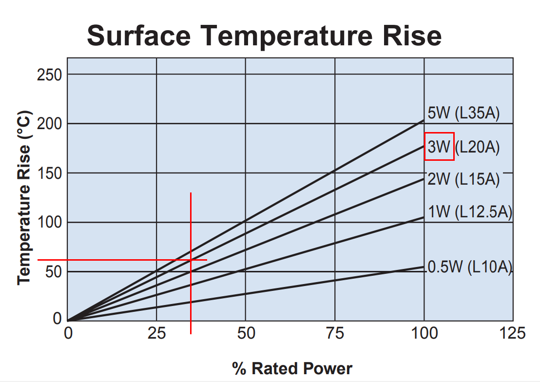

... [in a power supply CRC filter] the resistors themselves dissipate enough power to get pretty toasty.
Although resistor manufacturers publish datasheets, few people read them. Which is too bad, because then there would be less angst and surprise when dissipating one watt in a 3 watt rated resistor produces a very hot booboo device. If the datasheet curves are accurate, thermal resistance theta (degrees C per watt) is constant; the curves are straight lines of constant slope, passing through the origin.
Oh and if you dare to dissipate 3 watts in a "3W" resistor, the resistor body will be 175 degrees C above ambient according to those curves. Hot enough to make the PCB turn brown. Hot enough to melt 63/37 solder!

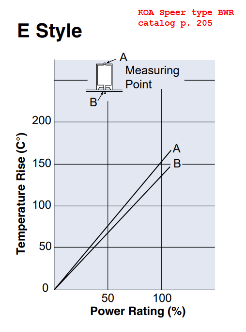

I couldn't find a temperature-vs-dissipated_power graph, or a theta spec, for the BPR resistors on page 211 of that KOA Speer catalog. But the previous resistor in the catalog, type "BWR" on page 205, looks physically very similar and I was able to find its graph, copied below.
If using a BWR resistor rated 5W, dissipating 2.5W in it will result in a temperature rise of 65 to 75 degrees C above ambient, depending on whether you measure at the bottom {which cooks the PCB} or the top {which burns people's fingertips.} Add the room ambient air temperature (~ 24C) and you're close to the boiling point of water.
It sounds like you have already investigated this, using either fingertips or thermometers, and deemed the resistor temperature acceptable. If so, congratulations. Too many people fail to do this, and receive a high temperature surprise early in the production of assembled units within chassis. The unhappiest surprise is when these folks operate a resistor "within rating" and yet it melts its own solder.

It's definitely not something you want to grab with your fingers when it is running, but doesn't melt its own solder at least and we are giving it room for air flow. If folks are concerned about keeping temps low, use four 0.22R in series parallel and dissipation will be about 1.25W each for maybe 65C temps.

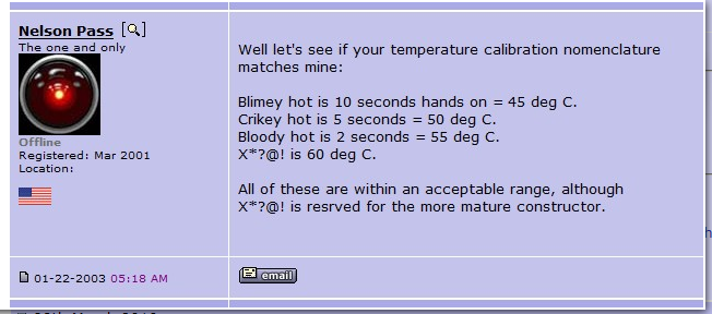

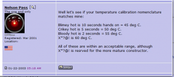

Here is a screen grab made by diyAudio member "ZenMod" sixteen years ago (!)
Somebody asked Nelson Pass, "When you touch various places on a Class A amplifier (heatsink etc), what physical sensations correspond to different temperatures?"
or some question like that.
NP replied, "Count seconds and see how long you can maintain contact before the pain becomes unbearable", and then he gave this handy table, attached below.
