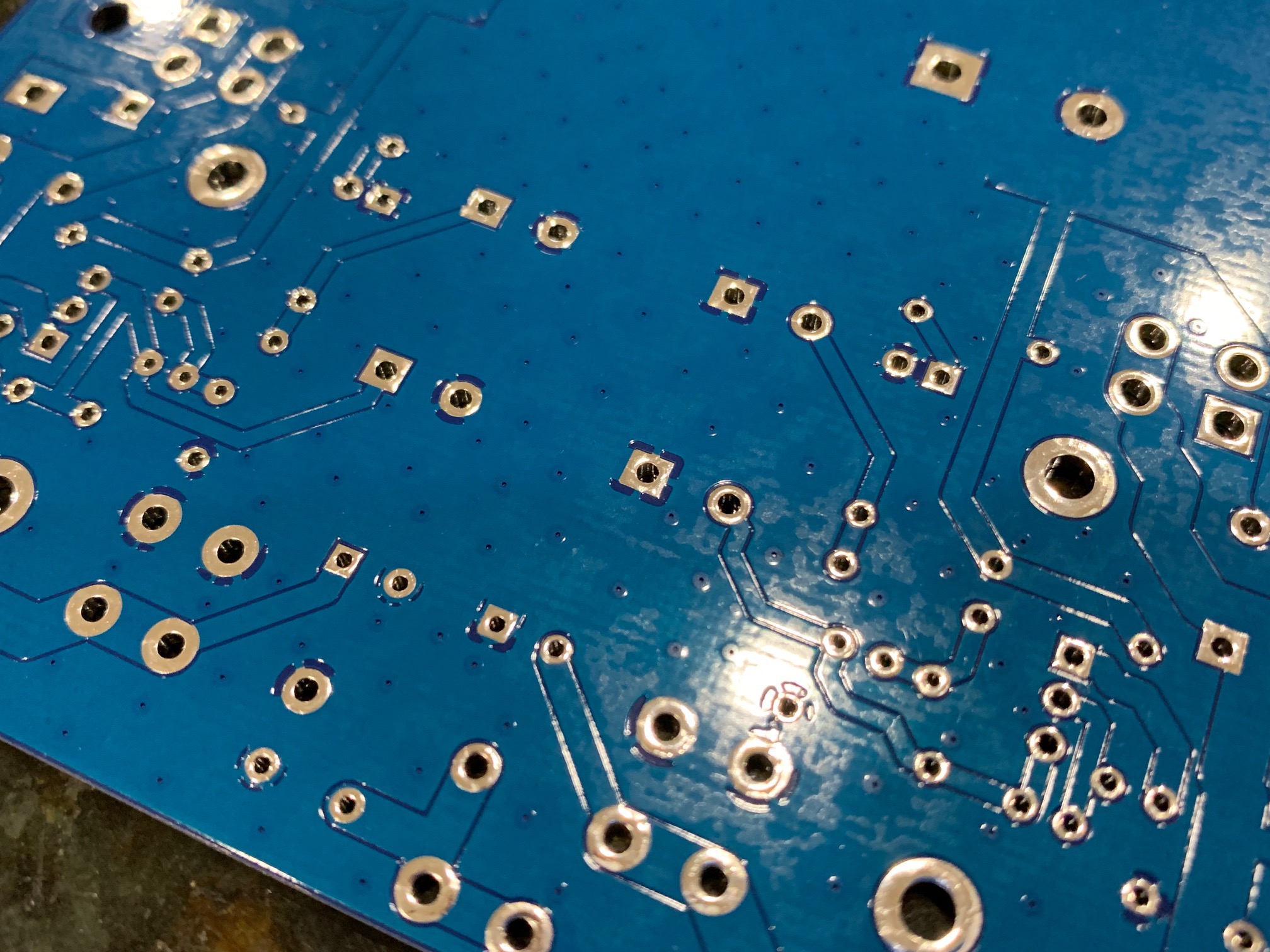

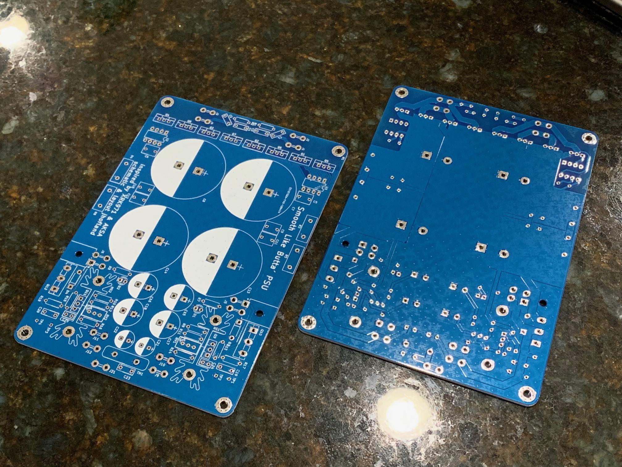

The SLB verification build PCBs just arrived. I will try to build it up this weekend. Board looks great - Thank you to jhofland for the beautiful layout!
The boards do look good, hopefully your build will find no problems. I have all the parts together ready to build (apart from any late changes you might suggest after building and testing) as soon as I get my boards, thanks again X.
The SLB’s look sweet X!
Very nice layout jhofland, the edge mounted CRC resistors will love their open space 😀

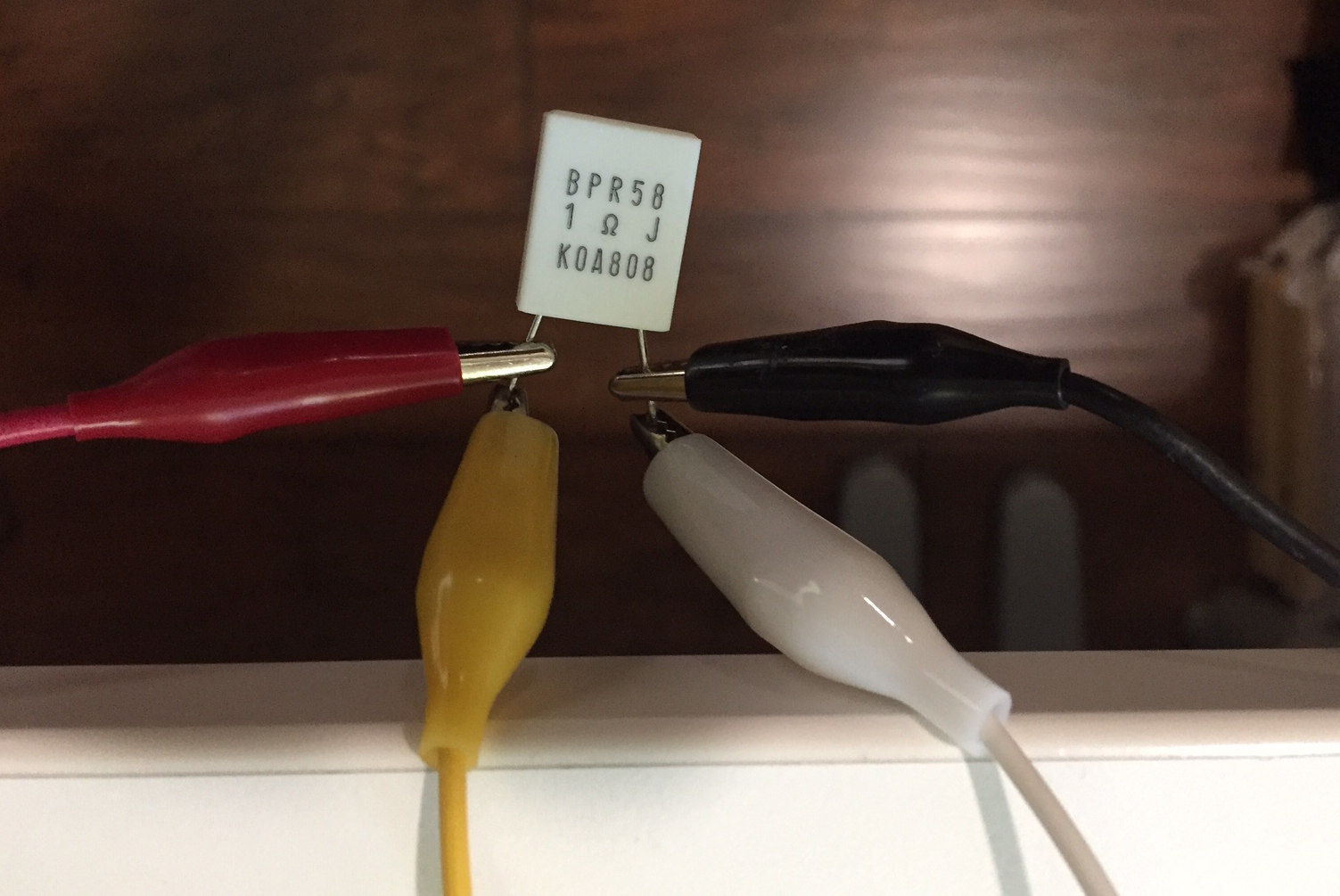

I added a few of those KOA Speer rectangular metal plate resistors, part type "BPR", to a recent Mouser order. They were less than a dollar, it's a very low cost to perform some fun experiments.
I bought the 1.0 ohm resistor from Mouser, and attached it to my lab equipment using a "4 point Kelvin connection". Current is forced from the red clip to the black clip. Voltage is sensed from the yellow clip to the white clip. Notice that the yellow and white clips are attached in places where the high current is NOT flowing. There is no IR drop to pollute the voltage measurement.

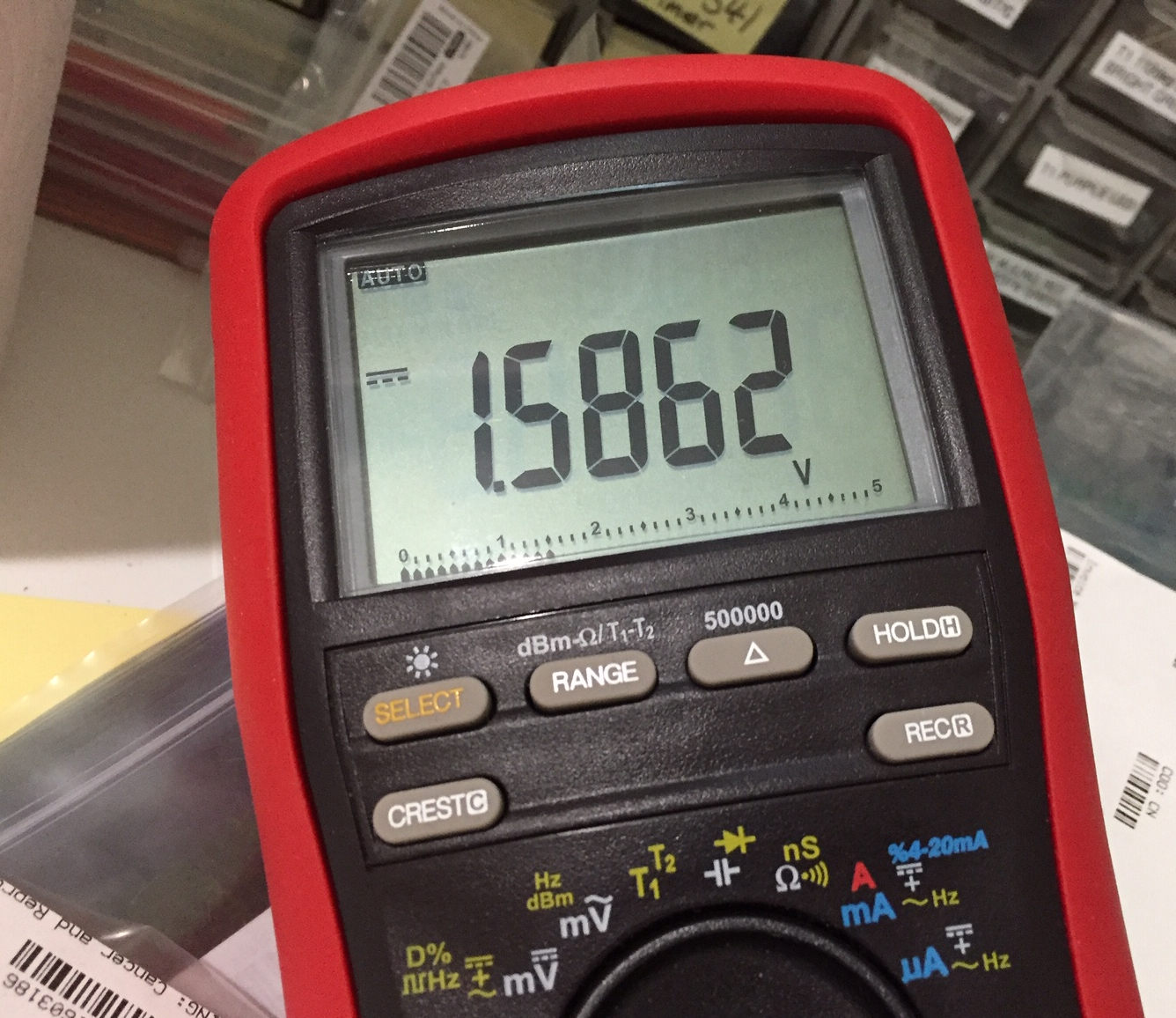

I carefully adjusted the power supply output voltage until 1.5862 volts appeared across the 1 ohm resistor, measured at the yellow clip and the white clip. Thus the power dissipated in the resistor was (1.5862 * 1.5862 / 1.00) = 2.516 watts. That's my best attempt to match the 2.5 watts of dissipation, mentioned in the very first quote above.
I used a Type-K thermocouple to measure the temperature of the BPR resistor body. The thermocouple bulb was pressed onto the resistor body right where the OMEGA symbol is printed, between the 1 and the J. Thermocouple temperature in this position was 95.6 degrees Celsius. Almost hot enough to boil water. Definitely hot enough to burn a hobbyist's fingers.
_
96C sounds rigjt - no argument there. I did say you don’t want to grab it with your fingers when it’s running. 96C temp doesn’t bother the part though one bit.
