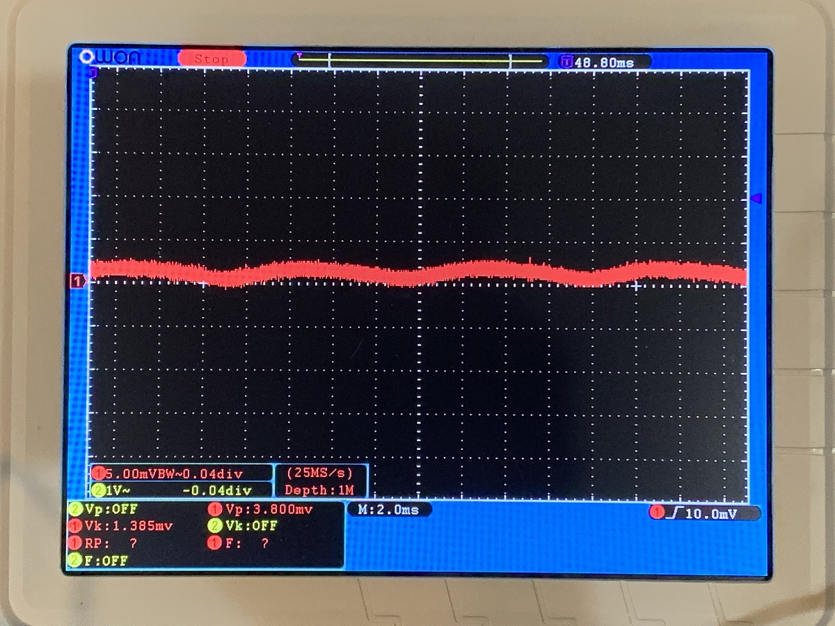

After some discussions we decided to remove the 10R resistor at R17 and R18 to buy back some gain that should squash the ripple even more. R17 and R18 are there to prevent oscillations should they occur, but do so at the detriment of ultimate ripple eating performance. So I removed the 10ohm resistors and replaced with a jumper. You could keep a 2R2 or even 1R5 there if you are chicken. But if you fry a $2 Toshiba 2SA1943N or 2SC5300N, no big deal. I monitored the output voltage with an o-scope during the power up and saw a small 50mV MHz range oscillation that was in a burst mode, but as soon as the voltage stabilized (5-10 seconds) the oscillation went away. What we are left with is pure magic. Here is 35.4v output into an 8ohm load for 4.43A current with a 3.1v drop across the CFP slave 2SA1943N transistor, and even at high current, the ripple is about 1mV. I measured 1.2mVrms on the postive rail and 0.9mVrms on the negative rail for the same condition. The negative rail had no startup oscillation.
attachment.php
This O-scope shot is on the 5mV per division vertical scale, and you can see the output. It's a tall order to ask a PSU with only 30,000uF bilk capacitance to give 1mVrms ripple under a 4.4A load. This means that one of these PSU's will have plenty of ripple eating ability for powering a stereo amp. The only thing one needs to be careful with are ground loops when sharing a PSU between two channels.

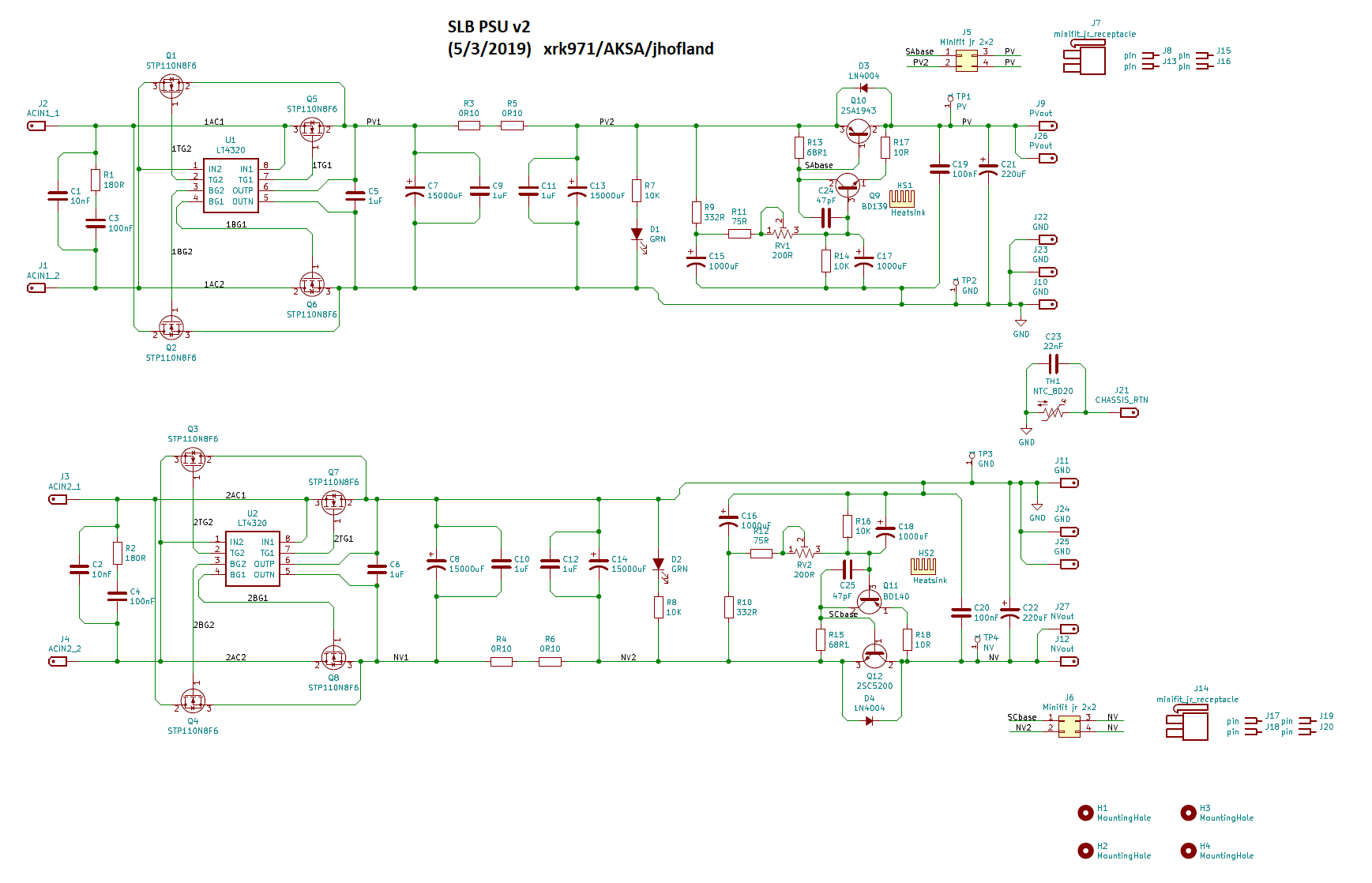

Here is the schematic of the production board (v2, May 3) with extra sets of output spade terminals for use as a stereo PSU:
attachment.php
In the above schematic, replace R17/18 with either jumper if you are brave or a 2R2 if not. Although a !R would probably squelch the startup oscillation nicely and give about same performance.

Brilliant, X. It seems that with ripple at 1mVrms even a low PSRR Class A would sound utterly quiet. It occurs to me that using a single darlington like a BD679/680 in place of the BD139/140 we would be able to get the ripple down another ten times for a stellar result. But we chose BD139/140 for good dissipation, low cost and slow speed as we knew the CFP configuration is famous for instability.
Do you have any emitter resistors, ballast, on the slave transistor? We only use one device here (Pd is around 13.5W, only one device needed) and if it is stable, arguably ballast resistors need not be either reduced or even used.
Thank for letting us know what and exactly and how you gone about it. This is a primer for anyone studying linear power supply design.

Hi Hugh,
There is no ballast resistor on the 2SA1943N slave BJT. It is exactly as it appears in this schematics (except jumpers provided at R17/18):
754412d1557026393-slb-smooth-butter-active-rect-crc-cap-mx-class-power-supply-gb-slb-v2-schematic-5-3-2019-png
And even at 7mVrms, a low PSRR SE Class A amp does sound so quiet I cannot tell is is even on by listening to speakers when source is not playing music. 1mV must sound even more quiet.

Sure, we can start thinking about the single rail version of the SLB now that we know the layout is good. It’s basically the top half of the SLB board. We will have to wait for Jhofland to make the layout.
Let’s call it the SLB-SR, and simply specify SLB or SLB-SR in the GB list. Pricing will be $17ea for the SLB-SR. Note that cost of boards is mostly based on the single maximum dimension, and not the surface area.

I was thinking about just using the single rail on the dual board as well, but using just the rectifier portion of the other rail to create a separate positive rail (not using the cap multiplier on that rail.) It would be for the DC filament heater of the preamp tube, which has its own CCS for ripple.
See any issues as to pulling the output off that 2nd rectifier for other uses like this?

That would work fine and you could use smaller bulk caps and perhaps a linear regulator like 78xx.

Yes, I had similar thoughts but the second rail I would need (for a gyrator loaded 4P1L driver stage for my MoFo project) needs to be up towards +200V, however, I'm not sure the active rectifier on the negative section could be used anyway as it I believe the pinout of the mosfets means it isn't as simple as reversing them on the board? My observation is based on the picture of the PCB in the first post which shows the board has a connection between the grounds lines of the two sections.
