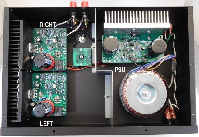

I have often wondered what such psu could bring to class A/B. there are some hints on Eliott projects page but it stays generic. What would you advice if used foi A/B? Is it a waste of resources?
The Akitika GT102 is a class AB chipamp. It's got a regulated power supply, which is equivalent to the highest possible performance capacitance multiplier (you can imagine it as a Mx with Cap=infinity). This drops an even larger number of volts than a capacitance multiplier, but the result is ultra low impedance, super clean supply.
How does it sound? Fantastic. What does it cost? More than a Cap Mx. Photo below. Notice that the voltage regulator PCB is bigger than an amp channel PCB, and the voltage regulator heatsink is bigger than a (class AB) amp channel heatsink.

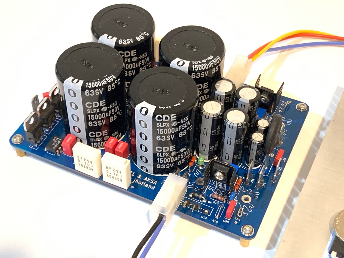

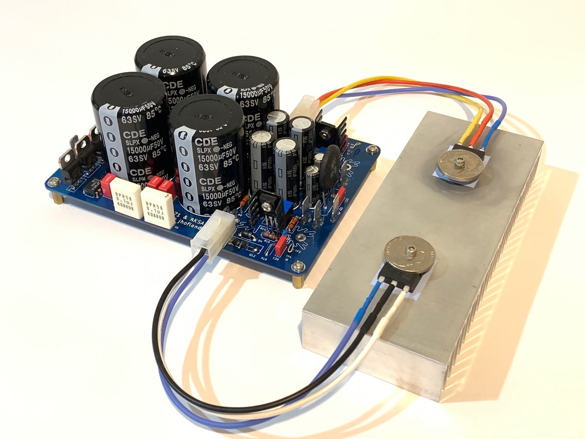

Some close up photos of the SLB verification build (v1). Note that the production v2 will be a bit longer to accommodate extra output FASTOn spade connectors for use as a stereo PSU.
attachment.php
With output slave BJT's (2SA1943N and 2SC5200N) mounted on a cheap $5 aluminum heatsink. The chassis floor plate or the actual side finned hetasink of an amp enclosure will be fine. I love the AMP quick disconnect cables (I use 18ga silicone super soft and flexible wire from RC model cars) - it makes removing the PSU board literally a snap. You also have the choice of mounting the transistors directly to the board in an underhung fashion:
attachment.php
Another view:
attachment.php

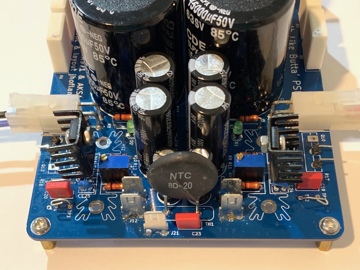

End view of the Cap Mx part with the CFP master on the small local heatsinks and the NTC and 22nF ground loop breaker for connection to chassis GND and mains earth GND:
attachment.php

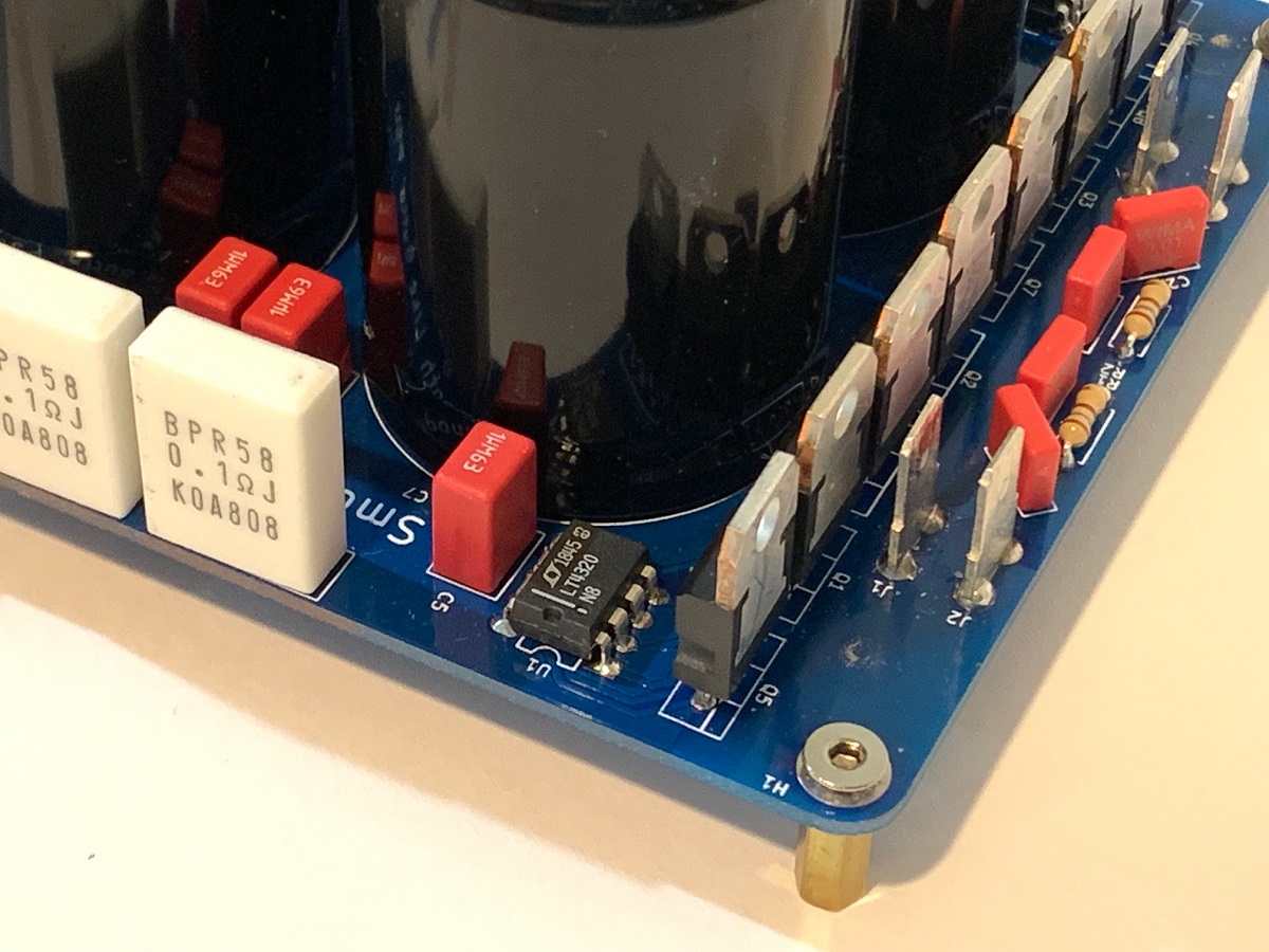

Closeup of the LT4320 active bridge and MOSFETs:
attachment.php
Input AC snubbers are also provided.

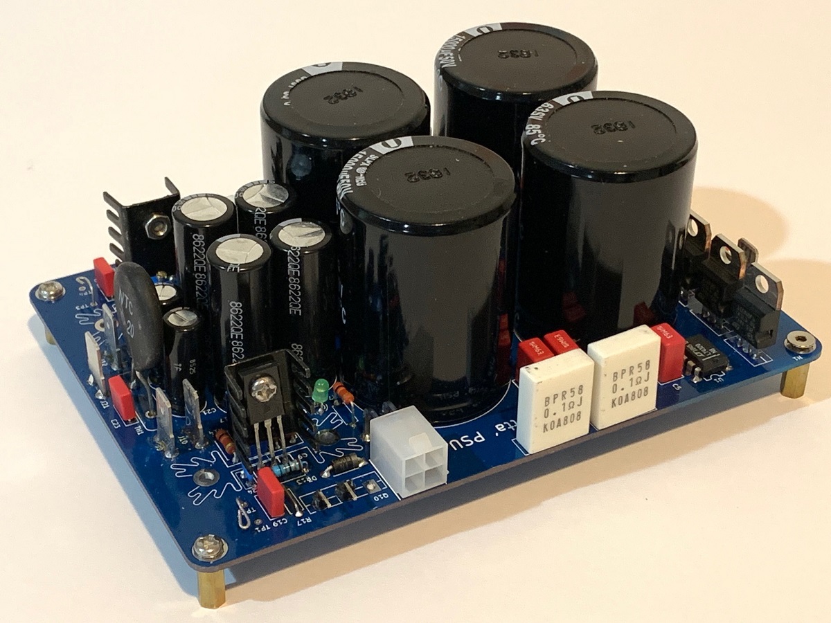

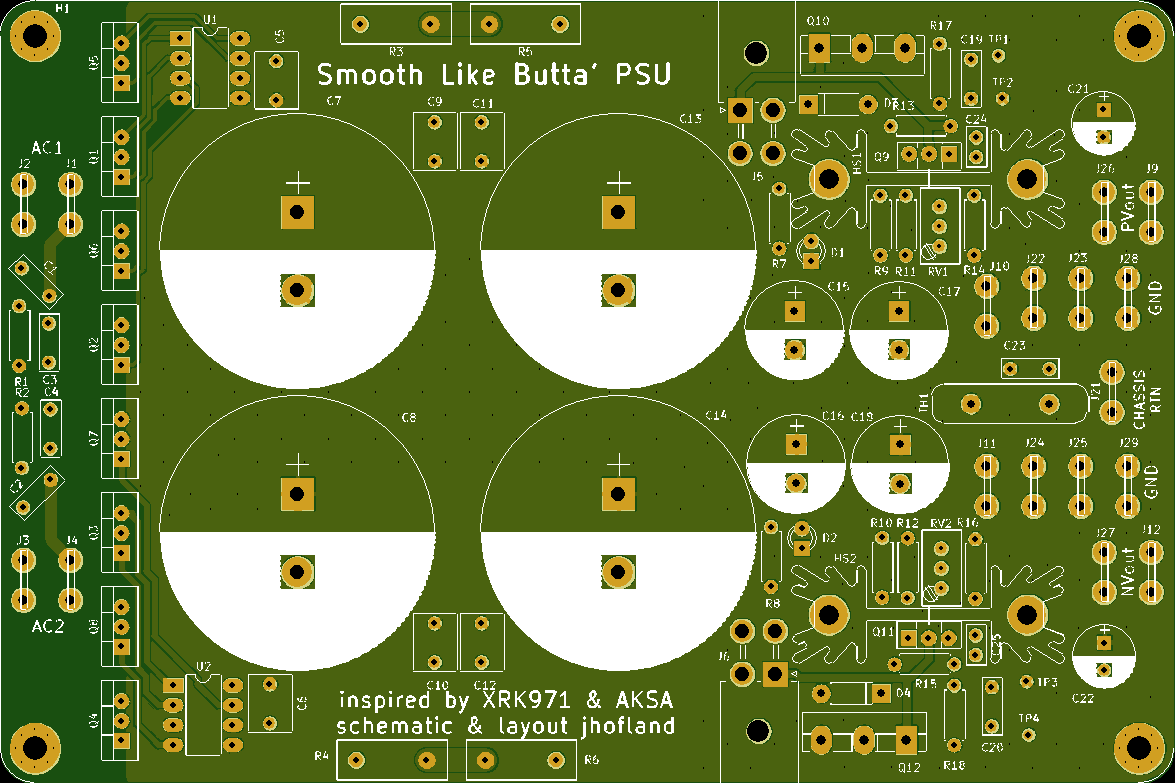

SLB v2 (May 3, 2019) Production Board Top View:
attachment.php
BOM (txt and csv format) and pdf schematic are below.
