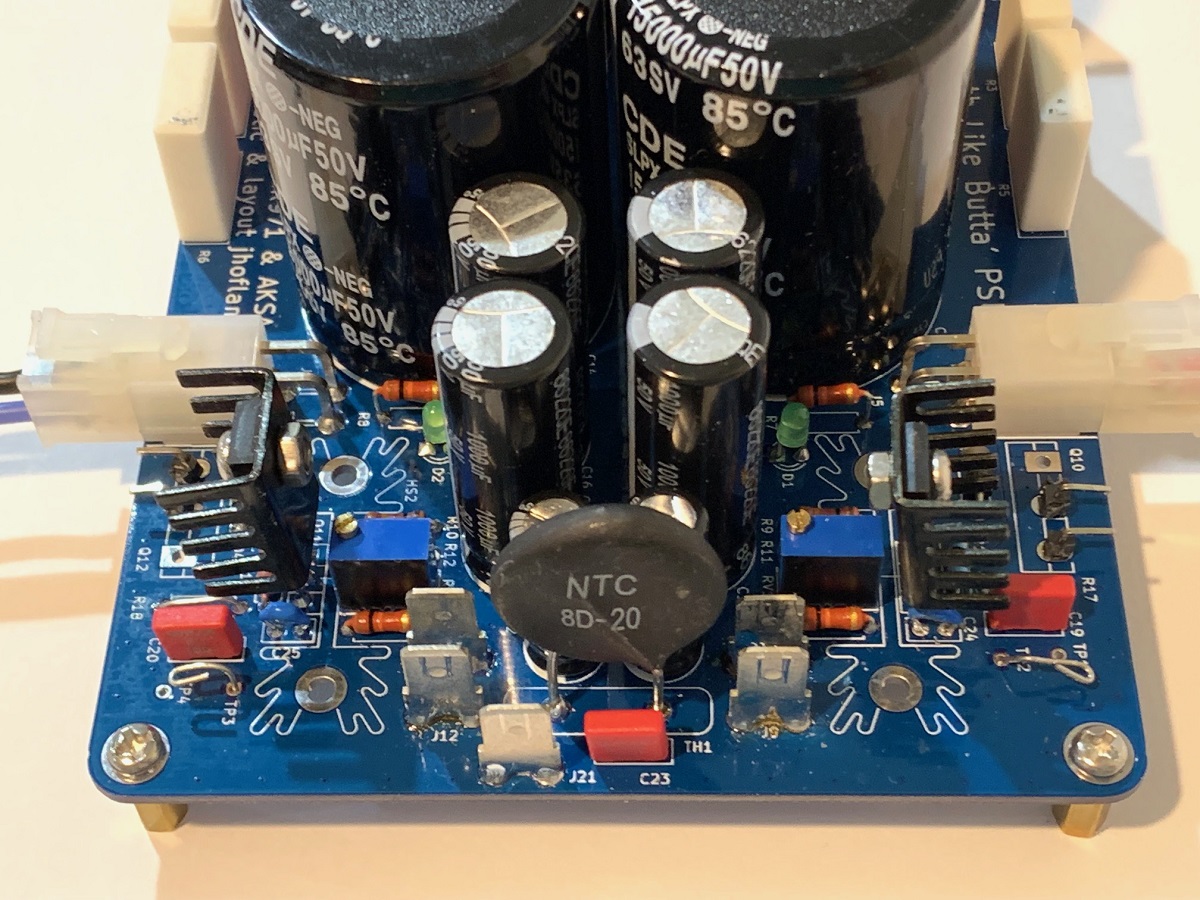

Quick heads up on the BOM posted the other day: A search for the part number for the Aavid heatsinks on the SLB BOM returns nothing at Mouser. I tried a few variations, and had no luck. The part number for the corresponding part on the SLB-SR BOM, 531102B02500G, does work on Mouser, and I'm guessing is the part intended for use on both versions.
I think the darned fool that generated the BOM (me) made a typo. Oops. The intended number is the one Vunce supplied.
Note that even a cheap stamped aluminum serated style fin heat sink works fine. It’s not a lot of heat so big Aavid’s are not critical. Look at my build photo to see what I did.
The big Aavids look nice though - if you really want those - get them.

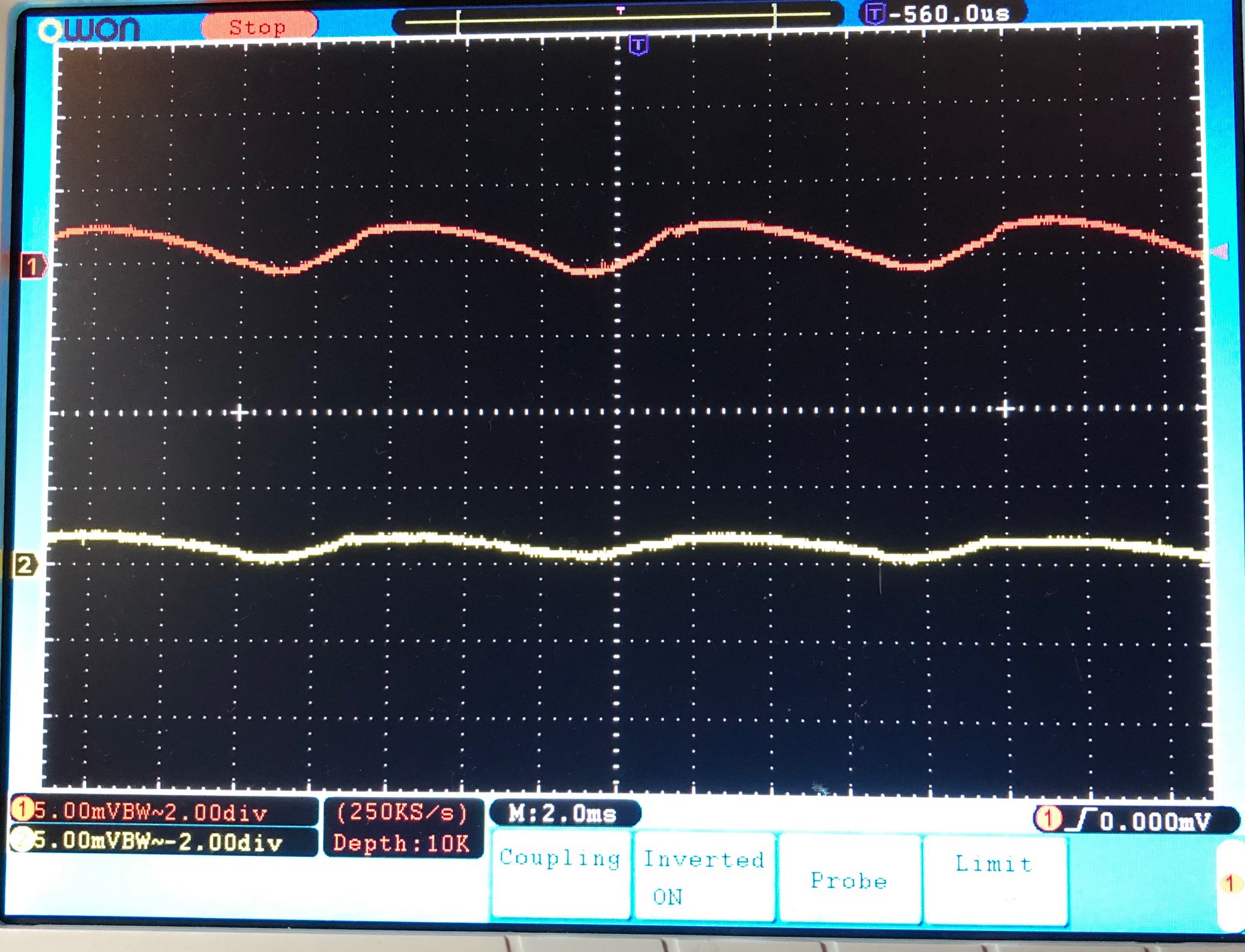

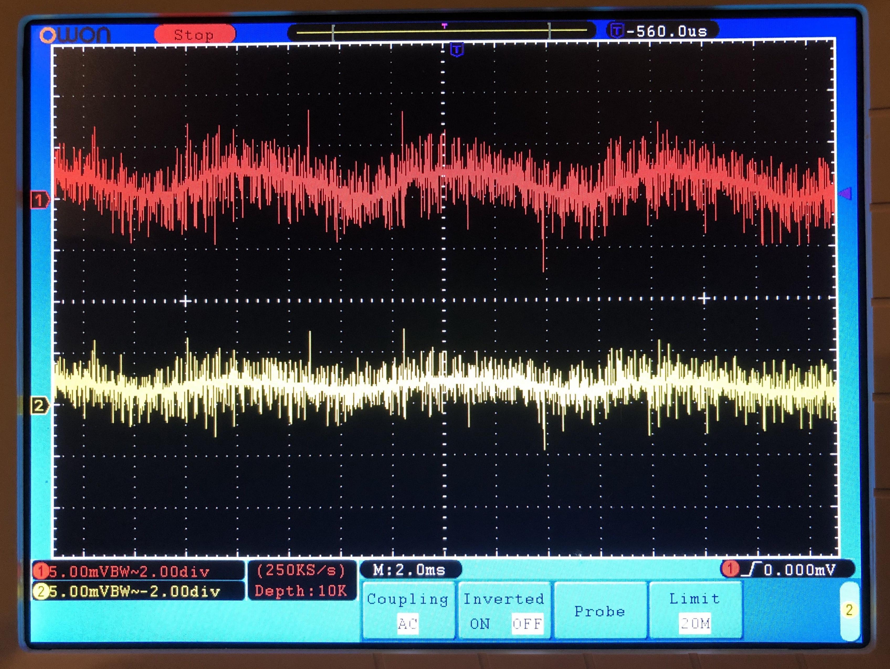

Some independent testing of the SLB topology on an actual SE Class A amp. This data is provided by Vunce and voltage is 37.4Vdc at 3.925A current. Red trace is the 10R for R117 and yellow is 1R5 for R117. Voltage drop on both is about 3.2v. The yellow trace, well it’s smooth like buttah! 🙂
Vunce reported that he found the source of the hash: it was a SMPS plugged into the same mains back-contaminating the supply. Once disconnected, we get this front he SLB (too is with 10R and bottom is 1.5 for R117):
