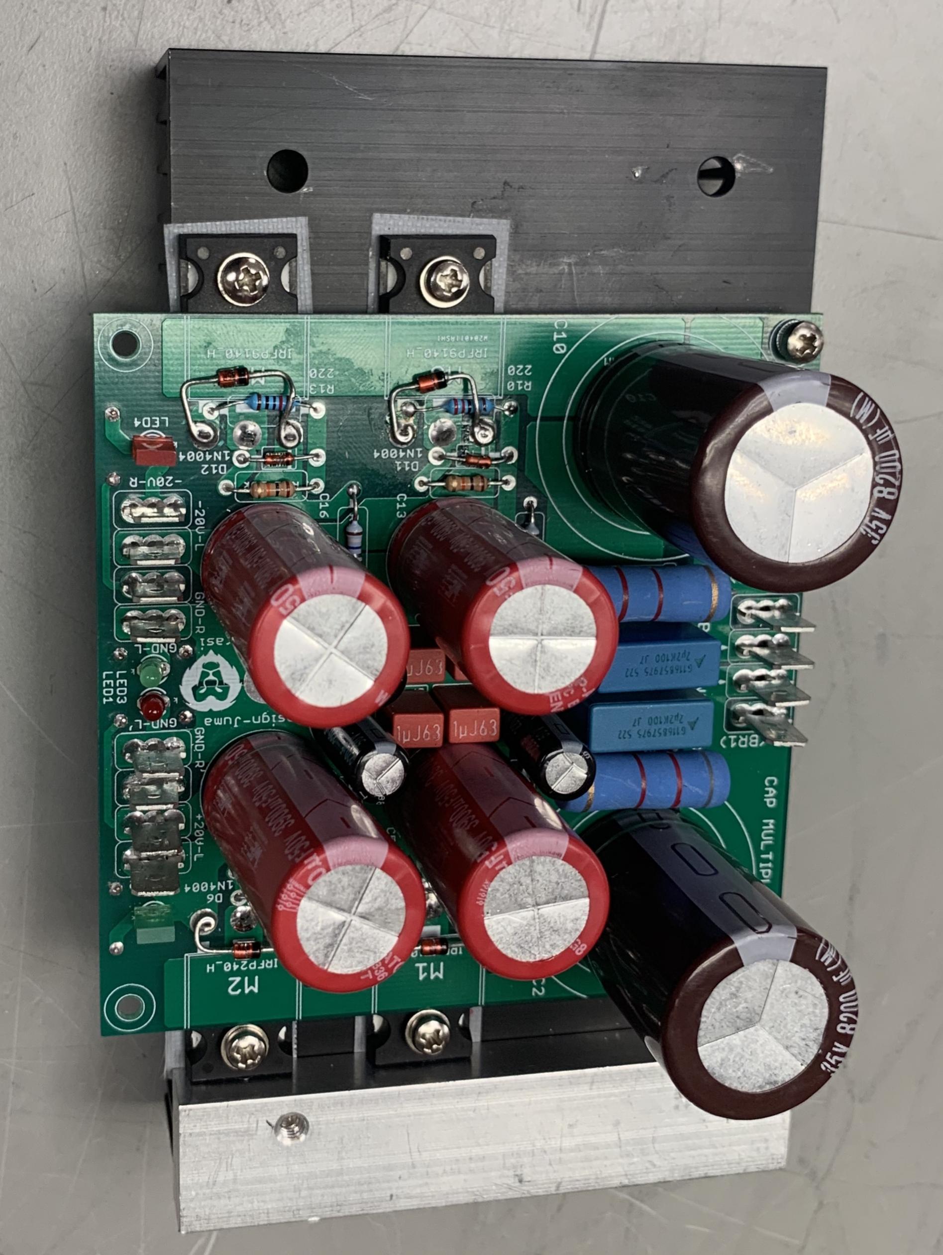

The voltage drop is typically 3v through the pass (slave) transistor on the CFP. All 25w Nelson Pass Class A amps are designed around 1.25A quiescent bias current and +/-24v rails. The dissipation in the pass transistors is then 3v x 1.25A per rail per channel or 3.75w per rail per channel. x 2 rails x 2 channels is 4x3.75w total =15w. I think the front aluminum faceplate can easily dissipate 15w (or 7.5w ea).
Or get a small heatsink like this one (150mm x 60mm x 25mm) for $4 - it works fine:
754596d1557082791-slb-smooth-butter-active-rect-crc-cap-mx-class-power-supply-gb-slb-vero-build-01-jpg
Aluminum Heatsink Cooling Fin 150mmx60mmx25mm for Power Amplifier A6P7 190268295864 | eBay
I am using with an M2 right now (same category of 25w Class A Nelson Pass amp), and it works well to provide the current needed.

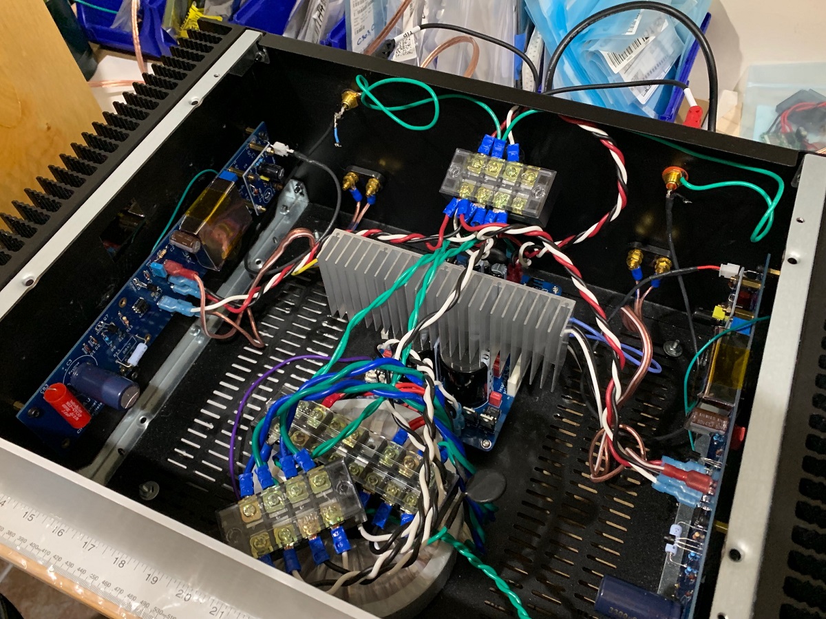

Single dual rail SLB tested with M2X amp
I know many of you are curious about whether or not a single SLB can be used to power a typical Nelson Pass 25w Class A amp. I have finally tested the SLB with a M2X variant and a single Antek 300VA 22v (model AS-3222) trafo with a pair of secondaries for both stereo channels. I know that using dual power trafos and two SLB's would result in a good setup, typically free of ground loop hum artifacts. Well, to achieve a ground loop and hum-free setup with only a single power trafo is challenging and I was originally getting some serious hum.
However, with some thought and debugging, I think I have revealed the path to a hum-free. The hum was bad the moment both RCA input connectors were plugged in. With one plugged in, it was fine so I knew that the source of the hum was a ground loop through the common in the RCA connectors at the source (in this case, an Amazon Echo Input). So, I cut the ground between the RCA panel jack and the M2X PCB and instead, connected each RCA ground to the SLB PSU star hub ground. On my prototype SLB, I did not have enough ground connectors on the board itself, so I used the terminal block where the SLB splits in a 'Y' to the two M2X amp modules.
This removed the ground loop hum to the point that I could only hear it with my ear about 2-3 inches away from the speaker cone (in this case, a 93-94dB sensitve 0.53x Karlsonator with dual 3F25-16's).

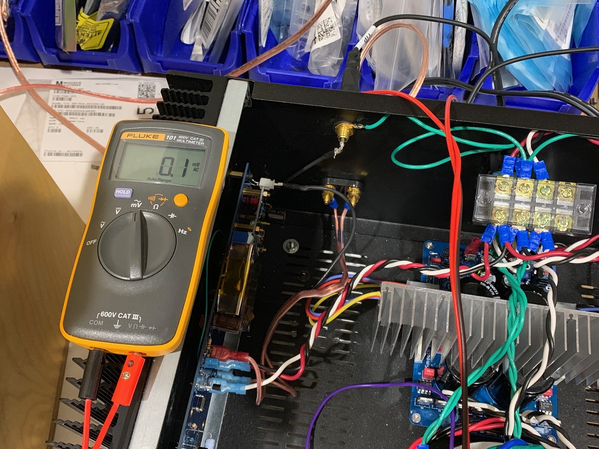

It sounds quite nice, and I don't think anyone would complain of hum at normal listening distances, and even at 3 feet away, the amp sounds silent now with input turned off. Measuring the output at the speaker with my Fluke 101 in AC mV rms, I get 100uV rms on the left and 200uV rms on the right channel. This is with mu-metal shielding on the Edcor trafos and the Antek mounted in the front away from the Edcors. The 100uV rms is actually the lowest I have ever measured with the M2 or M2X, indicating that the PSU is doing its job well.
Here is the setup with the SLB in the middle-back (you can see the pass-transisor heatsink fins), note the green ground wires from the star hub to the RCA panel jacks:
attachment.php
Here is the output AC mV rms on the left channel on the Fluke 101 showing 0.1mV rms:
attachment.php

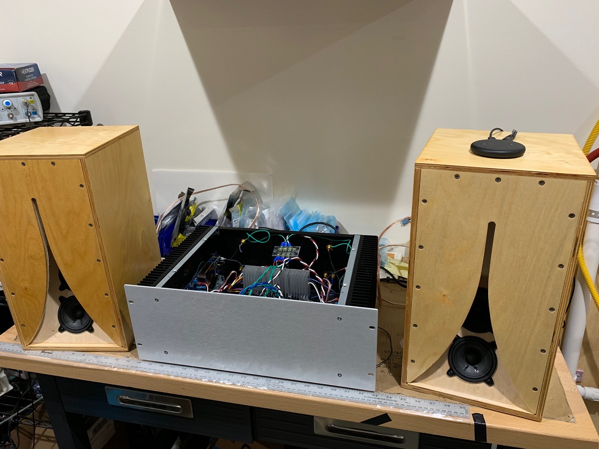

Here is the amp with the 0.53x Karlsonator speakers (dual 3FE25-16 drivers):
attachment.php
Some test condition notes:
Trafo is Antek AS-3222
Source is Amazon Echo Input (no built in speaker)
SLB is running 3.0v drop and output voltage rails are +/-25.4vdc
M2X is running at (self regulating) 1.38A bias current with 0.47R source resistors
Temp of pass-transistor heatsink (150mm x 50mm x 25mm $6 unit from eBay) is 53C
Temp of 4U Dissipante case heatsink is 45C
