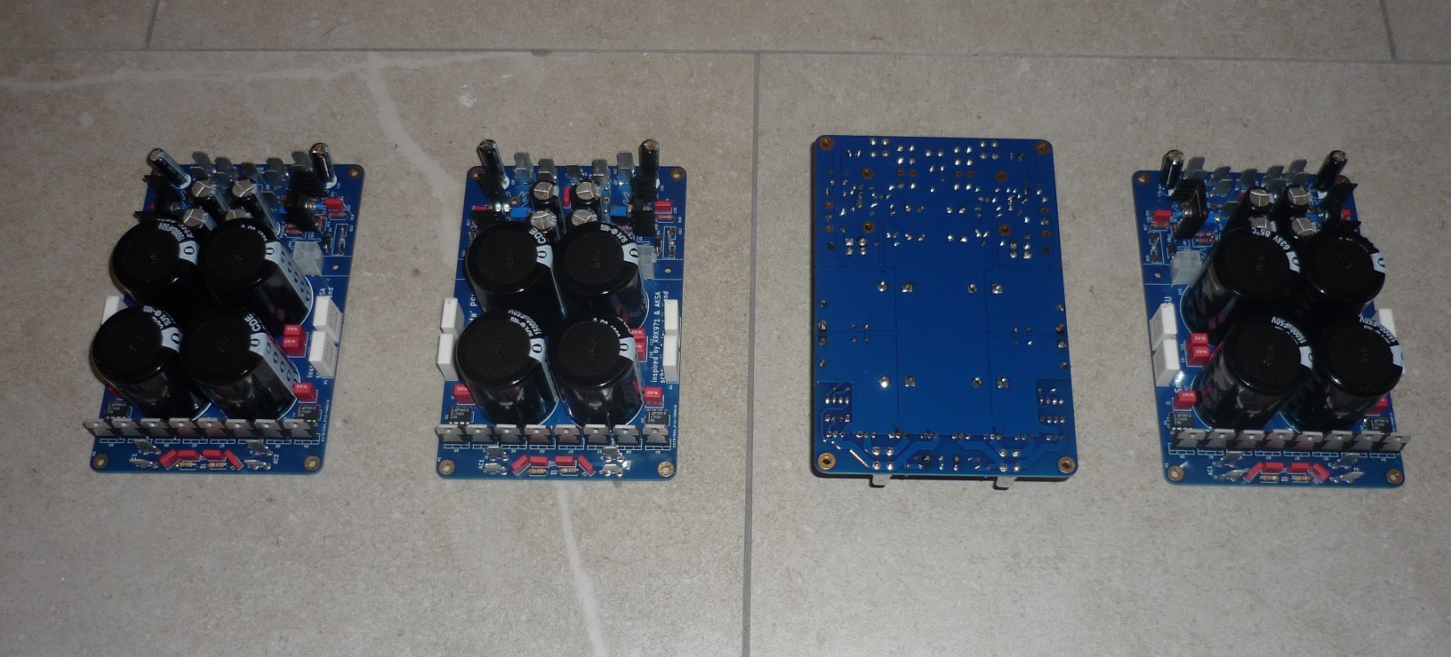

Completed my 4x SLB's ... and cleaned and lacquered the solder side.
Because I was ordering for 4 of them, I was able to get good matches for the same component on the '+' side and the '-' side of each SLB.
In addition, as I had 16x 15000uF caps in all, I was able to closely match the total capacitance on each DC rail.
I was able to get 28,440 / 28,420uF on one pair of SLBs (the same on the ‘+ve’ DC rail as the ‘-ve’) … and 28,400 / 28,390uF on the other pair.
Pity all the caps were 5% below spec, though ... rather than 5% above!
Now I have to create the flying leads for Q10 & Q12 - and then I can test them, to adjust output voltage to 20v, when drawing 3a.
Andy

Hi X, Hugh,
Fired up my first SLB - with my 6.2 ohm load res first between PVout & earth - and then between earth & NVout.
No 'magic smoke' - all that happened was the load res got very hot ... but Q10 & Q12 were both barely warm (on their heatsink).
Only trouble is ... with RV1 & RV2 turned to give the lowest output voltage - I am reading:
* + 21.6v for PVout, and
* - 21.7v for NVout.
(So I probably should've used 16v toroids - not 18v. )
Can I reduce PVout & NVout by replacing RV1 & 2 with a higher value Bourne pot - like 1K?
Given I'm using my AN4R on 2 ohm ribbons ... I don't want to stress it even more by increasing its DC rails above the nominated +/- 20v.
Sure, I know this will increase the wattage through Q10 & Q12 - but as they are barely warm at present ... I'm thinking this shouldn't be a problem?

Changing the resistors (R11 & R12) is a good suggestion, X. I had some 121 ohm reses lying around - so I changed R12 on one SLB.
It was not an easy exercise - due to the fact that this res is right next to the Bourne pot - first to get the original res out ... then get some nice clean holes ... and then put the new res in. So I did it for one, to see if it would reduce the -ve DC rail.
It didn't make much difference! So I suspect your values of 75R and 200R need to be quite a bit higher (to allow for a bit of adjustment) when the DC output of the SLB is only +/- 20v.
BTW, my situation is not helped by the fact that my mains voltage is 247v - instead of the 240v the traffos were specced for! My traffo secondaries were reading around 19.75v, instead of 18v - which would explain the DC rails I was getting!
Anyway, I left all the other 75 ohm reses in place and will live with the DC rails I can achieve, when I match +ve and -ve on each SLB.
However, I might add 3x diodes in series with each DC rail (to drop 1.8v), after I see how the SLB performs, when driving an AN 4R PCB with a 2ohm load.
