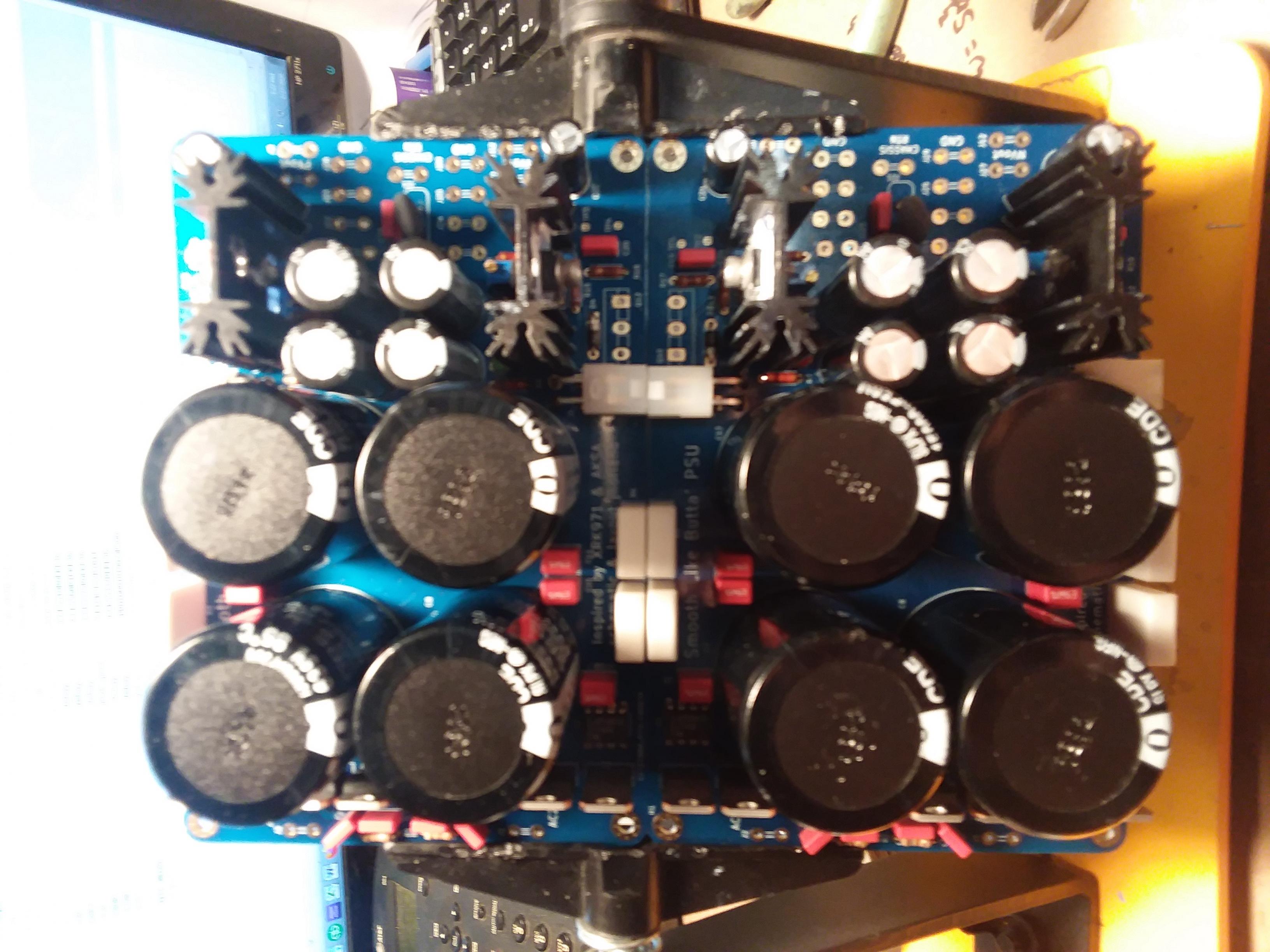

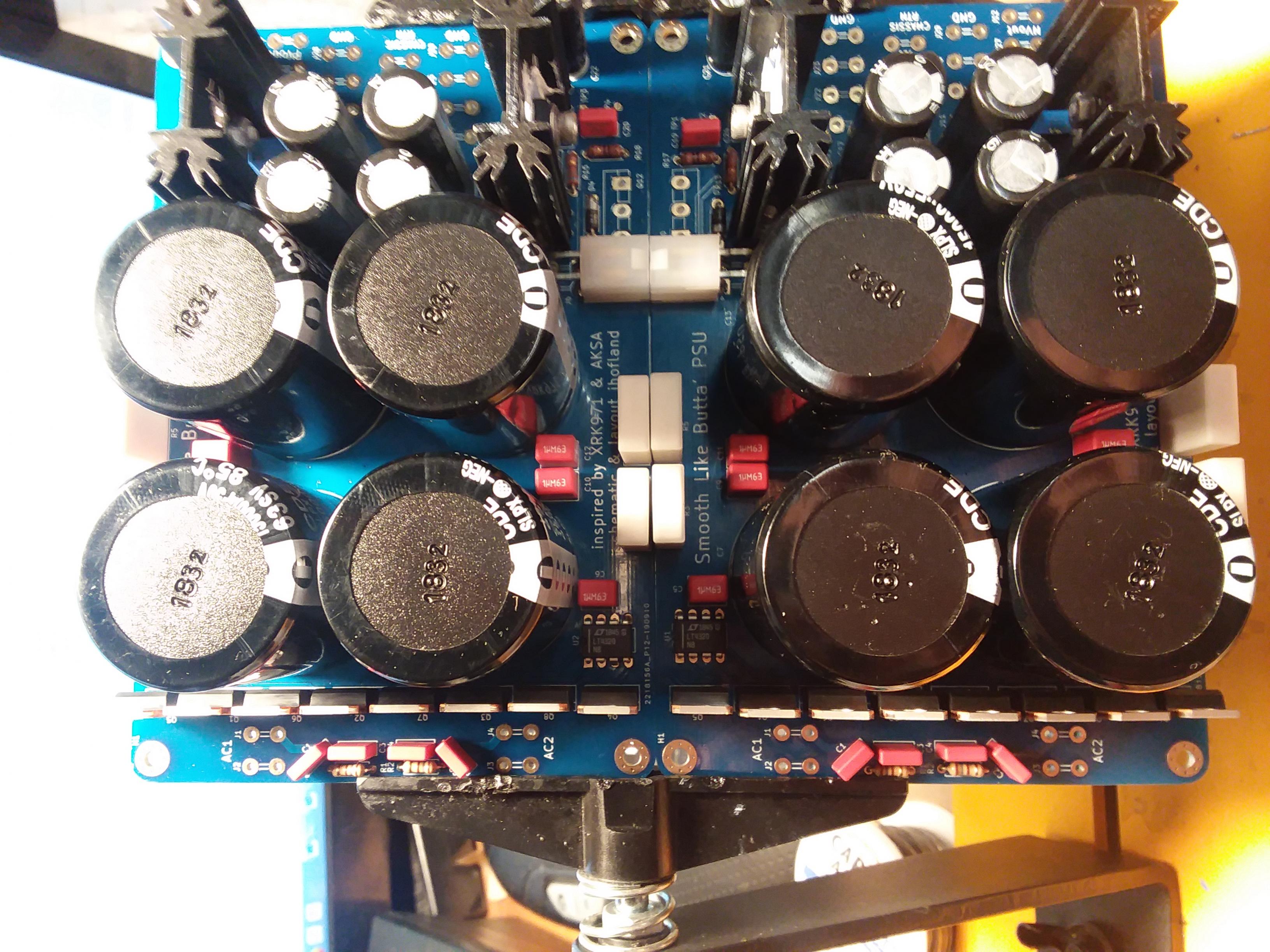

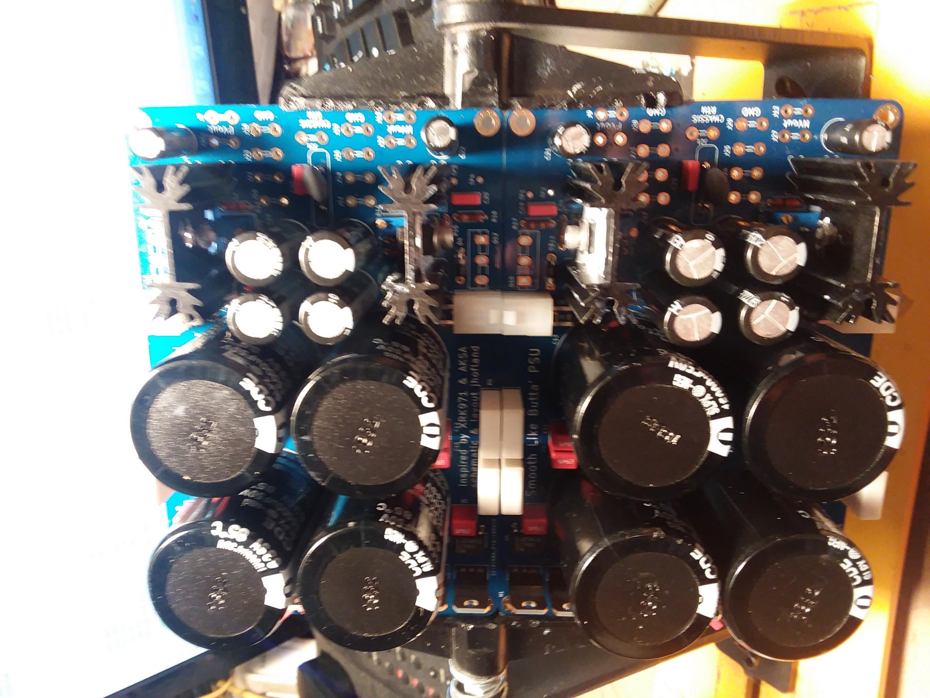

That’s some quick soldering - You are fast TT!
Those were indeed, the final set I had on hand.
Went to breakfast with a friend came back and got to work... it doesn't hurt that those are the 3rd and 4th of the SLBs I have built.
The beer is correct, I been up since about 3:30, so it's just about time for a couple.
I found a slick way to solder all those STP110N8F6 in place. Just drop them all in and sandwich them in 2 masking tape one side about to the bottom of the sink area and the other over to the board. It pulls them all inward and aligns them perfectly. No soldering one leg and adjusting. I did all those in about 10mins. Just make sure you do them before you put in those big mamajama caps.

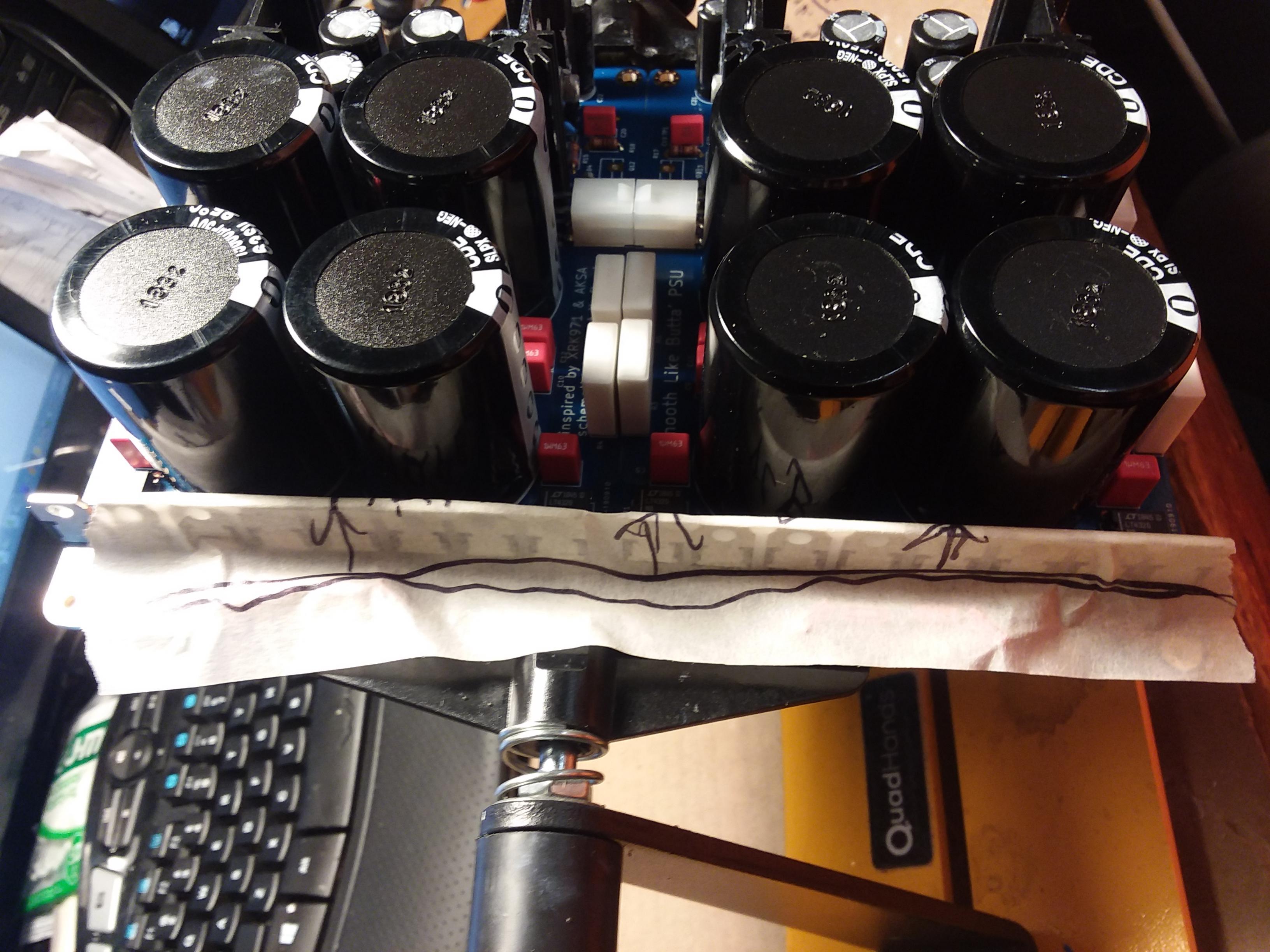

Basically one strip on the 8 metal backs align them flat to one another. Another strip from PCB up to bodies on front, aligns them perpendicular to the PCB. Right?
Group solder
Yes, that's it exactly, stumbled on it and did the centers as you said, but they were all perfect, so I just did one leg on each and moved to the next to prevent heat build-up, when I was done I removed the tape and it's what you see in the picture. No tweaking of any kind... in fact there are a couple not perfect and that was from handling after the fact.
Sorry I didn't get photos, let me tape it off and show, you just remember the large caps are not there...
Okay, here it is quick and dirty, but the extra tape hanging off would be reversed, so it was taped to the PCB where the large caps are... You just take your time when taping, make sure they are all flush and no air gaps in the tape on top.

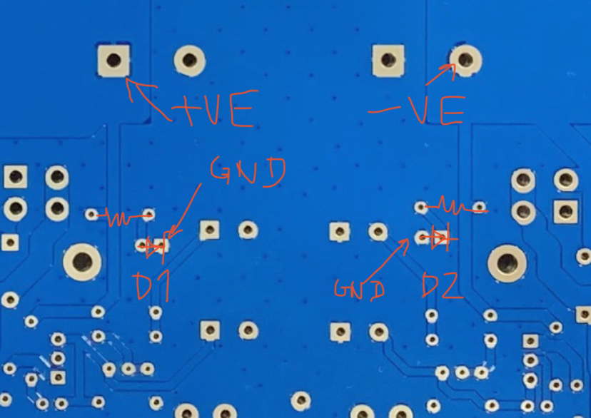

A Qu for anyone who has got a working SLB.
On the dual-rail PCB, D1 & D2 have a square pad in the lower position.
The 'standard' used on the PCB is that the square pad is 'Pin 1'.
Now:
* I would expect that 'Pin 1' would be the Anode
* however, the way the PCB is laid out, I would expect the lower position on both LEDs would be the Cathode.
Can someone tell me the correct orientation, please.

Hi Andy,
You have the board in front of you and you have the schematic, I assume you also have a continuity checker. Please spend a few minutes studying where the traces go from the pads and you can answer all of these “orientation” questions yourself. It’s good to do this in general. Especially when you wire the flying leads to the BJT. You always have to verify the connection is correct yourself before turning on the power. Silkscreens and their designers can have (and will have) errors. This is the only way to help ensure you don’t see tragically avoidable magic smoke come out when powering up the amp. There’s no harm done with the LEDs as they are indicators only.
So flip the board over and you will see that D1 is the LED for the positive rail cap, that goes to the current limiting resistor then D1. Current flows from positive to negative. The cathode is normally marked with a bar on the diode. It makes sense to mark the cathode with a square pad. No one (except on SMT diodes) marks the anode of a diode. But if in doubt, follow the actual trace of the board in front of you. Look back to the schematic and you will see a correspondence.
Finally, it’s only an indicator. Mount it backwards and it won’t light. You then reverse it.
But spending 5 minutes looking at the board in-hand and comparing with the schematic is always the best way to do it. The same questions about pad 1 pin 1 for the BJT is also answered this way. Look at the supply of voltage upstream and which pin it goes to vs the one downstream. Those will tell you where the collector or emitter are (depending on the +ve or -ve).
Hope this helps.
Hope this helps.
Thank you very much for your detailed explanation, X.
The problem is that I am used to Hugh's PCBs - where the traces are clearly visible ... both on top and undeneath the PCB. But, basically, I couldn't exactly see where the traces go on your PCB ... your drawing on the above pic has helped me do this.
Andy
