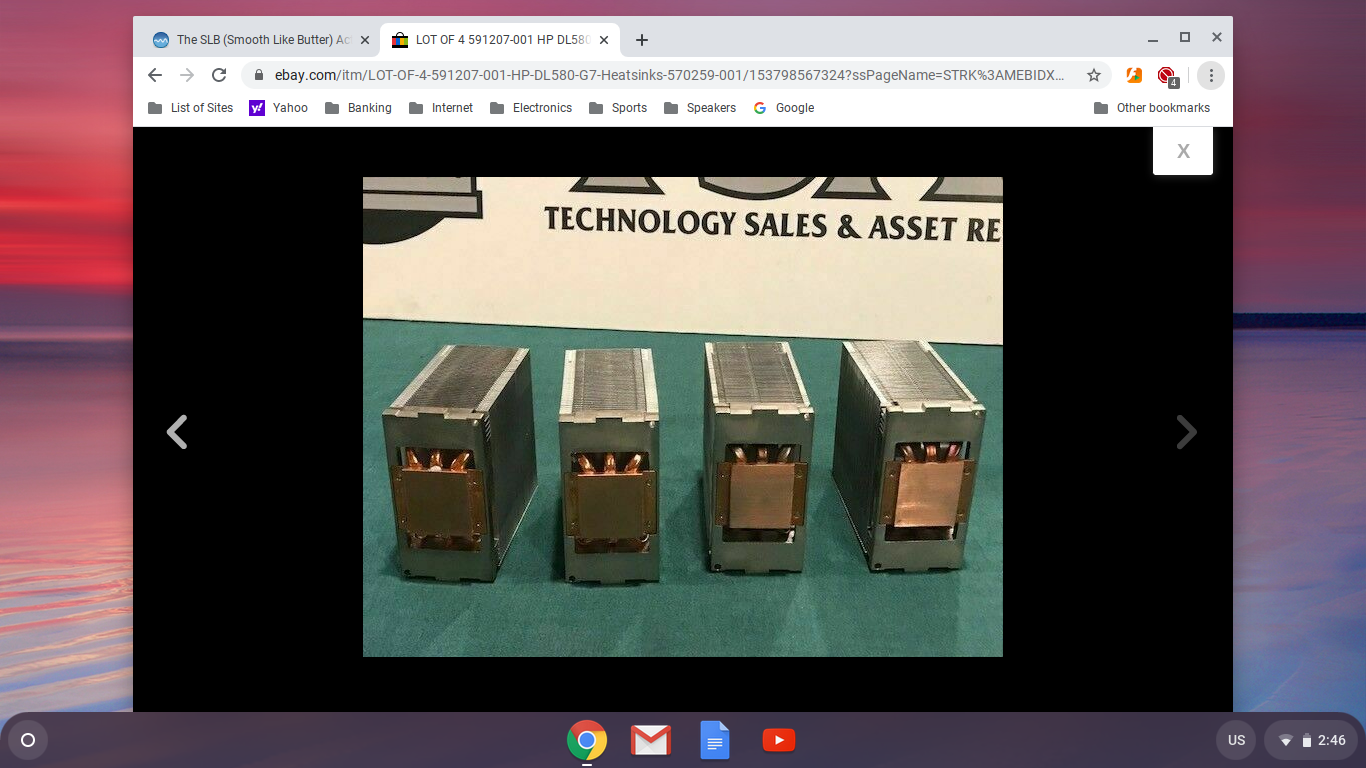

Hi Vunce,
Wish I could find Dell coolers at a reasonable price. Had to settle on the HP heatsinks (like jwjarch purchased). The thermal copper pad is 38mm x 31 mm, so it should be enough room for a mosfet & a BJT transistors. That is, if I am reading the data sheets correctly.😀. Good for around 130W dissapation. Happy building!!

Kokanee,
These HP’s also have a very large copper area. Search for DL580
“HP CPU cooler LGA1567 DL580 G7 DL980 G7 591207-001 570259-001”
LOT OF 2 HP LGA1567 CPU Heatsink for DL580 G7 DL980 G7 591207-001 570259-001 39517463831 | eBay
Hi X,
Those are the models that I purchased. I asked the seller the dimensions of the thermal copper plate. The seller replied with 1.5" x 1.25". I will see when they arrive. Pretty confident they will work. The Dells are getting hard to find in N.America at a good price. Shipping from China is crazy.
MM
MM
Ok, good. I think they will works fine. They are nice in that they don’t have a long heat pipe poking out like the Dell’s. With a 120mm Noctua fan, you will be fine even up to 160w would be my guess.
