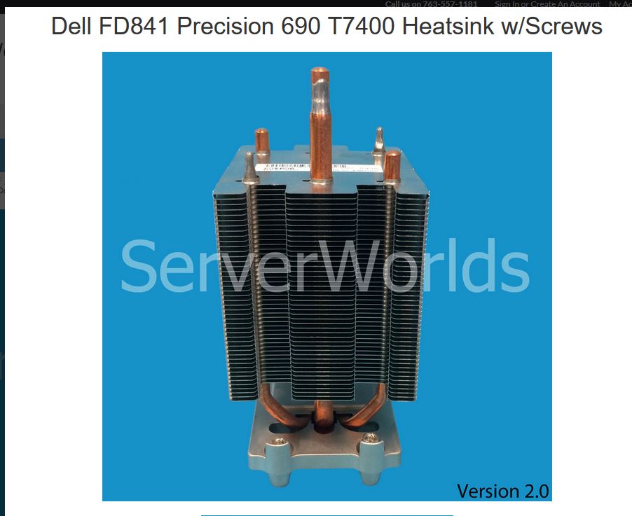

I looked up the Dell FD841; they look excellent - but the Dell page is unhelpful (there are no dimensions! :mad: )
Are you able to give me the dimensions of the fin-bank (ie. the horizontal dimensions of the floor real-estate that each cooler will take up)?
Also the height from the base of the pad to the top of the central (tallest) copper pipe.
I presume you mount a fan alongside the cooler stack?
One point: I notice from the picture on the website - attached - that the 4x screw holes have a pillar on the underside of the cooling pad.
I presume the length of these pillars is less than the thickness of the MOSFETs?

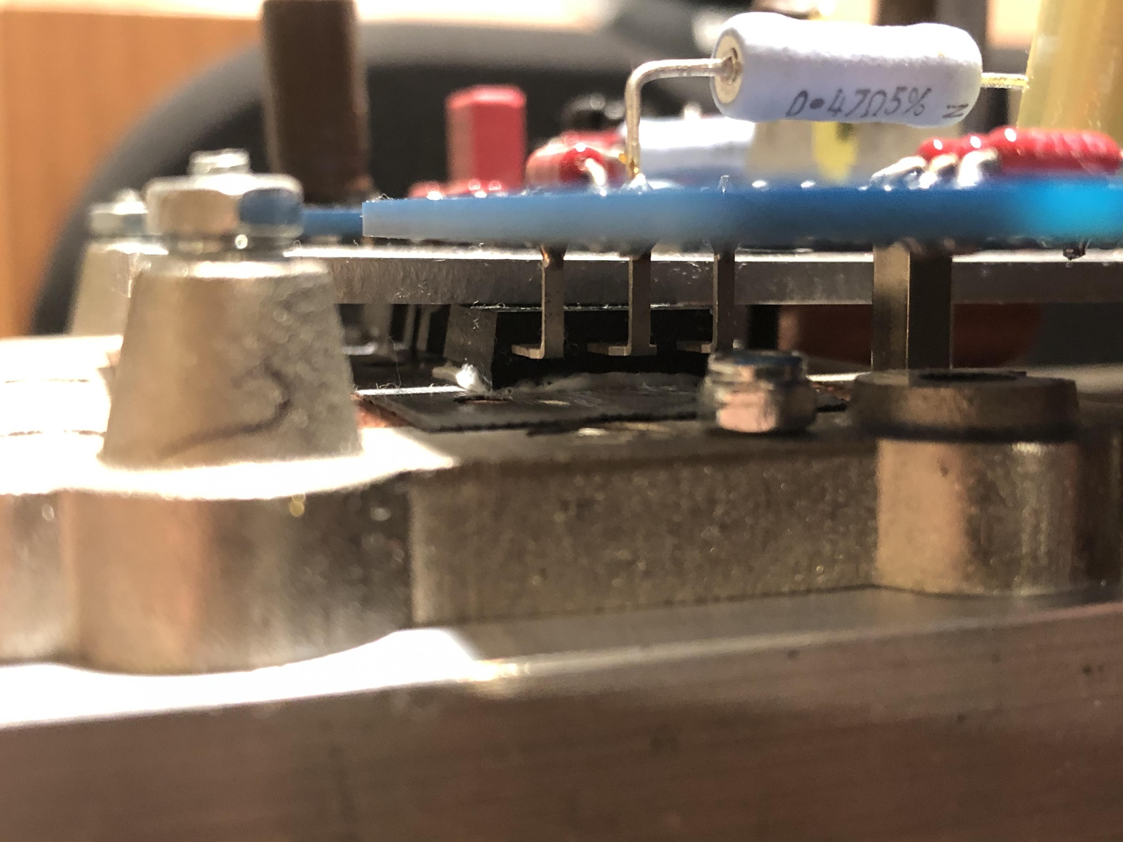

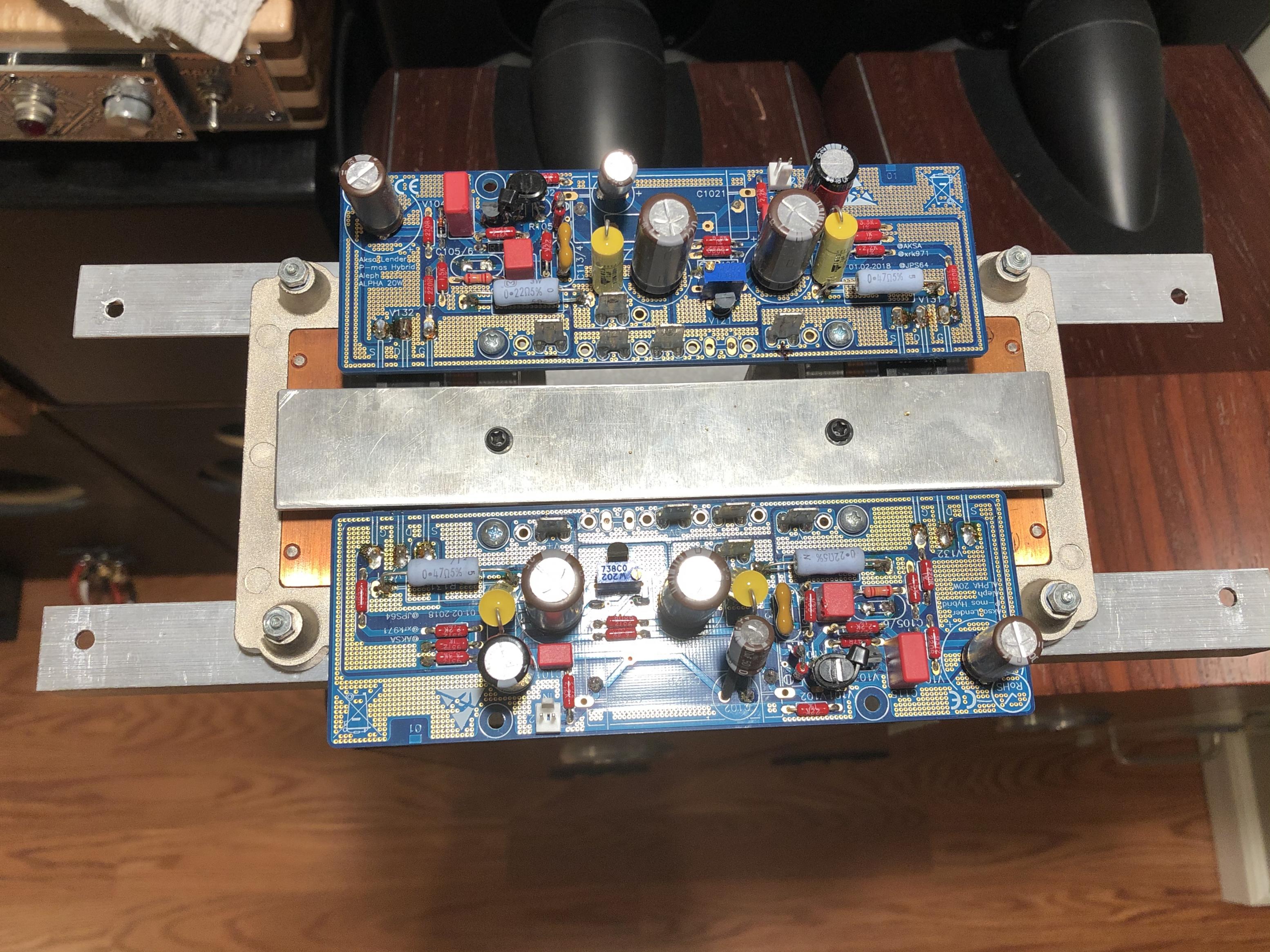

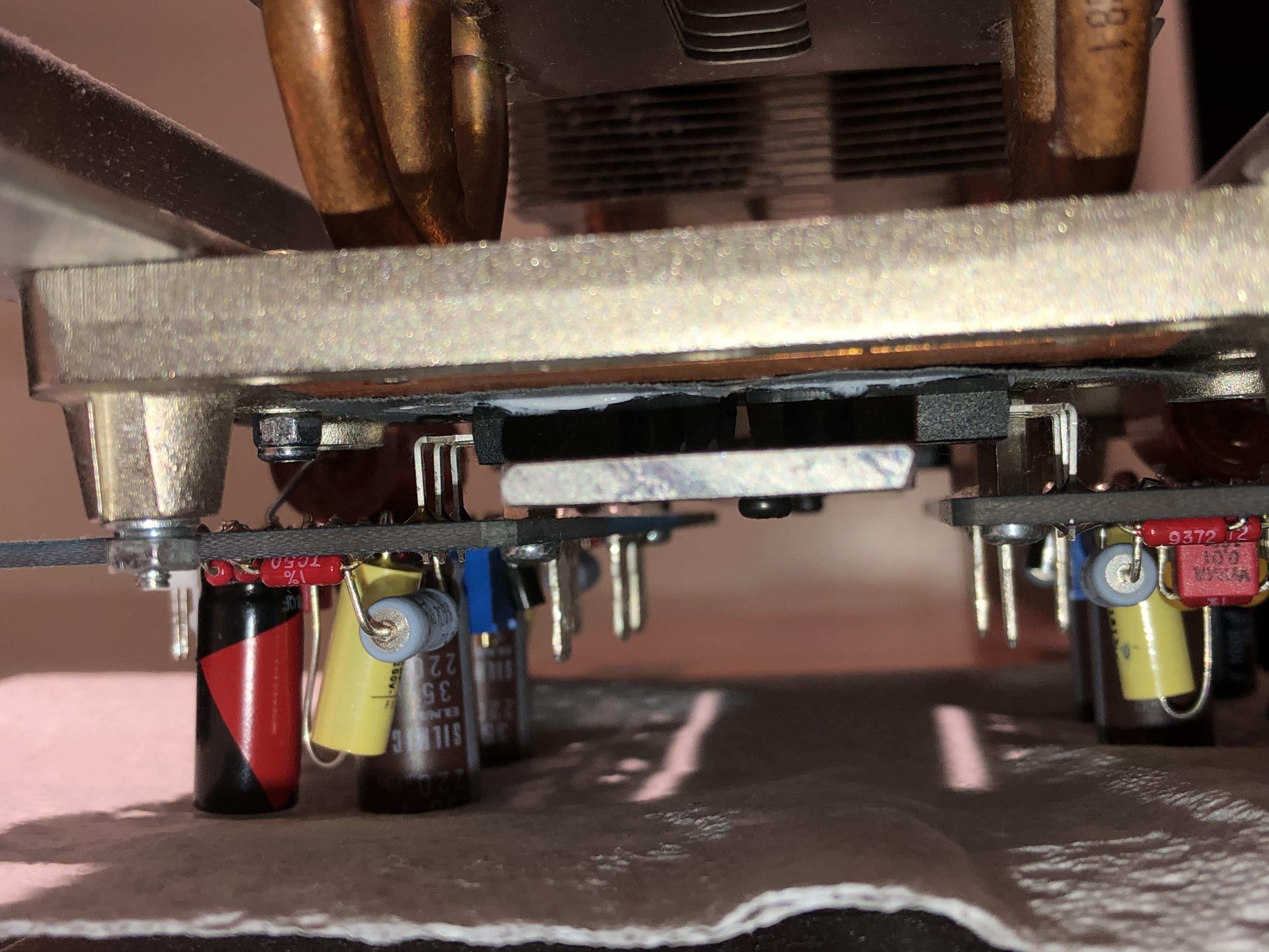

Dell FD841 dimensions (close approximation)
6.5” - Total height (to tip of pipe)
3”w x 3”d x 3.25”h - aluminum finned size
3.75”w x 2.5”d - aluminum base
45mm x 63mm - copper mounting pad
The attached pictures are my Alpha20 modules mounted opposing each other so two mosfets are on each cpu cooler. Aluminum flat stock is the holding clamp down the middle. Attachment points to the coolers are drilled/tapped in the aluminum that surrounds the copper pad.
These coolers can really dissipate heat well, with Noctua fans 130watts is no problem :cool:

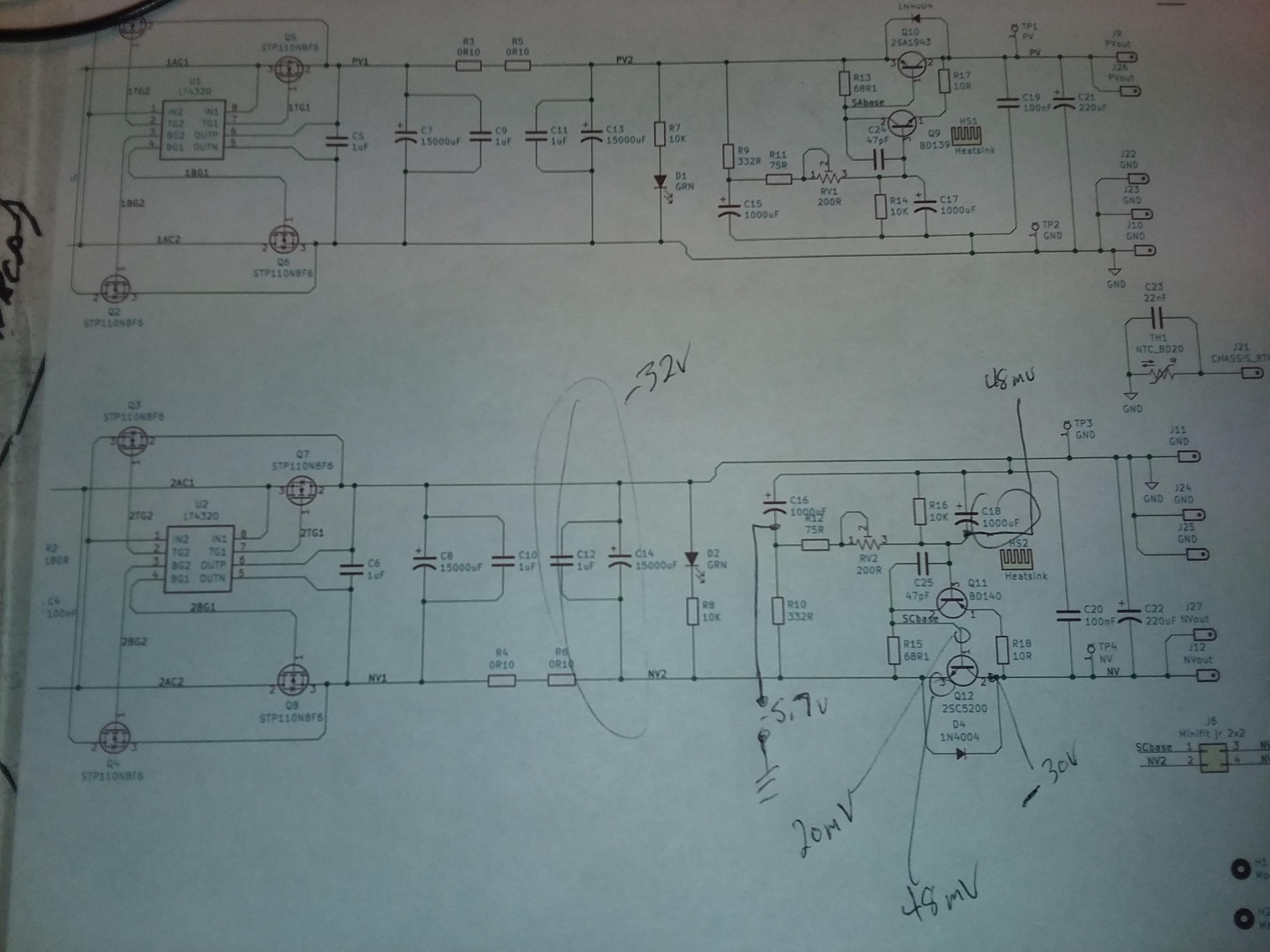

Hey X and everyone... have a bit of an issue here. I'm not getting any voltage on the Q12 side, the Q10 side is fine.
To date:
Checked to make sure on orientations
Went back over all parts and checked values.
Went over all soldering...
Both board led illuminate
Nothingsmoked :)
I do have one working board (Mono build) and I'm seeing some strange values in comparison to the working board. I know "strange values" doesn't help, but the values are in the area of Q11 and D4
Both test points to ground give me close to zero
Nothing on ground to Nvout
Pvout is at 29v
We can rule out Q12 as I dropped in the other supply with the same Q10 & Q12 in place and both sides work fine.
I put some power on it and got -30v on the collector of Q11 about 12mv on the base and zero on the emitter.
Help me with a test procedure on this if you would. I have a feeling it's Q11 & or D4, but I would like some help with diagnostics, before I order more parts.

Sorry you are having trouble. you can help us diagnose by measuring the voltage (relative to GND) of each node of interest on the circuit. Write those by red pen on a printed out schematic and take a photo of schematic and post it here. Also, a closeup detailed photo of the board from a few angles so we can see components will be helpful.
By nodes of interest, I mean voltages on each 3 legs of the two transistors, voltages at C16 (negative pin), rail voltage at C14.
Having no voltage and no smoke means that the big BJT is not turning on. It is probably still good. So this may be a bad Q11 or incorrect part for Q11 or Q11 installed backwards, or a bad value on one of the resistors R10/12/15/16/18. A bad (open) diode won't hurt as it is there for protection, a shorted diode will smoke. But if unsure, pull it out and test it. A bad pot RV2 (open circuit) will also prevent this from working. Finally, double check the pinouts of Q12 from the PCB to the actual transistor. There are 3 wire, 4 pads, and two connectors - lot's of room for a mistake or maybe the wiring diagram for the connectors might be bad. Are you sure you an NPN there (TTC5200 or 2SC5200)?
Since I have a good working SLB I dropped it in with the same Q10 & Q12 and it worked perfectly, so we can rule out Q12 as a problem. Also, the orientation is okay on Q11 and verified the correct part. I did measure the values on Q11 on both the bad and good board.
RV2 is okay as well. All resistor values verified, but not removed and tested.
I get -30V on the collector and a few mV on the base and nothing on the emitter.
I pulled Q11 and tested it I get PNP hFE 215 Uf=608mV
