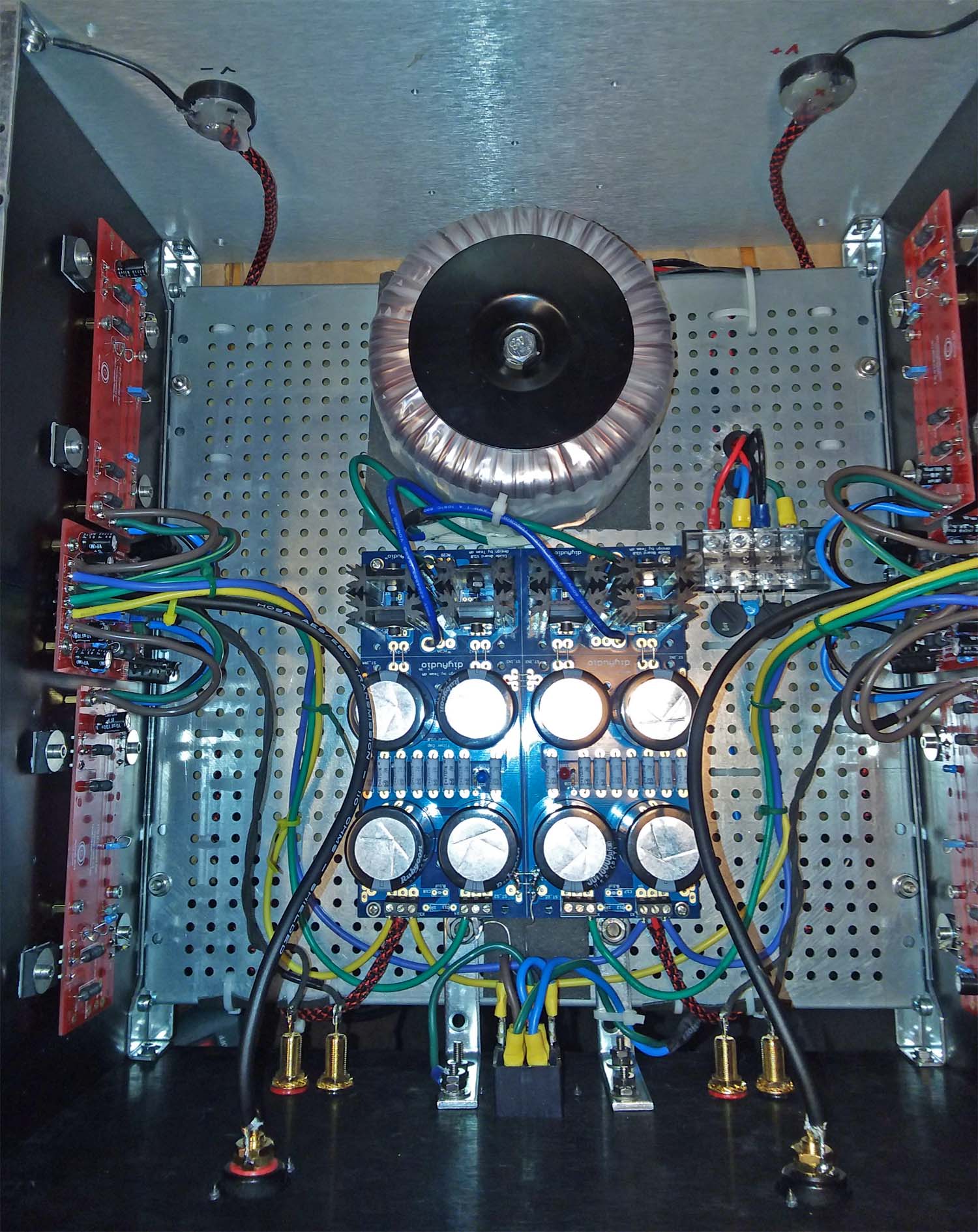

Andy, do you think because I build at a frenetic rate that it makes me sloppy? Here's the F5T I built for a friend for Christmas, it was my first NP build.
I take pride in what I build, there are other factors of this build and board, which have bearing, but I will figure it out with help from my friends. If you have anything constructive to add, that would be great!
Anyway, I will re-post when I have better data and would appreciate any thoughts you may have... In the mean time, check out my lack of measuring and haste to build the F5T.
JT
I wouldn't say 'sloppy', TT - but it seems to me that a frenetic pace has a higher chance of creating errors than a measured pace. 🙂
My sincere congratulations, TT, for building a working F5T! :superman:
