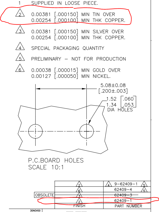

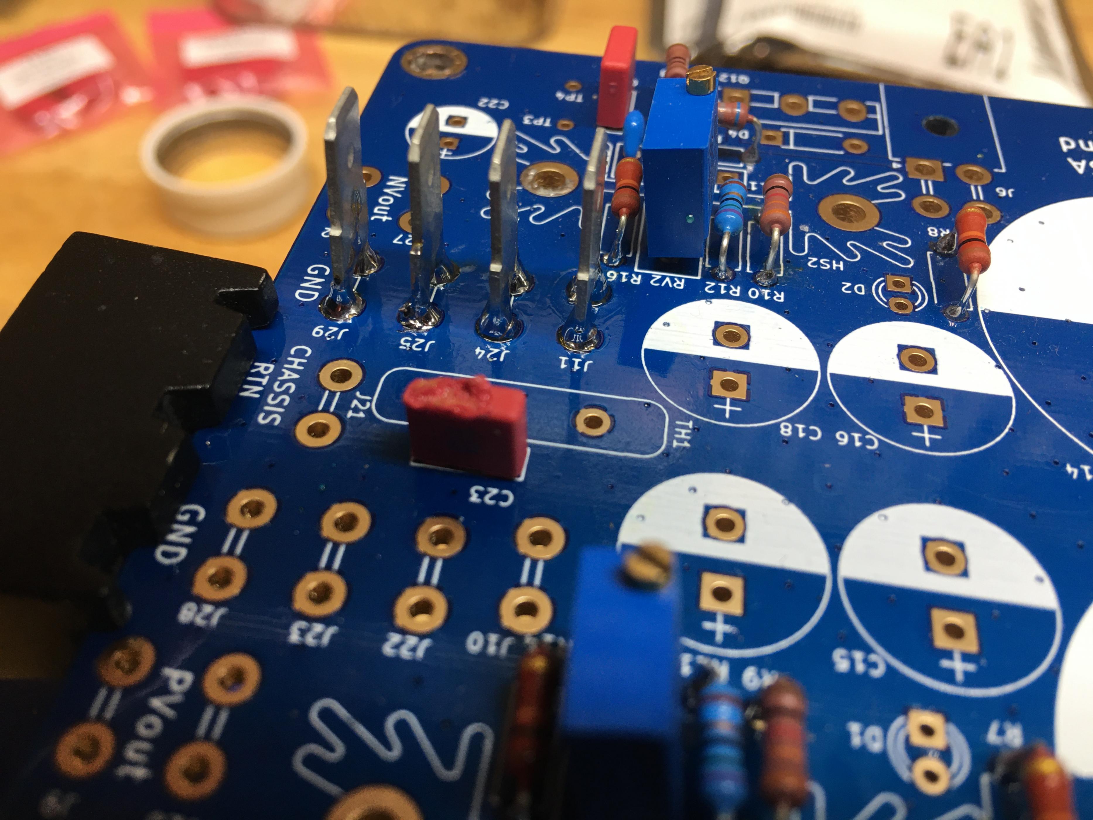

I just noticed something when I tried to use cheap no-name spade terminals (probably bought from Aliexpress years ago). They would not take on the solder easily and got all gunked up with burnt up flux yet the solder would not stick. I removed it and used a genuine TE Connectivity AMP Faston brand spade terminal. These are precision made with thick solid copper core and silver plated. They heat up instantly with my soldering iron and the solder wet the part and the pads and flowed nicely. Huge difference. If you notie difficulty soldering the spade tabs, I can highly recommend genuine Faston brand. $0.17ea but well worth it.
62409-1 TE Connectivity | Mouser
CAD drawing showing material composition (copper with silver plating):
https://www.te.com/commerce/Documen...cLang=English&PartCntxt=62409-1&DocFormat=pdf
I buy these as well and have no problems.
Unfortunately according to the hard to read data sheet the silver plating (3) is obsolete (bottom right hand corner).
Also in one area of the data sheet it says the material is brass and in another it says copper.😱
I hope you're right because the data sheet, if I'm reading correctly says tin for 62409-1.
