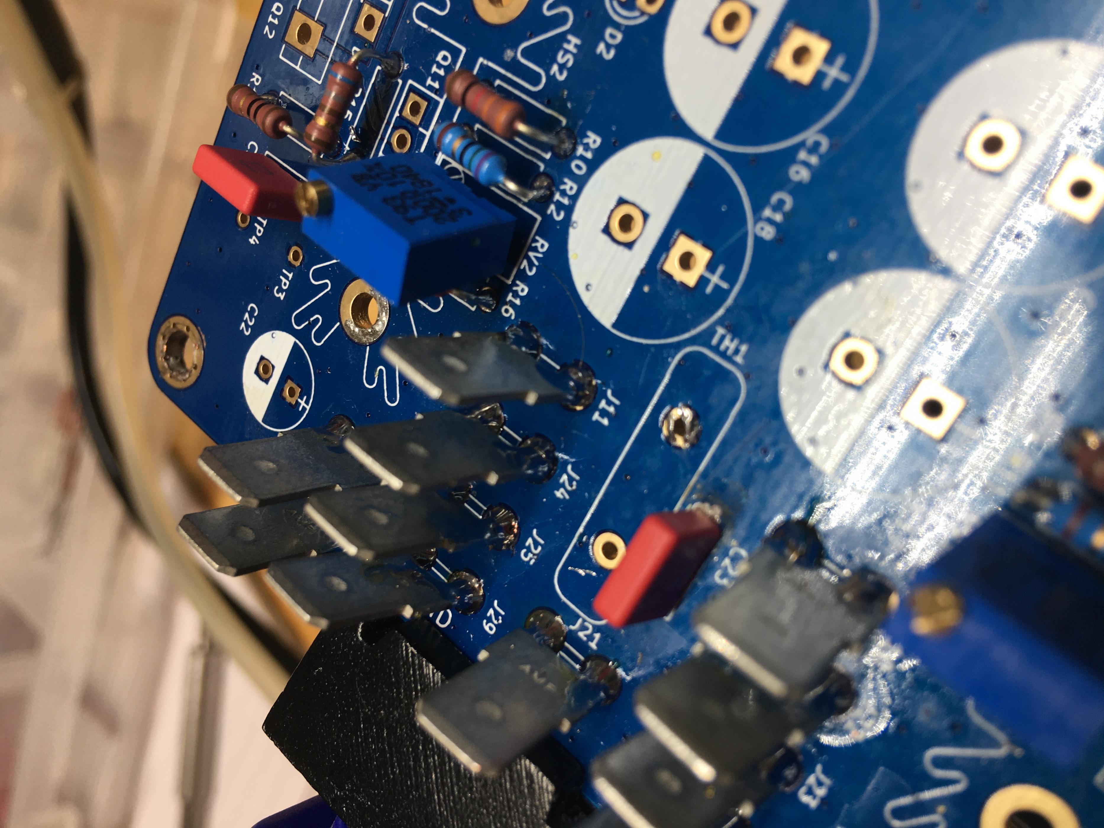

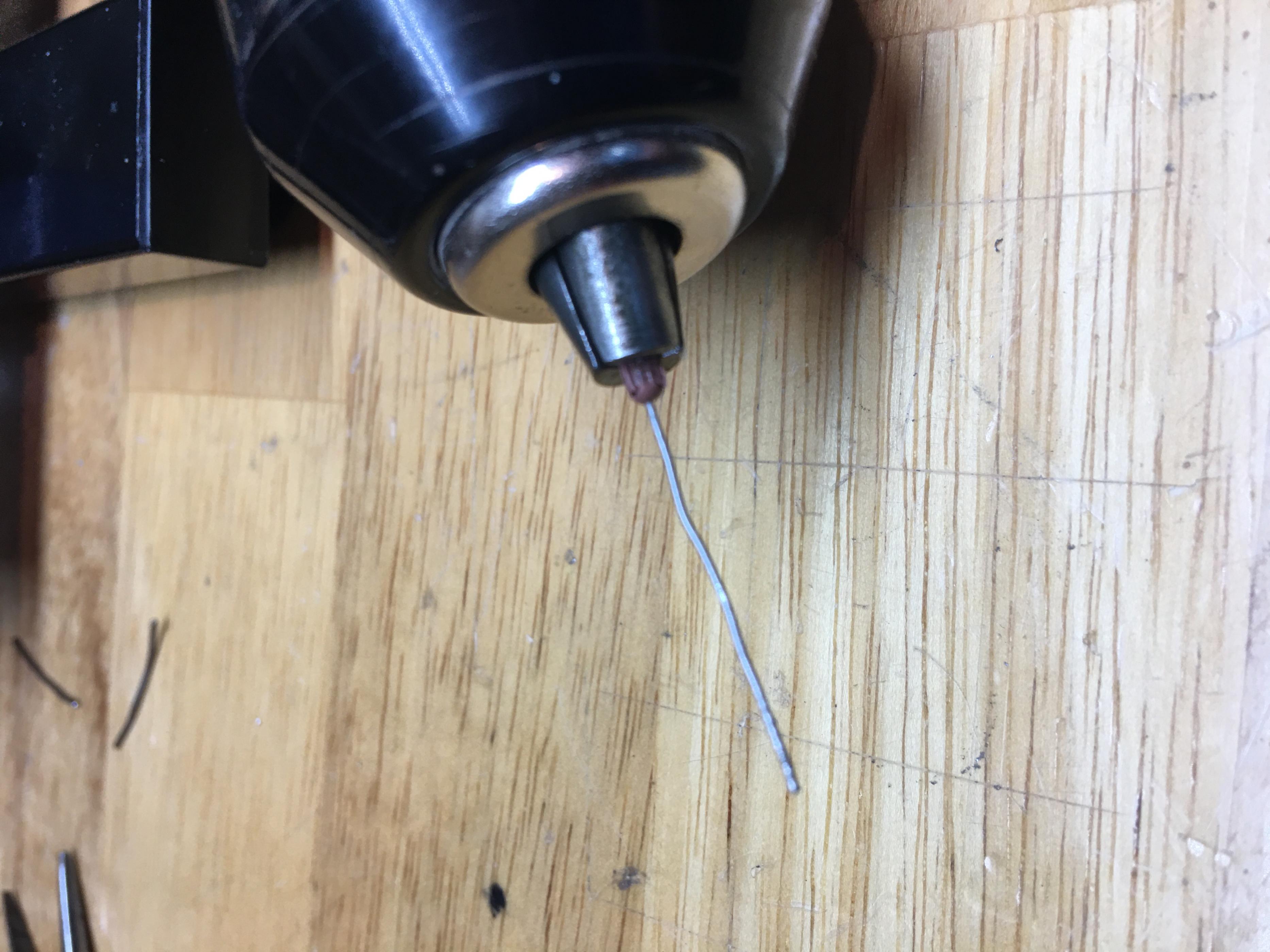

Success!...I think. After MANY attempts I was able to remove enough material from the eyelet to install the new part. However, I damaged some of the solder mask around the eyelet on both top and bottom by "walking" the de-soldering tip back and forth.
In the end I used the smallest soldering tip I have and applied heat to the eyelet through the top. At the same time I was pulling with with the de-soldering tool from underneath. Both machines were at ~800°F. This removed 90% of the material. In order to remove enough of the remaining material I did this:
Cut one lead off an RN55 resistor and inserted the body into a drill (chuck). Cut the other lead at an angle and used it to bore (as in drill) out the eyelet. Many resistors were sacrificed honing in this technique.
So the new part is in, will the damaged solder mask be a problem?

Solder mask is there to prevent solder bridges. As long as you check for no bridging it is fine.

Check for continuity from C23 to TH1 per the schematic... You could have also just soldered C23 on the bottom of the board to each lead of TH1... just saying. 🙂

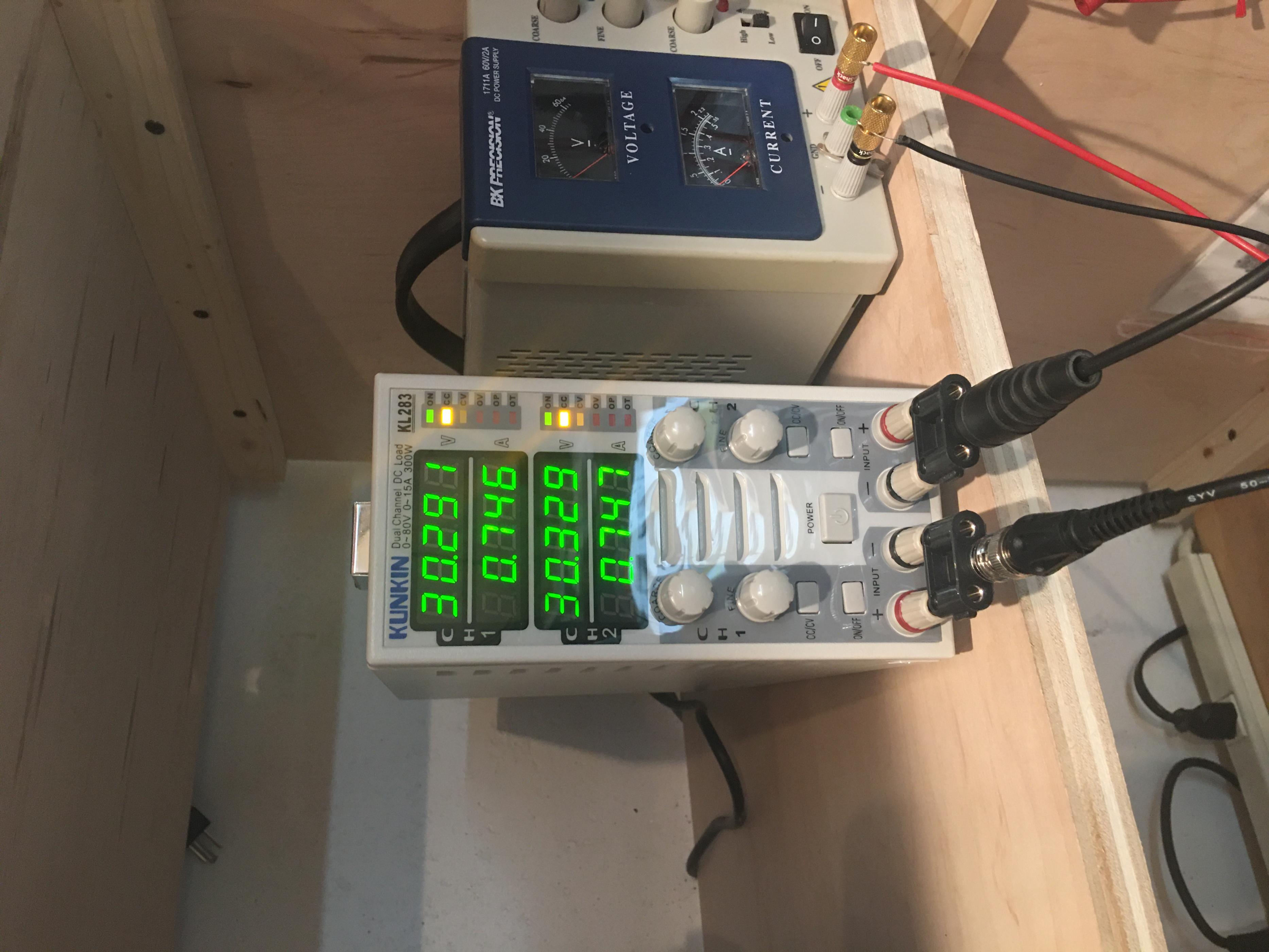

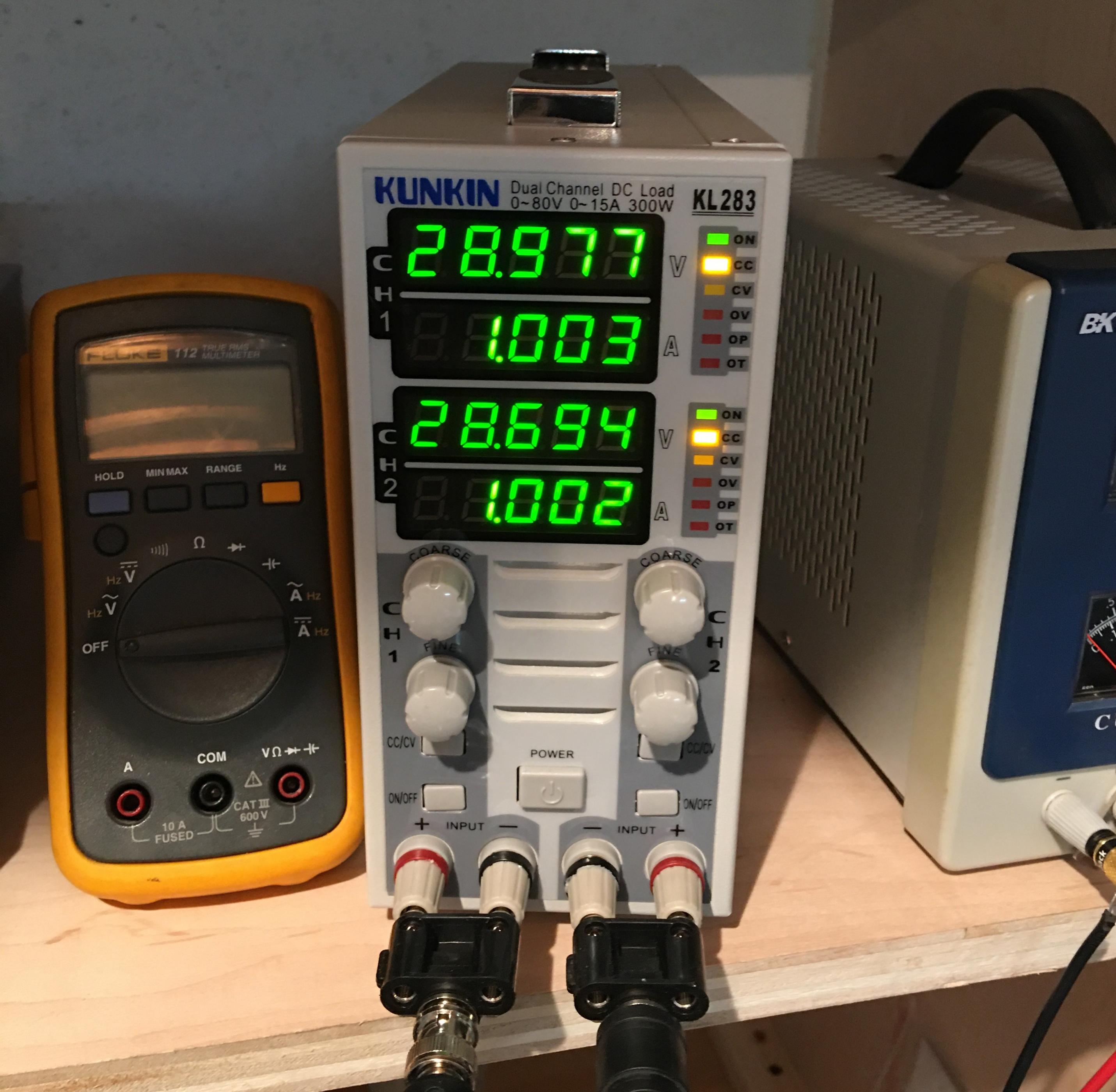

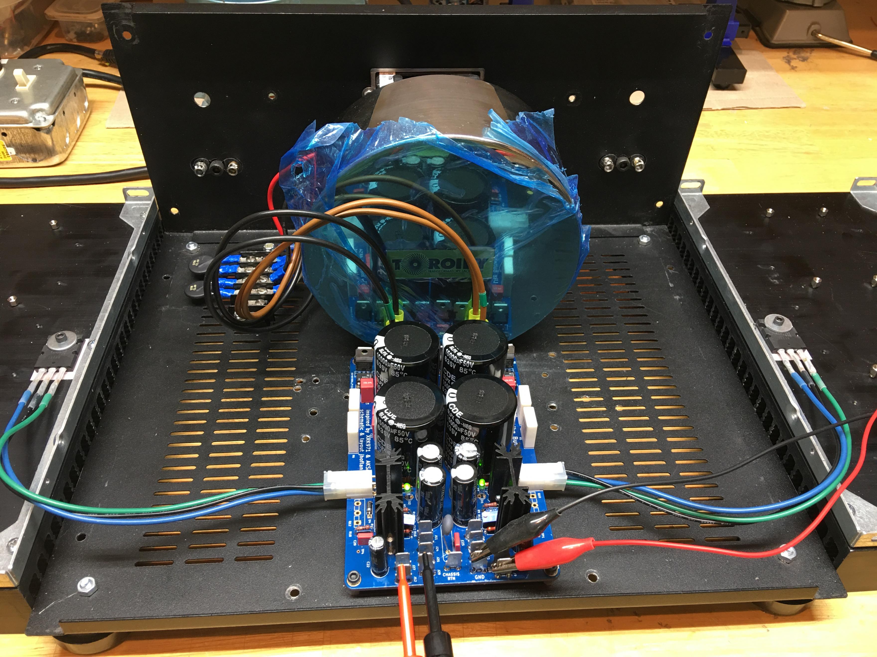

22V 400VA. I have it loaded down with the electronic load pictured. I have ~31-32 unloaded.

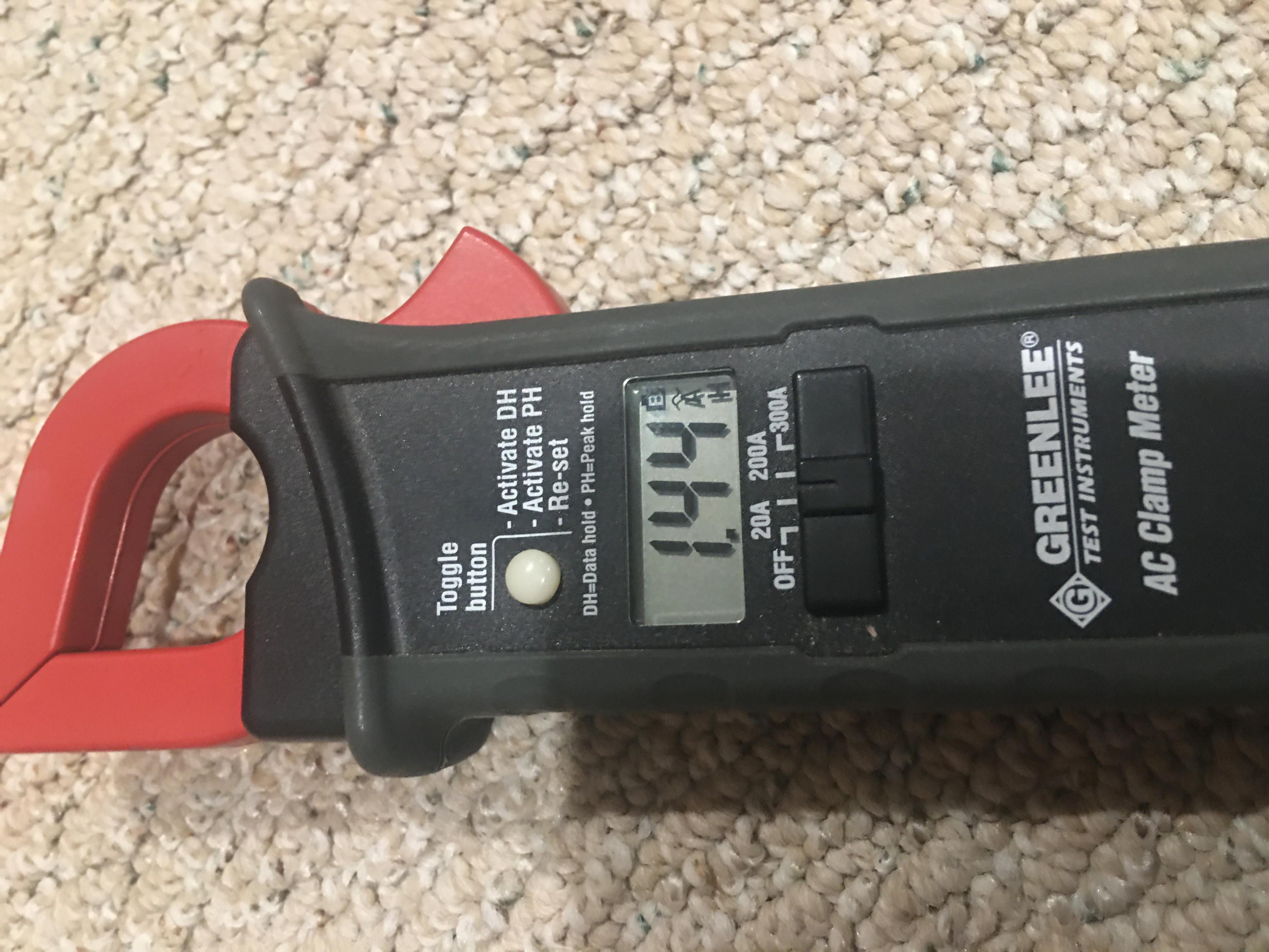

I’m not familiar with the current draw of the M2X? I know this is dangerous, but I’d assume it’s around 1.4-1.5A.
Thanks for jogging my memory...I have a clamp meter right in my box. I measured 1.44A. So if I set my load to 750mA on both channels, one connected to the positive rail and one connected to the negative rail, this would simulate the ~1.5A load of the amplifier boards, right? That would give me the voltage (~30V) which would go the the M2X boards. Now, is the M2X with Norwood boards happy with 30V.
Most Pass 25w Class A amps are biased at 1.25A through plus and minus rails. For stereo that is 2.5A. If you want to simulate a 2.5A load at 30v that’s Ohm’s law. V=IR.
R = 60V/2.5=24ohm resistor that can handle 150w.
Connect positive and negative outputs across the 24ohm dummy load and you have simulated your M2 as a load.
