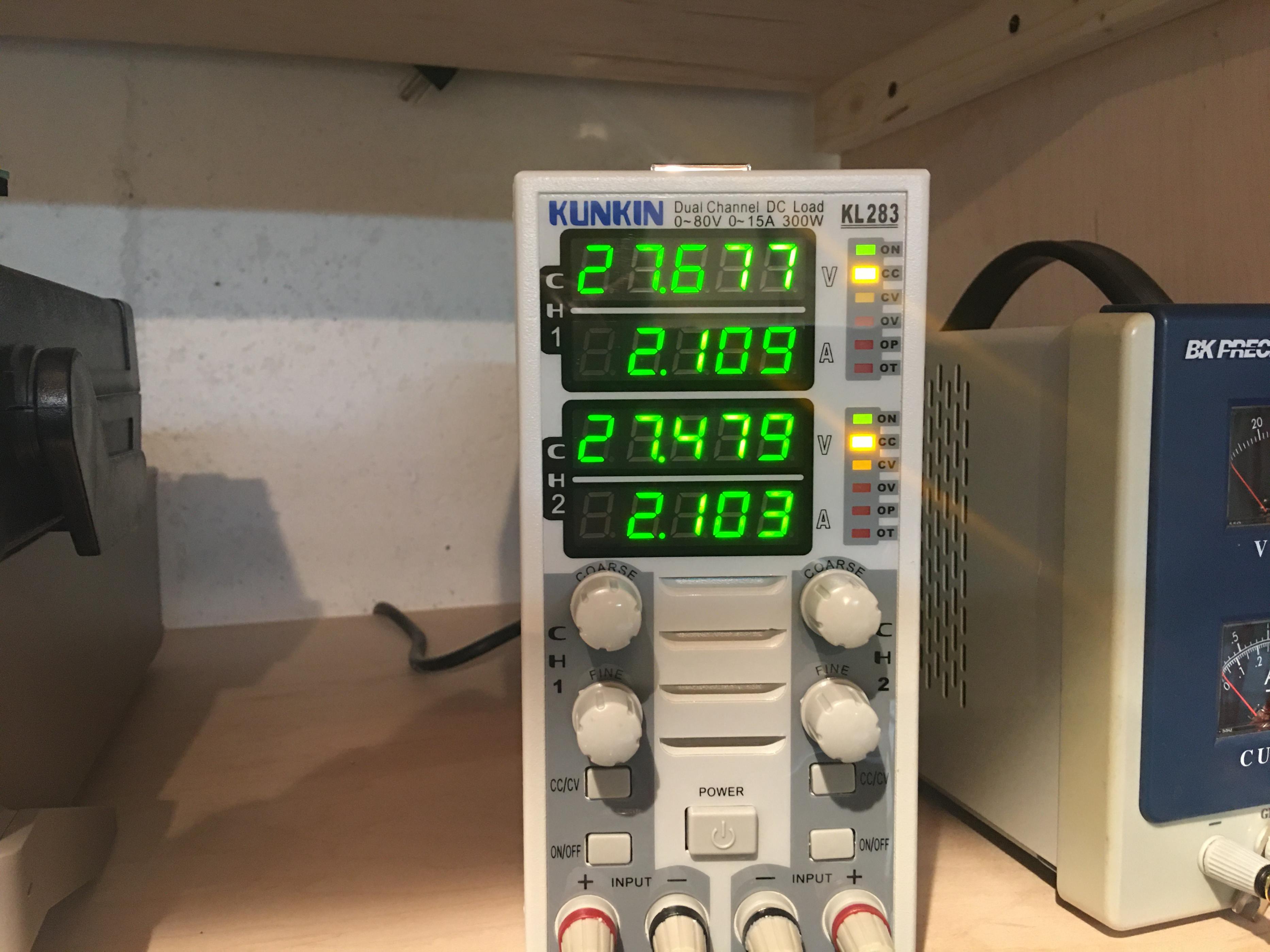

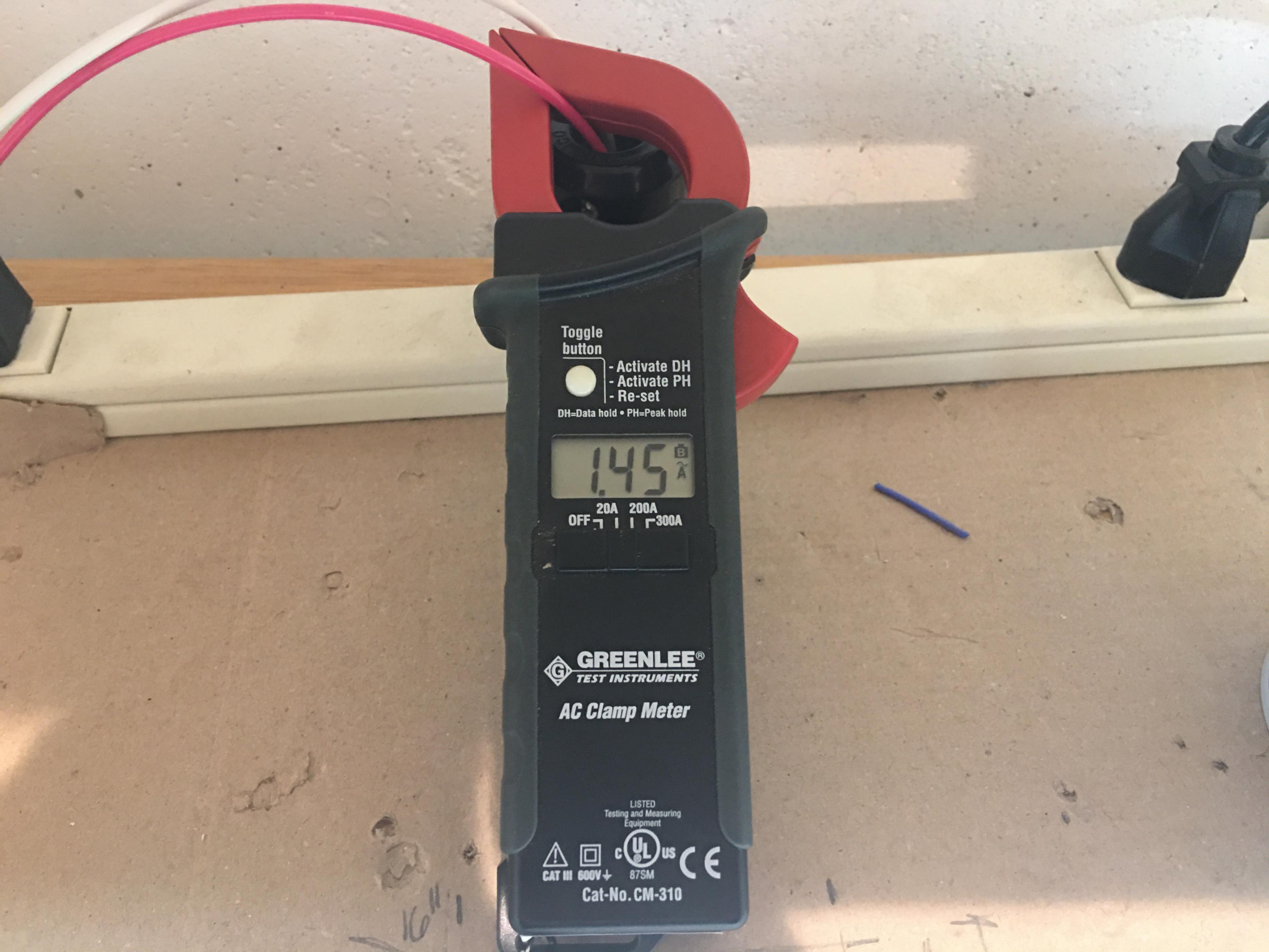

On the amp I'm assembling with the SLB, I loaded the power supply to 2.1Adc which in turn draws 1.45Aac from the mains line. This simulates (and matches) the mains current draw from a working M2. At this load I have 27.5Vdc coming from the SLB. All this to determine whether the M2X can withstand the output voltage coming from the SLB (27.5V).

With the M2X boards connected the voltage drops to 27Vdc and it draws 1.85A from the wall. The amp seems quite happy at this voltage with heat sinks running around 50°C. All capacitors are rated well above 27V. The amp sounds wonderful, is much quieter, and seems to have deeper bass then with the previous PS.
Yup, that's about what I see too, about .5V less than what you figured. Temps right on par with mine too.

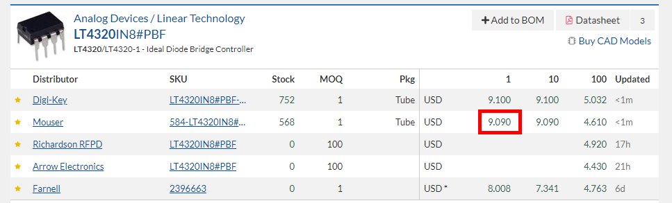

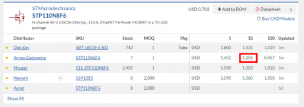

If you get rid of the pricey controller ICs and the numerous MOSFETs, you can save ( (2 x $9.09) + (8 x $1.26) ) = $28.26 .

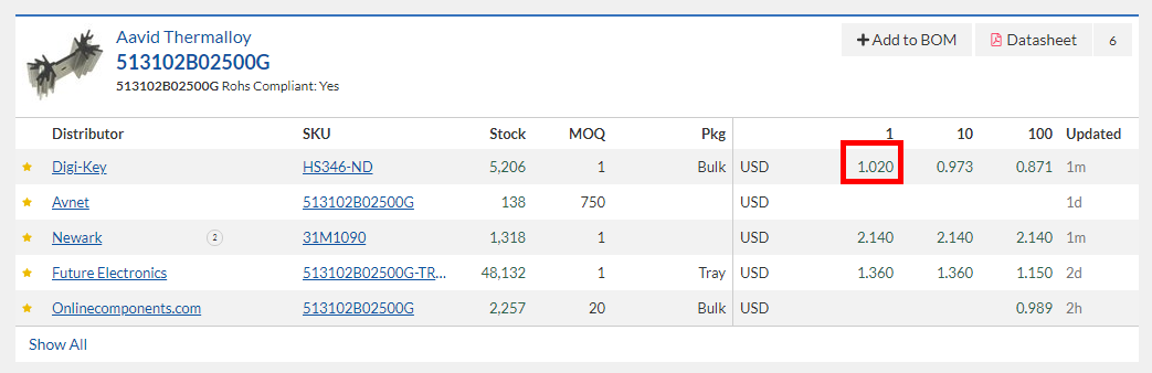

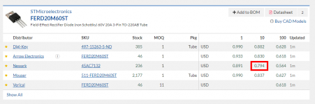

If you replace them with low-but-not-zero-forward-voltage-drop diodes like the FERD 20 ampere parts, you save money but lose 2 x Vfwd volts of headroom. I think there's a very good chance that the FERDs in TO-220 packages would run cool enough without heatsinks, to remain within their datasheet Absolute Maximum junction temperature rating. But to be extra extra cautious, you could mount two diodes per heatsink, using one of the excellent extruded aluminum heatsinks by Aavid.
The diodes cost (8 x $0.80) and the heatsinks cost (4 x $1.02) which totals $10.48 .
So your net dollar savings would be $17.78 ... but you lose 2 x Vfwd volts of headroom. I've attached the diode datasheet so you can calculate the exact number of millivolts Vfwd represents, in your personal situation "on Class D/H amplifier".
