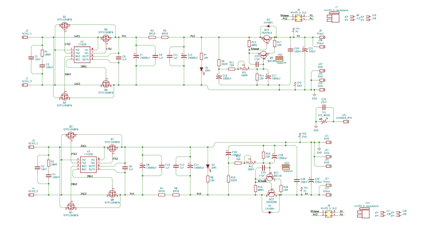

I have an annoying problem with the -ve rail of one SLB in my 2nd AN - which is stopping the amp from working. So I'm hoping I can get some suggestions as to how to find out which component has "gone bad". 🙁
When I switch on, I get:
* +24v on the +ve rail (instead of about 22v), and
* only -0.4v on the -ve rail.
However, both the green LEDs (D1 / D2) are lit.

Hi Andy,
Please measure the voltages at all major nodes in the circuit (each pin of each transistor) and redline a schematic with those values. That way, we can troubleshoot with you. It’s like going to a doctor when you are sick and don’t know why. Dr needs diagnostics: vitals, bloodwork, xrays etc.
So far, we know the negative rail is sick.

Hi X. OK, measurements as follows:
* traffo input to the -ve rail: 19.49 AC
* 2SC5200 pin 1: -26.9v DC
pin 2: -25v DC ... and dropping
pin 3: -26.9 DC
* BD140 pins 1 & 3: -26.7
(can't safely get to pin2.)
Andy
PS: Just now, I measured pin 2 of the 2SC5200 again - which is the -ve out voltage - and got -0.25v!! 🙁

It’s a slow effect. Look at your electrolytic capacitors C16, C18, something may be bad and takes time to show up. Looks like maybe a 30 second time constant?
What are other voltages when it goes bad? We need to know the voltage at the node of pin 3 of Q11.
Also accessible via the other parts connected to it. R16, C18, RV2.

This time around I get a different scenario for pin 2 of Q12 - but one which aligns with what I measured when I discovered the other day that there was something wrong.
Q12 pin 1: -27.06v
Q12 pin 2: -0.2v, rising slowly. After ~5 mins, it had reached -2.7v!
Q12 pin 3: -27.06v
Q11 pin 1: -24.8v
Q11 pin 2: -26.6v
Q11 pin 3: -25.2v
Now I know the voltage at Q11 pin 2 should be the same as Q12 pin 1 - and it's not, according to my measurements. All I can suggest is ... this is because of a time difference between the 2 measurements?
Andy
Hello Andy,
From the voltages you are showing, assuming that Q11 and Q12 have not failed, it appears that there is no current through 10 ohm resistor R18. If that is the case there won't be any collector current through Q11 and Q12 won't conduct at all because the base and emitter are at the same potential. I would remove at least one side of R18 from the board and measure its resistance and I would carefully check the solder joints for it. If it was intact I would expect 2.7 amps flowing through it and either it or Q11 will fail.

Hi Jan,
As I'm waiting for my new soldering iron, I couldn't unsolder one end of R18. However, I did measure across it - and R17.
Now in my build, R17 & R18 were ordered as 2.21 ohms - not 10 ohms. I will have to check back through my emails but the only reason I can think of why this happened is that I must've been advised that - for an SLB for an AN 4R - these reses should be reduced to 2.21 ohms, because of the higher bias current (3a instead of 1.7a).
@Hugh ... can you remember telling me this?
Anyway, the meter said R17 was 2.5 ohms but I couldn't get a reading for R18. iow ... it was zero ohms!
That ties up with what you said, Jan, right (there is no current flowing through R18 ) - it must be a short-circuit?
So if I replace this particular, failed R18 ... the SLB should work properly?
