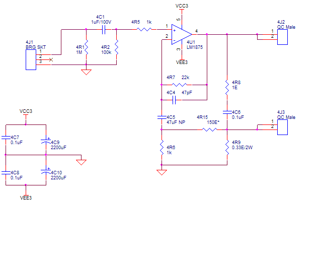

Hello xrk971. I was wondering if you think the SLB PSU would work for a transconductance amp. Schematic attached.This is the LM1875 Trans-Amp that a few people here have built. I already own the SLB PSU and would like to use it on this project.

Thanks for considering the SLB. The chipamp LM1875 is a Class AB amp and although I would like to say that all amps can benefit from an ultra low ripple PSU, most Class AB amps have very good power supply ripple rejection (PSRR) built in to the design. If you have an SLB already, go ahead and use it like a clean bench lab supply for testing. The background noise and hum will be non-existent on any amp (ground loops on the input signal, notwithstanding). But to make one specifically for this is overkill. Also, larger Class AB amps like a lot of peak current draw and so a plain CRC or even all-C’s PSU is what is ideal for them.
But if you have one - no harm to use it. Don’t buy one for this project unless you are afflicted with regulitis electronicus. 🙂
I guess I have poor salesmanship - not recommending my own product.
If you are making your own, is it because you want to squeeze it under 100mm square to save on manufacturing costs or is your physical space limited?

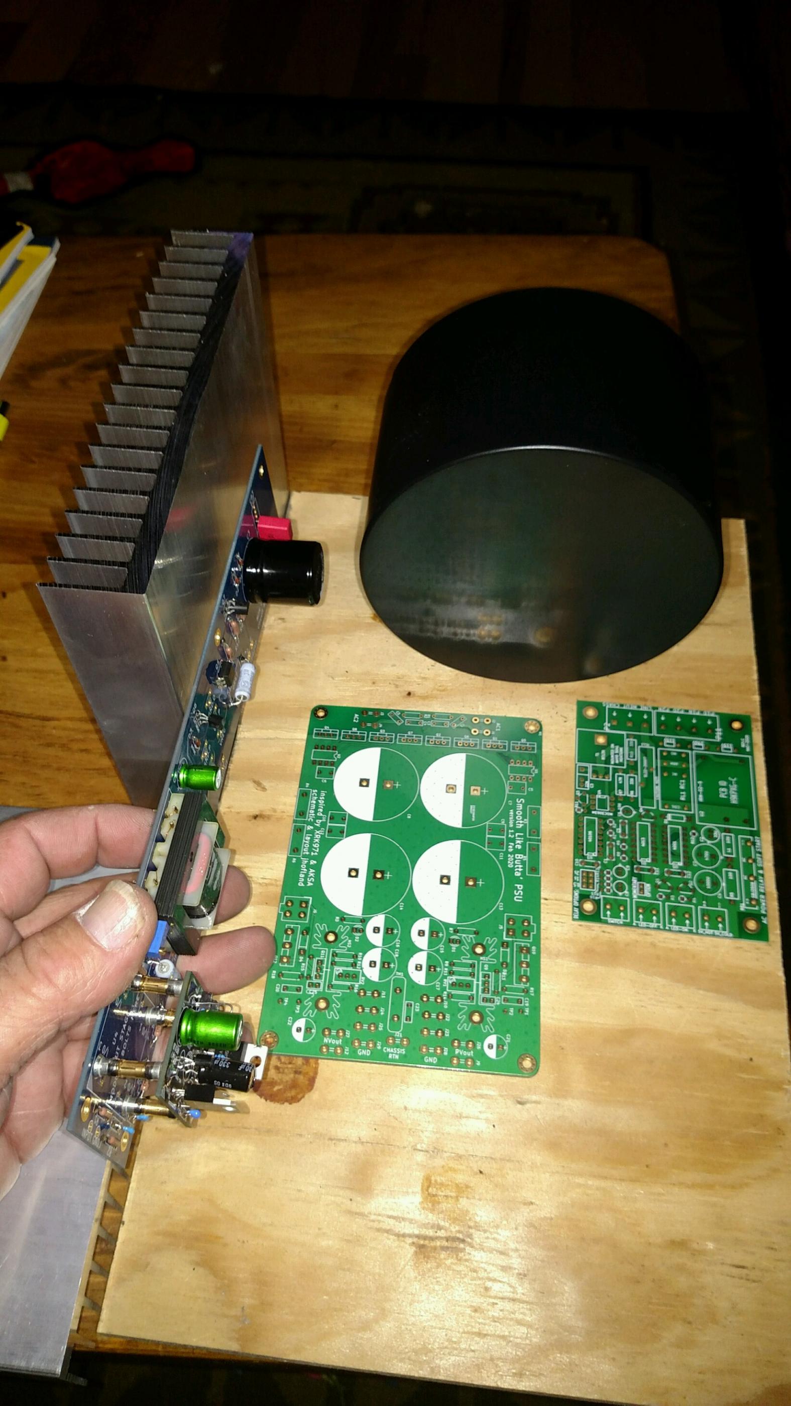

I would say it’s not worth making your own when you can just buy the 2mm thick 2oz copper and ENIG board ($18 for gen1) for less than it would cost to make 5 of your own boards.
The thick traces are the ones carrying current. So from AC in to CRC, to cap Mx BJT (collector and emitter) and then out. Probably not necessary to do double sided via stitching for the traces. 4-5mm wide 2oz copper should be more than sufficient. Just look at photo to get idea:

Thank-you for your reply xrk971,
I obviously checked first on etsy. It's not for now, plan for future builds.
There is a mix of several reasons to try this, including high shipping fees from US to FR, some good deals for boards within 100x100mm and adapt the layout to some components.
