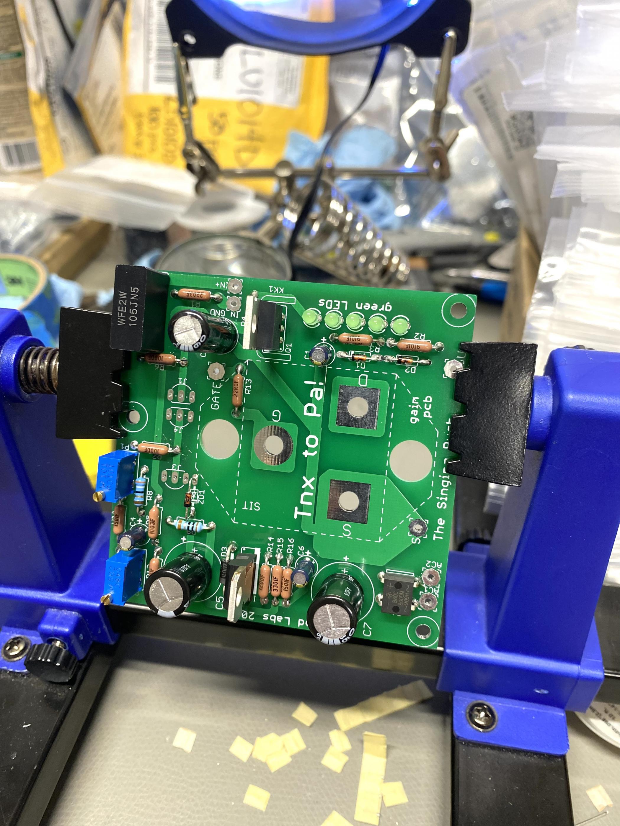

One SIT gain board down. I realize I soldered in the 22r gate resistor. I’ll either clip it out or bolt into the board for that nice clean look. 😉

Thanks for the tip on the 22r. It does look nice on the board. 😉
Absolutely will add the heat sink for the IRF510. Thanks ZM. These boards are more form than function at the moment. I’m making sure I can fit everything in my chassis’s in full mock up form.

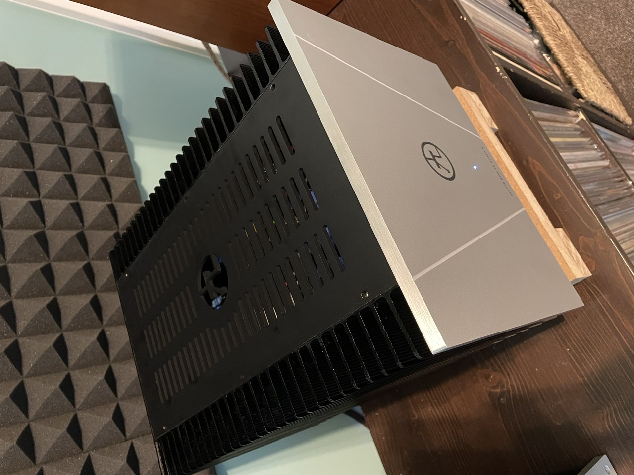

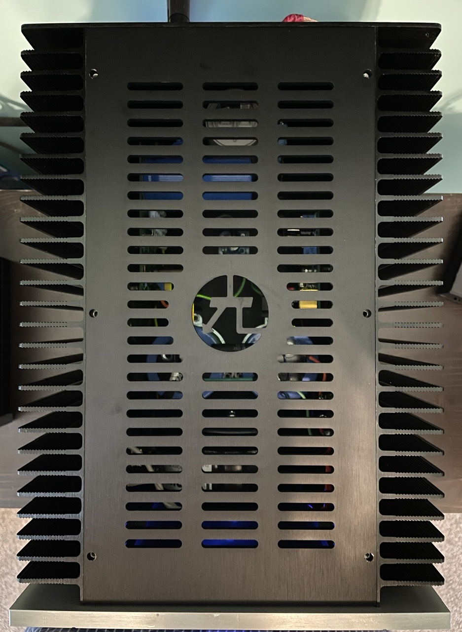

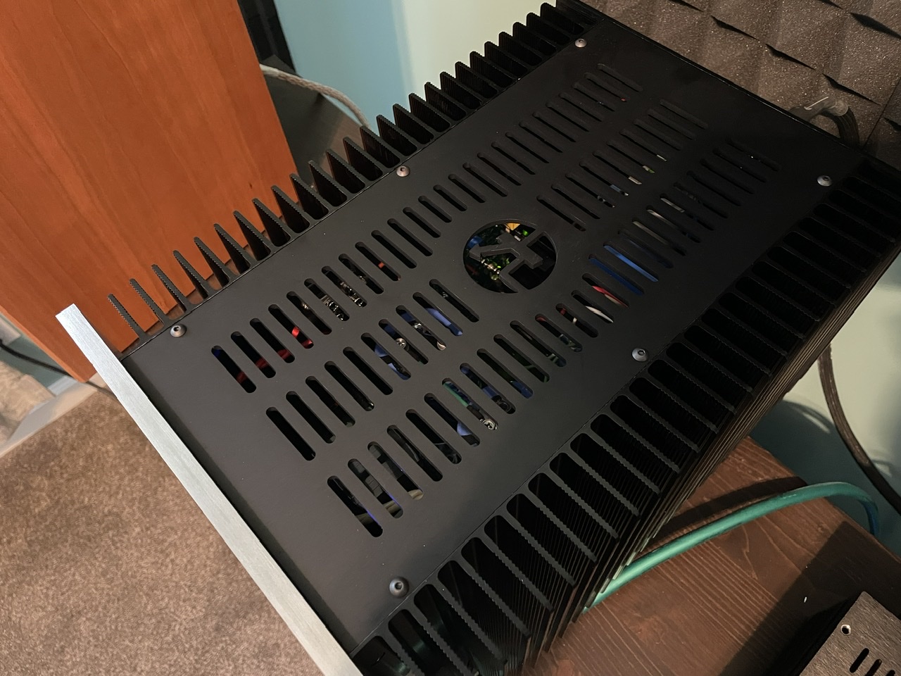

I finally got around to replacing the under-ventilated top covers for my monoblocks. Another homage to Digital Do Main… lot more holes now, along with some more bling. They’ve definitely helped lower temps.

methinks that you need more work on that ddomain signs
get them to engraver and engrave on symbol lines "Tnx to Papa!"
:devilr:
with that logic, I could badge any of my amps as Motorola!!!!!!! or Tokin!!!!!!!!! or IXYS!!!!!!!! or IR!!!!!!!!!!
ok, at least one I can badge PASS!!!!!!!!!!!!!!!!!!!!
:rofl:
Well, I was looking at more as the ‘SIT’ symbol rather than the Digital Do Main logo. By homage I meant, “look, here’s another SIT symbol on top of an amp!” I’ve seen a few others do it, so making sure I received no credit for originality.
Yes, I DO need to add a TTP (Thanks to Pa) text somewhere 🙂
