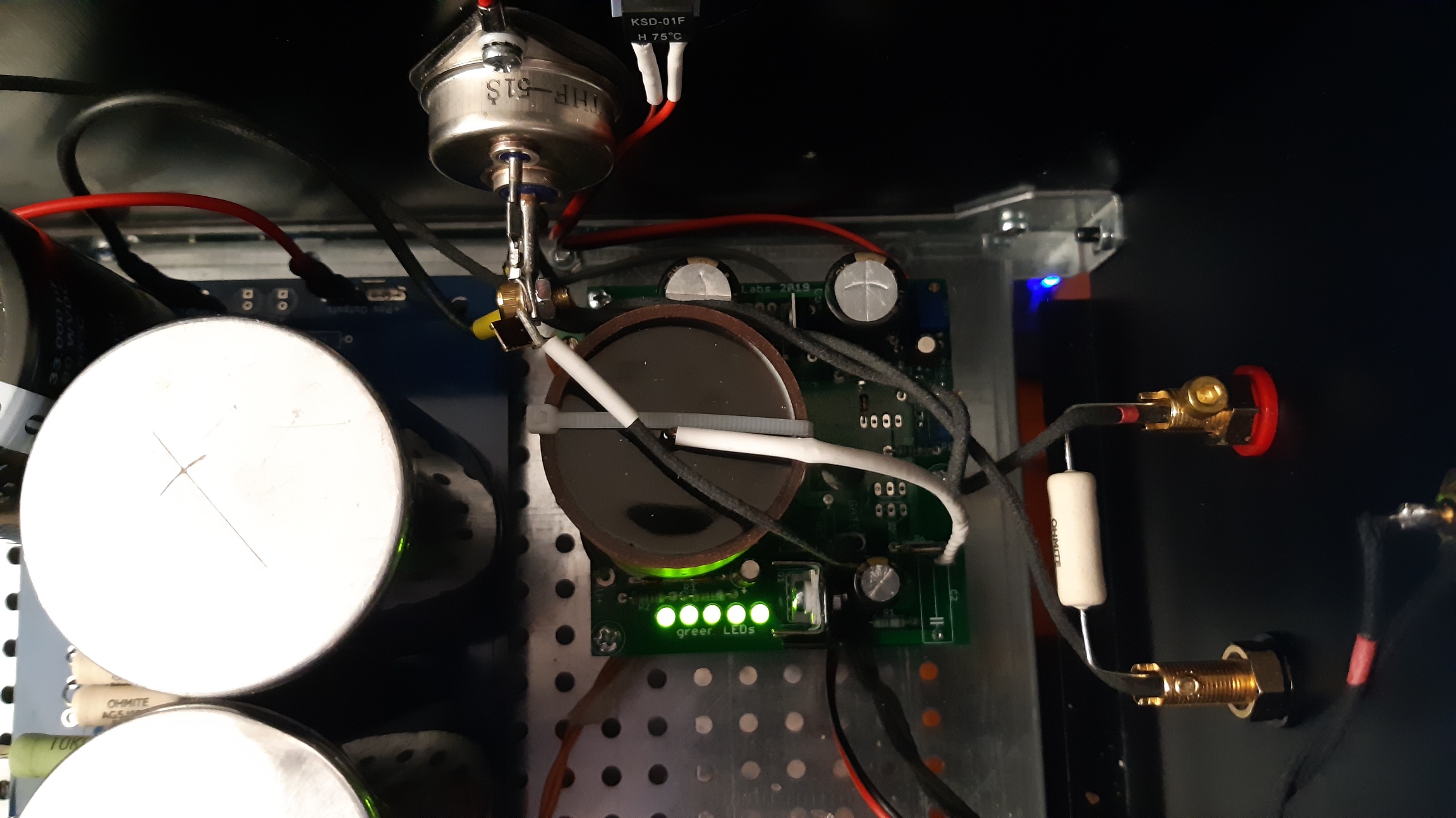

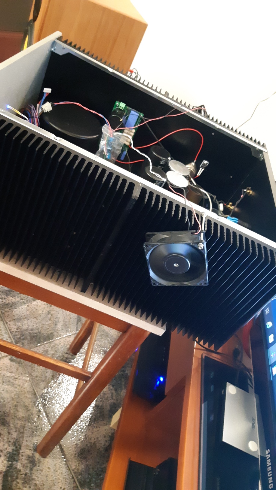

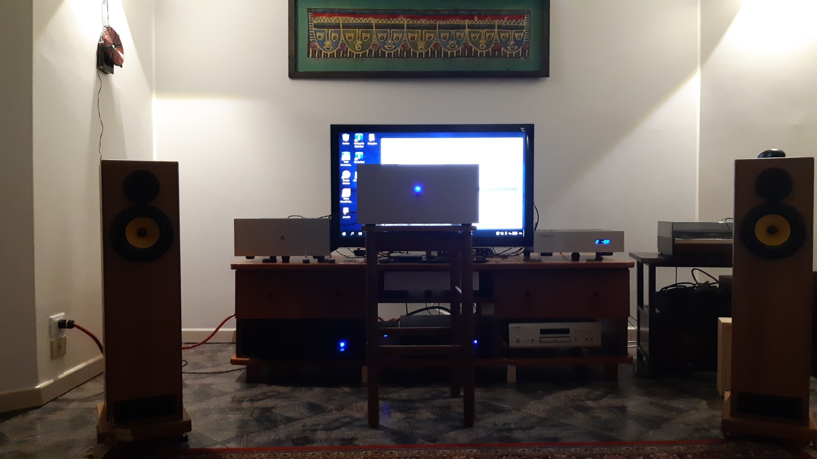

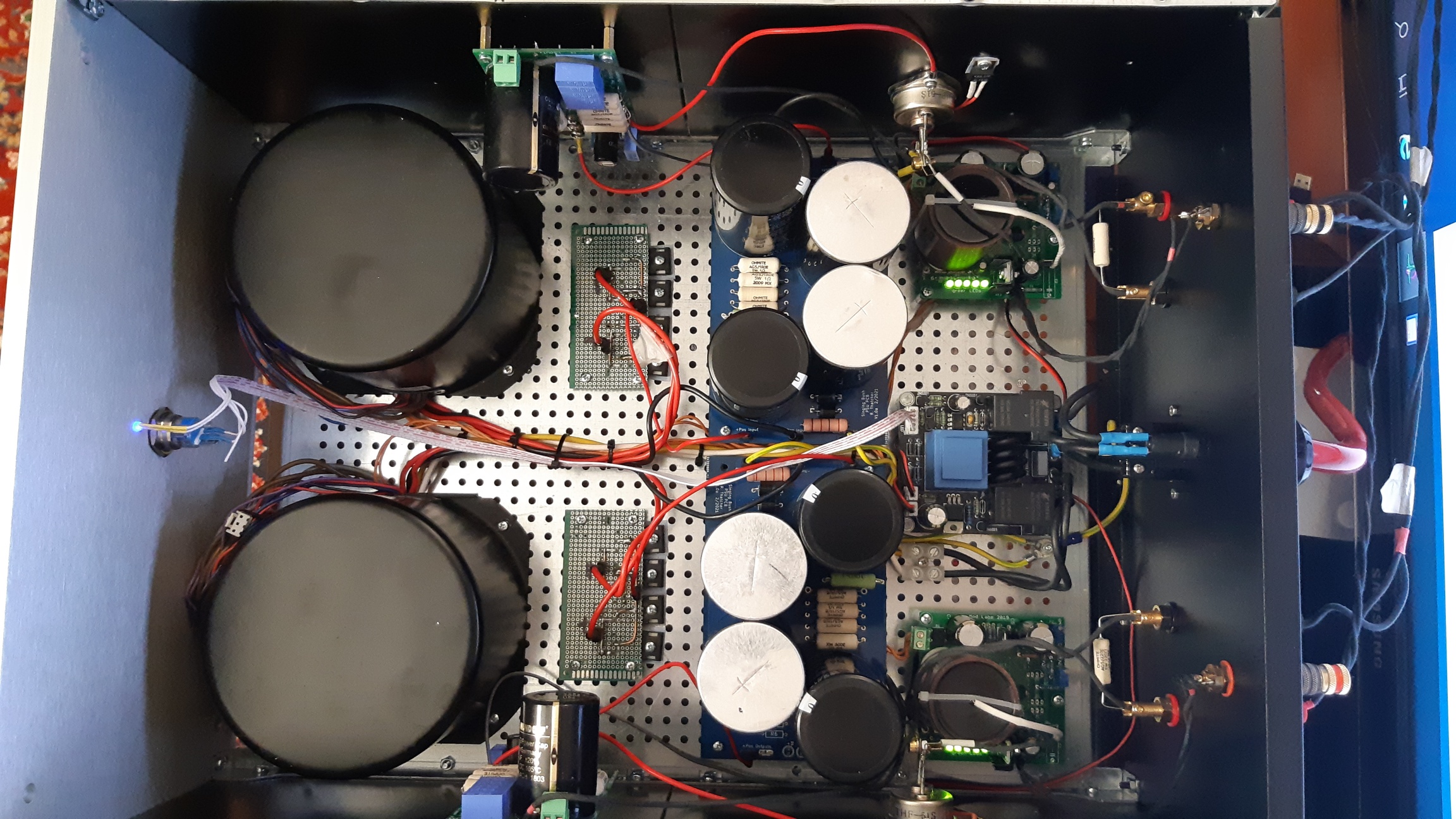

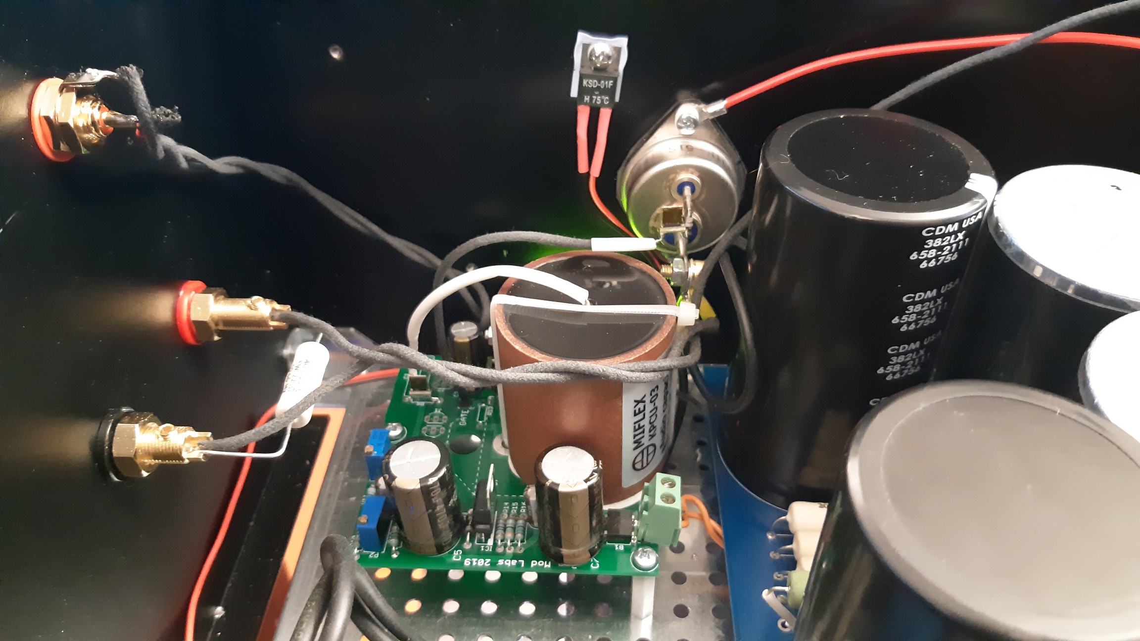

😀 Dear Zen Mod, you have become a dad again. I finally gave birth to a huge and hot "little" Singing Bush. I made the appliance in a hifi2000 5U500 container. I replaced your favorite Philips capacitors on the sit board, with my beloved and huge Miflexes and taking advantage of the space that was left free on the board, since the thf51s are next to them, with a little imagination I fixed them. I used for the PSU the cards of my friend rhthatcher whom I thank for having contributed to this construction. Everything worked as you expected, but I have a problem. I can't set the bias to 2.3A. with 37v the maximum. I get through the 0.2r resistors is about 415mv almost 2.1A. The voltage rail is 60v. What should I do? The amplifier heats up a lot, especially on the "sit" side and therefore I will mount two fans on the outside. In the meantime I used what I had available. I can't tell you how good it is yet, but the first start was very encouraging.

so, confirm - you can get 2A1 max and you can't decrease output node voltage lower than 37V?
you did follow procedure described in post #29 here :
-P1 on Mu ,to set exact Iq of, say , 2A3, which is 460mV across Iq meter,
-P2 on SIT pcb , to get magic number of 34-37V at SIT Drain
when you achieve that , well - when you're in 15% ballpark, with heatsinks approaching temp equilibrium, you can leave it and proceed with same second part od procedure with second channel
when you are done with that , repeat second part of procedure with both channels, this time trying to pinpoint it where intended (2A3 and 34-37V) in temp equilibrium, lids closed
please, write what Ugs of SIT you have now (as is in amp)
I presume both channels same situation?
whatever - for start you can decrease value of R11, SIT pcb , ref. schm in post #2 here
either replace 1K5 with, say, 470R to 510R ....... or solder 1K across 1K5
logic is that your SITs are of variety with rare small Ugs value, so they need to be open more, to allow increase in Iq and sliding output voltage node down ( effective impedance of SIT being lower)
Hi Zen Mod. Yes, I followed the procedure of post 29. I can safely go down to 34v, where I can see about 2.2A and the two channels be have the same way. I don't know what is the Ugs of these my SIT. I bought them matched by Tomoaki Watanabe and mounted without asking me too many questions. As soon as I can, I replace the 1k5 resistor and let you know. Thanks, Fabio.
with 2A2 you're in ballpark
say that 34-35V is safe point for output node, higher than that slightly decreasing THD but also decreasing output power
if you insist on higher Iq, I believe altering R11 down, and fiddling with top trimpot and lower trimpot should set things as you wish
so it seems that bottleneck is mosfet
you can cheat optocoupler in two ways
first back-up with upper trimpot to decrease Iq
then :
- increase R3 (upper pcb, of course) to, say 330R to 390R, or
- leave R3 as is, and solder 3K3 to 2K2 across pins 1 & 2 of optocoupler
twiddle again with trimpots to set what you wish
