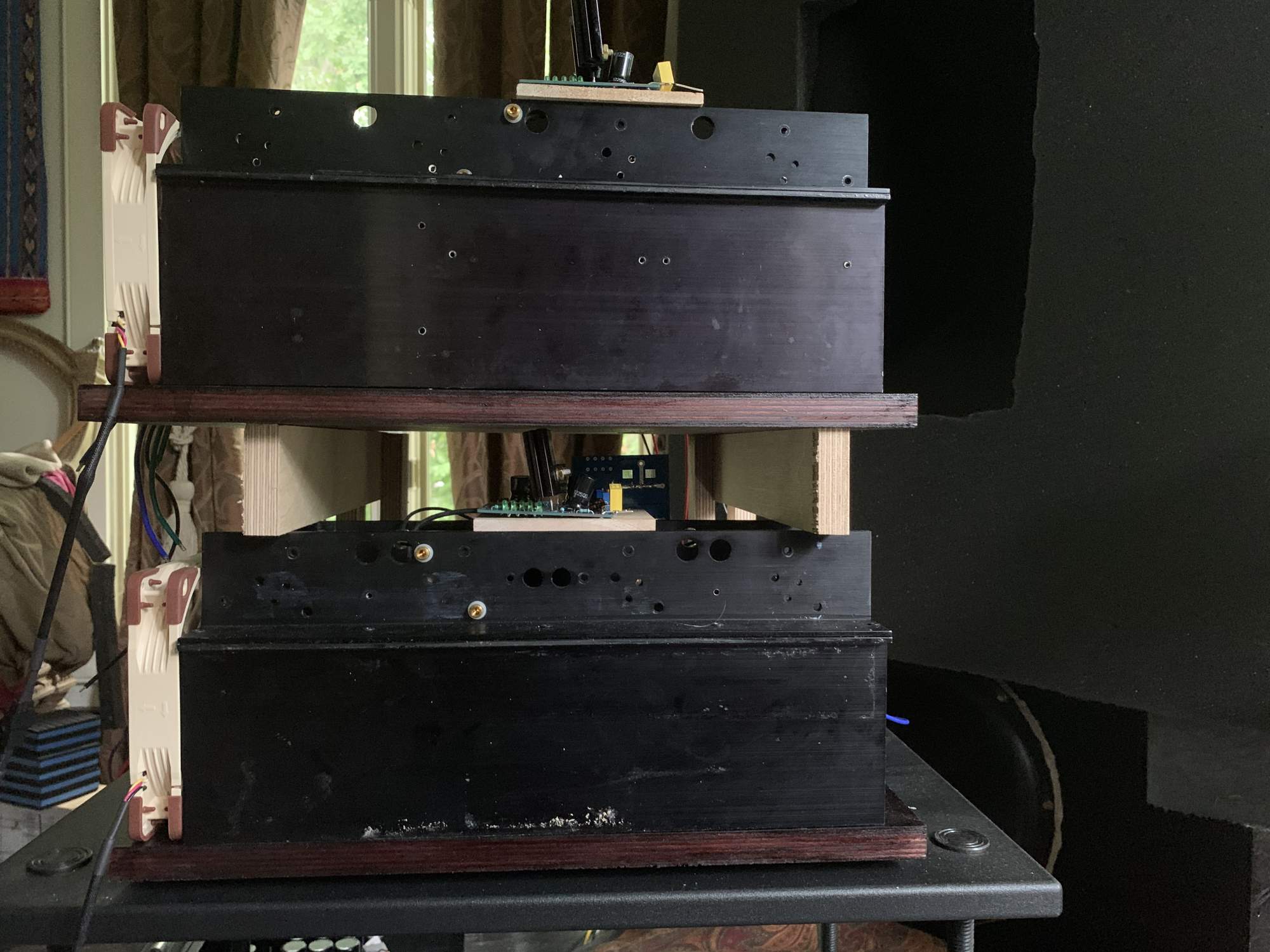

Not exactly porn more of what I call DIY AT FIRST SIGHT but here is the mock up, soon to be working, first pair of SINGING BUSH.
Based upon the DYNACO 400 amplifier's magnificent heat sink this imposes a vertical orientation.
Both of the PCBs will be very close to each other. My output capacitors will be remotely located - not on the PCB - with that in mind I sawed off all but what is needed for the input to the couplers to save some height.
NOCTUA fans should keep the devices comfortable with no noise. The LENCO idler drive makes more noise than the fans,
Pictures Monday of the power supply which is behind the heat sink. All leads minimal length.
The TINKER TOY SINGING BUSH.
Gravity is welcome here. Since they will never be moved I went to no great trouble to secure things. The power transformers are bolted down and the mosfet board is held in place by the mosfet. The SIT board will be attached to the heatsink using some 3M VHB tape to secure the balsa board it rests upon. Balsa has vanishingly low capacitance and good damping qualities and best of all: it is easy to work with.
The rectifiers are attached to a piece of I beam aluminum. They are what Mr. Yazaki of SPEC CORP called the solid state equivalent of a WE 274B - appropriate to use with our solid state triodes. The LL2733 is attached to this same piece of I beam to give a measure of heat sinking to the choke and to make them as close together as possible. The choke/rectifier assembly is held aloft by a simple piece of wood which I will glue to the 18 mm birch ply baseboard. The phenolic board of the LL2733 will be used as the motherboard for the power supply - all wires attach to these points - from the rectifiers, from the storage caps and then the leads to the amplifier. With ZM's assurance I am using the "alternate series connection for improved common mode rejection". Will the choke be happy with this? I like the idea of the connection but have some concern that it might be too close tot he saturating current but XM has (proverbially) forgot more than I know along with you never know what happens until you try it. It is worth a try.
I like the idea of easy disassembly. The leads from the choke to the devices is as short as I can make them which I think should be about as short as possible in any application.
Not going for any beauty prizes or even Miss Congeniality. I admire those who make beautiful amplifiers but all I care about is how they sound. This weekend i get to find out whether I have made a mess or allowed ZM's design to speak through my speakers in the manner he intended.

"alternate series connection for improved common mode rejection" is working exactly in way of two current pats cancelling DC flux in core, so no saturation in sight........ two opposite currents being equal
sole worry in this case is that you'll have too much voltage sag in that arrangement (that needing conformation in vivo - if you end up with enough voltage, you're good), in which case you're going to arrange it in parallel connection of two windings
DUNCAN power amp simmer predicts 59 volts.
I figure that will be OK. If it actually is.
But will not know for sure until the thing is processing GEORGIA POWER's electrons for sale.
With the way I have wired the supplies it would be easy to make the change to parallel if that is required. For the moment hoping it works.
If it is shy would it be worth considering more than the raw 50 AC volts I have installed? Next step up with ANTEK is 56 volts. Was wondering if there was a point where the resistance of the coils and the current needed by the amps reach a stalemate that extra volts cannot ameliorate? You know I have no idea! Of course, we need to see what I get with what I have, first.

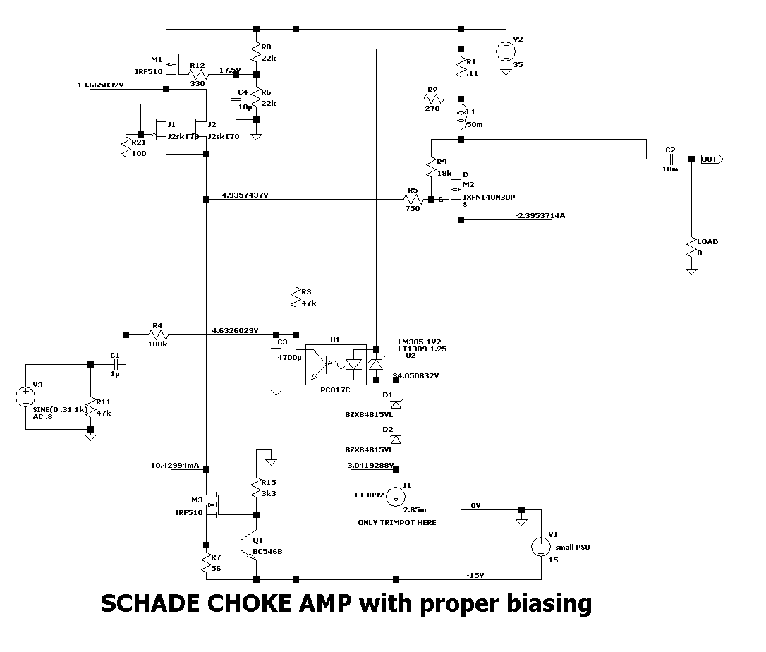

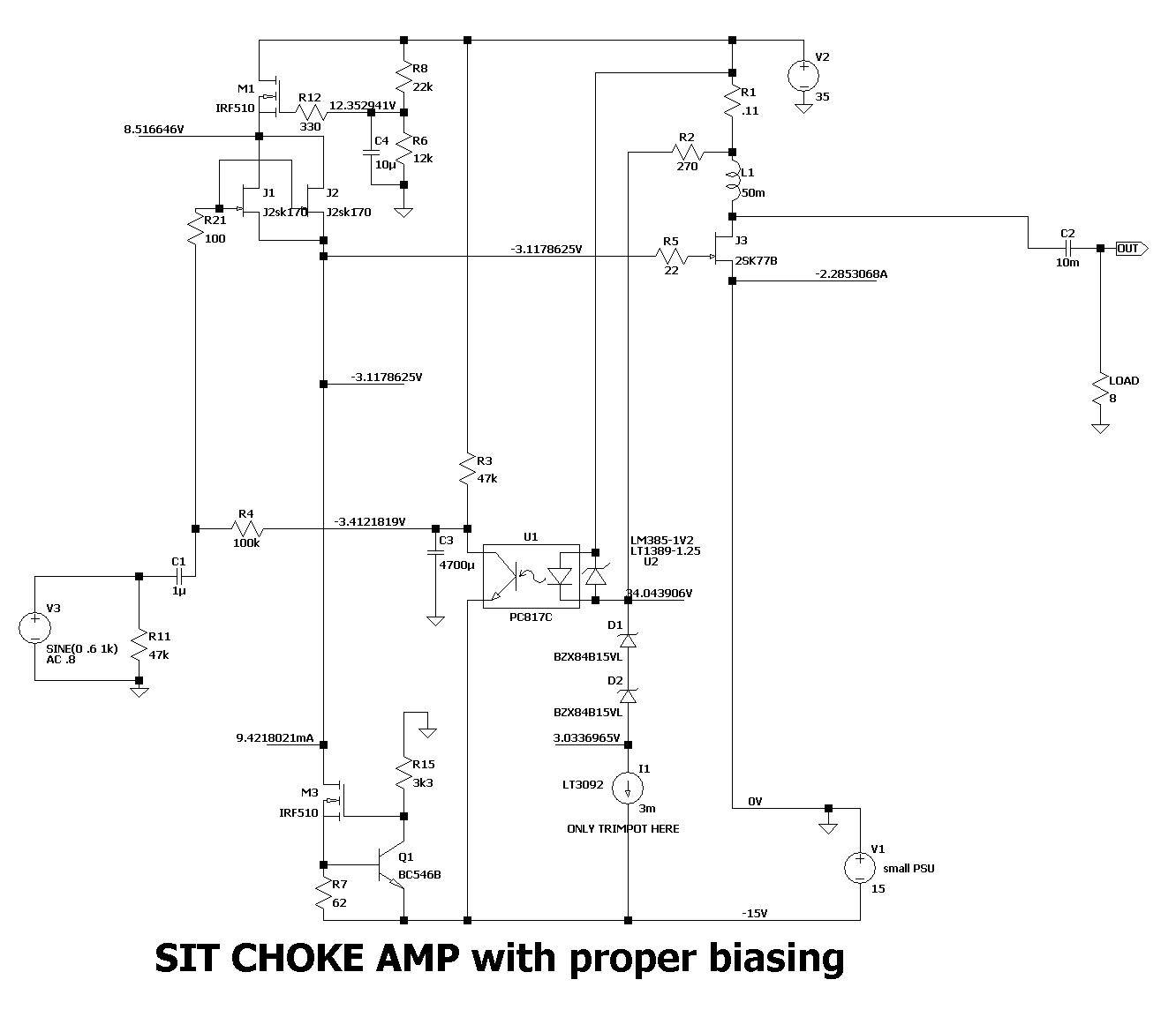

Midget Singing Bush
I'm in too many threads ....... sometimes can't fathom in which one I need to reply......one Greedy Boy asked for Choke load, and here it is - usual overcomplicated ZM jobbie
anyway, as Title sez - here , as sims, but no reason to doubt - as I'm faultless
:rofl:
Midget Singing Bush, in 2 iterations
edit: faultless, ZM's a$$ ....... :rofl: - ignore value of input shunt resistor, designated as R11 - it needs to be 150K and upwards ..... even 1Meg
