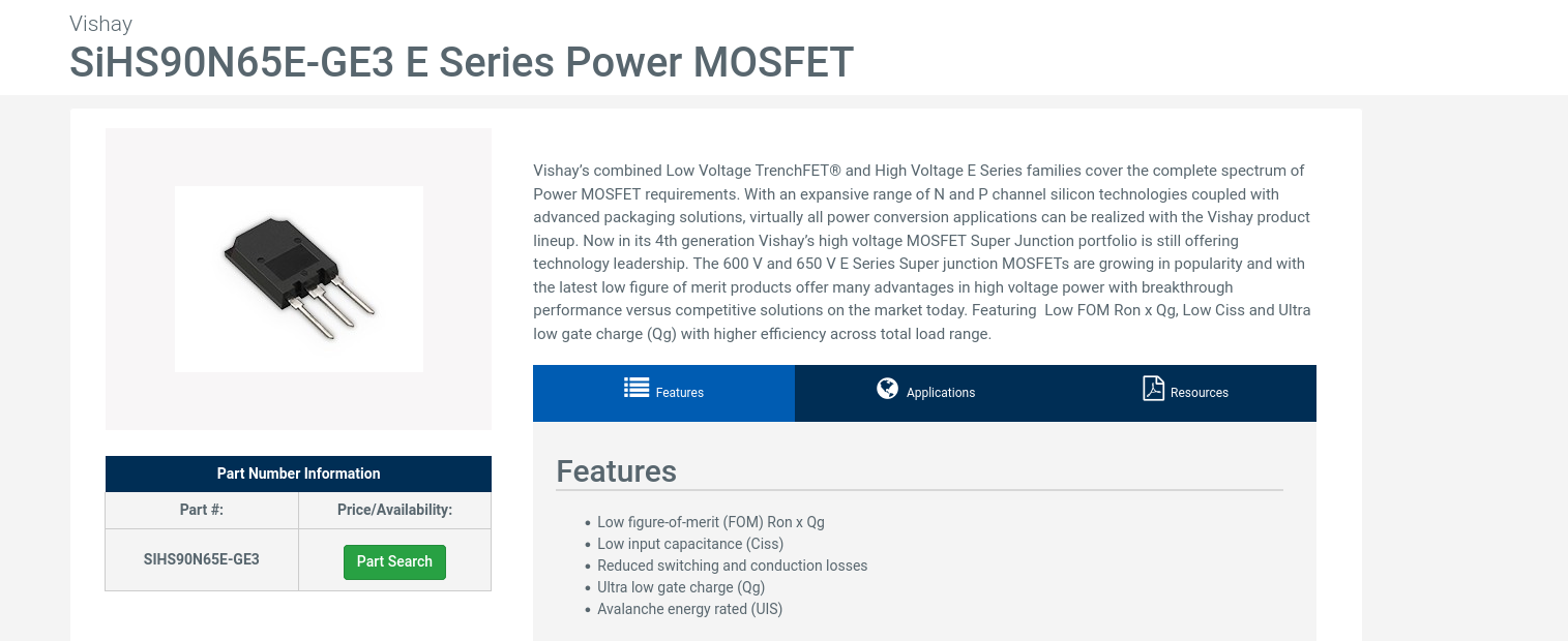

datasheet - (closest I can find ) - https://www.vishay.com/docs/91585/sihs90n65e.pdf
everything looks good .......... except 2 things - Ciss is sky-high ......... and - no confirmation for DC operation in SOA graph
meaning - part is suspicious to the point when someone actually make proper torture test
