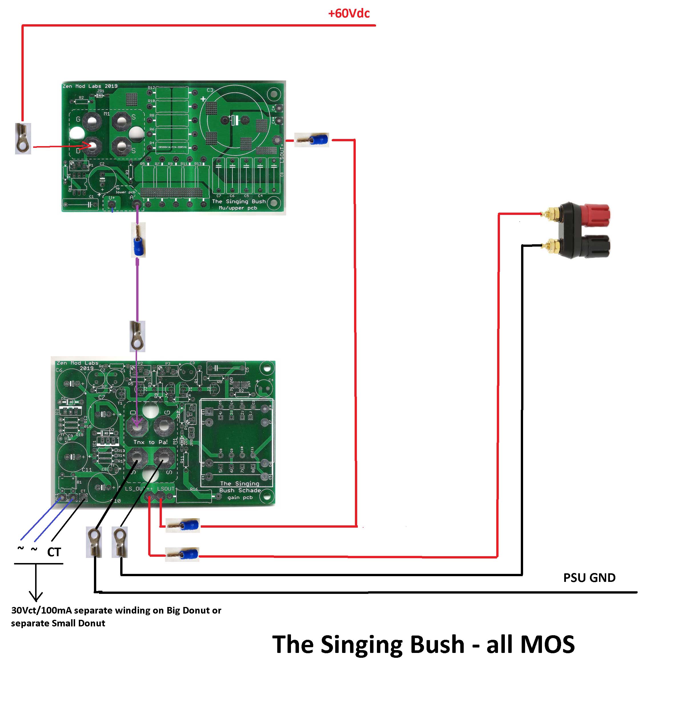

ORIGIN THREAD : The Singing Bush

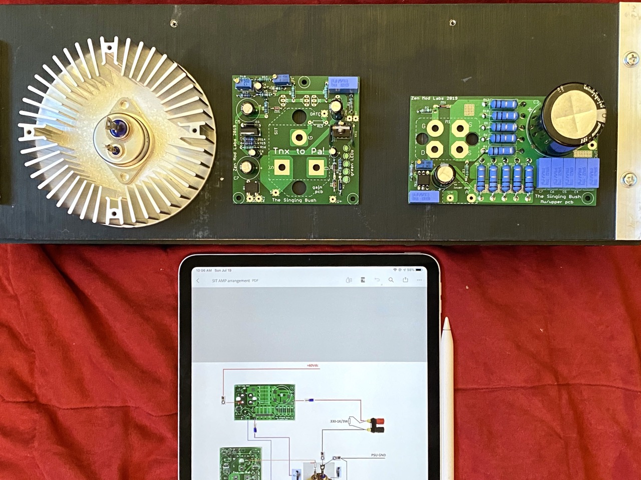

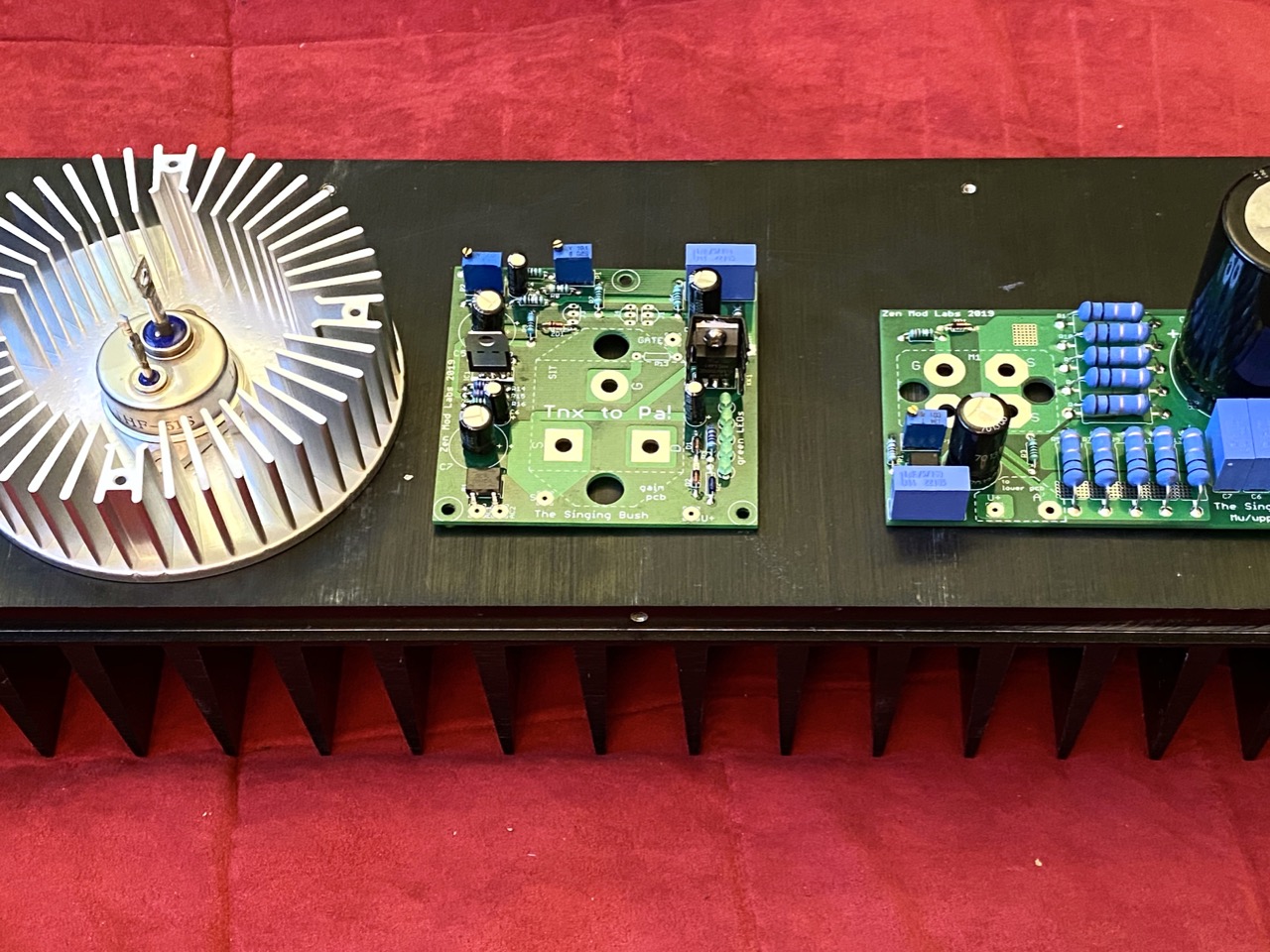

First few posts with graphical info, then I'll write separate posts for both amps, explaining few details

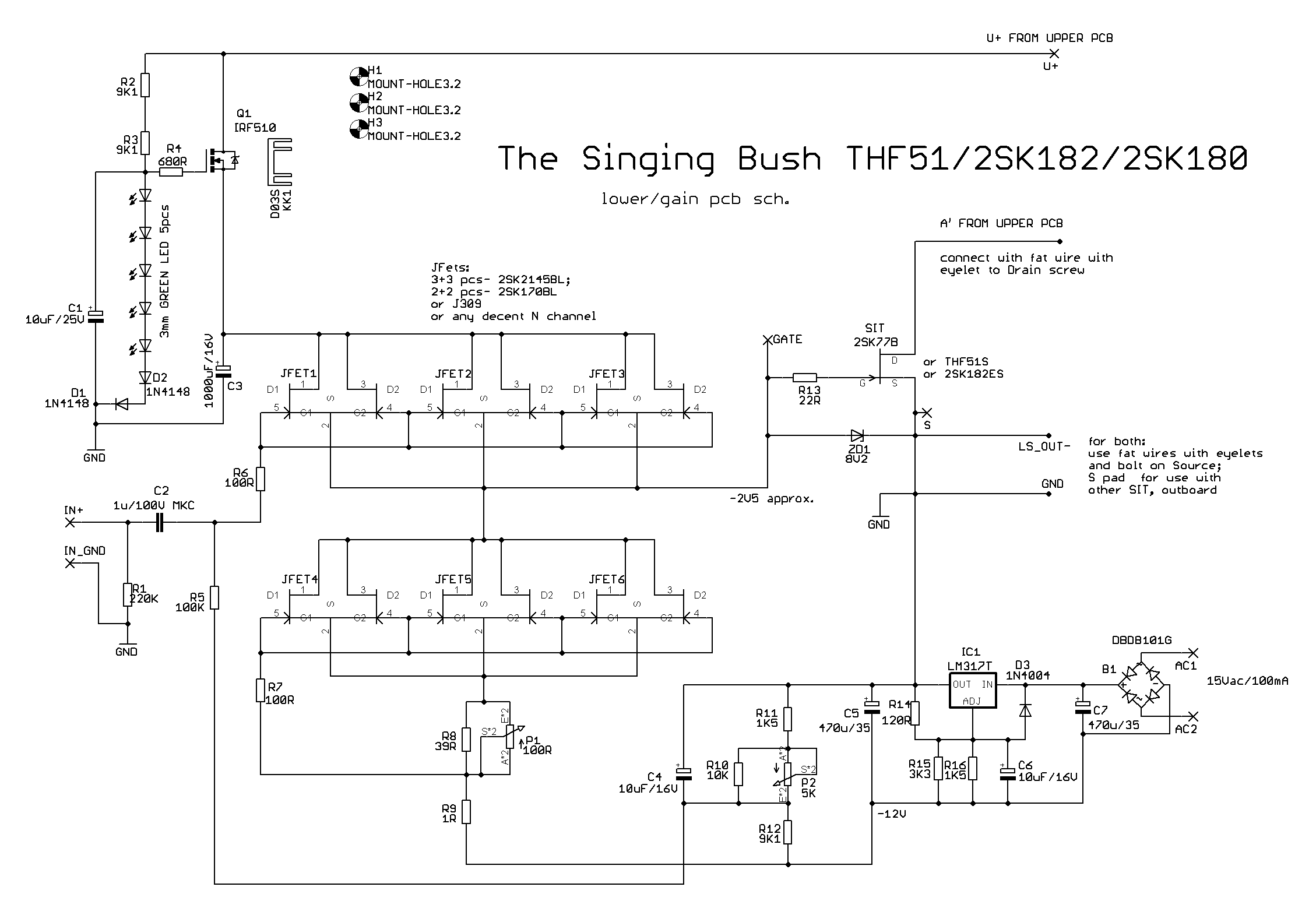

however , most important thing when starting, applicable for both amps:
be sure that trimpot in buffer negative rail (lower JFet group source) is set to max position, prior to first powering up - check that measuring across parallel 39R resistor - reading must be close to 28R
another thing - remove that silly blue collar from needle wire terminal you got from me - either use heat gun or heat it with solder or lighter ...... then pull it
all wires need to be crimped then soldered in wire terminals, then heatshrinked, to look nice

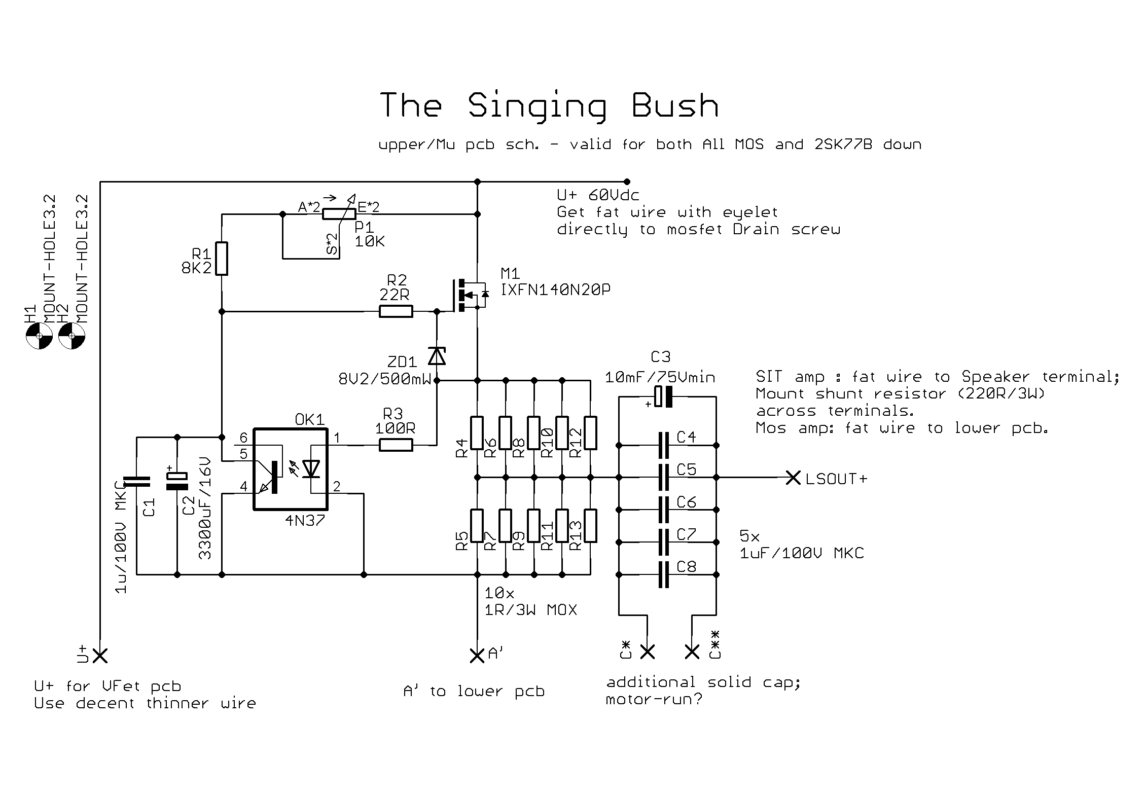

for 2SK77B - lucky bstrdz having these - all 3W resistors in Mu part of amp - they are still 1R/3W , no change ........... Iq 3A2, output node or SIT Drain (what's easier to reach for measurement) set at approx U/2

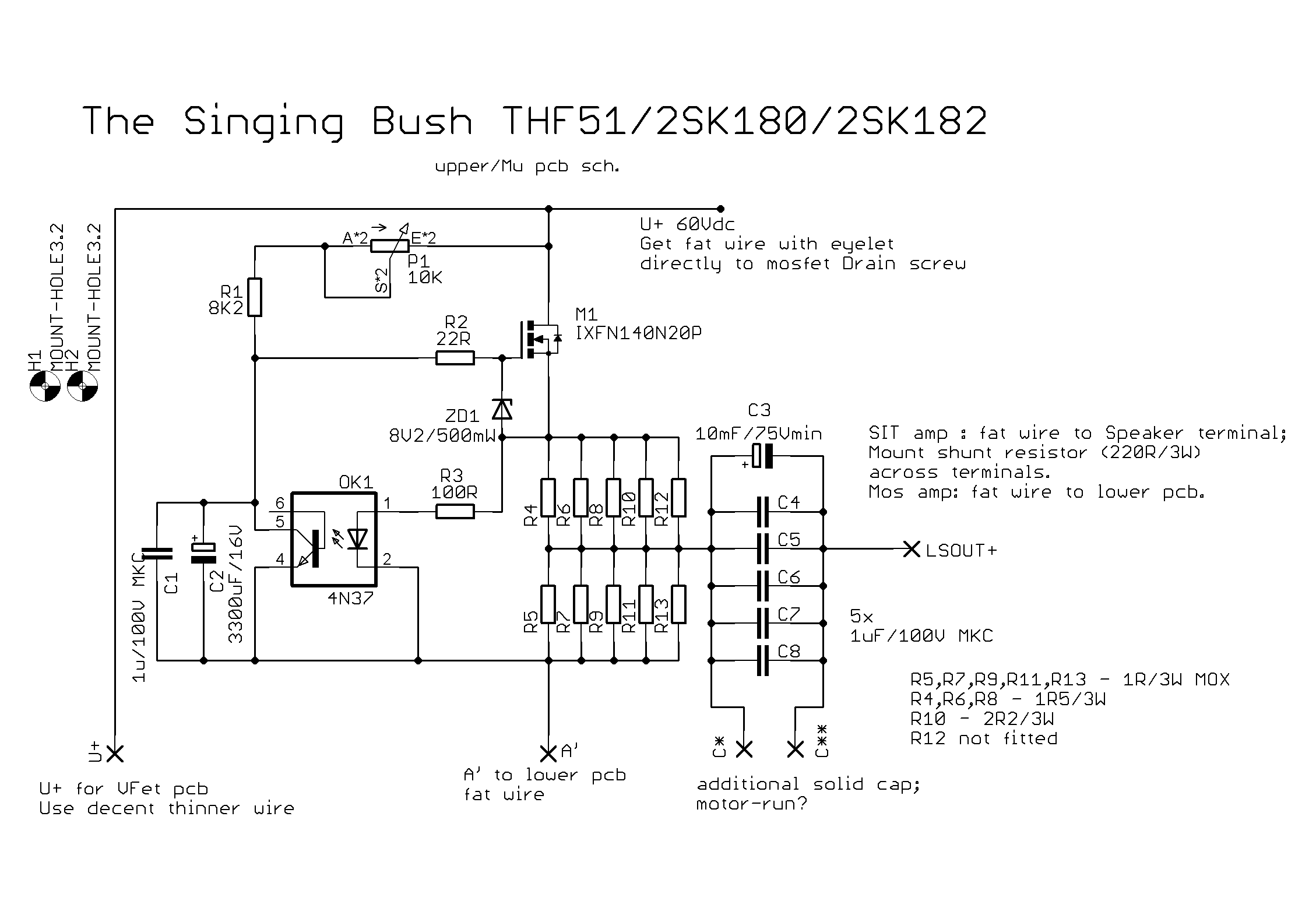

The Singing Bush SIT iteration
yup, this one is with THF51/2SK182/2SK180 in lower position
I know that few lucky bstrdz are having 2SK77B , to use there ....
I didn't drew input RCA and twisted pair of thin wires for that , you'll manage
I think I figured out what I need for the THF-51. According to post #97 in the Singing Bush thread, we are trying to create the equivalent of a string of six 0R1 resistors, with the tap point 0R2 from the bottom, and 0R4 from the top.
So my bottom resistors are correct, but the top resistors need to be 3x 1R5 and 1x 2R2 for a total of 0.407 Ohms. Yes?

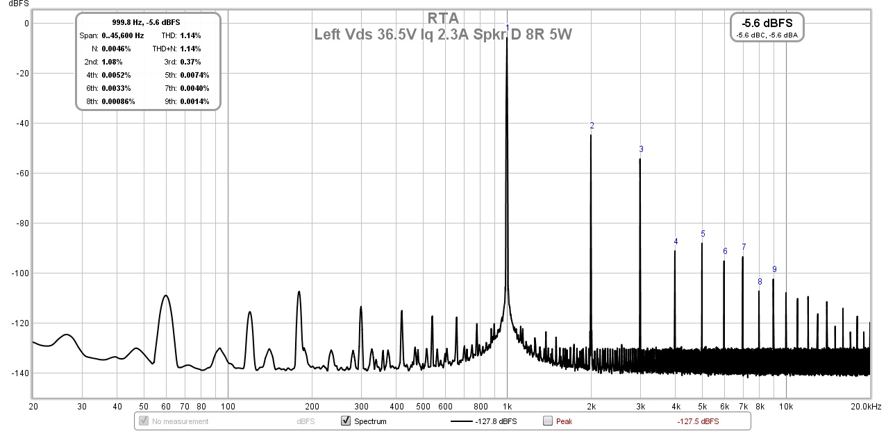

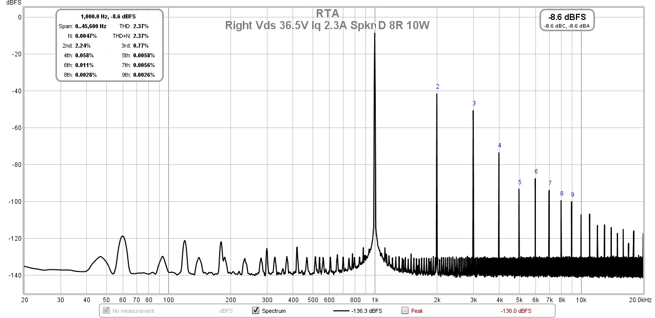

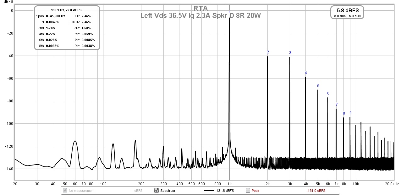

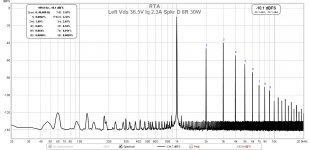

Hi ZM,
In my version of amps (pre - Singing Bush) I recently tried speaker out at the middle of the resistors - THF - 0R3 - speaker - 0R3. With the THF-51S that I have, this gave better distortion results than speaker out at THF - 0R2 - speaker - 0R4.
Do you want to see the results?
Hi ZM,
certainly that I want
though , we see that there is no perfect recipe ...... in fact - every recipe is to get in ballpark, and fine tuning is always possible
without NFB and with so broad spread of transfer characteristics of used parts, we are pretty much lucky bstrdz anyway

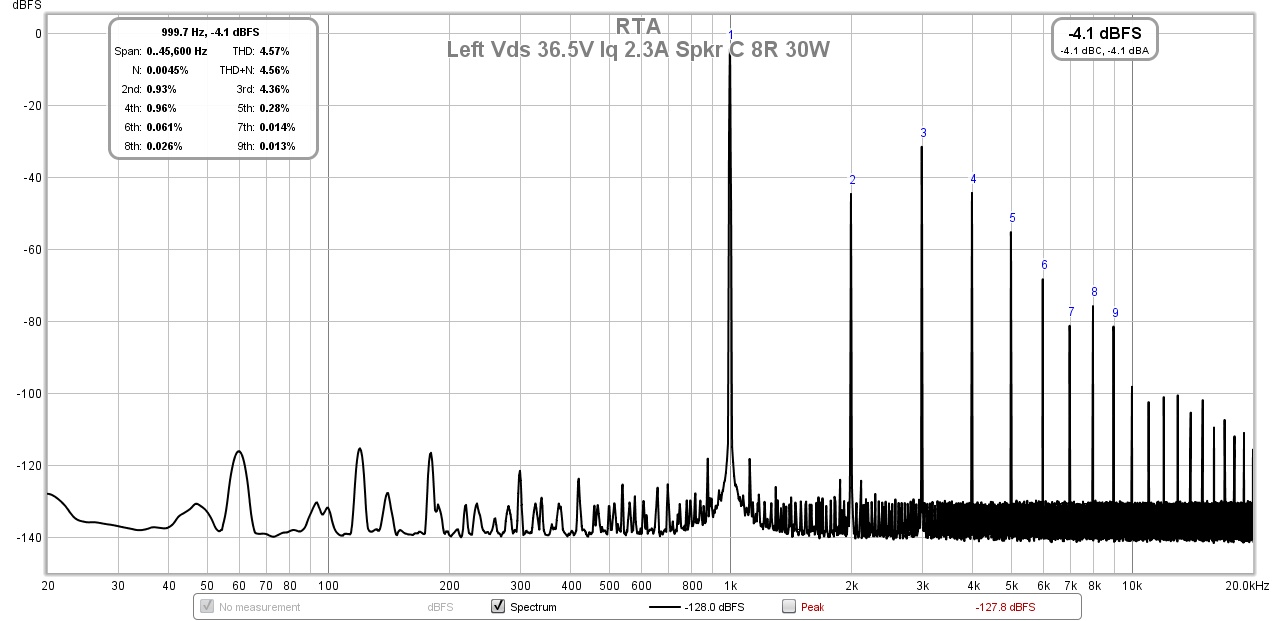

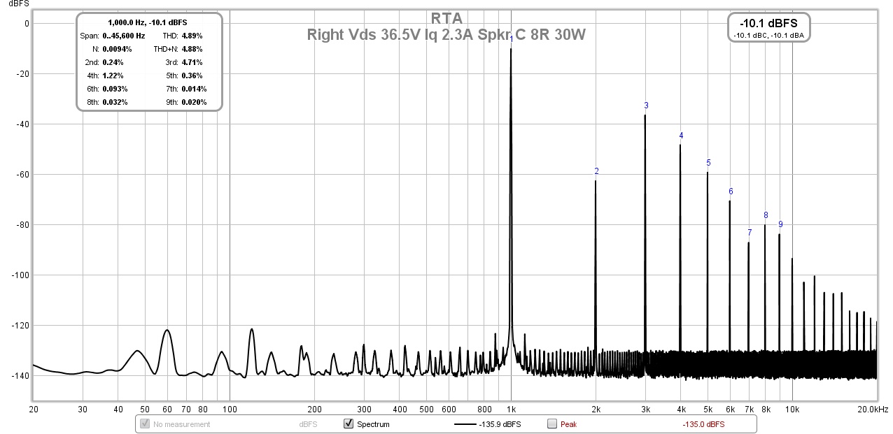

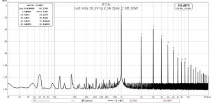

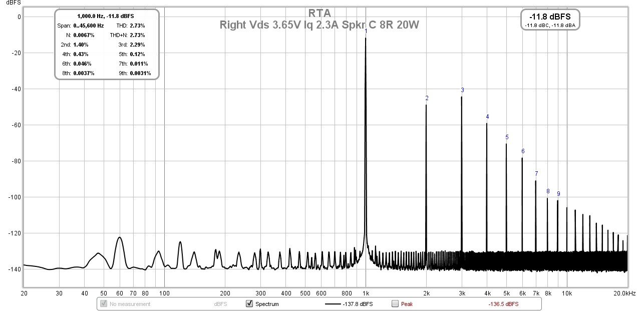

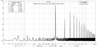

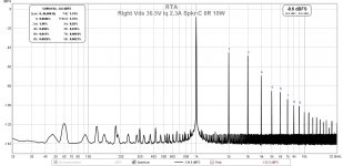

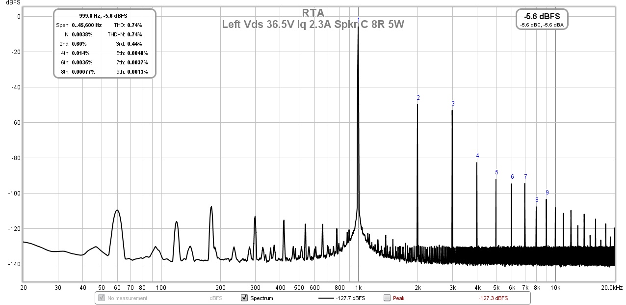

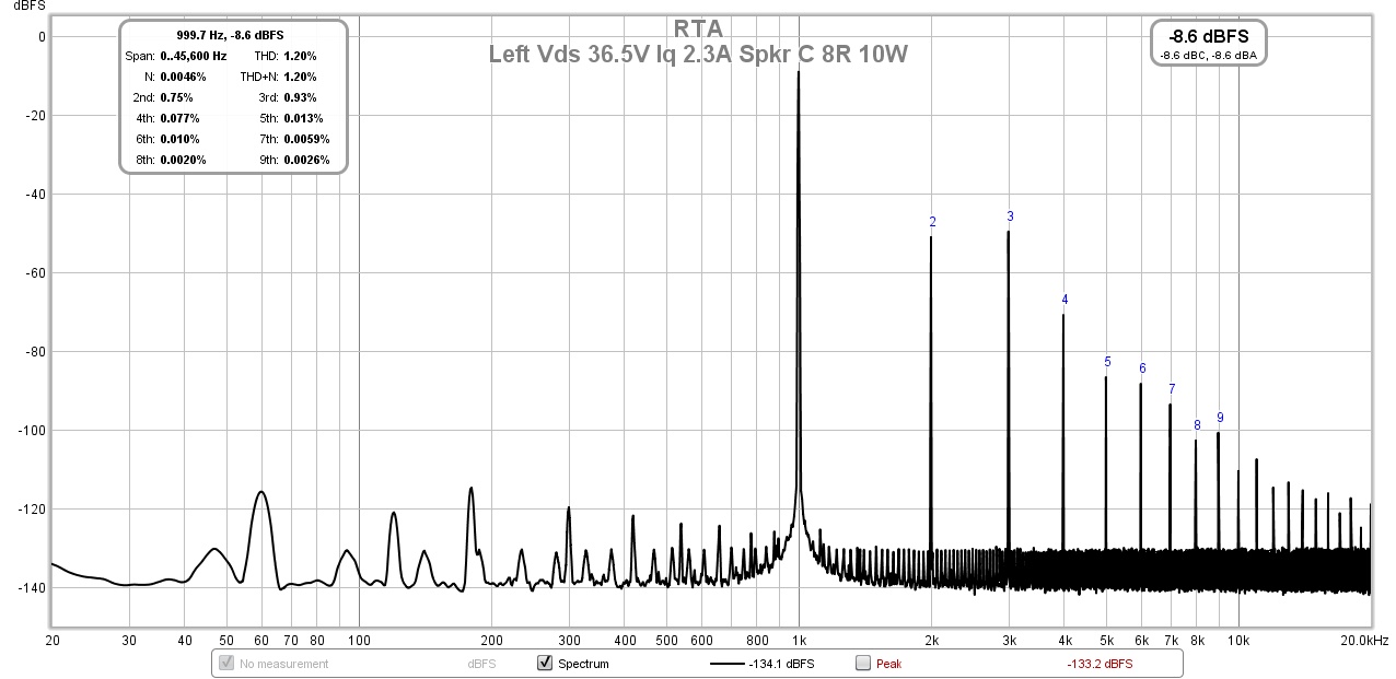

There certainly is variability among the THF-51S. My two pieces are not identical.

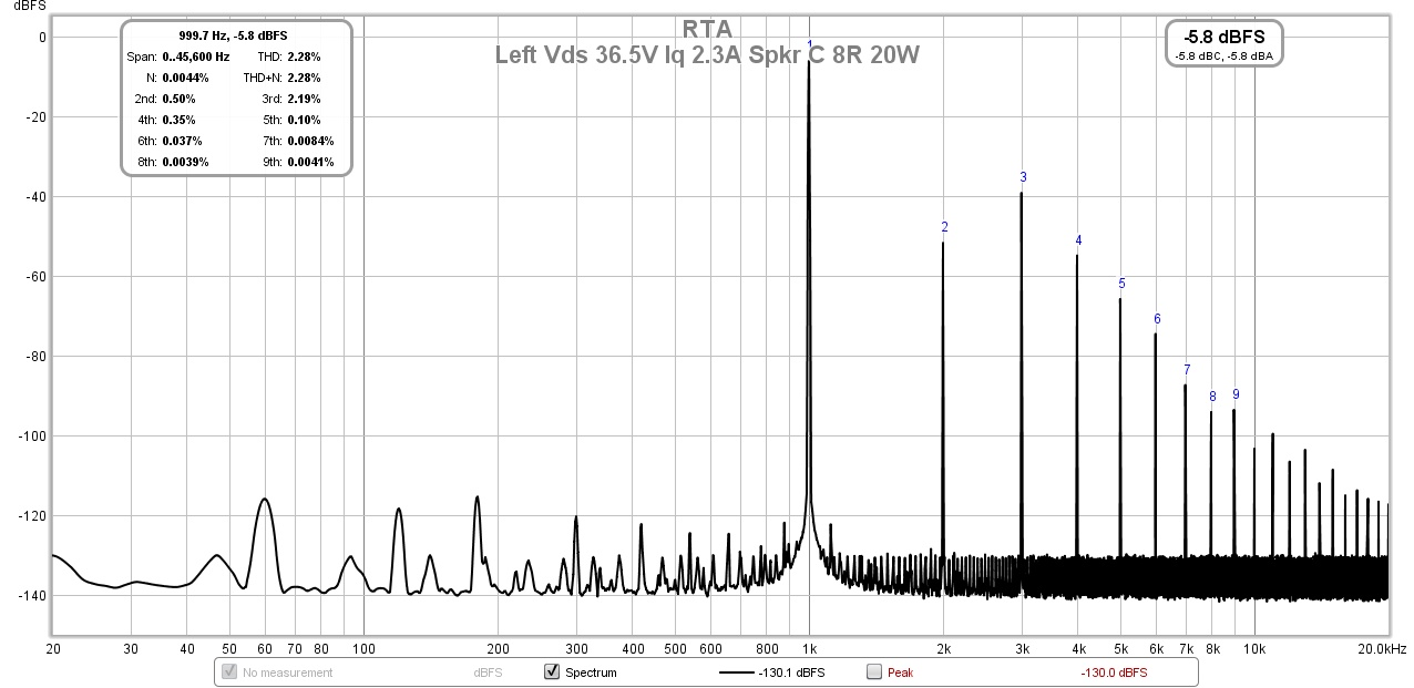

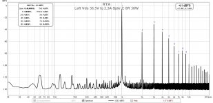

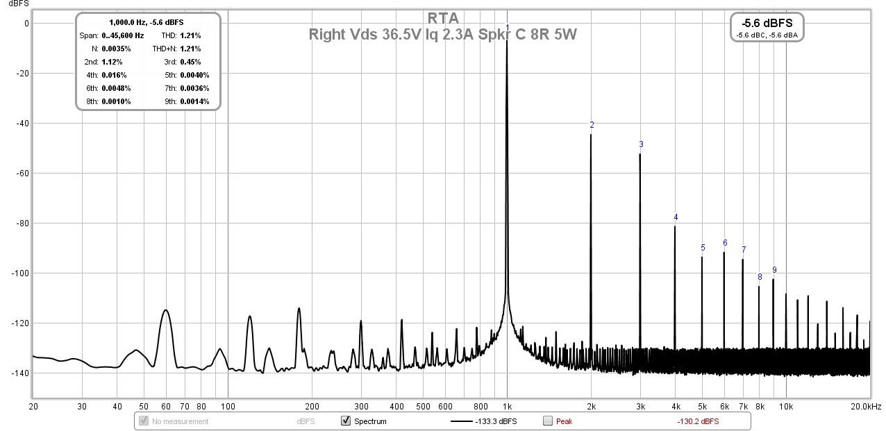

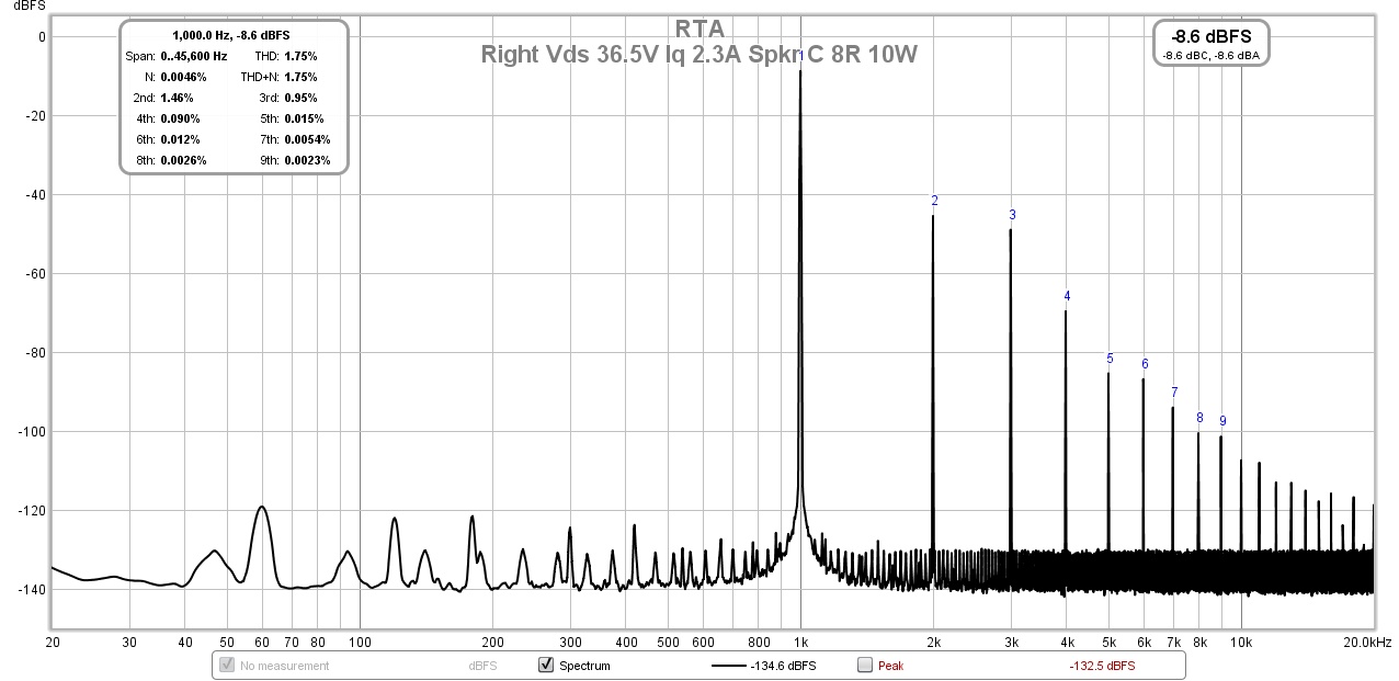

My amps are Vds=36.5V Iq=2.3A, same as your spec.
The following are left and right channels, speaker out between 0R2 and 0R4:

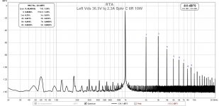

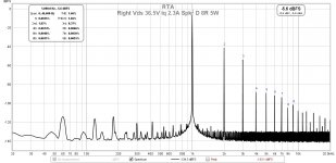

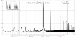

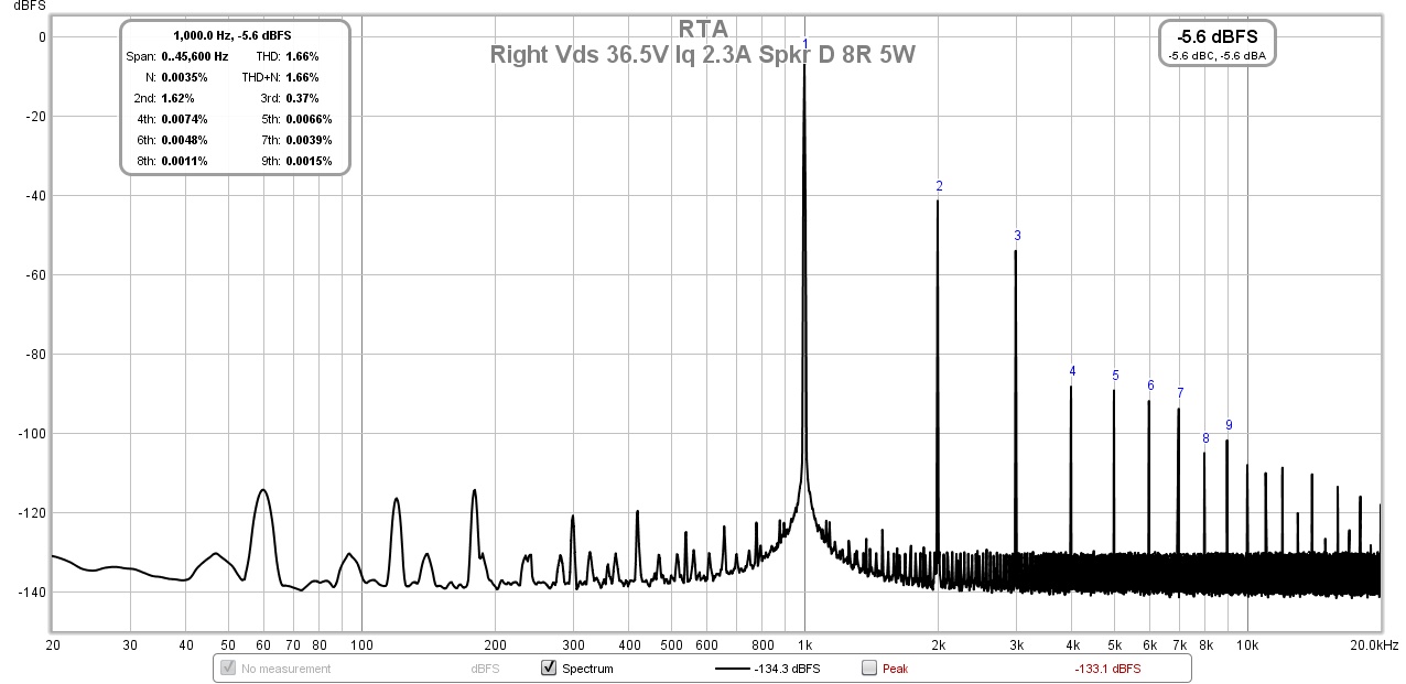

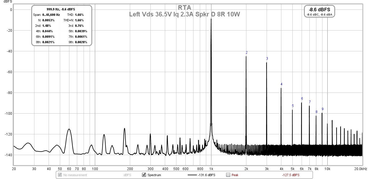

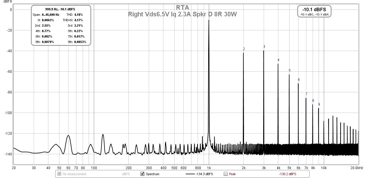

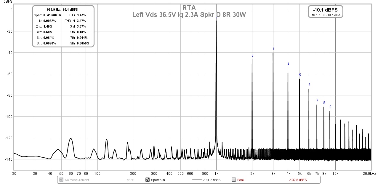

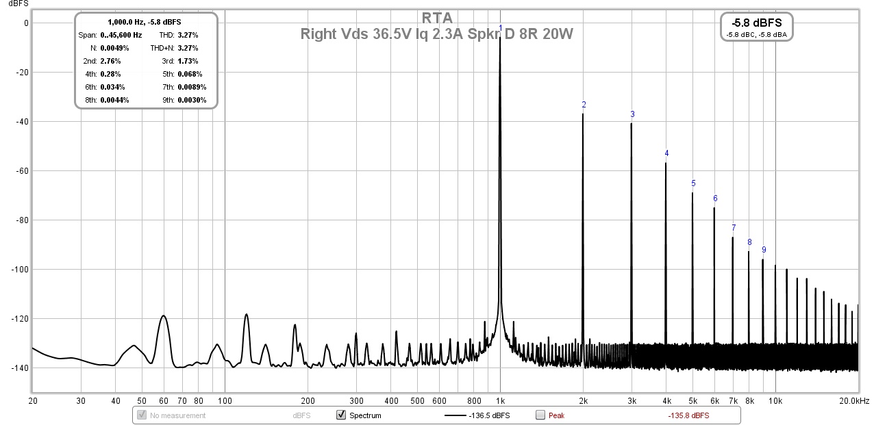

Here are left and right channels, speaker out between 0R3 and 0R3, Vgs=36.5V, Iq=2.3A:
I used Room Equalization Wizard (REW) in conjunction with a Focusrite Scarlett USB sound card.
Howto - Distortion Measurements with REW
