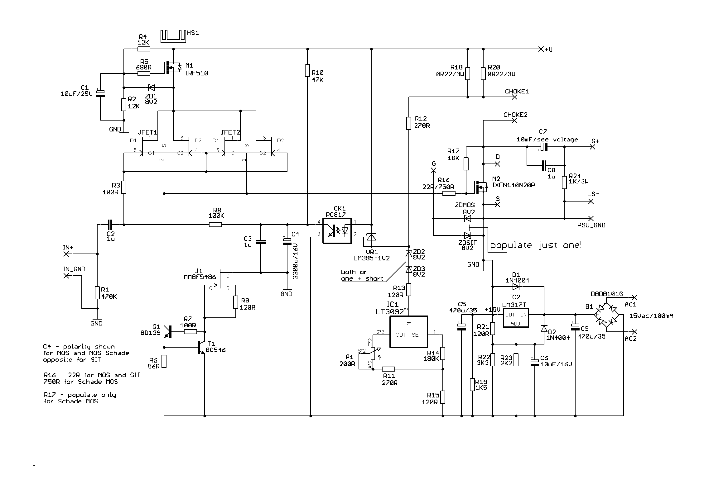

importance of referencing level (where to connect neg pin) of C4 - pin 4 of optocoupler ; ignore 1uF - it's bypass and it follows big one
as is, perfect and genial
though, in final version it'll be connected to neg rail; reason - SITs
what's the Catch?

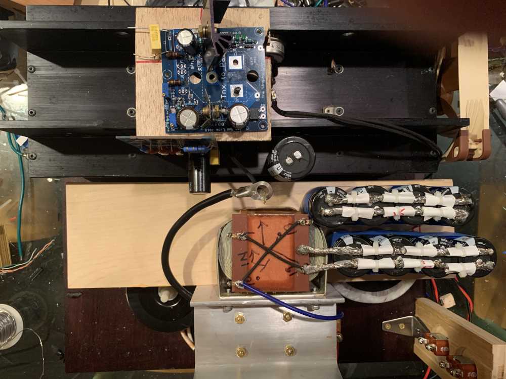

Here is a mock up of the new arrangement.
The large wire is from the negative end of the bridge. I could make it an inch shorter but not sure that is worth the trouble. The wire is a length of the 8 gauge stuff.
All of four of the grounds will be soldered to the ring and will be of equal length.

The cap bank to the front is the last bank electrically - going to the single cap on the ledge via the 1 ohm resistor. (initially two 2R 50 watt resistors in parallel without heat sinking) They get plenty hot.
The bank nearest the heatsink is actually the input cap bank due to the Lundahl's arrangement AND mine.

bummer ........ I'm sure you already wrote that, but I can't find - your PSU arrangement is bridge - LCRC ?
Bridge
Positive lead
40mF - LL2733
40 Mf - 1R
10 mF
entry point on MOSFET
Ground lead - 8 gauge wire with large round connector at the end where all ground converge with wire lengths approx. the same
12 gauge wire from the SIT to the ground which will be the longest length - 16 gauge wires from the caps to the ground - these will be shorter than the 12 gauge lead since they can be and to compensate for the resistive difference (as if I could measure it)

(got it - CLCRC; will draw later)

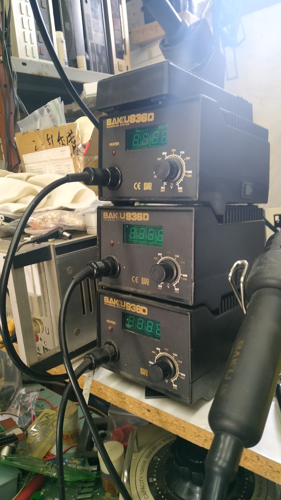

This is the entry level adjustable HAKKO. It has taken many insults previously and this one was the last straw.
No soldering until Tuesday. Do you have a favorite?

no need to move anything, just wire it as I sketched; proper wiring and grounding scheme is more important than length of wires; or - try it and - if that cures noise and buzz, rearrange positions by your liking
my fave Tower of Power attached - copy of Hakko; have 3 - each different tip size - SMD, regular small flat, big 8mm wide

Found out soldering irons require AC.
I was plugging the thing into a unconnected extension cord.
Completely unsurprising.
I figured you would have something good. Better than I would ever need. Luckily this one is working fine.
