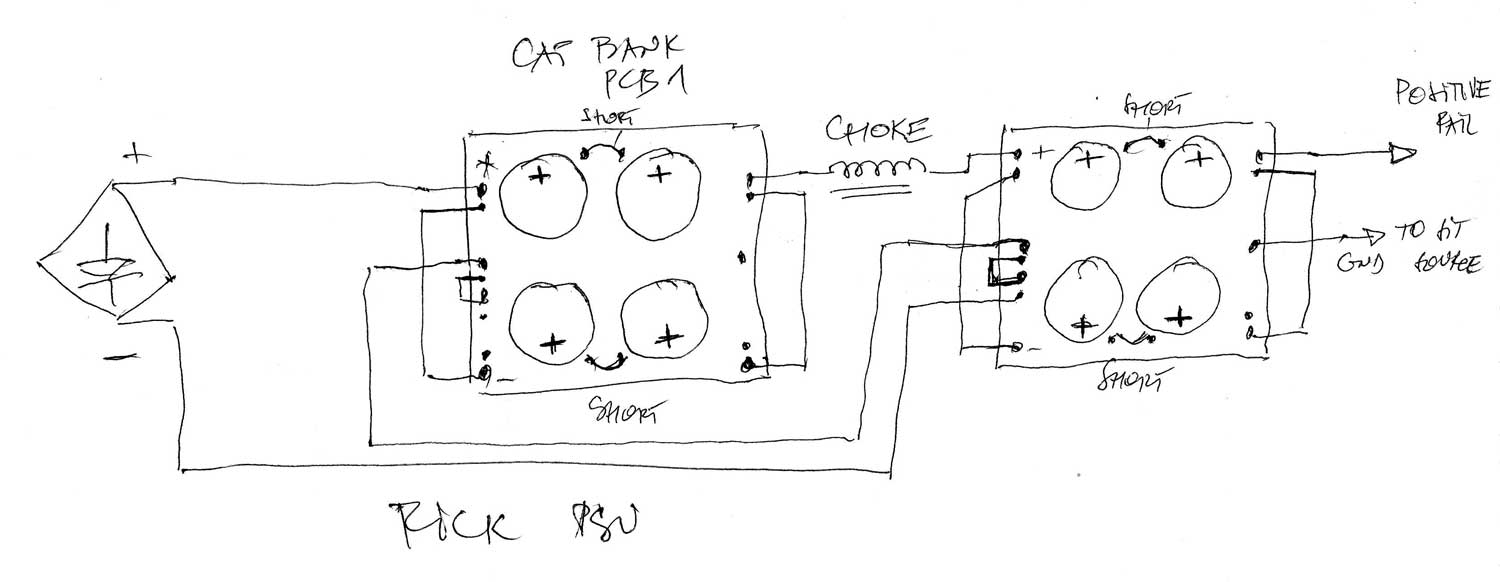

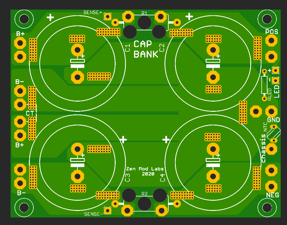

you can use cap bank pcbs I sent you (4pcs I believe) for single rail
I can sketch how, and you'll get even easier wiring scheme, while superior to your fat wire mess
problem with fat is starting with need for proper solder - 8-10mm thick tip, flat knife-like end, 60W min.
temp. inertia you get with massive tip is equally important as power in Watts
further - everything needs to be done in way that cap electrodes/pins are not excessively heated - fast and furious, potent soldering job is what is needed
if soldering isn't made that way, there are contact ...... or even bad cap troubles

first, you need to make me a list for each of 4 channels you have:
1. what is max Iq you can set
2. what is a range you can set output node voltage, ref. to GND
the I can tell specifically what's needed to be done - resistor value change here and there ( everything being in conjunction with border Ugs of either SIT or Mosfet, preventing setting of Kosher value)
will make sketch for you , to use present Cap Bank pcbs
be patient some time, need to feed coffee maker

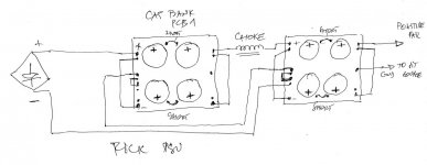

counting on fact that PSU arrangement is as we already have shown above - 4 caps, choke, 4 caps, this is it
route every wire as shown
no need to use wire fatter than 2.5mmsq ; gauge that
if you have them ( and I believe I've sent Plethora of these to you), use needle connector ends - neater and better; toss plastic junk from them , crimp gently, solder wire in connector, solder in pcb
lower two caps on pcb - orient them as shown in pic
short R positions on pcb, one up, one down
if something is not clear, say
cap bank pcb render , for reference

proper wiring is much more important than gauge, once when gauge is enough
now, 4+12 boards - how's that?
I reckon - sketch I posted above - #437, that's how one channel PSU is looking?
if yes, you need 2 boards per channel, 8 overall
