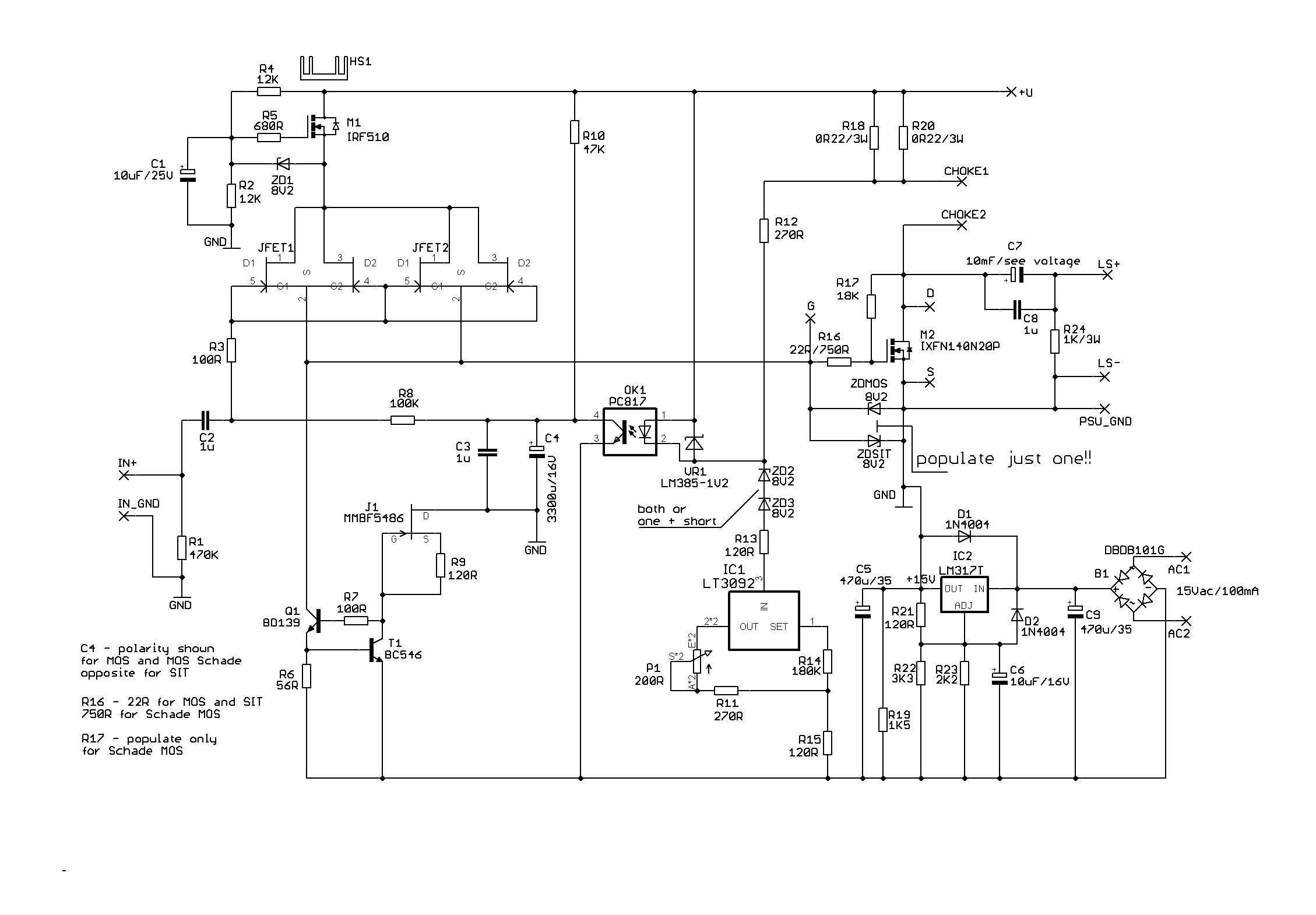

importance of referencing level (where to connect neg pin) of C4 - pin 4 of optocoupler ; ignore 1uF - it's bypass and it follows big one
as is, perfect and genialfor mosfet and Schaded mosfet
though, in final version it'll be connected to neg rail; reason - SITs

Here is ZM’s schematic regarding above comment.

say that C4 connection shown there is resulting in nothing criticall for enhancement part in output
said change (neg side of C4 must go to aux rail) , because as is - is critical for depletion
ignore polarity - treat it as solid cap, for this analysis
The SIT is a depletion mode part with negative Vgs. So Vg has to be less than Vs.
I am guessing that you will raising the Gnd with the LM317 power supply so that the voltage at Gnd will be higher than the voltage at pin 4 to achieve the negative Vgs.
Just guessing. 🙂
I am still confused though with the Gnd

Yes, confused. The Gnd is not elevated. The LM317 is a negative supply that shifts the voltages of the front end so that the voltage at pin 4 is lowered and is negative relative to Gnd.

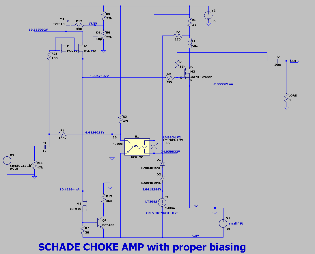

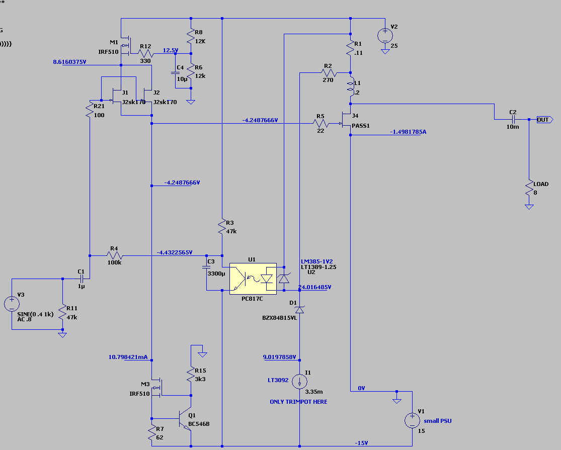

well, things are easy ....... will post sshot of sim with SIT, to confirm your thinking
but reason for C4, it must be connected to aux rail?
if ignoring that, it is certainly more elegant if C4 neg leg is connected to GND

those two things - positive Ugs for Mosfet and Schade, same as neg. Ugs for SIT, are automatically set (with optocoupler action etc.) and that is having nothing with importance where C4 is "grounded"
edit: for this game, take C4 as non-polarised, meaning polarity is not of importance

I'm just going to start throwing out guesses...
- anything to do with establishing the signal's reference between the two PSU's?

OK, I'm softie..... so here's some help:
think what's happening in moment of powering it On ....... all caps are empty
analyze so called transition effects, separately for amp with enhancement part , separately for amp having depletion mode part in OS
start with C4 referenced to GND and, when you got that, move C4 (lower pin) to aux rail

My guess is that at power-off, the negative supply powers down quicker and if C4 is grounded, it discharges through the opto-transistor quickly and the bias voltage for the SIT is lost. Not good for depletion mode.
With C4 not grounded, C4 discharges slower, maintaining bias for a bit longer while the main supply discharges.
