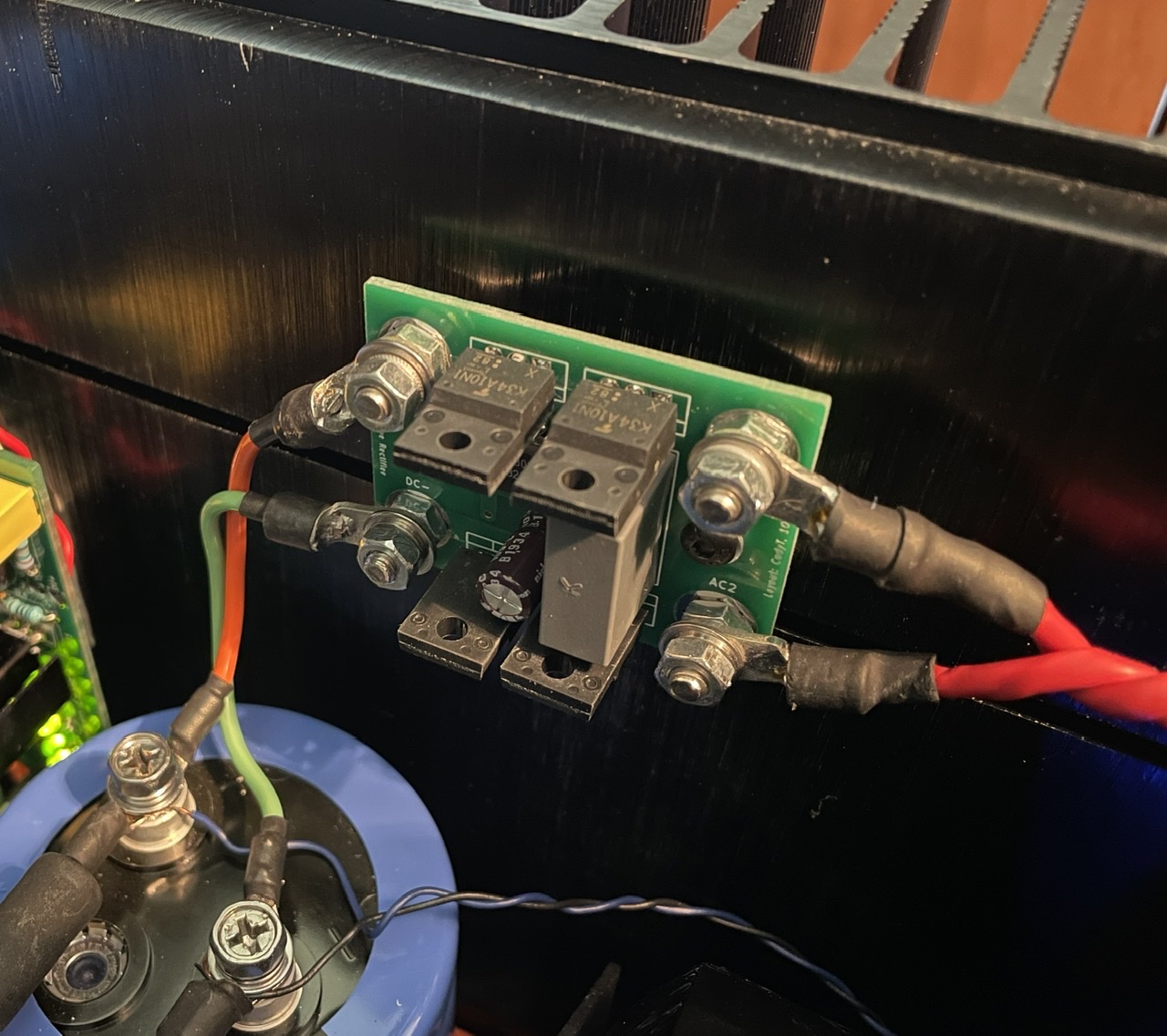

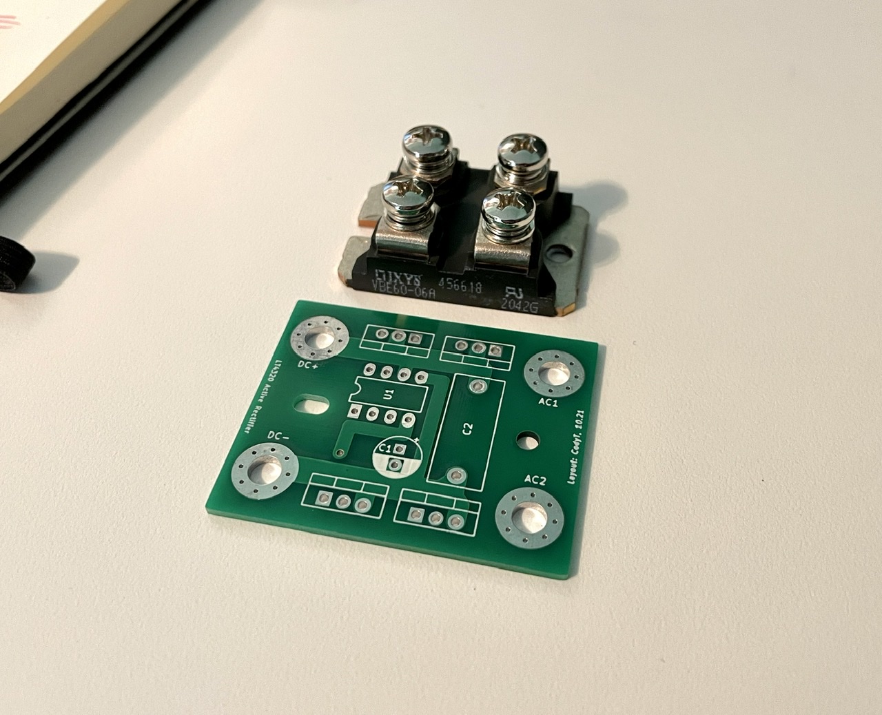

I’d been itching to try the LT4320 active rectifier and designed a board to swap for the fast IXYS sot-227 bridges I’d been using. So far, I’m pretty impressed. I gained an easy 2.5Vdc at the loaded rails. Noise is just as good or better than the diode-based bridge, and the thing is surprisingly cool to the touch. Regarding the impact to sound, I feel like the soundstage depth has gotten even better, and dynamics slightly improved. Who knows though - that could easily be in my head.
I’m going to put them through their paces, and will probably make another layout with some optimizations. Just wanted to share my experience this far.

Hi Cody,
Your LT4320 board is really cool and makes a wonderful drop-in substitute for the
hockey pucks. And having an extra 2.5V is nice.
BTW, did you make any adjustments to the operating point of the 2sk77 with the extra voltage?
Dennis
Hey Dennis –
Thanks! Yeah, I was motivated by laziness and a lack of interest in drilling more holes into my heatsink 🙂 I figured this would allow me to give them a try and see if it was worth a permanent switch. I will say that finding mosfets that fit all of the unique criteria set by the 4320 and have a high enough Vds to accommodate the 60V rails was a bit of a challenge. There's plenty with 100V or 120V Vds, but considering voltage peaks and what not, I don't have quite the headroom I'd normally prefer. I think they'll be fine though.
Regarding operating points, I've tried to maintain my Iq and Vgs as much as possible. To be honest, I'm exploring a bit more resistance in my CRC filter and this gave me the extra voltage to do so. I suppose my ultimate goal here was to lower noise as much as possible. Not that the amp is noisy at all – this is just me obsessing over measurements 🙂

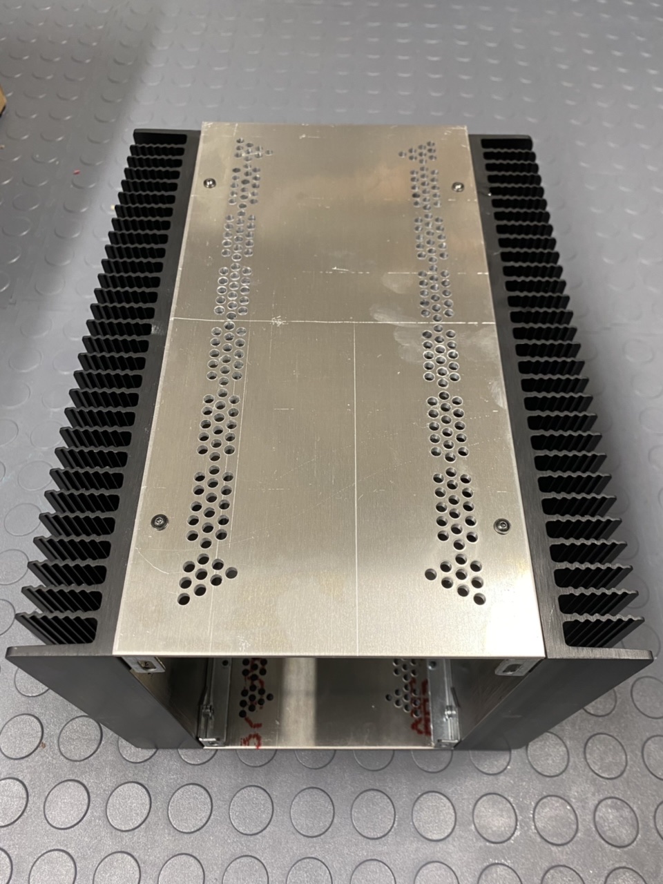

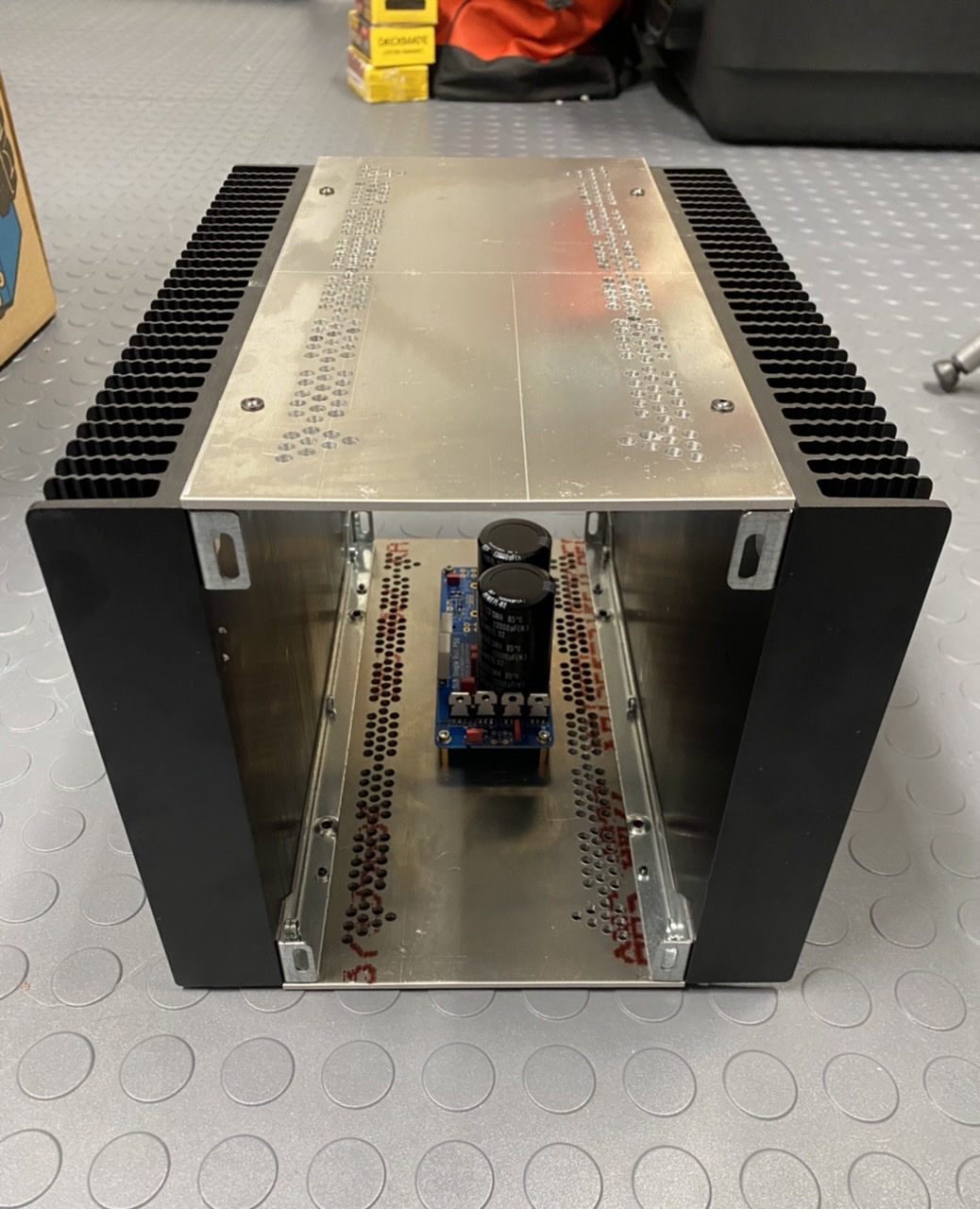

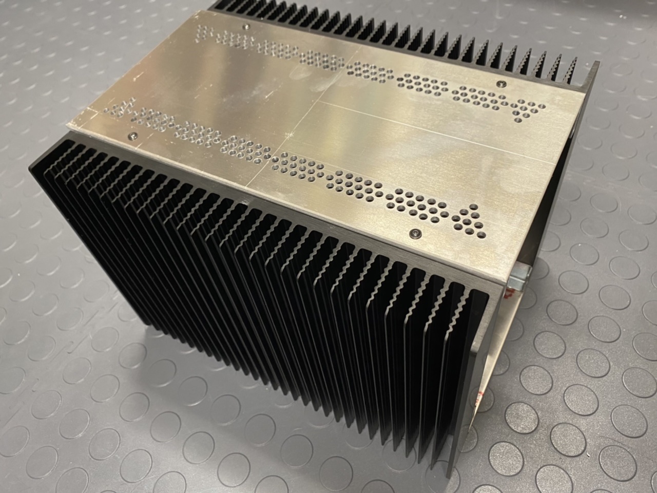

It’s been a few months but I’m finally making some progress. All the ventilation holes are drilled in all four top and bottom plates. Most holes drilled for one channel in the heat sinks. Tomorrow I plan to tap all the heat sink holes and assemble in mock-up form to make sure everything fits one more time before soldering wires.
