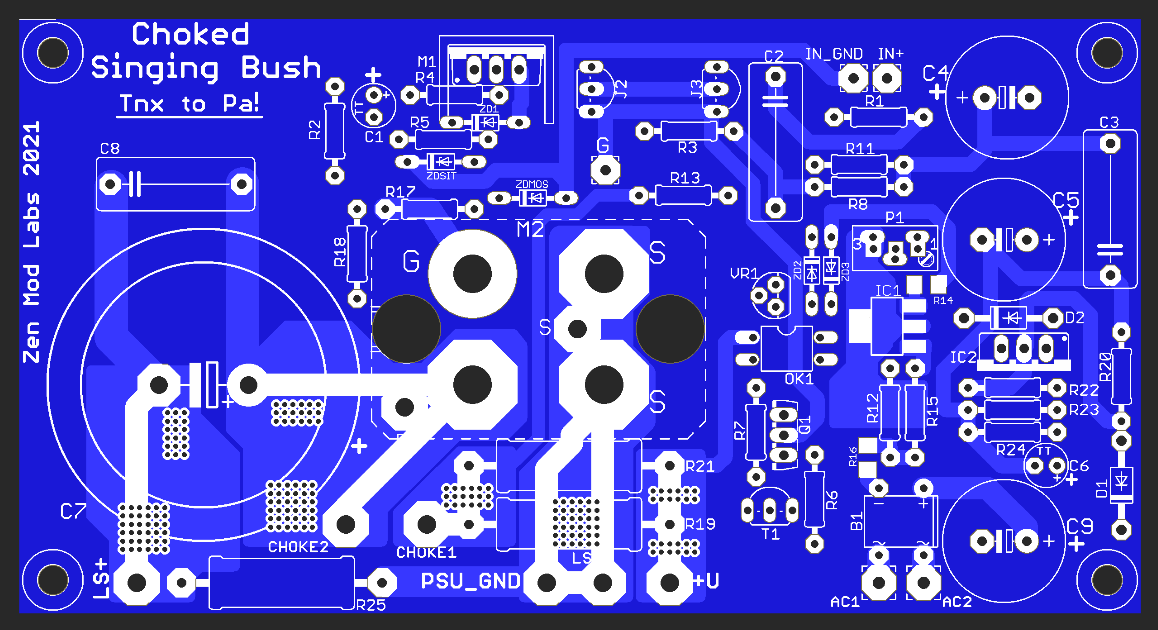

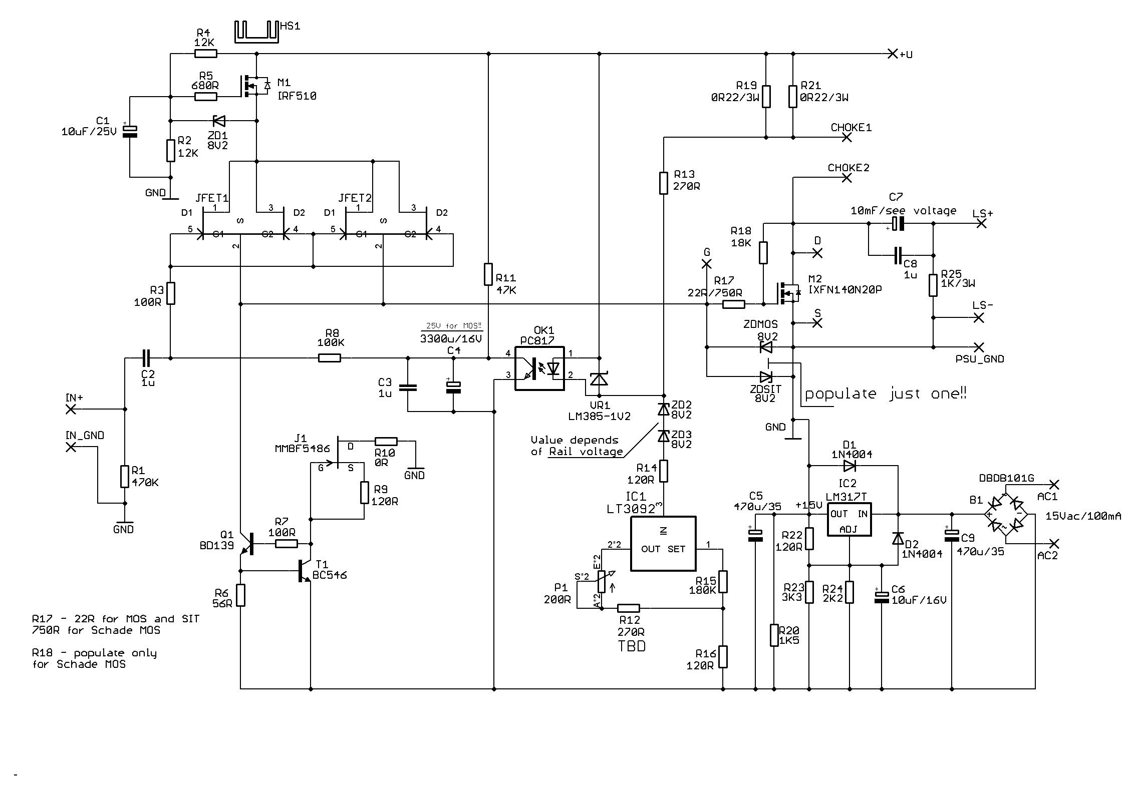

Case A
C4 to GND, initial state (all caps empty, rail rising fast):
- what's Ugs of Mosfet, if mounted in
-what's Ugs of SIT, if mounted in
Case B
C4 to Aux rail, initial state (all caps empty, rail rising fast):

re-read my post with Case A and B
think of moment right after you put amp On
This connection to signal input seems critical. When the cap is terminated to ground, it sets the gate voltage to positive for the MOS; when cap is connected to neg rail, it allows the negative voltage necessary at gate of SIT. That close at all?

C4 to aux rail would require longer time to charge, right? Which means a longer time before SIT bias is ramped up. And that would allow proper time for Vgs to arrive and control conduction?

ref. to post # 462:
Case A:
Mos is closed, opening graduuuuuualy with time
SIT is wide open, BigBadaBoom!!!!!
Case B:
Mos is closed, opening graduuuuuuuuuuuuuuuuuuuuualy with time
SIT is closed , opening graduuuuuuuuuuuuuualy with time
see difference, now?

That’s clever 🙂 I understand the need for those outcomes, but I’ve been trying to wrap my head around why that change in connection creates those circumstances.
simple -
in initial state , C3 is empty, meaning that its both ends are on same voltage potential
that further means :
Case A - top of C3 is on GND potential, SIT source is on GND potential , SIT is open - BigBadaBoom (only resistive of choke and resistive of SIT itself are limiting current from PSU to GND, ignoring internal resistance of PSU itself)
Case B - top of C3 is on Aux rail potential (negative 15V), SIT Source is on GND potential , so well closed; after few moments, small CCS for JFets is kicking in, JFet gate voltage damn low, CCS pumping 11mA current through SIT - GS zener, thus clamping SIT gate to -12V (zener voltage), 'till moment when C3 is fed enough (through 47K from upper rail) to start pushing JFet gate up ......... etc.
simple, isn't it
now, just to see how's output cap gonna charge in real life - don't wanna RCA cone in face, I mean , anywhere outa its own cab
I must apologize - C4 designation evidently left from some sketch, while on two last posted ones , it is C3
So, I'm still Dumbest of them All, I can bet that you could figure it out, only that I didn't made that designation error 🙂
attached - Case B, convenience .......... and imagine 12V zener between SIT gate line ( before gate stopper) and source, with zener cathode to Source
it is convenient to have it, but not necessary for regular functionality ...... only preventing Gremlins with Gremlin made Tube Preamps

Damn, that is clever! That way of explaining is exactly what I needed, thank you. I was 90% there, but a few key things you explained made it click.

I didn't realize or consider that the front end takes a lot longer to come up to voltage than the SIT.

well, one of FE duties is - to govern that fat Gate 🙂
name of the game is to have full control of it, or I'll resort to simple (passive) voltage reg for bias, controlling input buffer gate, and counting on overall thermal conundrum to take me where I want to end
all difference being exactly that - I want it (more or less) same , being cold or hot

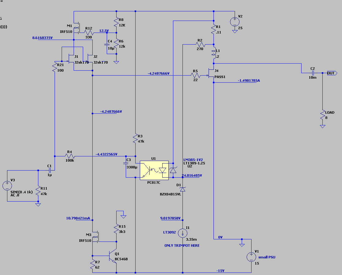

Choked Singing Bush
while I'm there ....... just another one of not planned at all .......
this time - this is complete amp ( well, except PSU and choke)
take any enhanced or depletion part you prefer, toss in
take care of zener polarity and few specific position resistor values, and that's it - summer amp
I can even toss 45R string instead of choke, up rail to 90V, put Pass SIT-1 thingie inside, and call it Babelfish SIT-1
