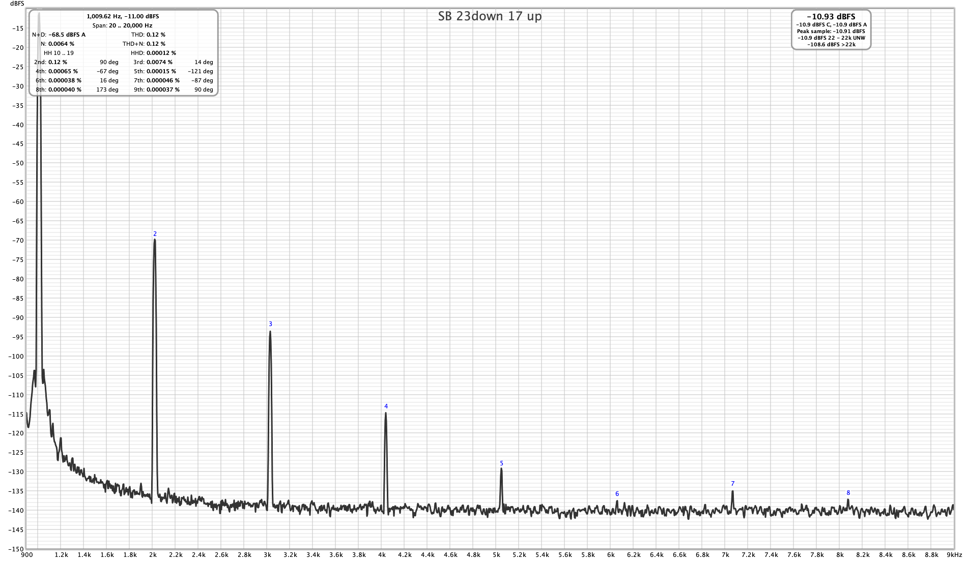

While building my Singing Bush, I soldered some heavy duty pin sockets on two of the five mu resistor spots on the top and bottom. I really didn't intend to deviate from the papa approved .2 up and .2 down, but also know that I can never leave well enough alone. I was really loving the the sound, but was missing some of the clarity I get from the Sony SE VFET amp.
So, I started with a minor adjustment – taking .03R from the top and adding it to the bottom for a cumulative edit to .23 down and .17 up. WOWSA! I was not expecting such a dramatic change! Just that small tweak lowered my THD from .17% to .11% and gave me just the right amount of airiness and clarity I was missing. Since then I've moved the output tap up and down more liberally (never outside of the parameters Nelson suggested), but I ultimately come back to that first, small tweak.

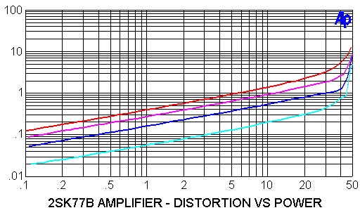

Looking at the graphic Nelson showed during his BAF talk, the THD reduction shouldn't have been a surprise. I just wasn't expecting such a positive improvement in sound. I'm a happy camper 😀

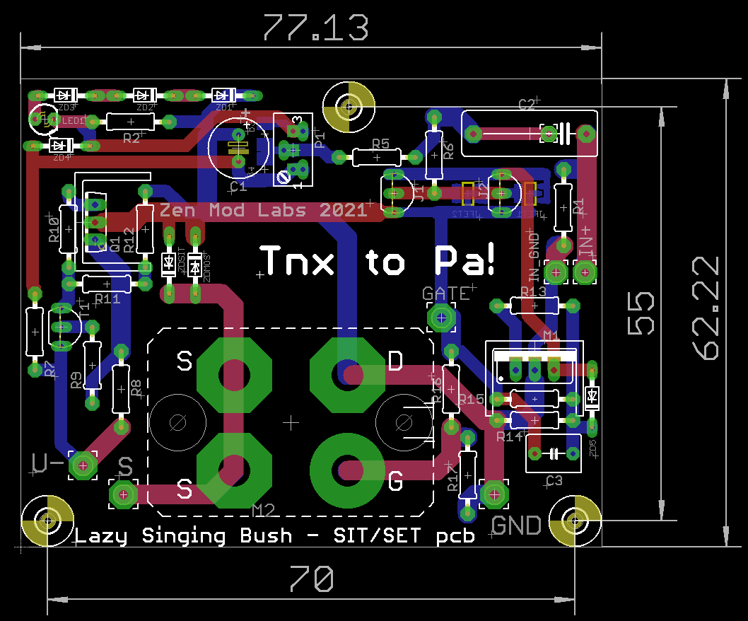

now - I got pcbs for Lazy Singing Bush; have some work to do prior , and I'm sure that LSB will be tried/tested in some random organized moment
anyway - what piece of logic moment was missing - SIT pcb arrangement :

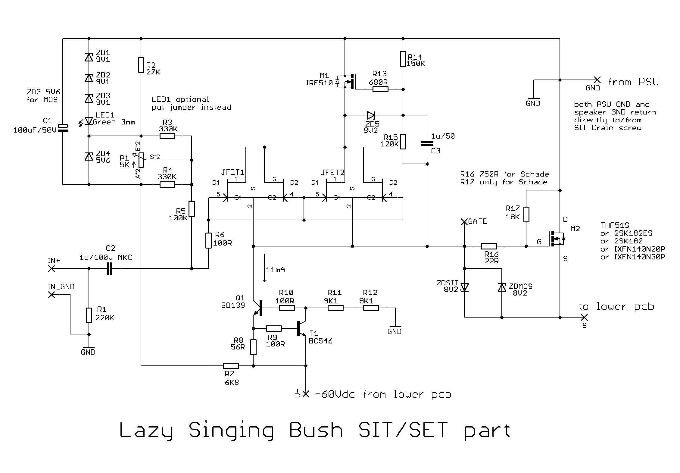

logic is - no need for 2SK77B footprint on pcb (who is going to be nutz enough to waste 2SK77B in follower role?) ...... but I did it anyway that way, simply because I was editing already existing Singing Bush SIT pcb ....
twisted logic
proper logic : since there is no possible way of implementing THF51/2SK182 on pcb itself, wht not putting IXYS puck on pcb, so enabling either SIT with wires to pcb ( energy wires anyway directly bolted to SIT itself) or IXYS Nchannel puck connected in Kosher way ( straight MOS) or even More Kosher way ( as Schade connected MOS)
silly ZM
anyway ........ that option made as file, if everything** goes as predicted/wanted, will order new pcbs
**SIT , straight MOS, Kosher MOS
Well, I at least want to try it. No doubt wasteful though, and I've got THF in the drawer for a more permanent implementation.
But yes, this _is_ the right logic, no doubt about that. I like it. Just save at least one of those 77B footprint PCBs for your nutty yank pal, codyt 😀
I'm curious... you think there'd be audible differences between 77B and the other Tokins in the same topology? I mean, I know it'd just be cool to have the OG vfets in there from a psychological perspective. 🙂
I think so, just based on the lesser thd of the 77B parts. But honestly, I don’t know. I imagine you’d end up with an amp with less thd, but not necessarily one that sounds better.
Doh -- I mixed up the 77B with the old Yamaha VFETs. I guess those were 2SK77(non-B)? The 77B appears to be a more modern SIT? They look to be even more rare than the other SITs -- lucky you 🙂
That's a great point about the THD spectrum being different.
Yeah, I think the 77B was an attempt to make a modern version of the old 77’s. They are amazing parts for sure, and I’m super lucky to have a pair.
