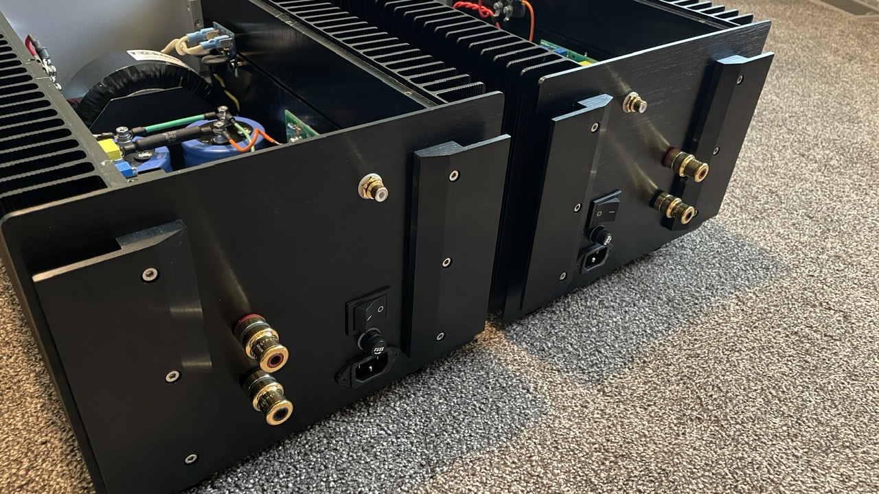

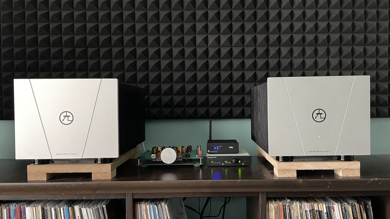

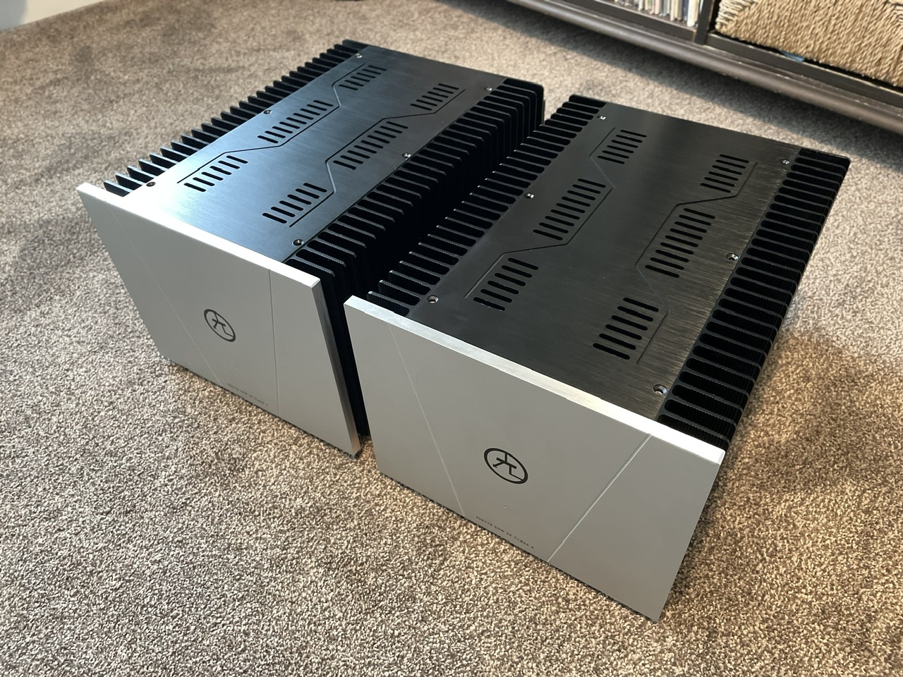

Finally got the monoblocks finished up. New faceplates and some minor wire rerouting. Also swapped the interface material under the transistors with some thermal grease. That change plus the trial babysitters I constructed have made a huge difference. Thanks for the recommendation ZM!

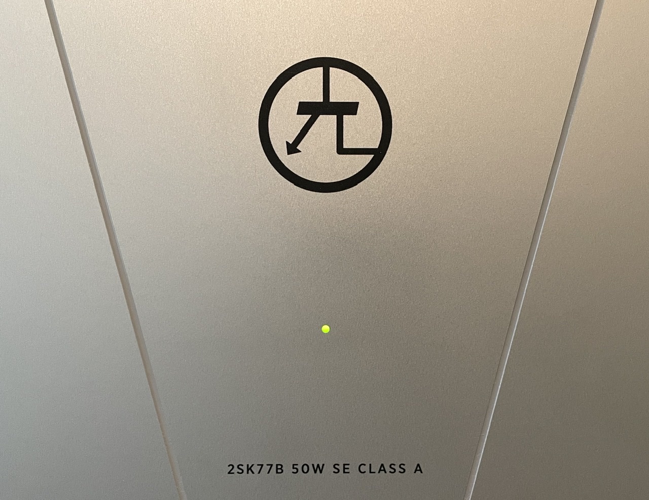

Front plates are a play on the recent Sony DIY design. Went with a green led indicator in tribute to ZM 🙂

ZM, since I didn’t put ‘Singing Bush’ on the front, I at least wanted to hat tip you with a green led 😀
