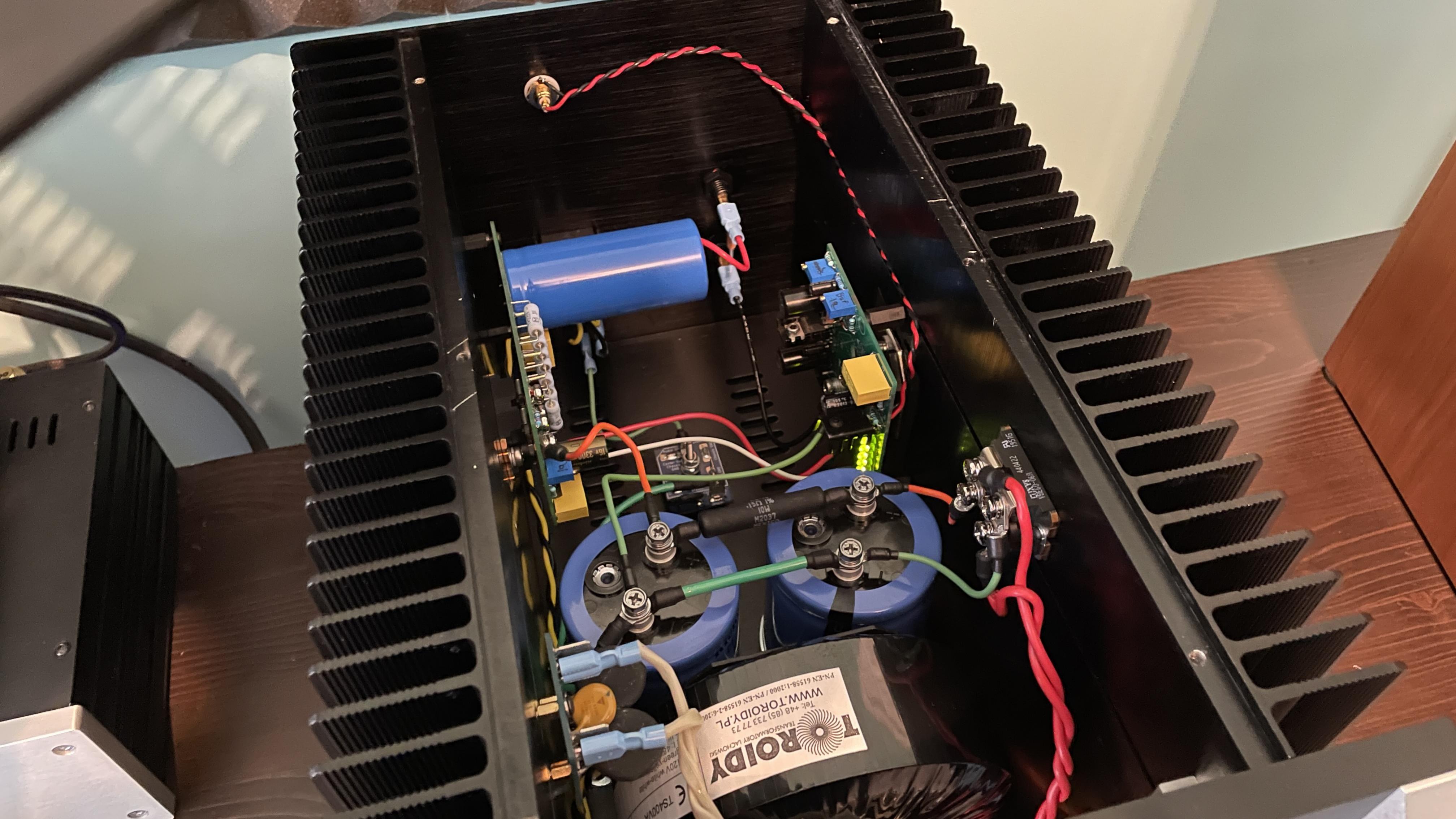

Here’s a higher res pic
if that option is feasible - you can put some 5mm to 10mm spacers (how big - depends whats doing to overall beauty of your amp) between bottom and resto amp, same as between rest of amp and top plate
"rest of amp" in your case being " heatsinks" , as far I can see
that way you're gaining same height slit around entire circumference of covers, plenty of air
also - thermal interface
hardly that anything is better than naked contact, helped with some thermal goop
both amp Biguns, same as IXYS bridge you're using - they're all having metal tab insulated, so no need for isolation
but, you alreay know that (wrote for Greenhhorns :clown: ) - having screws not isolated
what I meant is - Berquist pads are nice and not messy, but I'm not buying them as better than direct and little messier solution
Yeah, I triple checked that all the devices had their bottom plates isolated, as I had no clue about the biguns. I debated goop vs therm pads, and I chose the pads just for the lack of mess (and my lack of experience with goop). That said, my plan is to monitor temps and switch to goop if needed. Each bigun is having its own 5U 350mm sink, and have my fingers crossed that’ll be enough.

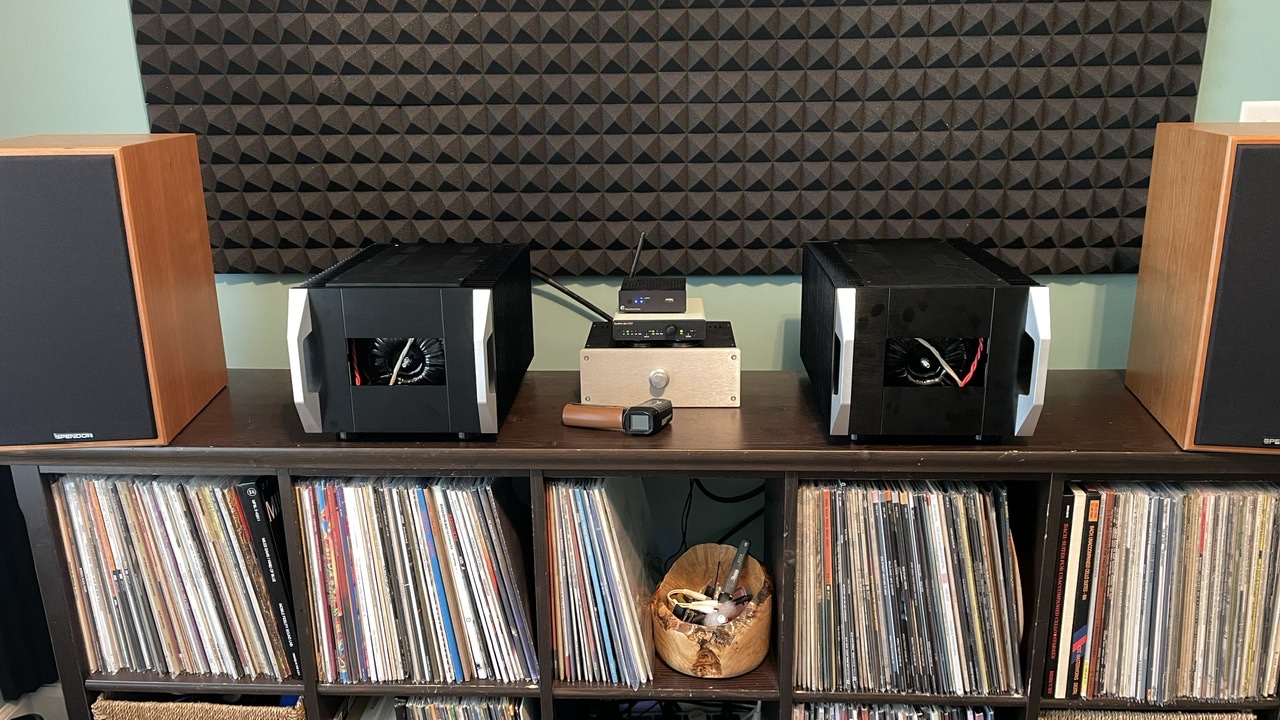

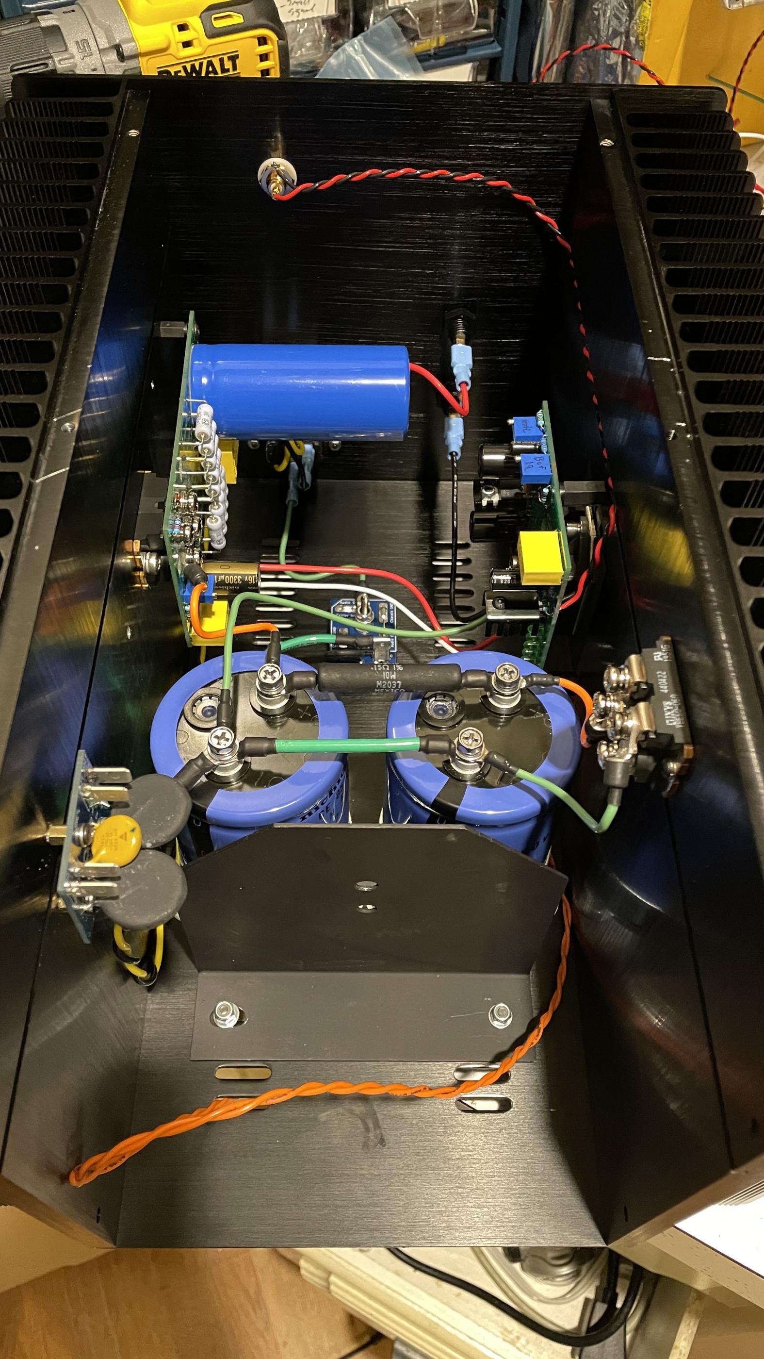

It’s alive!!! The pair of monoblocks are complete (save for the final front panels) and making music!!
The build and start-up process could not have gone better. I hope to post some measurements, temps, details, impressions and more pics soon. In the meantime, here are a few higher res pics for ZM 🙂
I’ll keep saying this, but thank you, thank you, THANK YOU to ZM and Pa for making these amps possible (in more ways than one…) :cheers:
