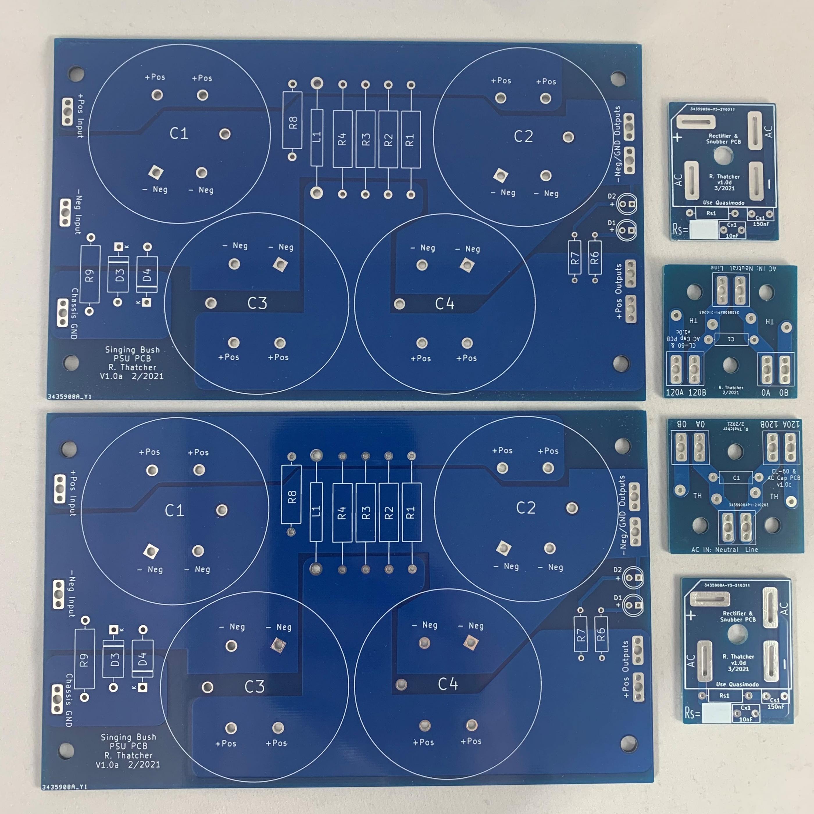

I got PCB's in for making my buddy's amp. Botte's concept with some tweaks. I made extras assuming some of you may want some.
If you're interested, head over the GB forum for details.
GB: Singing Bush Power Supply PCB Kit

that one perfect for stereo Singing Bush
though, you'll need proper big case, to get rid of heat of both channels
regarding aux windings, you got it right - if 12V sec result in little dirty regged rail, change to 18Vac and put smalllllllll heatsink on LM reg
current consumption is smidge above buffer Iq, so 20mA roughly plus some 10mA in reg itself...... so dissipation increase, ref to prescribed 15Vac secondary is just 90mW
So I’m starting to plan and gather parts for a monoblocks SIT version of Singin’ Bush. I’m looking at this 400VA, 45V Antek trafo (x2), which will give me the current I need when I parallel the two 45V secondary’s. My question - is it better to parallel the two AC lines and rectify together, or rectify each secondary separate and parallel the DC output?
AS-4445 - 400VA 45V Transformer - AnTek Products Corp
50Vac secondary is more likely to get you where needed ...... expecting multiplier in range of 1.25 to 1.3 ..... with usual CRC or CLC filtering jobbie
ZM is Chicken- directly paralleling windings only when I'm sure they're bifillary wound
if not, each secondary getting own Graetz bridge, then connecting them in parallel, after bridges
