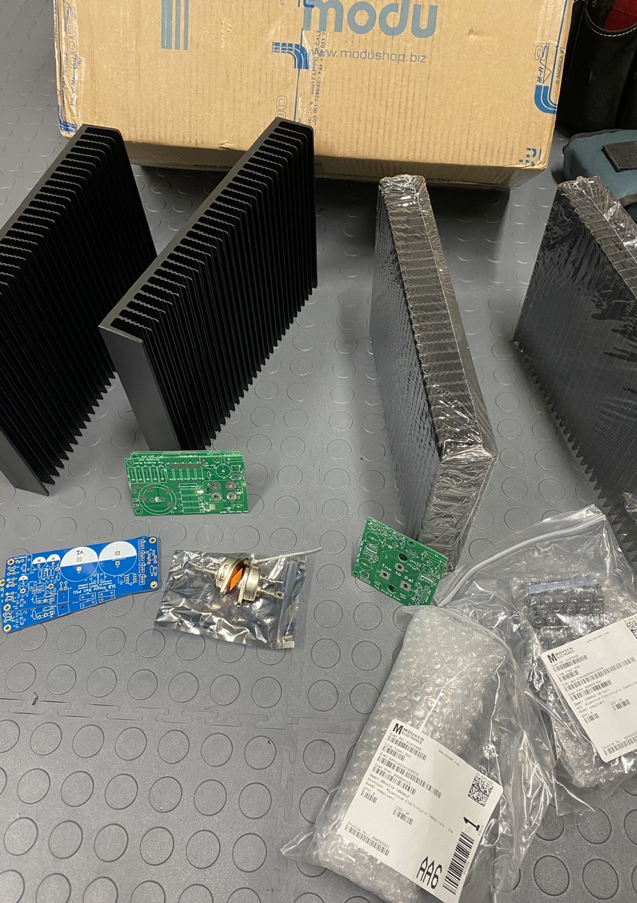

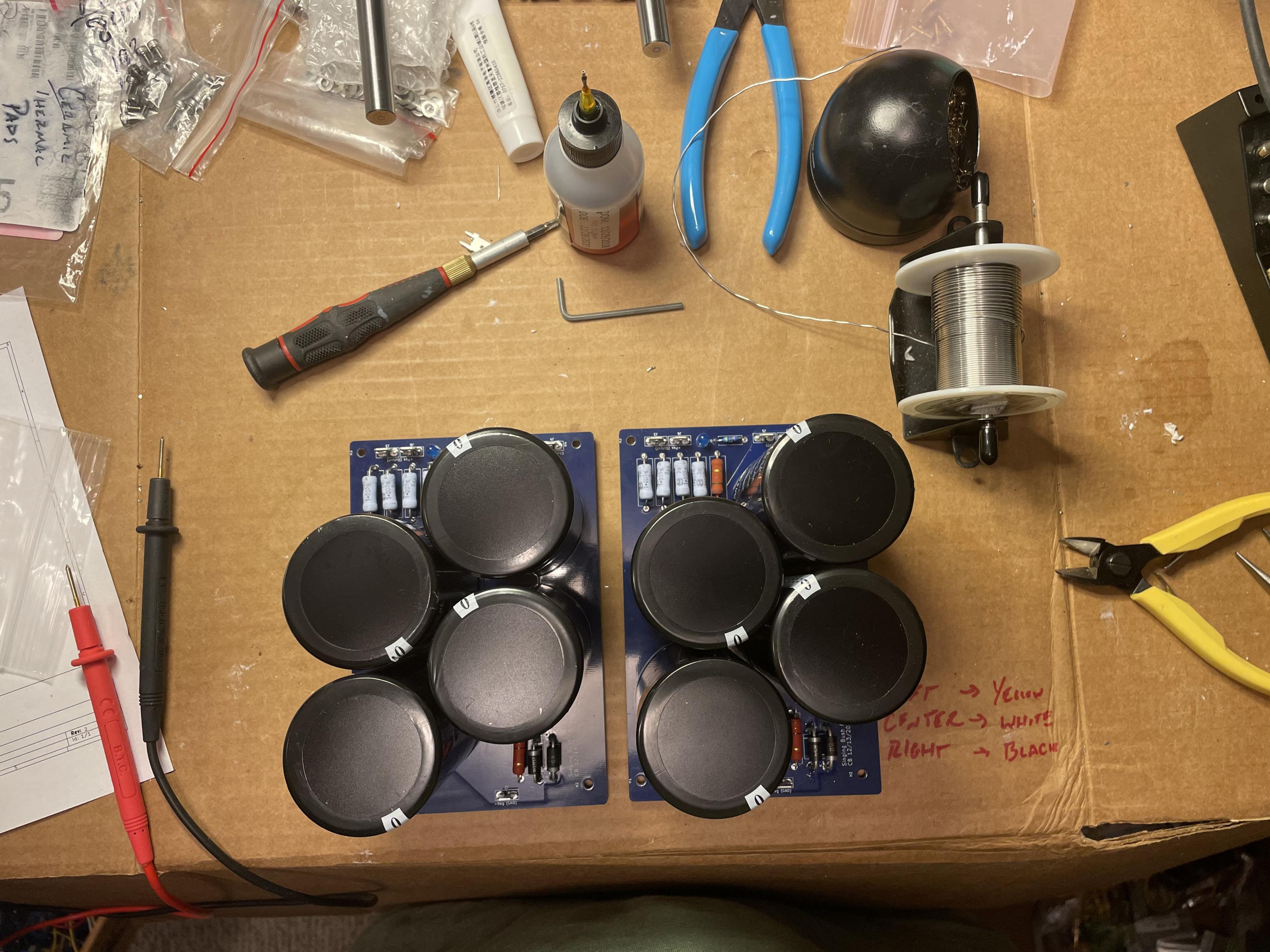

I finally got all my parts to (crossing fingers) get back to work on the Singing Bush. I haven't forgotten.
A little teaser of the filter boards for the PSU. Thanks again to Botte for the PCB design!!!

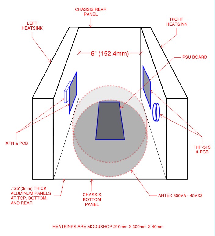

Yes, rhthatcher! Thank you for tracking that one down. I thought there had been a similar layout but I couldn’t find it. So it appears thermal tracking between devices is not an issue if they are on opposite sides of the chassis?
Thank you Ben! Yes, I know the diagram is a little crude. The shaded element in front is a vertically mounted transformer. A few weeks ago I found some .125” thick 2” x 4” aluminum angle on flea bay that was precut into 1-3/4” wide pieces. I used one in the BabelJ2 I just finished and it worked great to hold that transformer vertically to the baseplate of the chassis.
