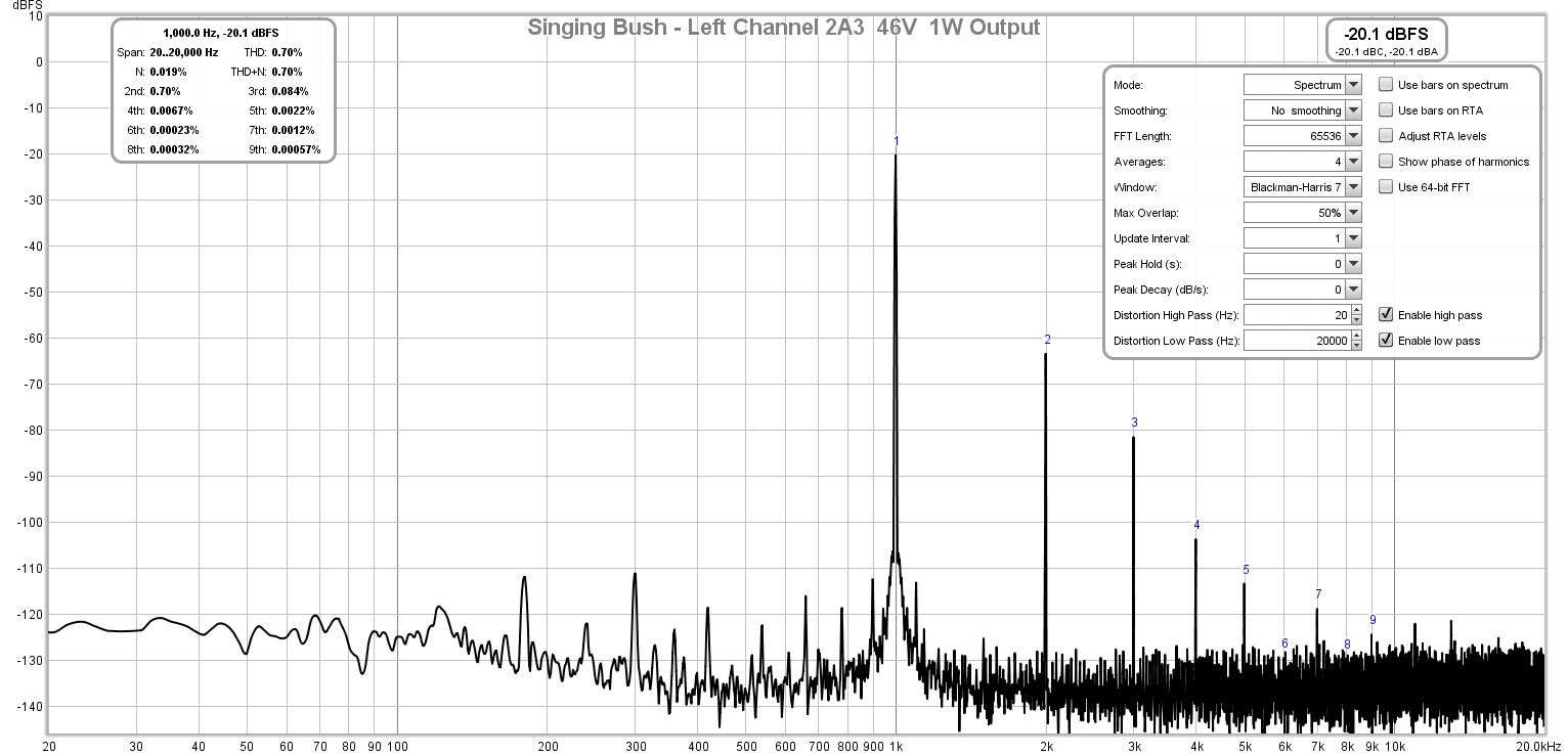

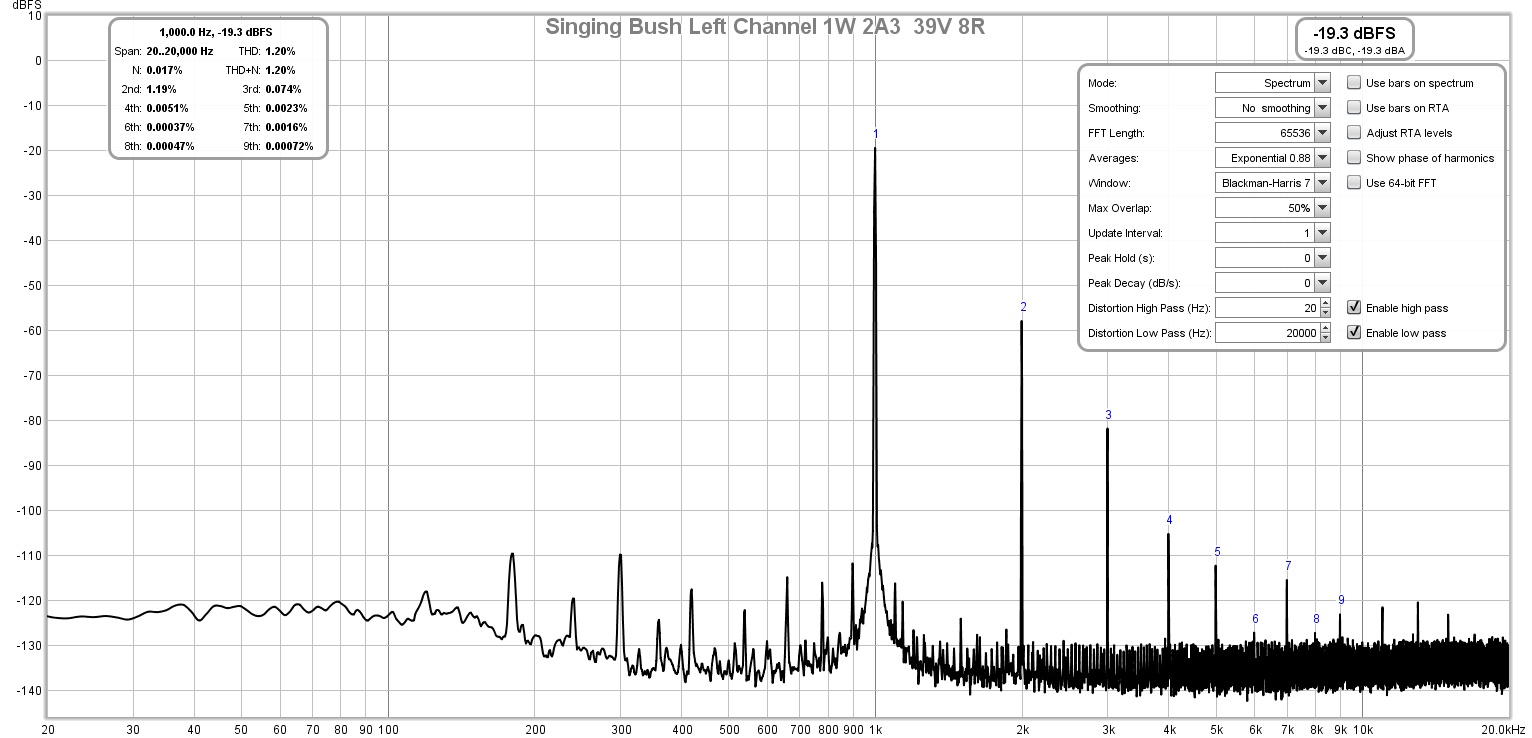

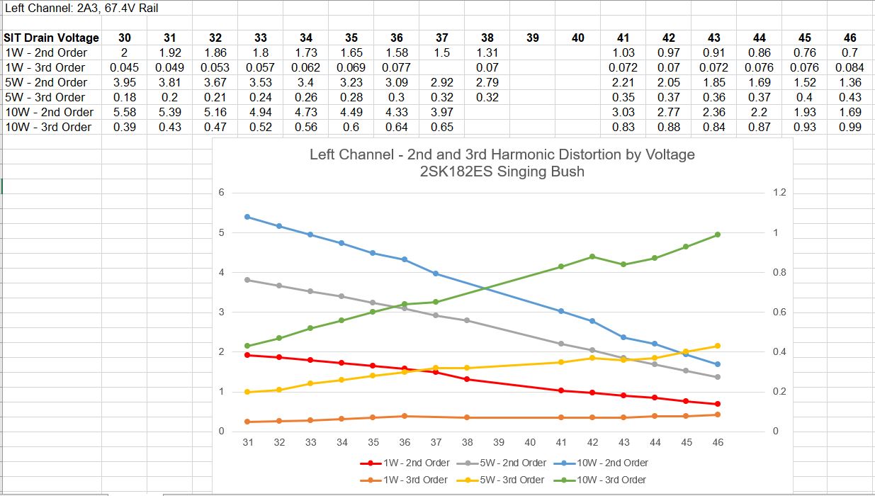

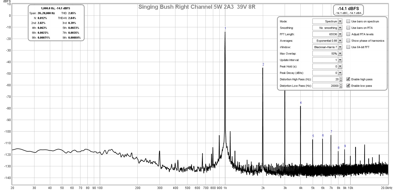

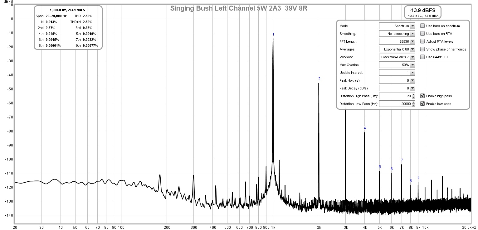

I started measuring in REW at 1W, 5W, and 10W. I printed a sheet to write down distortions while ramping up from 30V-37V.
At first I thought my distortion figures were way out of whack compared to what you and BenMah were showing, but I think what I'm seeing is I need to turn up the voltages.
I noticed the trend that 2nd order distortion kept dropping as SIT drain voltage increased. And 3rd order moves up.
I got to 46V and wanted to check here before I try too high and let magic smoke out of something...
Now I'm wondering.
How high CAN the drain voltage go?
How high SHOULD it go?
Background facts: 2SK182ES, 2A3, 67.4V Rail Voltage
Both channels track in a similar fashion.

do not go more than 5V above Urail/2
in your case (67.4/2) + 5 = 38V7 so ....... 39V
more, and there is much hotter SIT than puck, and also you're cutting much from output voltage envelope , from upper side, resulting in lesser power
not a problem with efficient spks, but still a problem..... one of the reasons to make a Beast is to have power for funny peaks
Super - thank you!!!! Exactly what I needed to know. I'll set for 39v for now - then it goes into the horn rig.

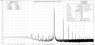

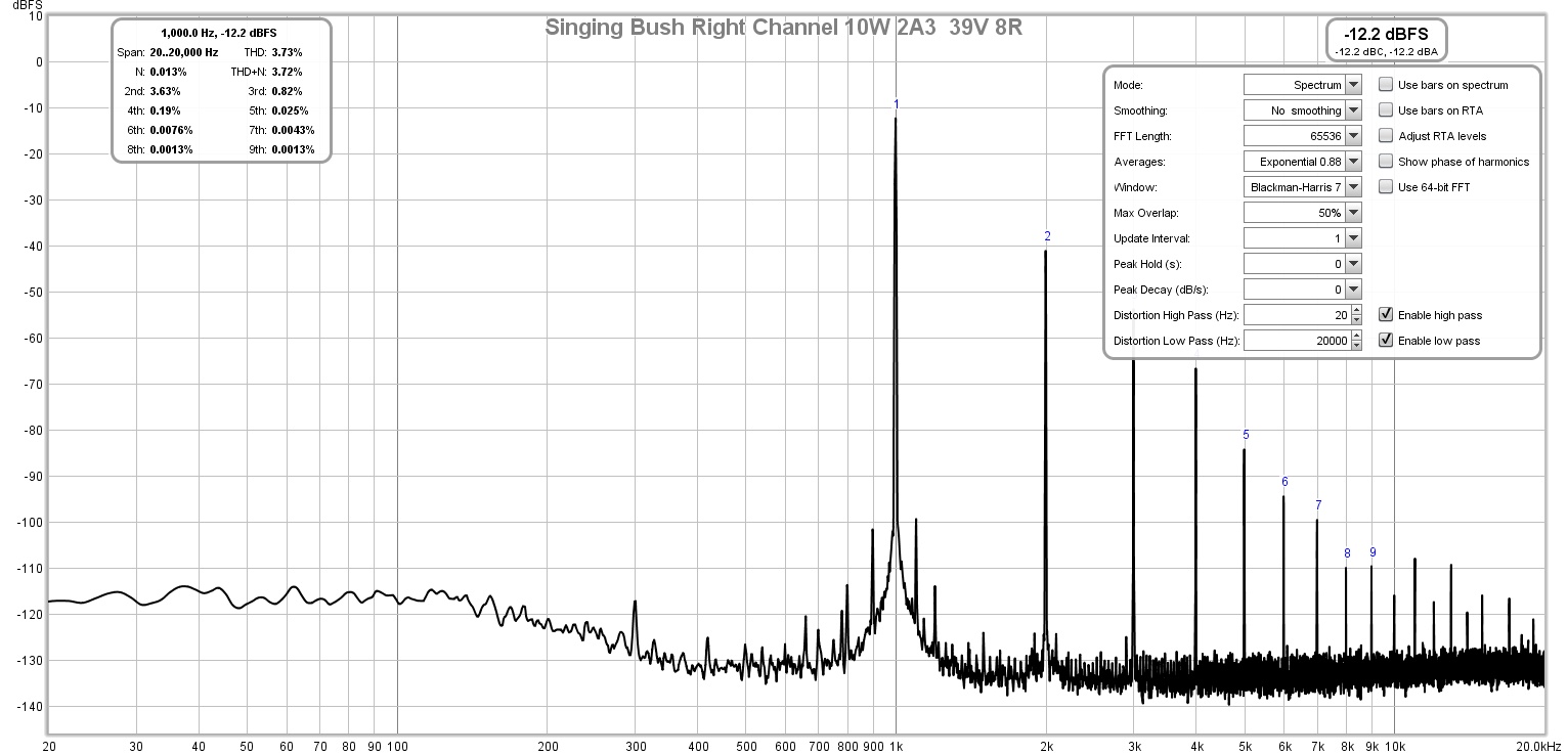

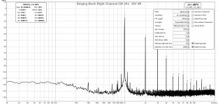

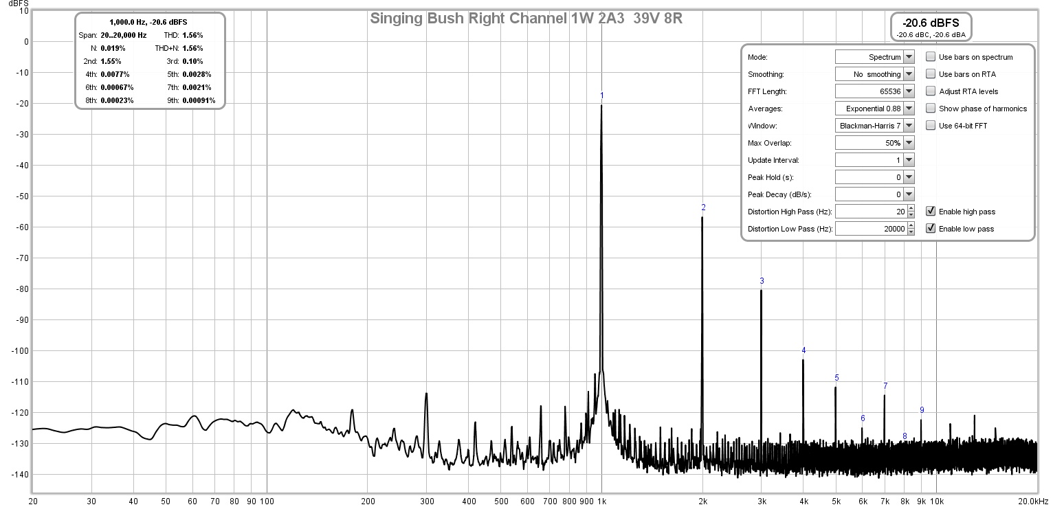

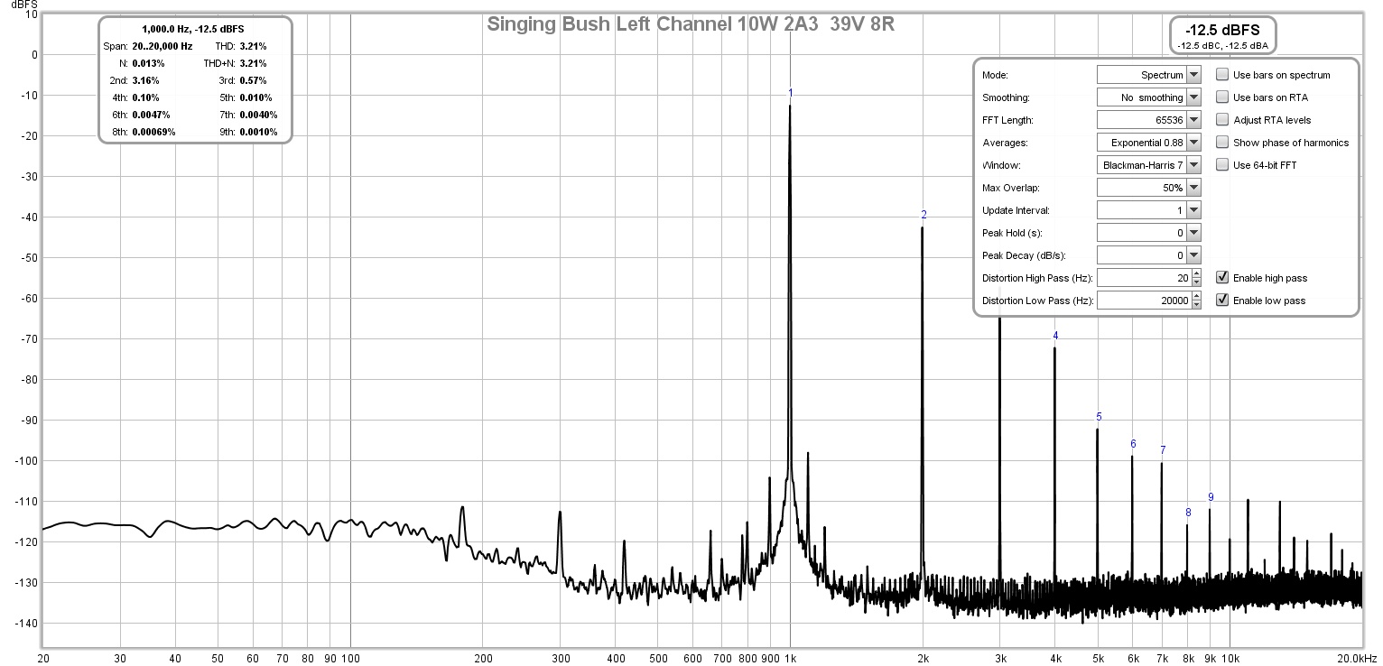

My measurements. 2SK182ES. 500VA dual donuts. 67.4V Rails. 2A3 Iq. 39V @ SIT Drain. 8R

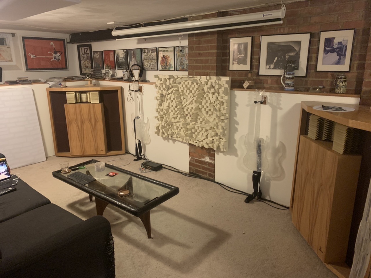

I first heard the classic audio reproduction jbl’s at Midwest audio fest long ago. I was smitten. I found these reproductions on audiomart a few years ago and the price was right. They were located about a mile from my old office in south San Francisco. So I arranged a visit during a biz trip. They all checked out and I made a deal. This was a definite “beg for forgiveness, don’t ask for permission” scenario with my wife. I felt like I hit the jackpot on these. I have added the fostex super tweeters because the JBL compression drivers drop off hard at 10k. And later I hit another jackpot getting a Danley DTS-10 horn sub. It’s all run with an active xover in my DEQX preamp. Crown k2 on subs. Adcom 555 on 15”. SIT 500 hz and up.

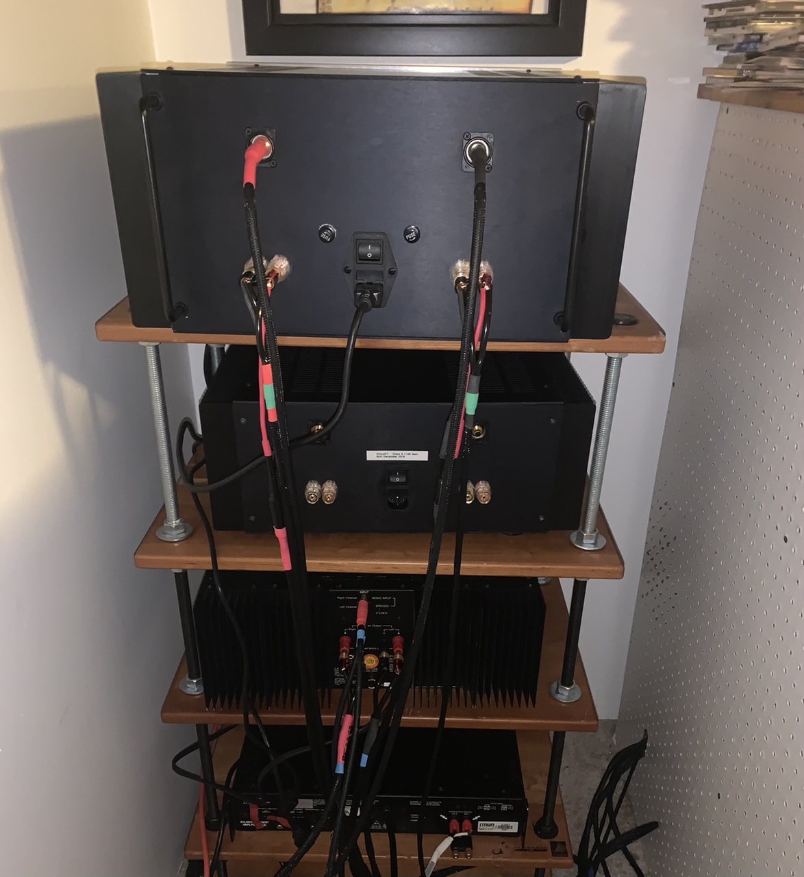

I have 2 SissySITs (one at a friend's house now), and I'm building that friend Singing Bush Monoblocks after he orders some parts. I'll put his SB Mono's in place of the Adcom for a test! I was running an F5 in that position, but I wanted more power.

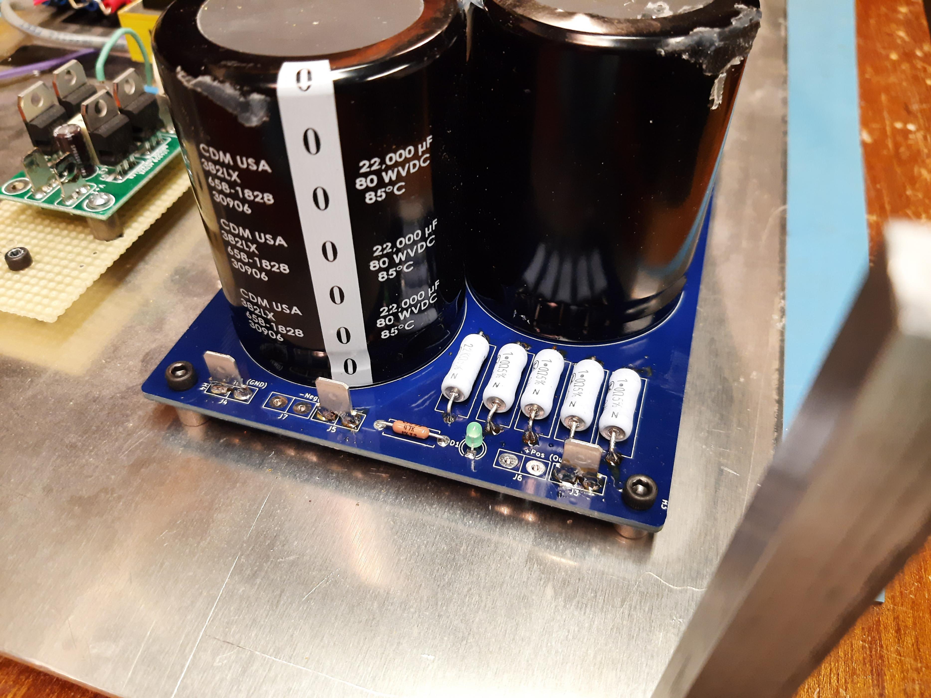

It will be much better without the hum, but after all that effort, I wanted to enjoy it a bit! I'm planning on telling my buddy to go for AS-3450's for his Monos. I'm also going to use 15kuF caps x 8 on spare DIYAudio boards I have on the shelf rather than the beer can sized caps I used. Live and learn. It looks like 4U Deluxe will fit everything nicely for a monoblock.

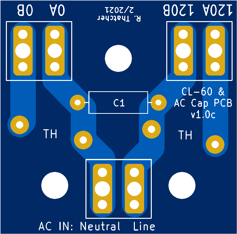

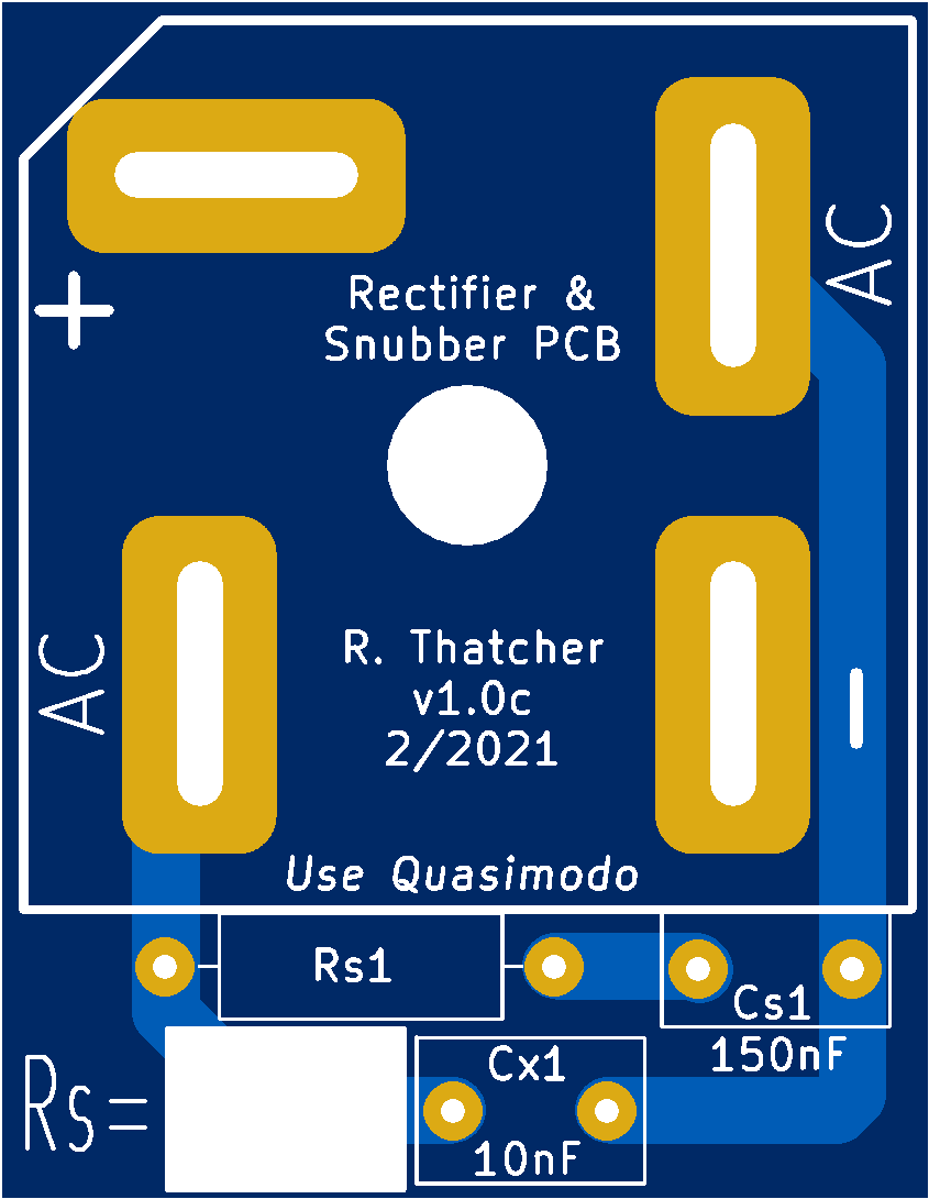

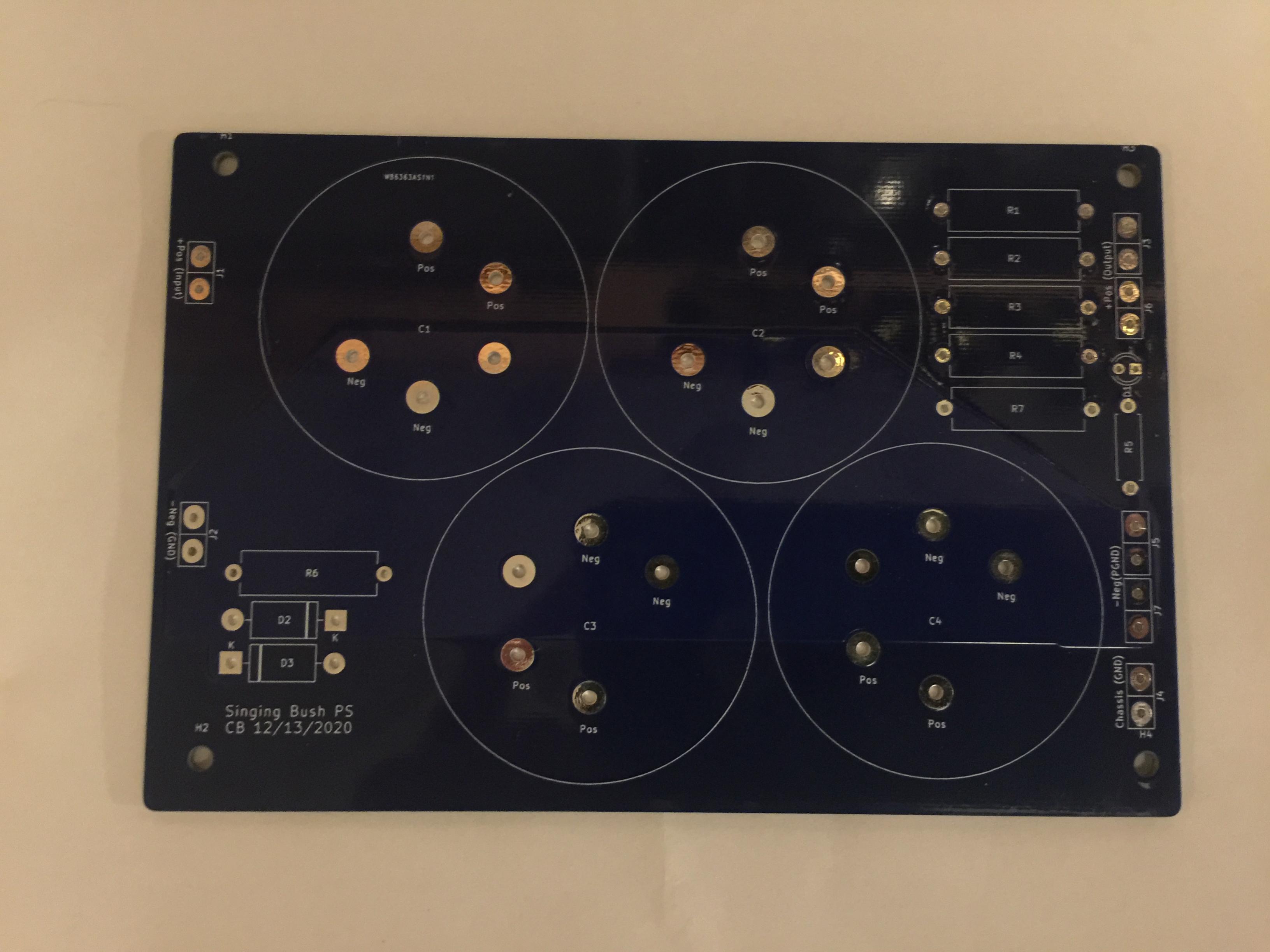

Botte designed the PCBs for me. He included my wish list: diode-incorporated ground lift, LED, bleeder, space for 50mm caps, 4 "pi resistors", and spacing at inputs and outputs for "Fast-On" connections. Mounting holes align with the ModuShop base plates.
I ordered them in 3oz copper from PCBWay.
Attached with Botte's blessing are the schematic, Gerber files, and a pic of an unpopulated board.
Thanks Botte!!!!!
Thanks Botte!!!!!
Excellent idea! I just ordered 10 boards, 2 are spoken for to go into my buddy’s monos. I tacked it on to another pcb order currently being fabbed. I expect it will be a little while until they’re ready to ship with lunar new year holiday.
I added ability to put in a choke, added a 2nd LED (on for board, one to run a wire to the front panel). I tweaked the layout to put the same copper on both sides of boards. Connection to the board can be via quick disconnect spades or hardwired.
