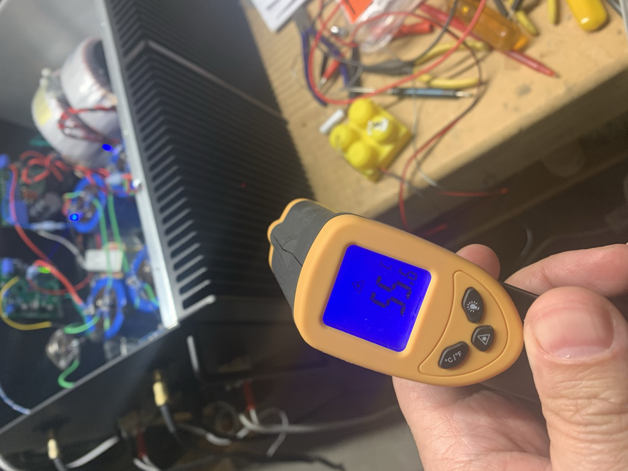

Temperatures:
Room: 19C
Top of chassis: 31C
Donut: 36C
Top of heatsink 51C
Aim thermal gun at outside of heatsink around location of SIT: 55C

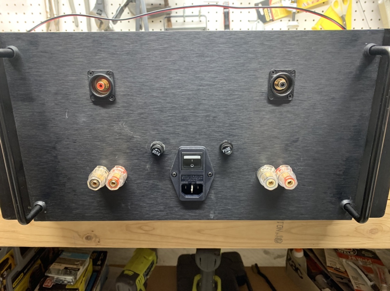

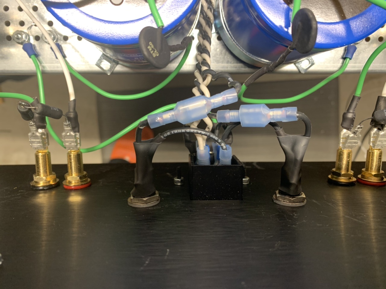

I currently have have one pair of fuses feeding both donuts. Easy enough to install additional fuse holders. I'll order them today.

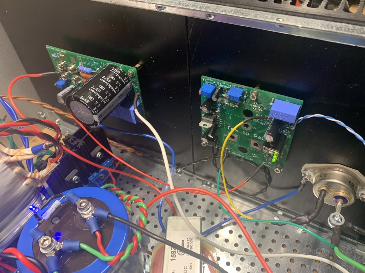

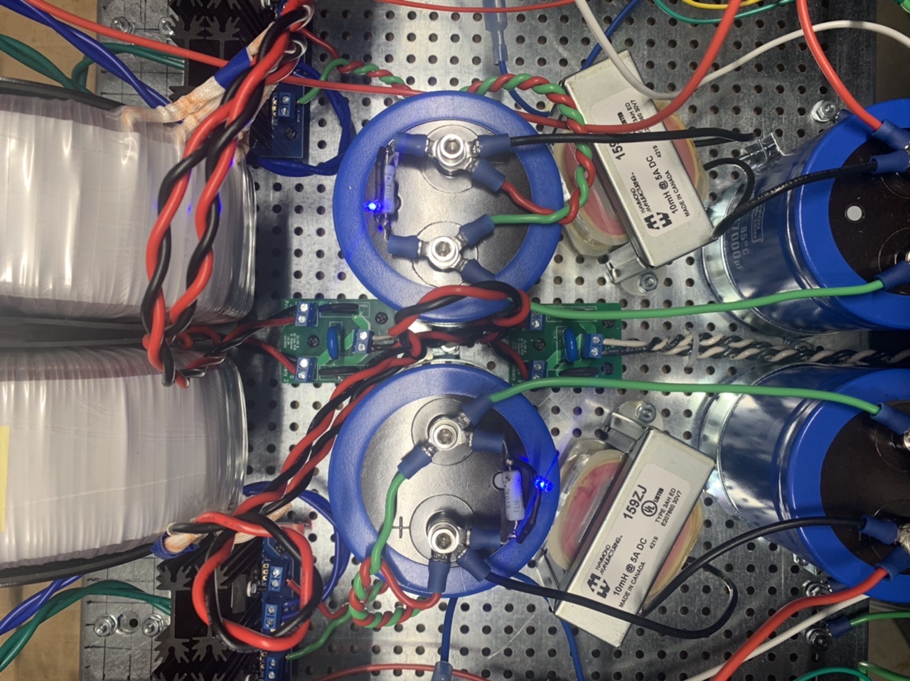

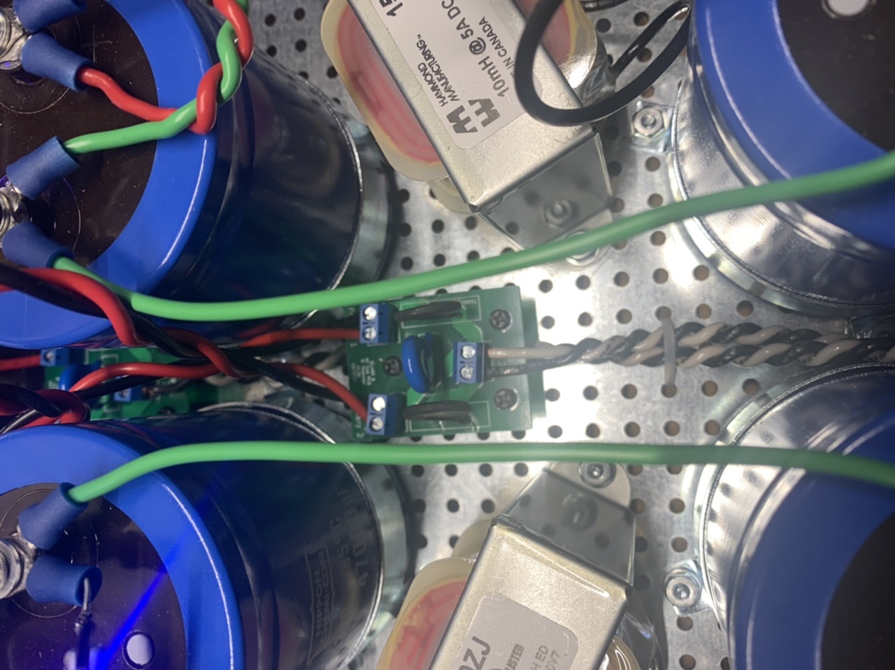

Mains power goes like this: switch, fuses (line + neutral), then split to 2 sets of mains wires. Each pair goes to a little CL-60 & AC Cap PCB, then to donut. The CL-60 board has 1 NTC per primary winding like F5 PSU drawing.
First things first I'll add additional fuse holders. I have new and improved CL60 PCB's in fab in china now, and I expect I'll have them in a week. I could try CL30's. I put those in my friend's F5 V3 Turbo's.

just give separate fuses to each Donut and you're good ...... be it pair or just one (in Europe, most of countries are not having oriented mains (neither plug nor wall thingie) and most gadgets having fuse are having it just in one line ; dunno, it is more logical to have both neutral and live fused, but logic is not what real life is)
in that case, one CL60 per Donut would do the work, no need to change

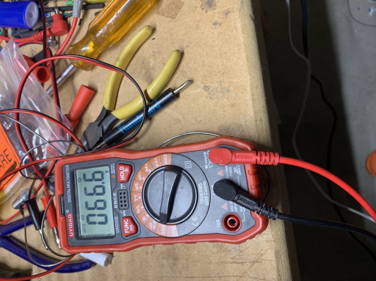

After long cooking session I checked Iq and drain voltage for adjustment. One channel IQ check is great. 2A3/460mv. Other channel I adjust at 458, 459, click click click. Leave it alone? Or should I drop in a different value at R1 on mu board? 8k? 7k5?
damn
I'm so old that I can't differentiate 459 and 460mV
what's percentage ?
0.21%
(besides fact that you can't blindly trust to anyone, writing anything on the web, so why 460 should be carved in the stone? just back-down other channel to 459mV)

I haven’t gotten into playing with operating points. It is 2.3A the max? As it stands I can’t go higher. Or is the magic in playing with drain voltage?
2A3 is pretty much what group of source resistors at Mu mosfet are allowing
feel free to fire up THD Spectra measuring rig and xperiment until you find better combo of Iq and output node voltage (still keep it sorta middish of rail), which your ears prefer
that combo ( which you get with schm values) is pretty much best I could find, with that rail

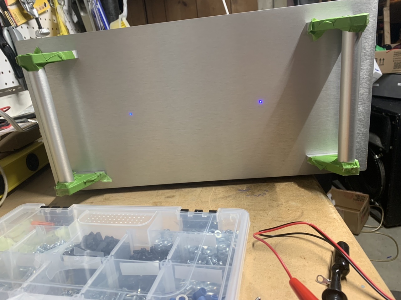

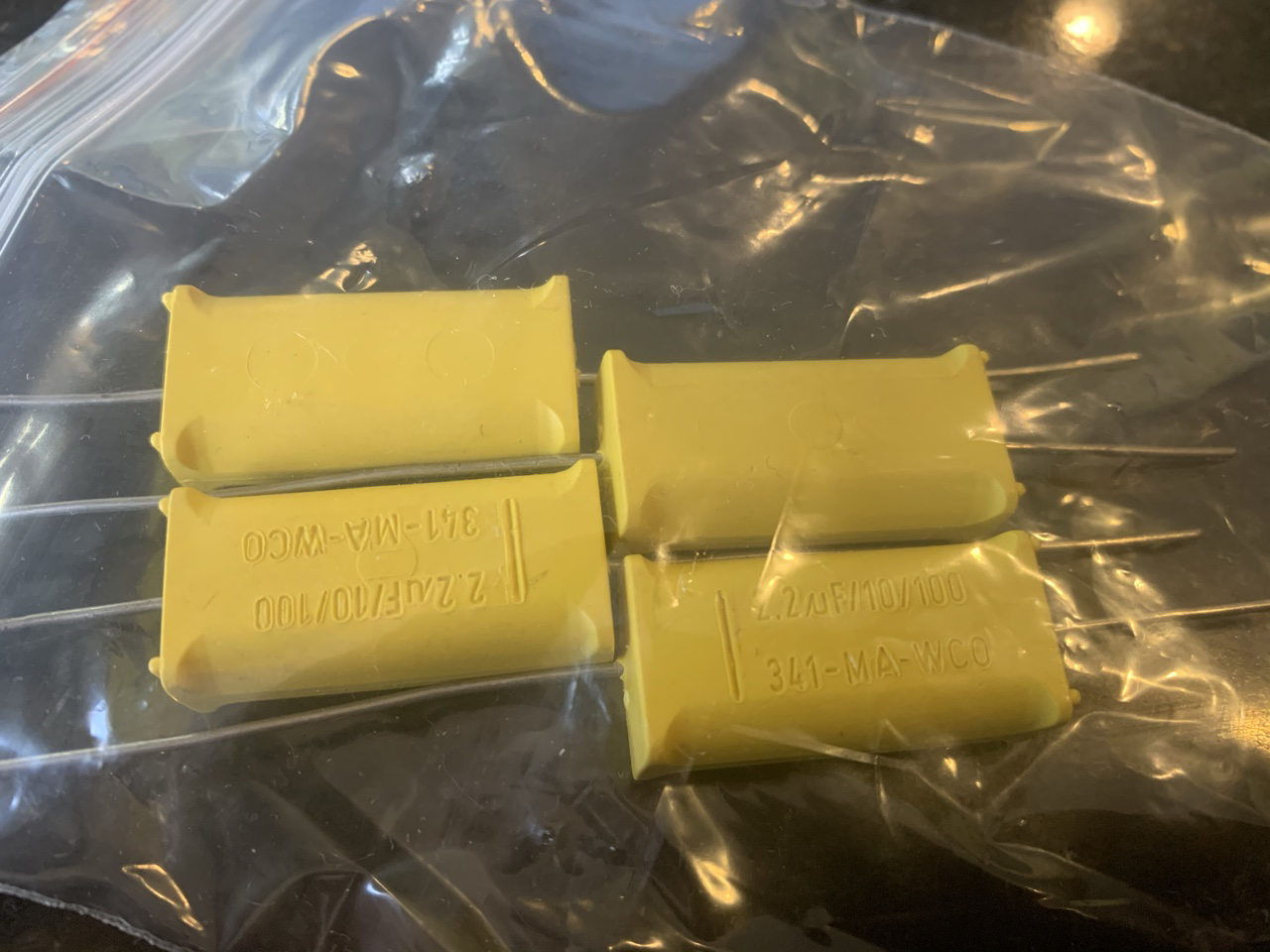

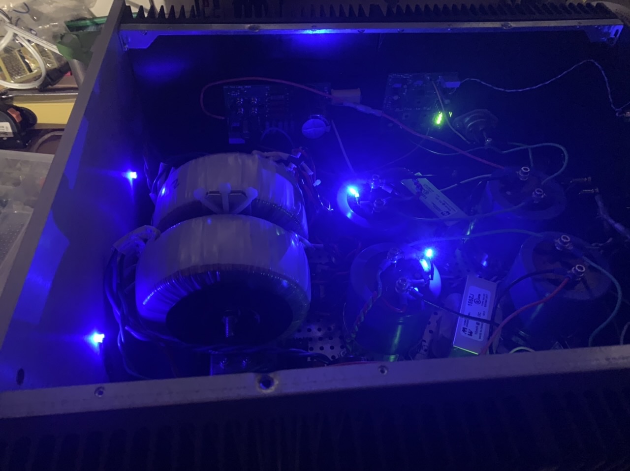

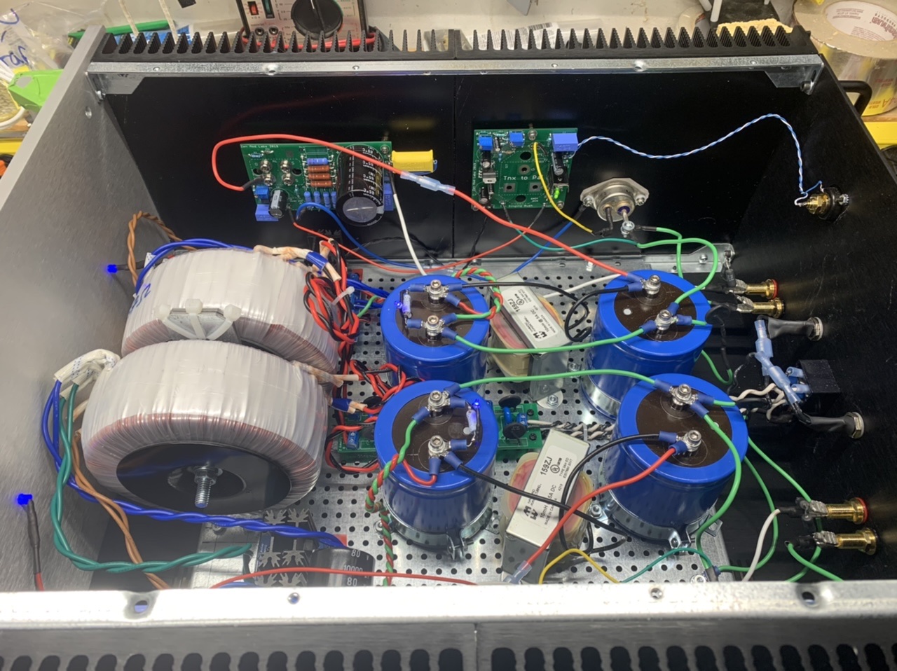

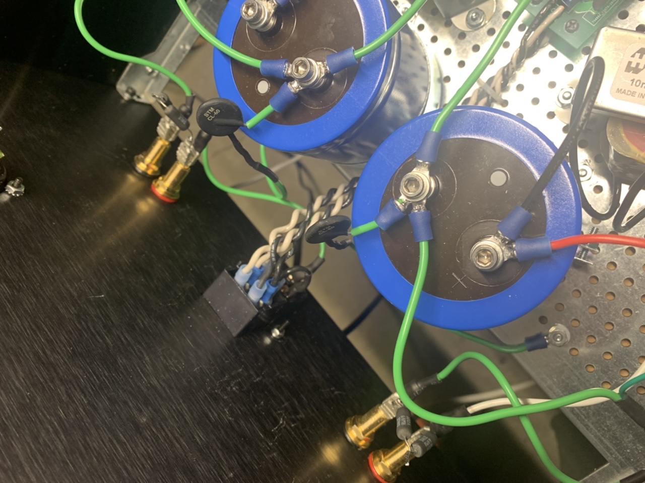

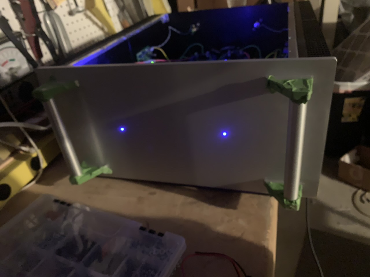

Fuses installed. Front LEDs installed. Donuts rotated and played with wires for low noise floor. Yellow chicklet caps installed. Sounds beautiful on the test bench! Tomorrow I’ll look at distortion profile and give a run in the horn rig.

having 5 of blue ones in bypass position, I can't see why installing chicklet one, too
though, if green is broader, I'm not arguing 🙂

ZM - I didn't realize the blue 1.0uF caps are so similar to the yellow ones. Since the yellow ones were the last parts ordered for my SissySIT, and they came highly recommended for that amp, I figured it would be good to repeat a bit of the secret sauce here.
blue ones are Polycarbonats (Philips MKC)
those yellow ones you bought are same, I believe
