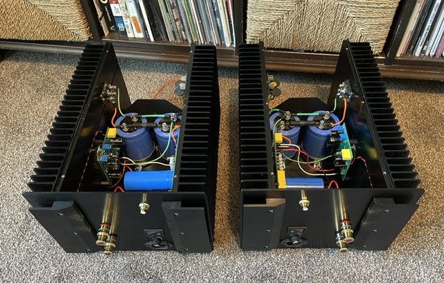

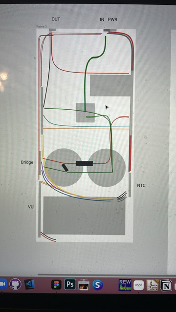

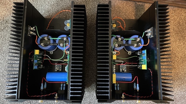

Still waiting on boards and trafos, but chassis’ arrived today. Two matching monoblocks, each equivalent to around 5U/350mm, and purchased from Aliexpress. Sinks need a touch of sanding, but otherwise great quality for the money. I’ve been matching parts and playing with wiring diagrams - Now time to start building this thing 🙂

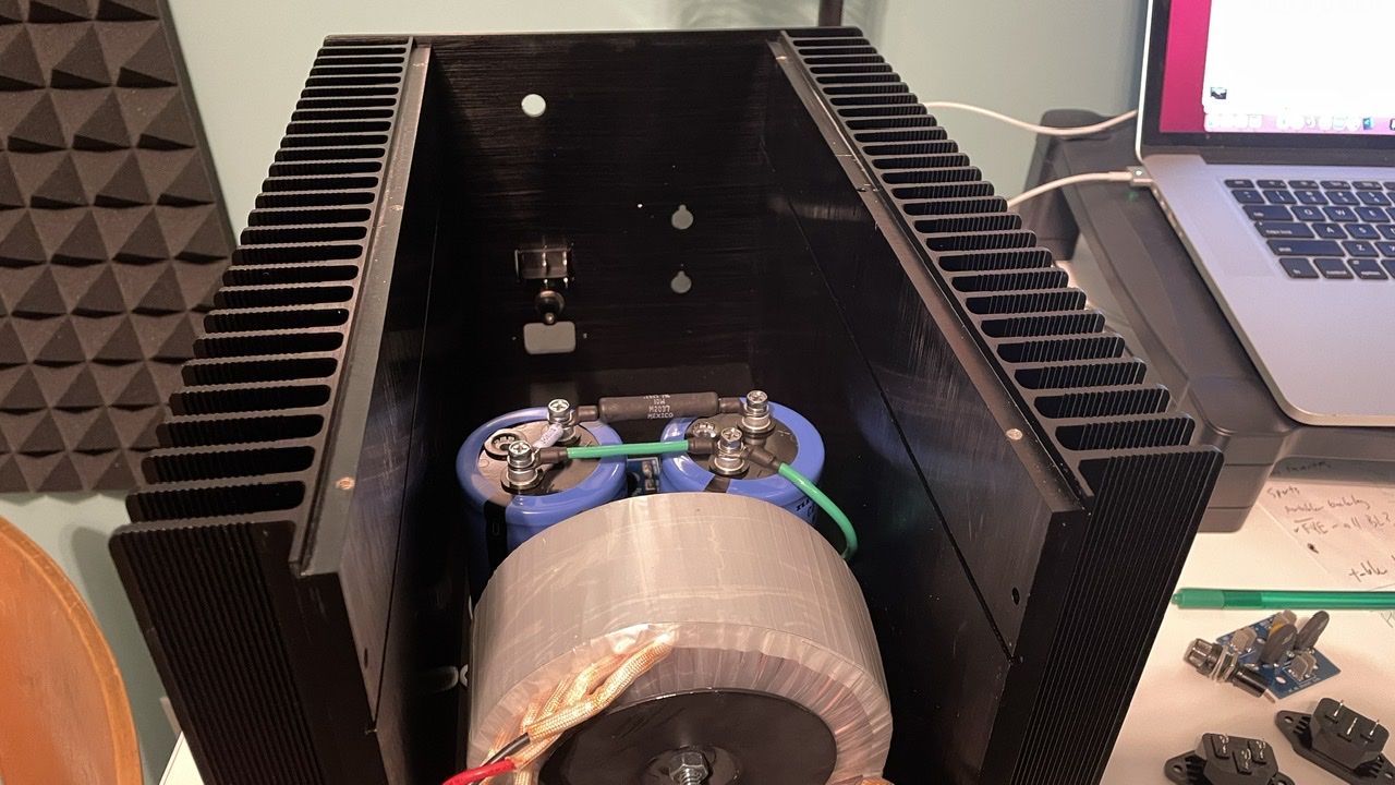

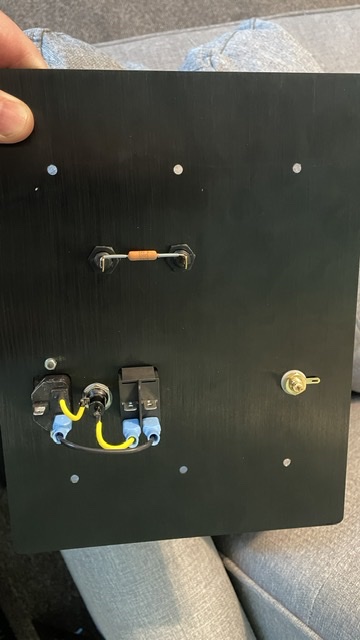

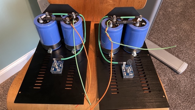

Time to get the party started 😀

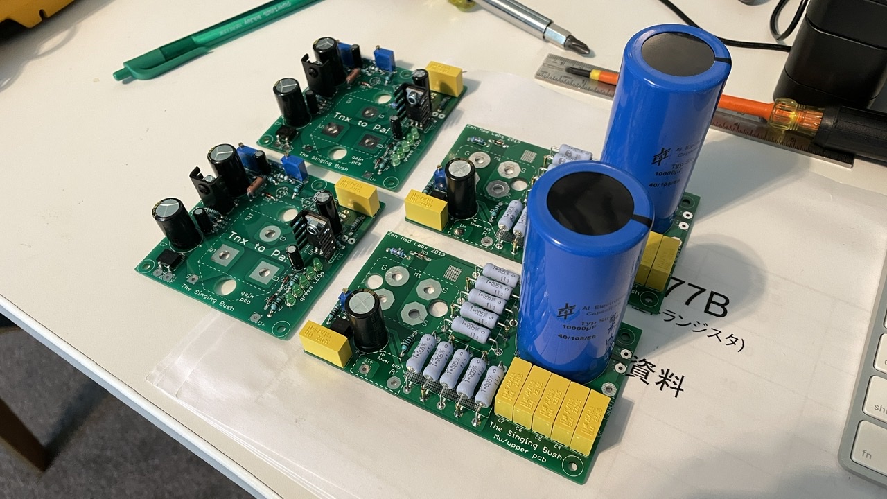

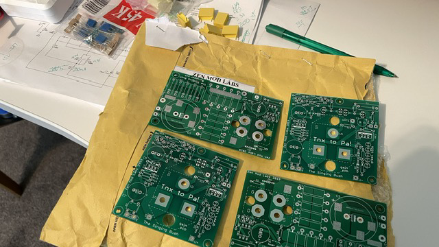

damn, all 3W resistor positions populated, some having pin sockets, no THF/182/180 specific values put on pcb
suspicious text on paper underside, so I can see that some various SIT's are going to be put to heat
:devilr: my lips are sealed
(edit: considering everything, nice 4A fuse temporary placed in positive rail ........ could be cunning to have; when you're done with settings, remove it)
Uh oh, ZM paying attention to the details 🙂
- I wanted to have option to ‘tap’ mu at different spots, and putting 2 of the 5 R’s for each side should allow me to cover papa’s values.
- concerning the 317, all I can say is I like a little heat sink symmetry
- I have 4A slow blow at mains entry. So put another 4A temp at pos rail just for insurance, right?

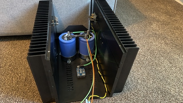

Alright, got these things as far as I can take em for now. Transformers are en route, so hope to be making music next week. In the meantime, going to put those temporary slo blo’s in the positive rail.
