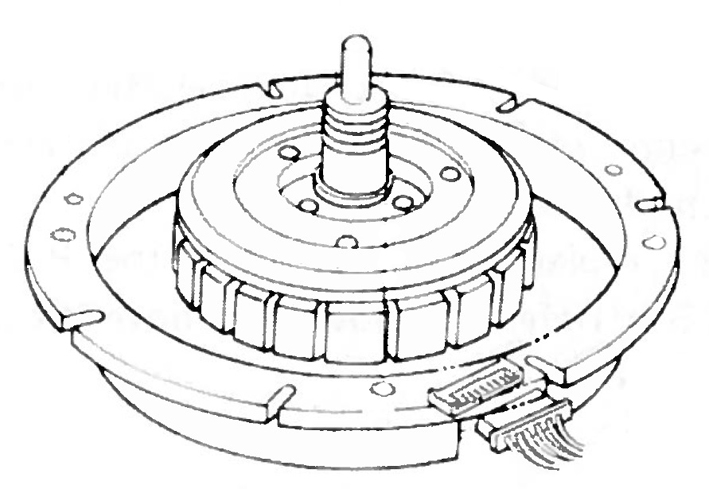

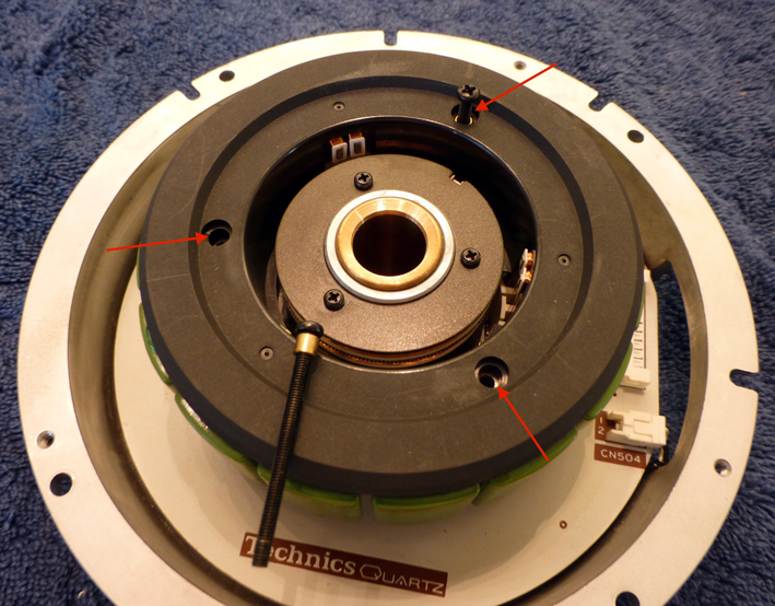

Gents, can I please ask for your guidance, I need some help from your expertise and understanding of the topic.
I am in the process of designing the plinth for my SP-10 Mk3. Will separate it from the chassis and mount it directly into a Panzerholz plinth (brake and strobe will be removed).
As the motor pan isn't too high, quite a substantial part of the motor unit will be visible - including almost all of the magnets. @JP, I am borrowing two of your pictures here from the beginning of the thread if that's ok, those clearly show the sections that will be exposed. Also the exploded view from the Manual shows the section and the dimensions quite well (also attached).
My question is: as these are magnets, and coils underneath, all typically covered up in the chassis but freely exposed here - do I need to take precautions of keeping magnetic and electrical interferences kind of radiating away from that area, eventually finding their way into the cartridge or other equipment etc.? I will likely not have another layer/plate of the plinth covering it up, so would it make sense to put kind of a brace/bracket, e.g. from mu-metal or so, around it?
