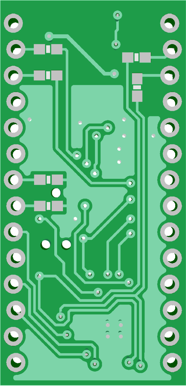

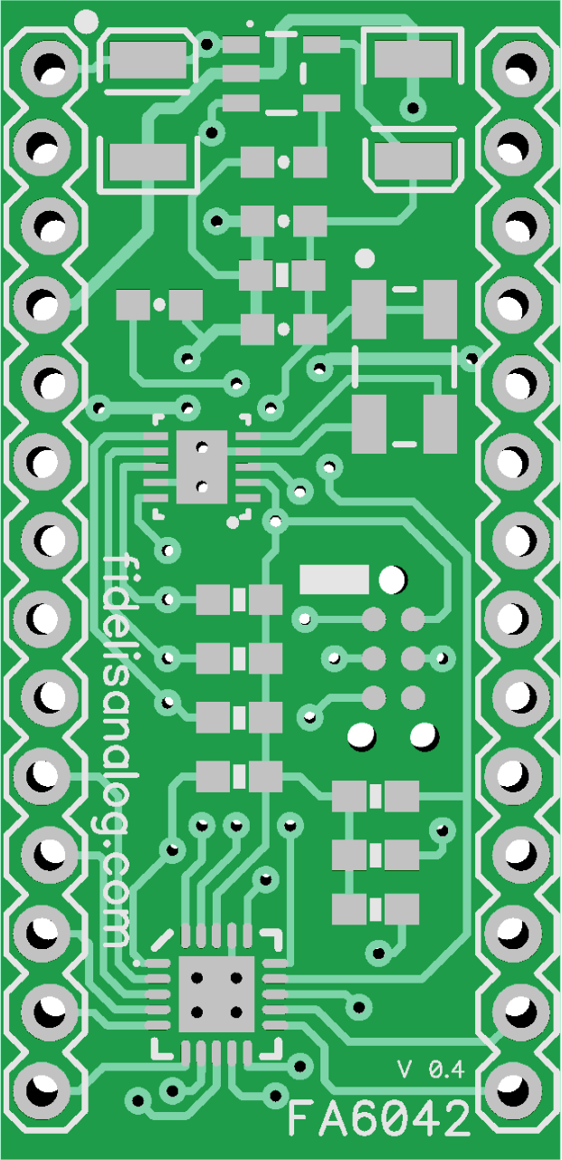

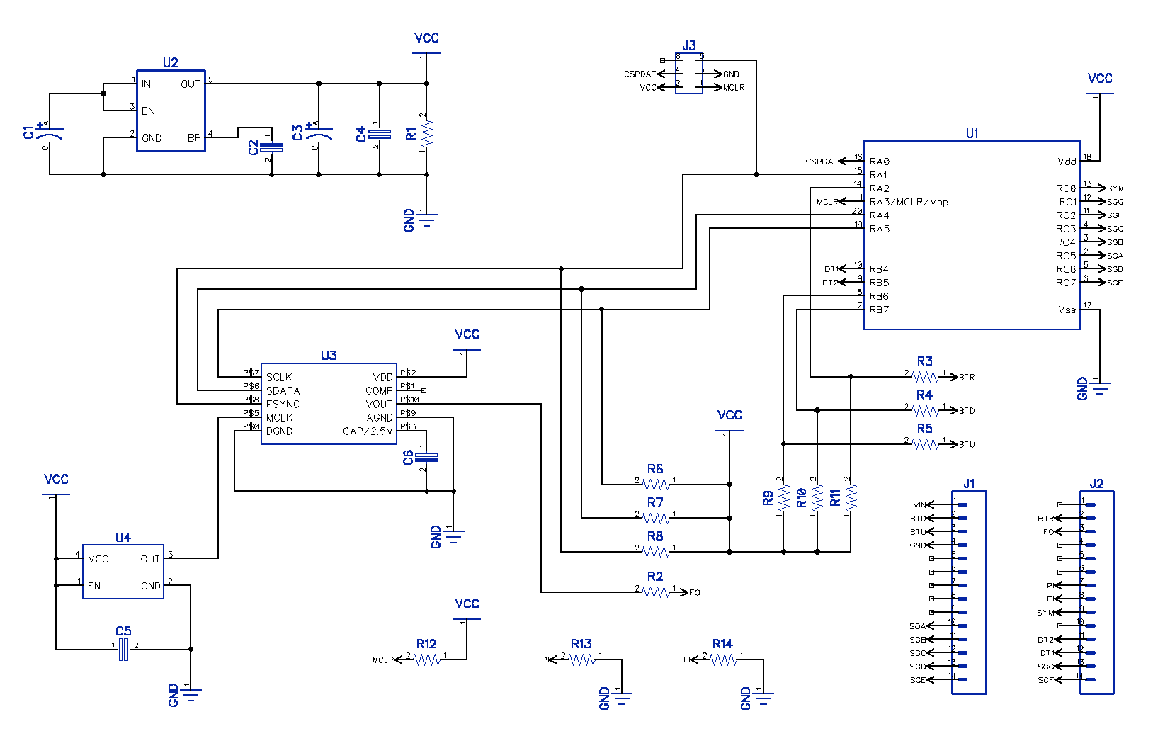

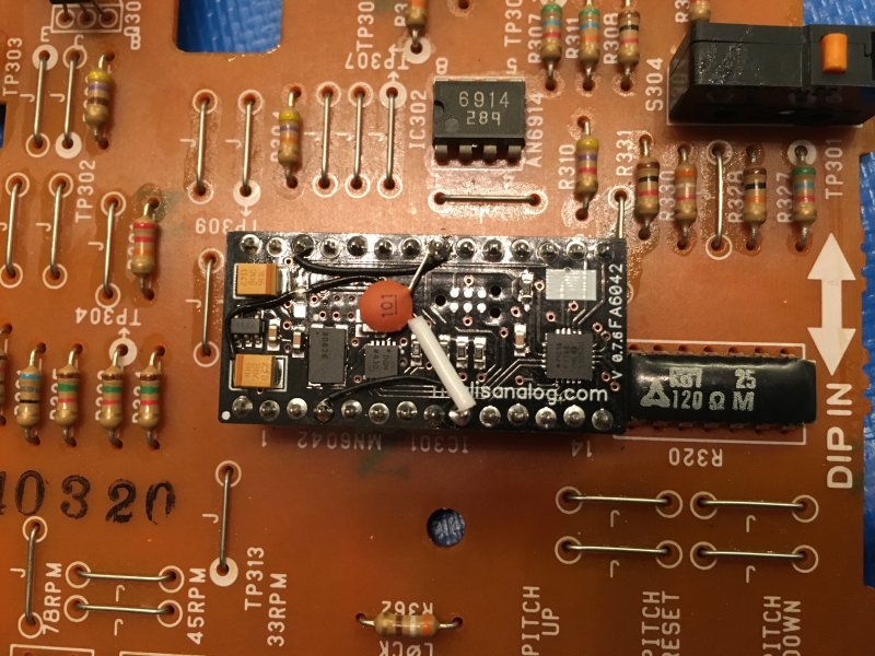

Here's a bit of an update. The schematic is what I've had running on the breadboard for the last several weeks. I've gone back to using the square wave output of the DDS as the DN860 chip has no issue with it, and it reduces complexity and layout sensitivity. On the breadboard setup the output of the DN860 is good to +/- 0.00001Hz. I've no idea how my table measures; I'll check when I next have it open.
This is the first board I've ever done, so I'm going to sit on it for a few days before having a couple prototypes made up.
So? It's his prototype. Probably need to determine if it actually works before releasing it to the world...
Looking good. I expect the DDS is decoupled well. Not sure the pull ups are required, but hey, it's a breakthrough concept !
Not local, but the board is so small I'm not sure I need more, and upon initialization I'm powering down the DAC. Works good on the breadboard anyway.
I did remove the pull ups on the SPI lines as they're not needed. This allowed a little bit of breathing room in the layout, which allowed a continuous ground pour. I also switched the current limiting resistors out for diodes.
I'll upload new images in the next few days. I hope to get it out for prototype boards early next week.
I'll update the schematic later, though here are the changes:
1) Added local decoupling to the oscillator, DDS, and PIC.
2) PIC and DDS are running off 5V, oscillator off the 3.3V regulator. It's quite difficult to find 5V TCXO's, and I couldn't run the PIC off 3.3V as high wasn't high enough for the LED display to work right.

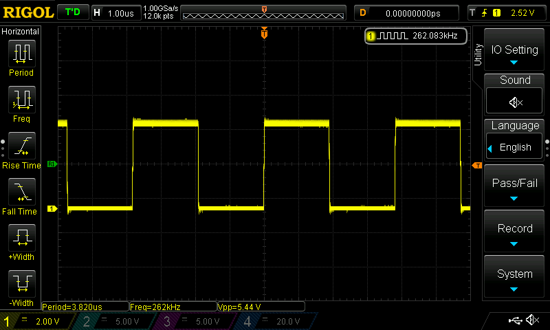

3) I'm using a programmable TCXO at 8.386560 so that /32 is the nominal clock we need: 262.080KHz. It doesn't seem to make much of a difference for this application, but if the output frequency of the DDS isn't an integer of MCLK, there's quite a bit of jitter in the output due to the averaging the DDS does.
4) Added 100pF across the output to take care of some rather severe overshoot.
5) Took care of some pinout issues.
I measured three MN6042 parts before putting this in. Two measured +1/-7 Hz, and one measured +0/-7 Hz. The replacement board measures +0.1/-0.2Hz. That'll do.
I didn't measure the DN860 output as there isn't one if the table isn't running, and I didn't have the motor hooked up. On the breadboard with a DN860 I'm getting 50.55566Hz +/-0.00002Hz at 0 pitch. When I adjust pitch which adds a bit of jitter from the DDS I get about the same though it fluctuates at a higher frequency, and more to the extremes.
I may revisit and use the sine output with a comparator to mitigate the jitter, but I don't think it'd make any practical differences.

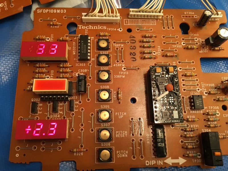

🙂 An update on an old thread.
John's chip has revived several SP-10 MK3's here in the UK. It fixes dead turntables and makes them better than new.
I have also revived over a handful of the Technics SP-15 with the same chip too.
