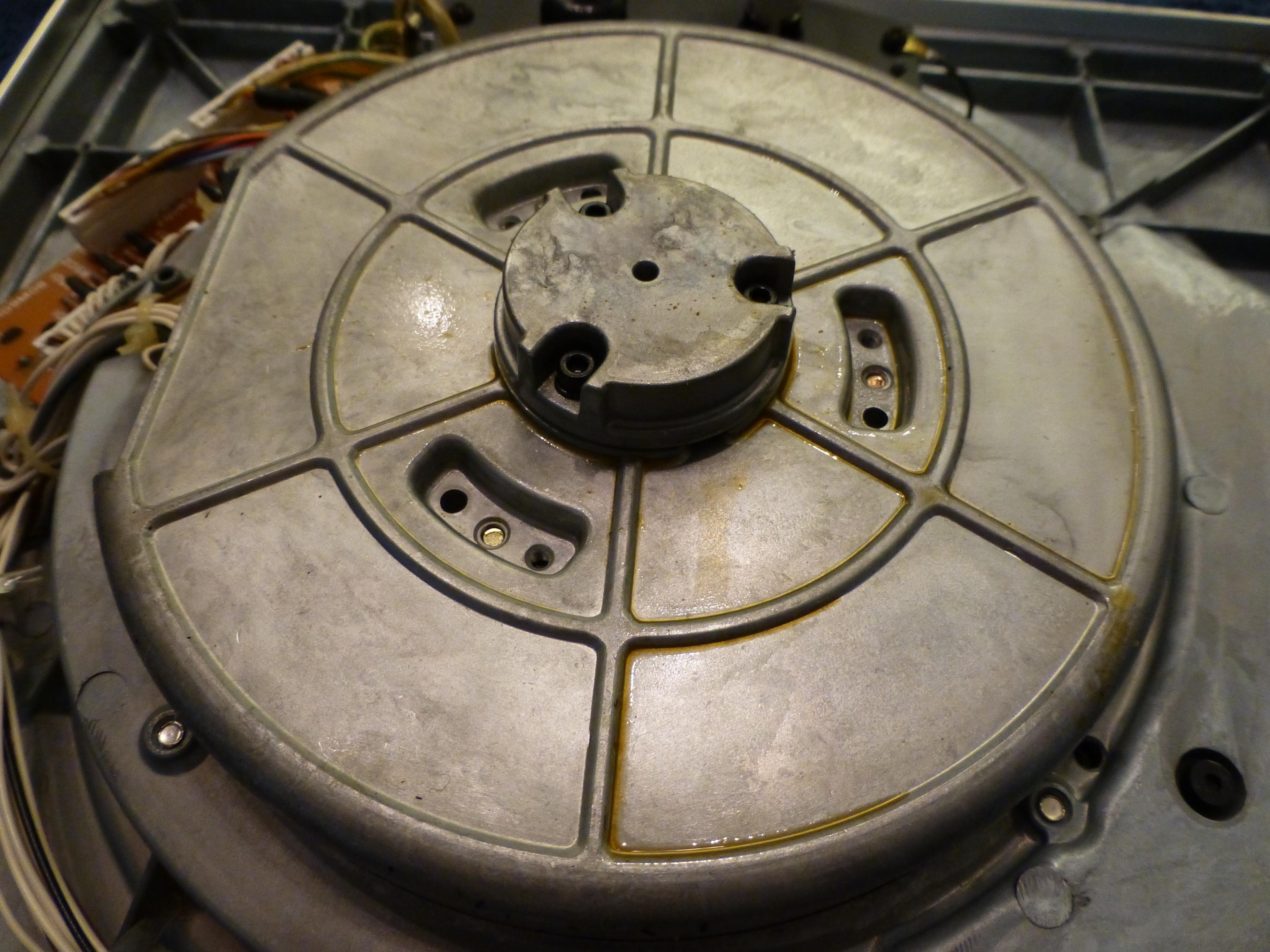

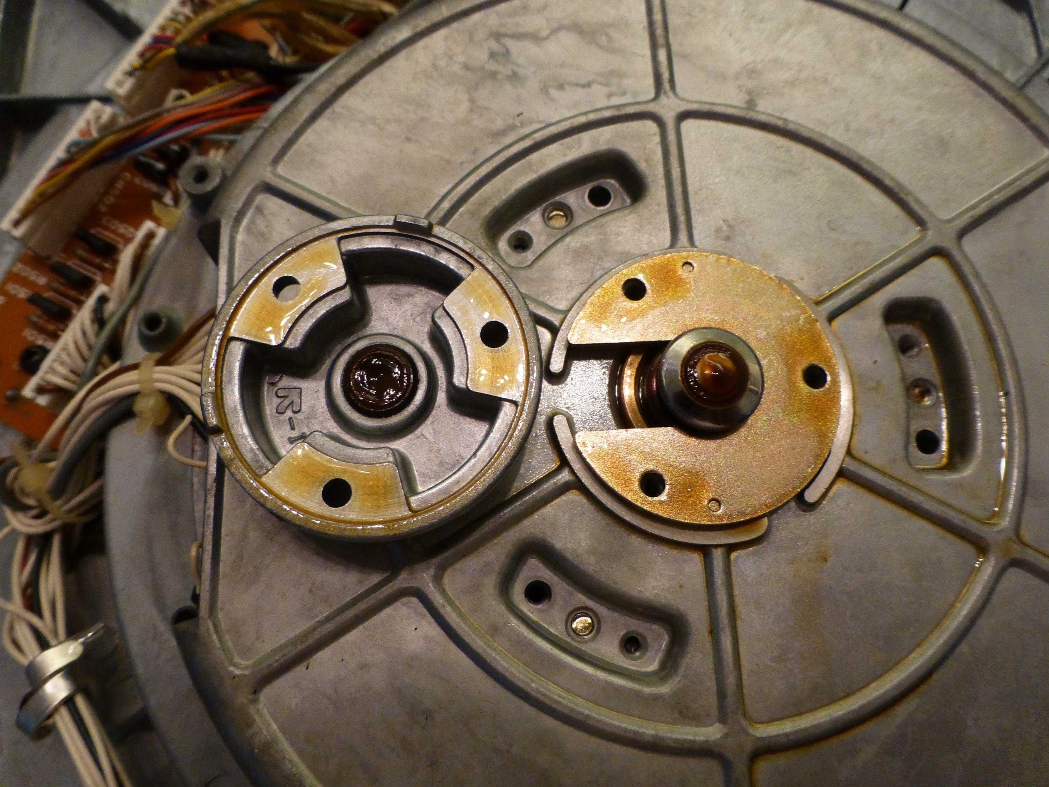

While I'm waiting for my parts order, I decided to take a look at the bearing.

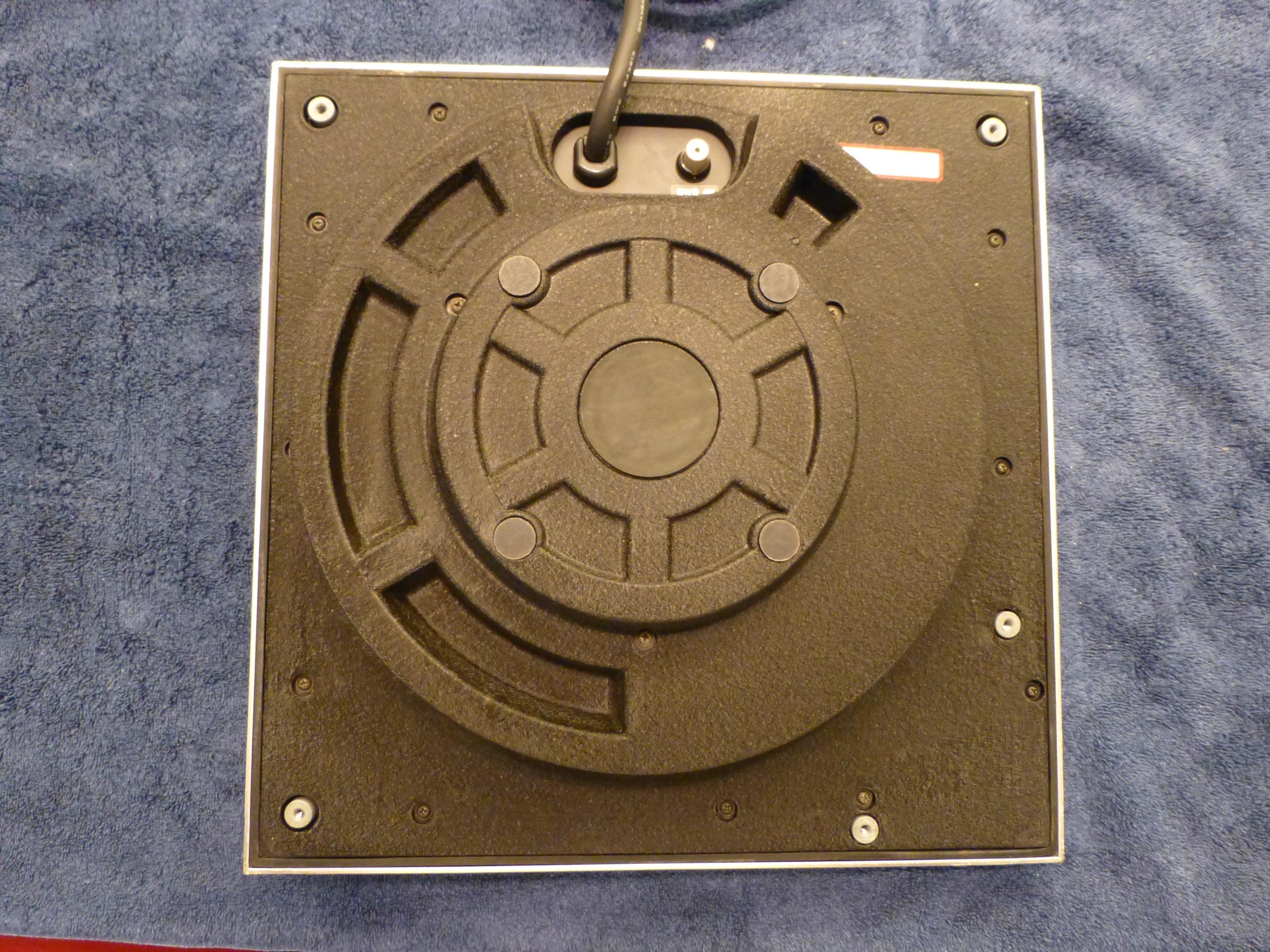

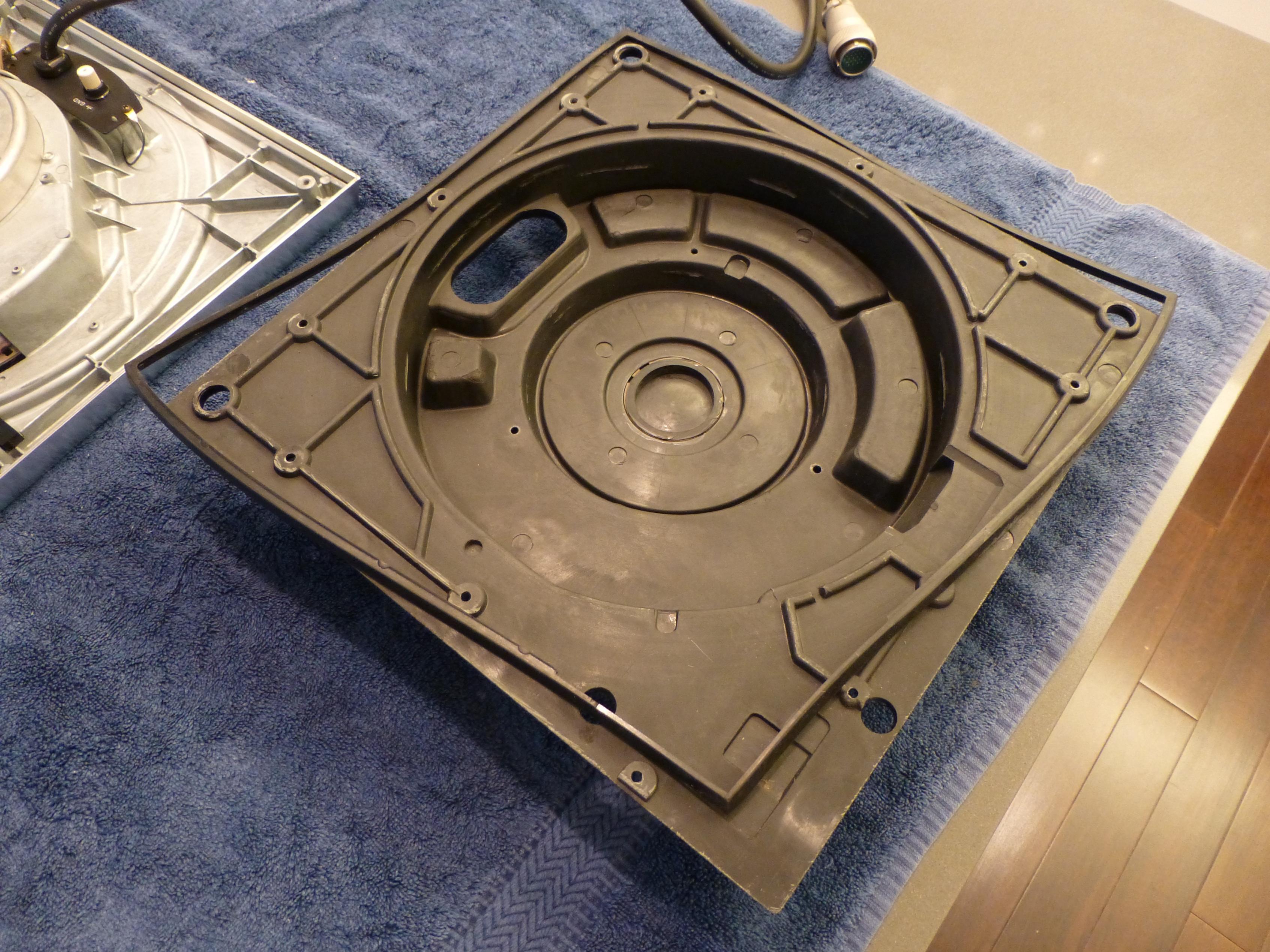

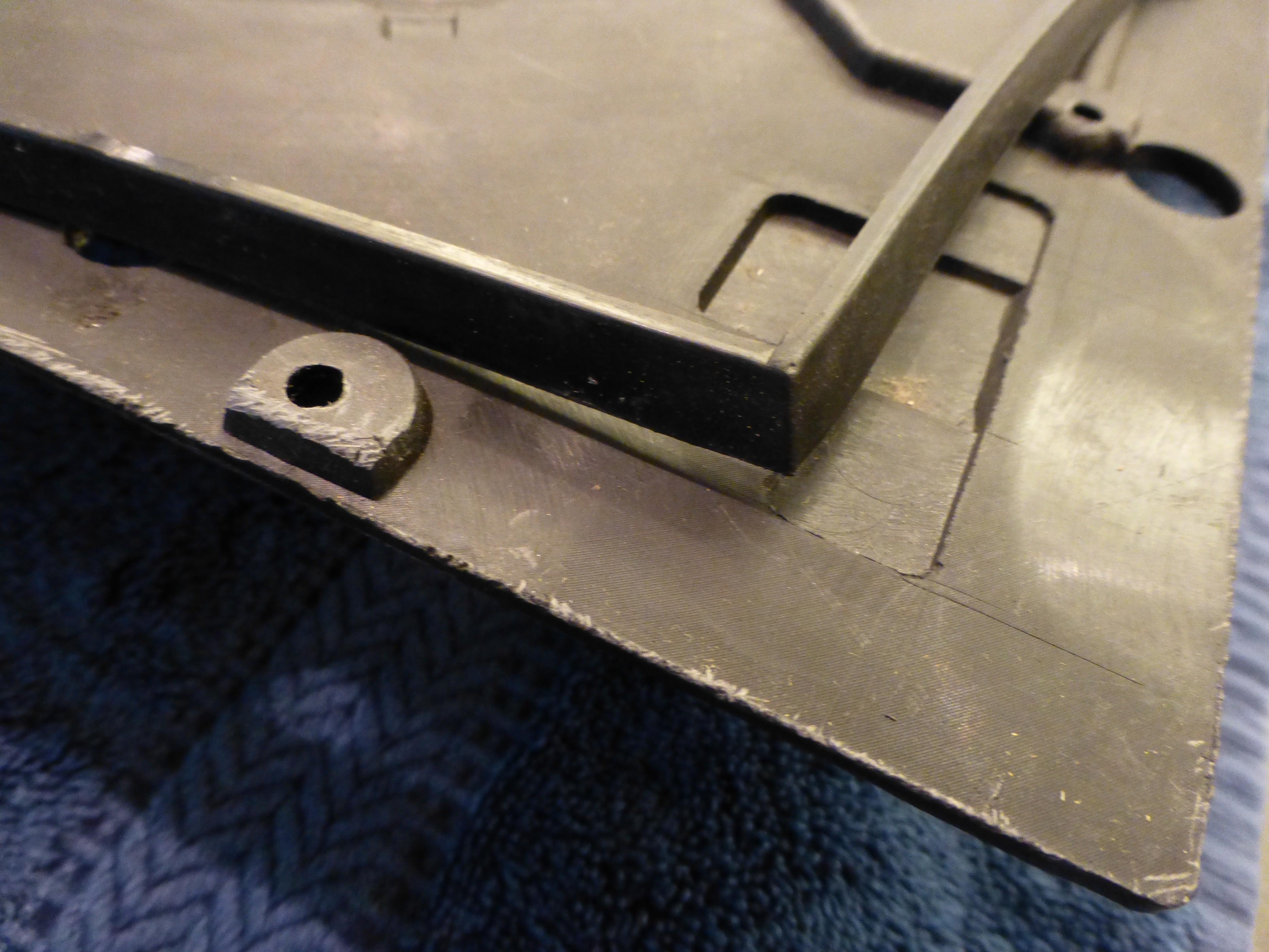

To remove the back cover, remove all the screws. Unlike the MKII/2A, they're all the same, and are self-tapping. The back cover is a composite material similar to the sub-plinth on the 1200MK2. There is a rubber gasket, so you need to get a good grip and give it a shake or two for it to break loose.

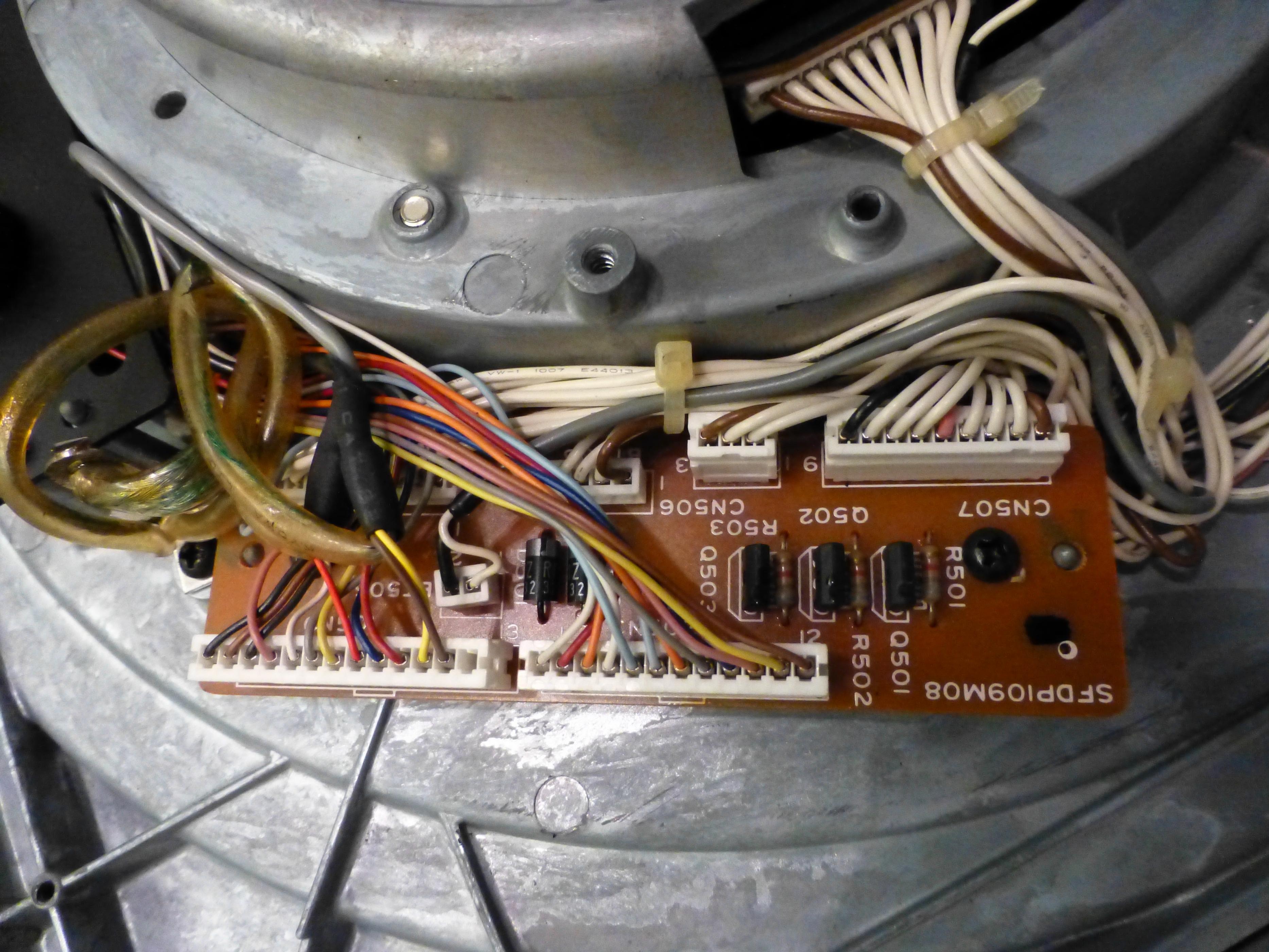

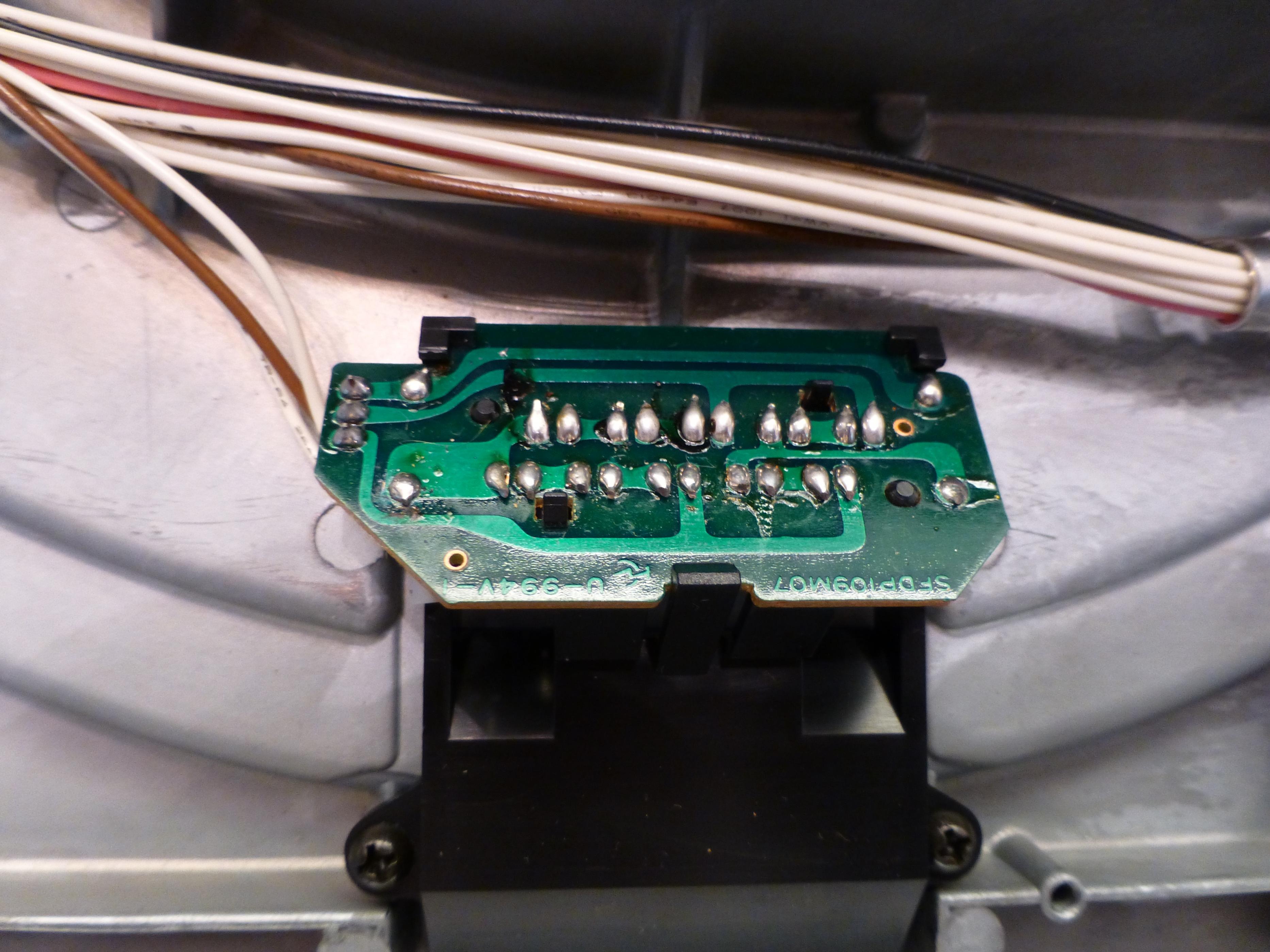

Some of the soldering leaves a lot to be desired.

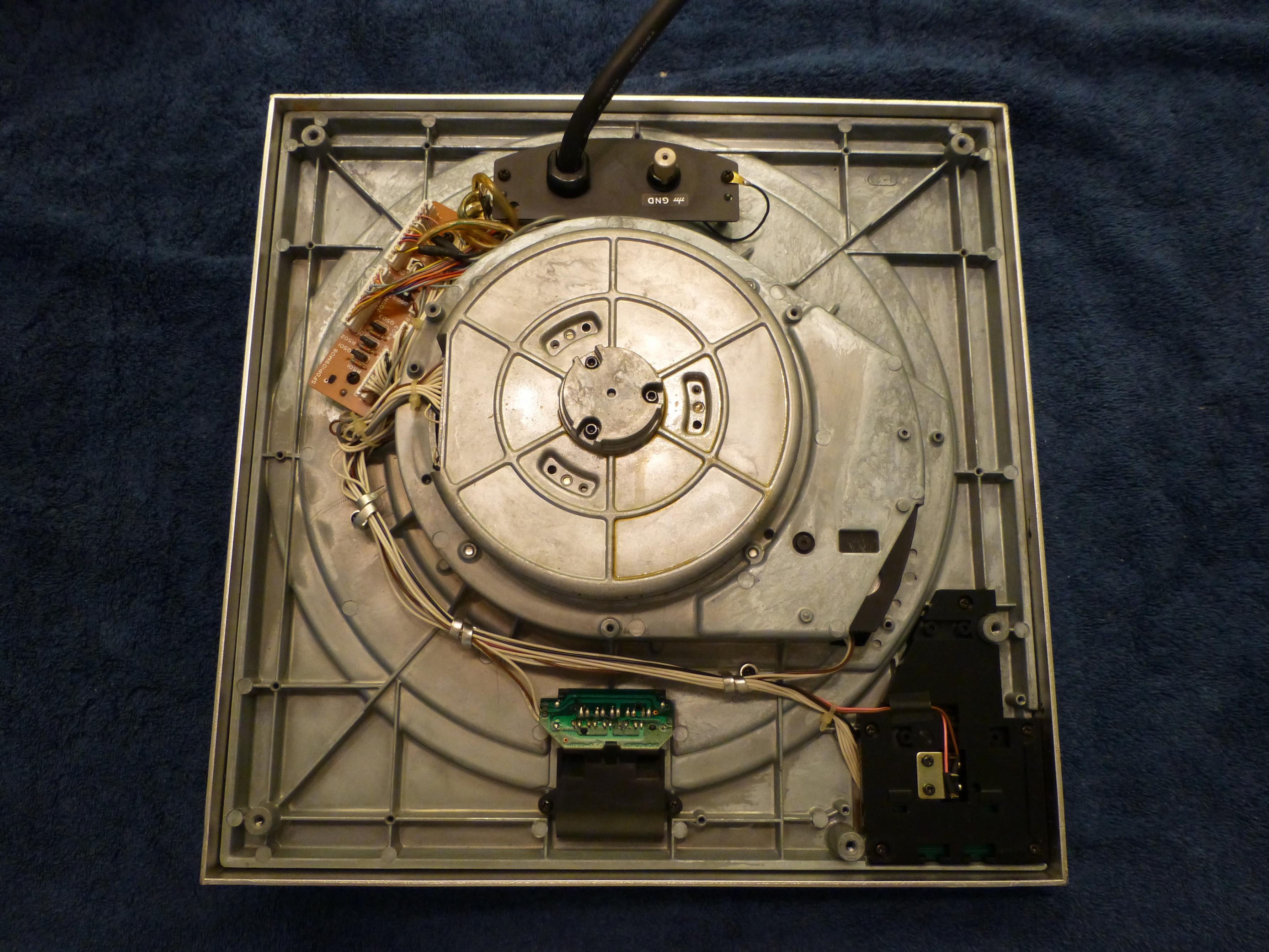

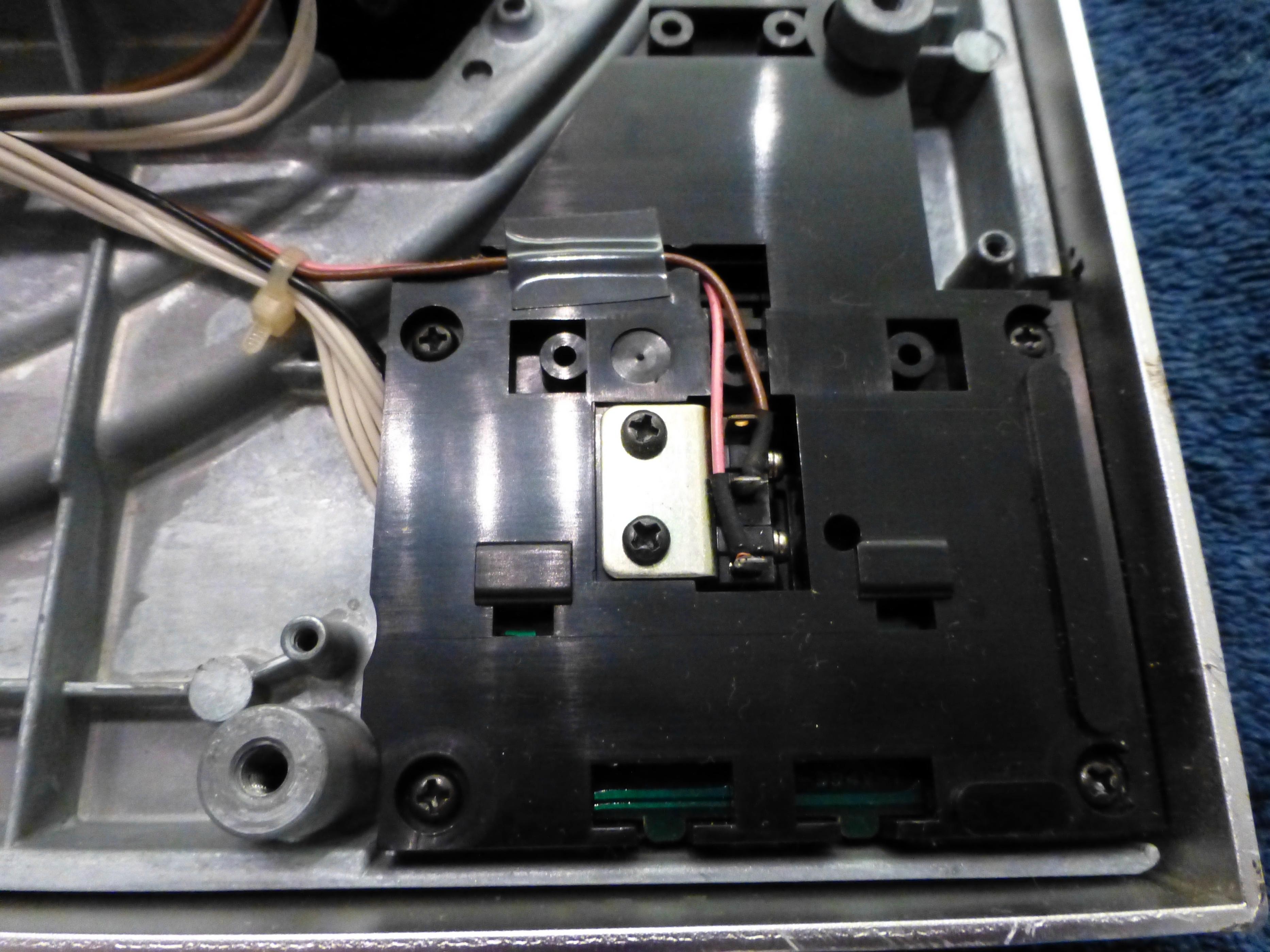

Start/Stop and speed switch mechanism.

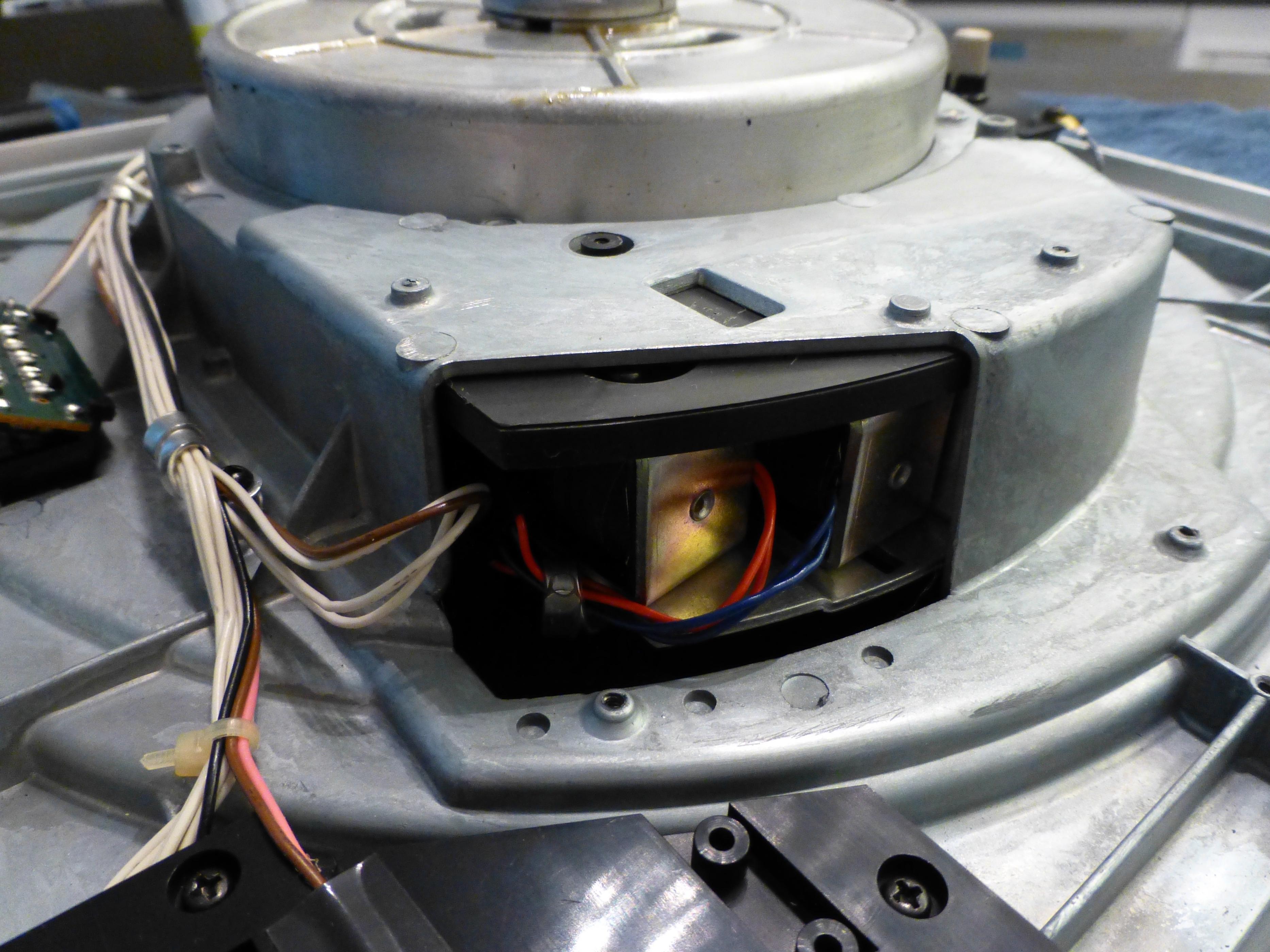

Dual brake solenoids. One is for a band brake like the MKII/2A, and the other is a lever brake.

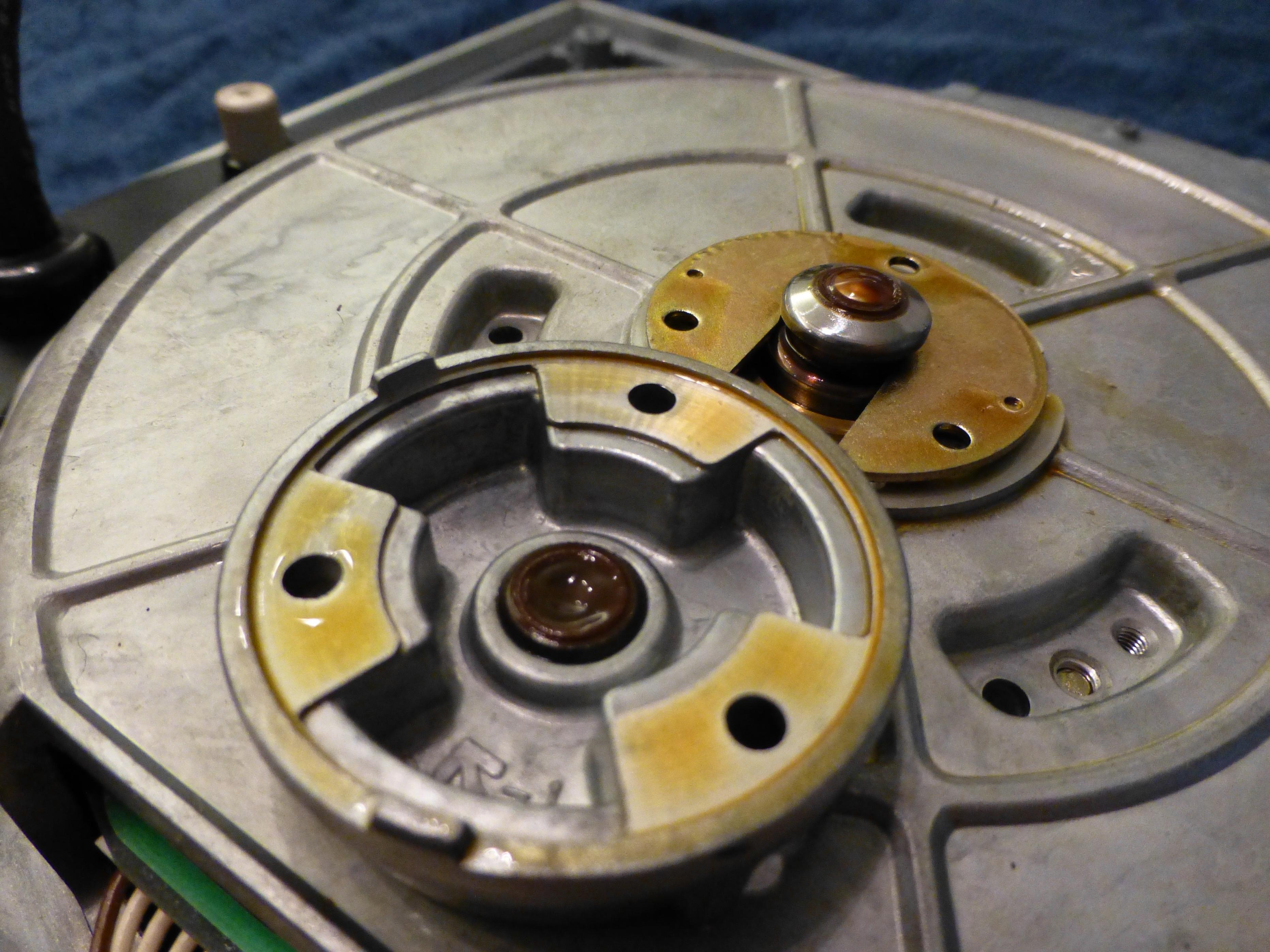

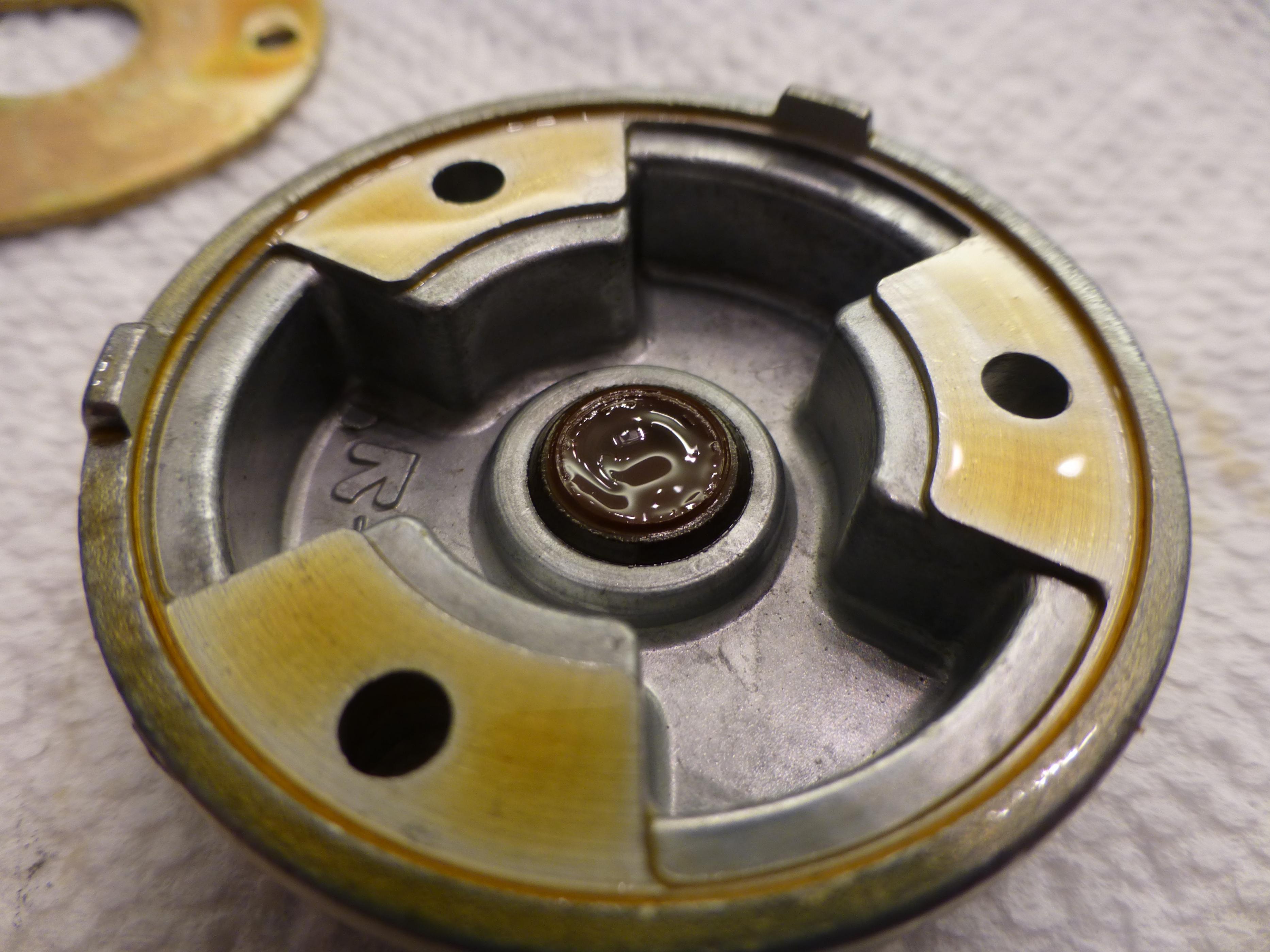

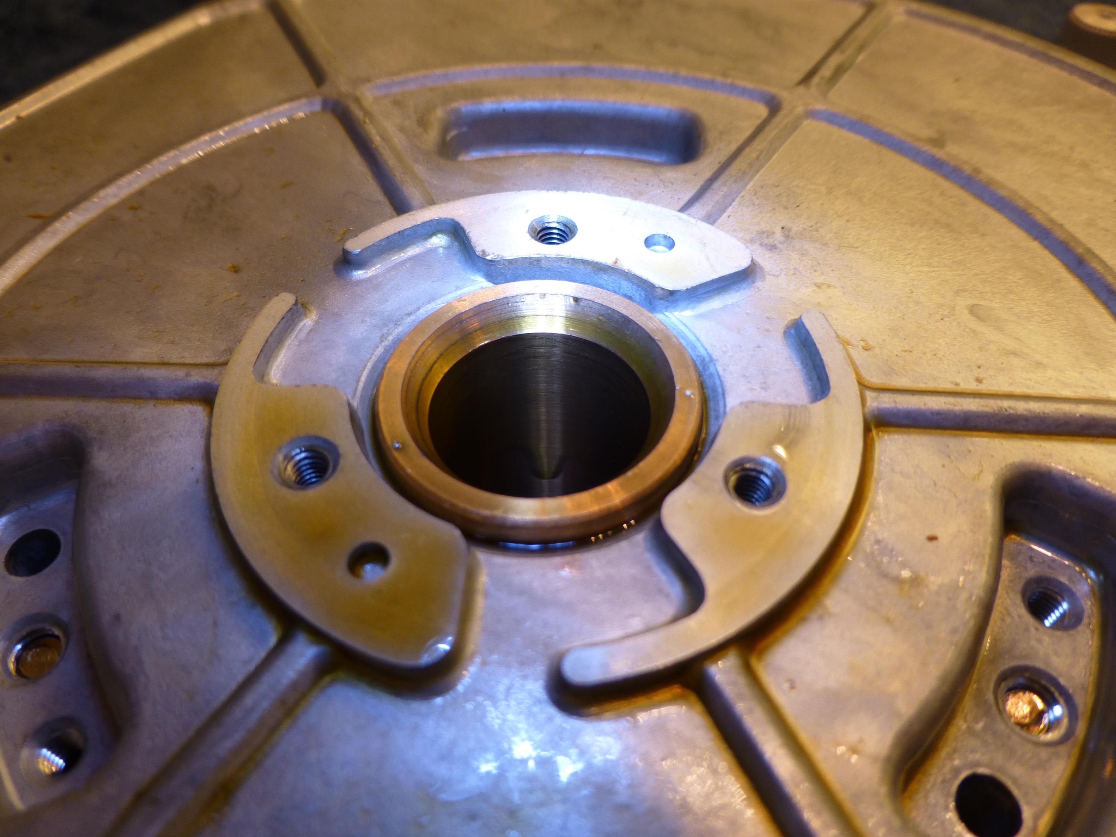

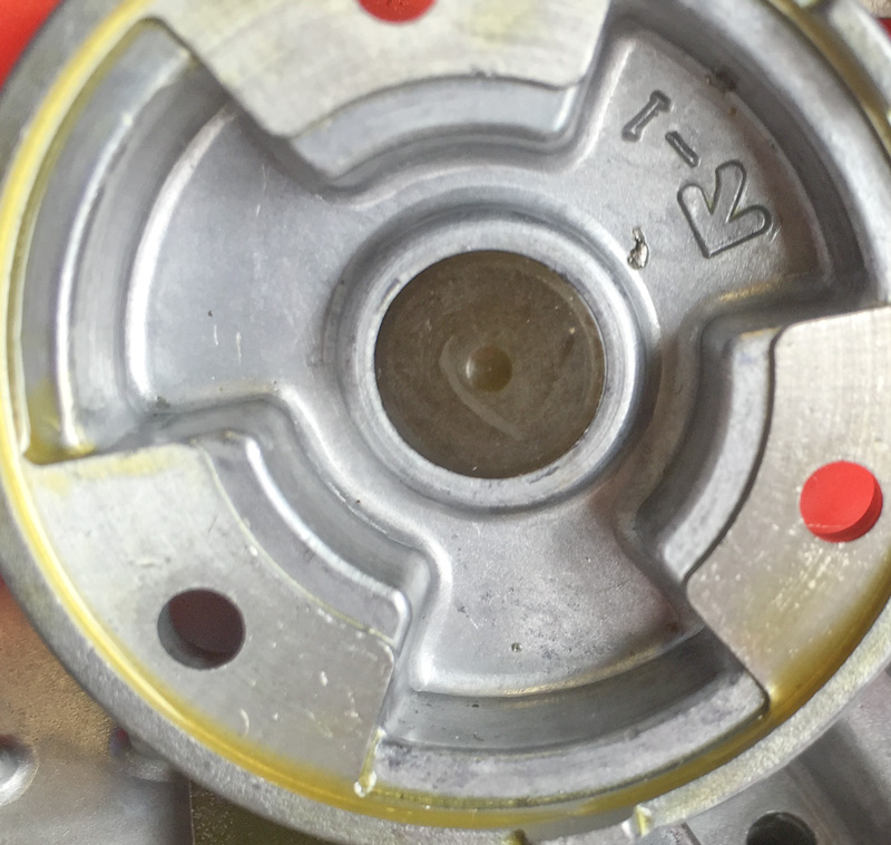

The bearing thrust cap on this 'table is open, so one consequence of over lubrication is that the oil leaks out.

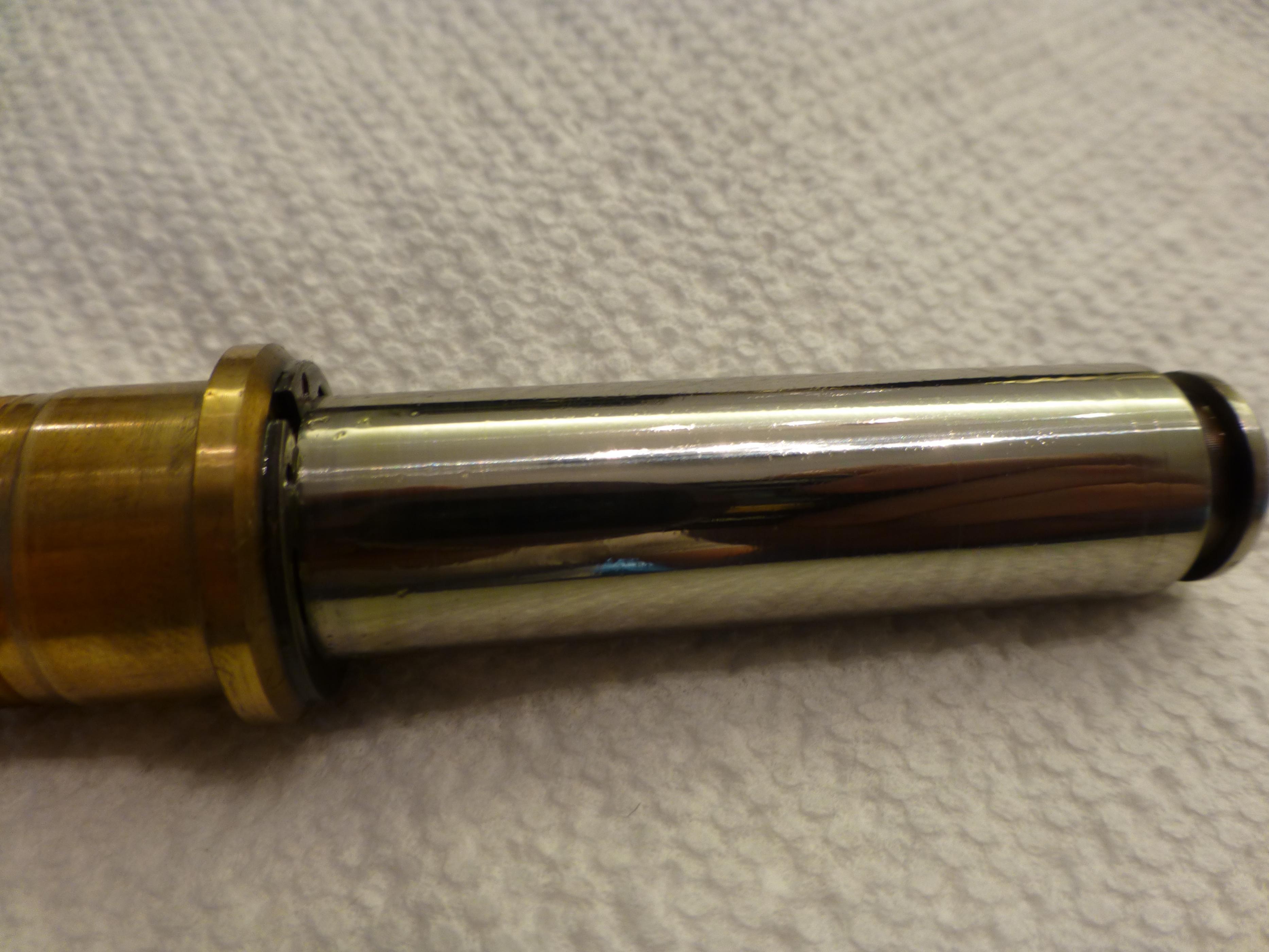

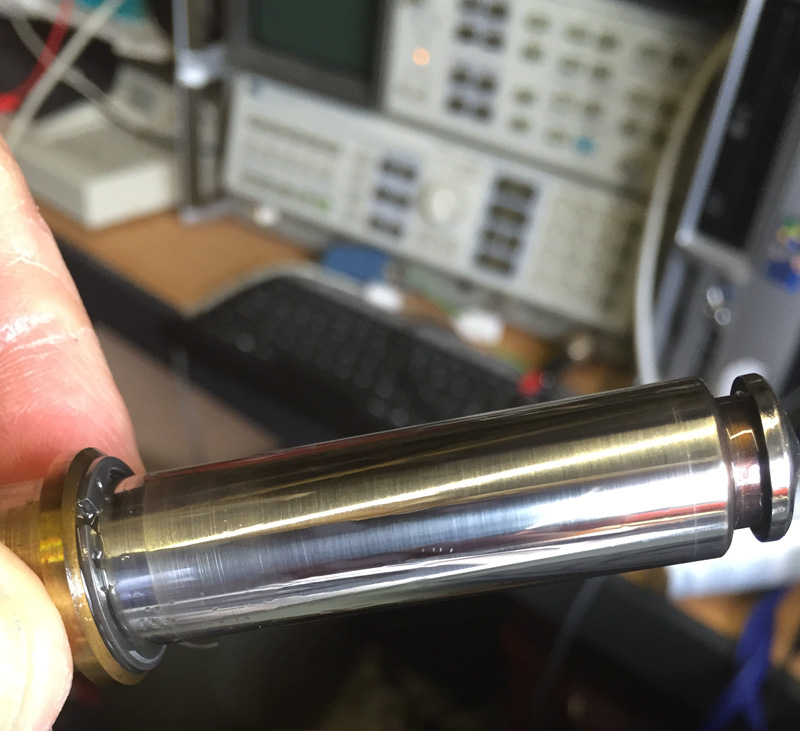

A 2.5mm hex key for the three socket head cap screws will liberate the bearing cap. From there the "C" retainer slides right off, freeing the shaft which you can pull out from the top-side.

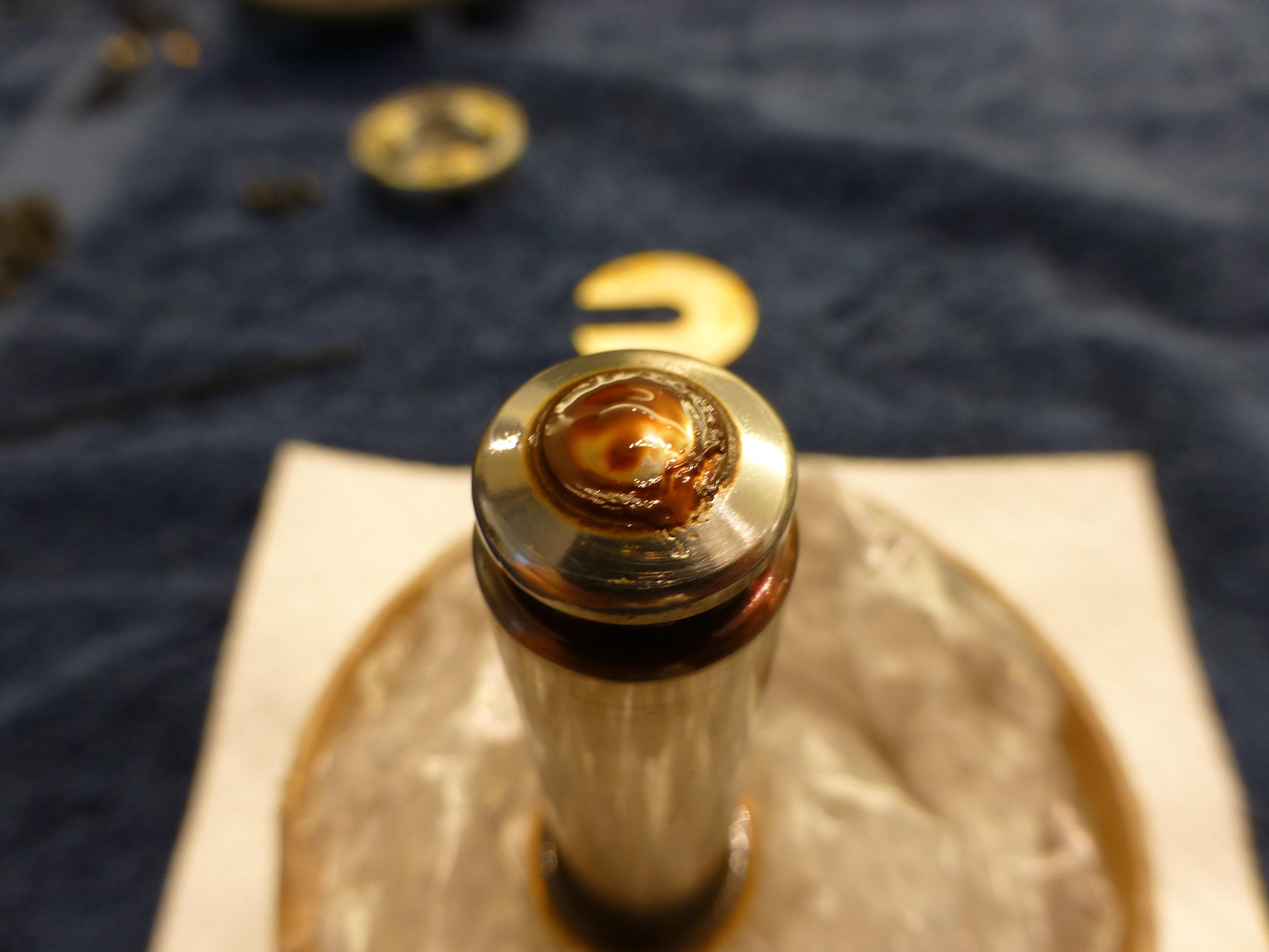

On this one the wear on the shaft and bore appear to be very minimal, and I noticed the fit is very tight. Just with light oil there's enough resistance that you'd think it was lubricated with light grease.
Now, the one thing that perplexes me is that I'm used to seeing light machine oil, which I presume is similar to the Technics oil, become gummy and amber in color when it's old. The only sign of oil not being oil anymore here is at the thrust bearing. However, this stuff has a consistency more like light grease than old gummy oil. This could be the way the Technics oil breaks down, or this could be some kind of grease only on the thrust bearing. Any ideas?

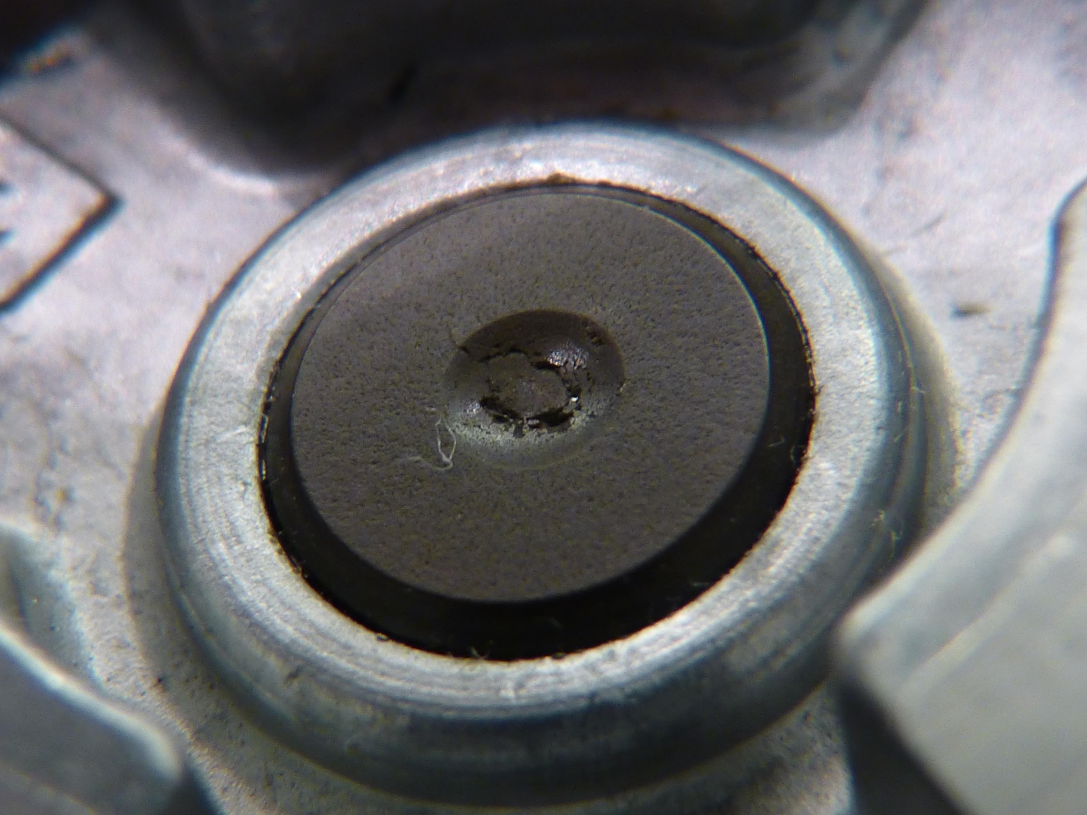

Mystery solved, unfortunately. The thrust bearing is ceramic, and the brown gunk is ground up bearing and oil. The ceramic on mine has taken and impact and has been damaged. Time to figure out how to replace it, and with what. I'm more than open to suggestions on this one...

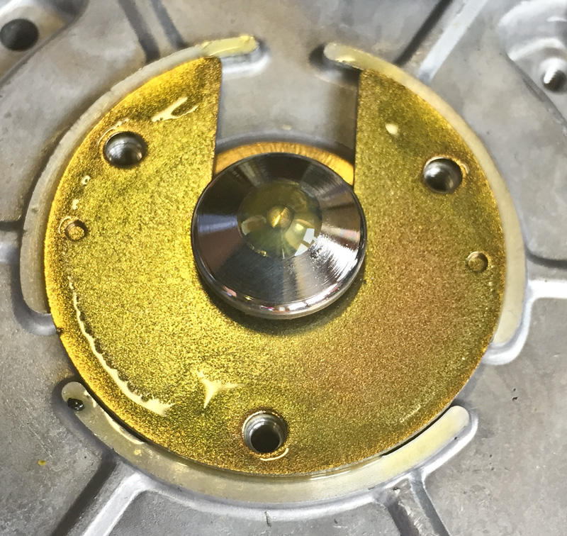

Mine is here and showed little sign of wear with golden thin oil at the thrust pad. However I cleared everything out with IPA and cut the wedge brake corner off as it was dragging (I think) now the slight all but inaudible noise at 78rpm has completely gone. The bearing is very free and not tight with minimal drag.

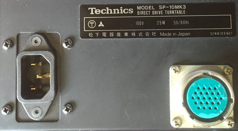

1. This is metric unit that uses mm Allen Keys and Philips heads (not posidrive, star or anything else)
2. The bottom cover, it needs to be re-fitted into the rubber gasket fully before screwing the screws back in, BUT :
3. Two of the 15 cover screws are shorter with blunt ends (not pointed) these MUST go into the two holes very close to the big diameter of the inside base unit, in other words where they are close to the platter and will muck (f) it up if the long pointy ones are screwed in there, lucky I noticed !

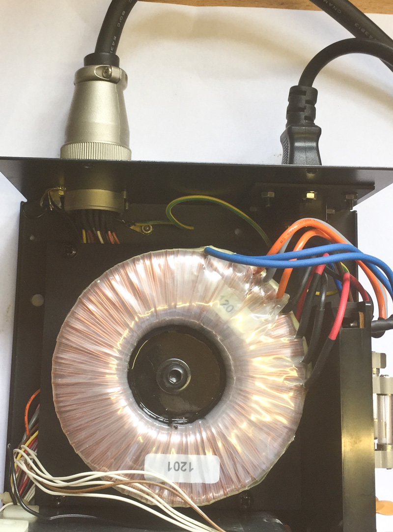

4. Most units are 100V the Japanese standard and they will not tolerate 117V let alone the up to 253 we get in the UK. So I had some custom toroids made and a new power inlet panel made to allow an IEC connector. The new transformer sits on a custom base plate spaced off the bottom to allow air through and fits to the original transformer mounting holes.

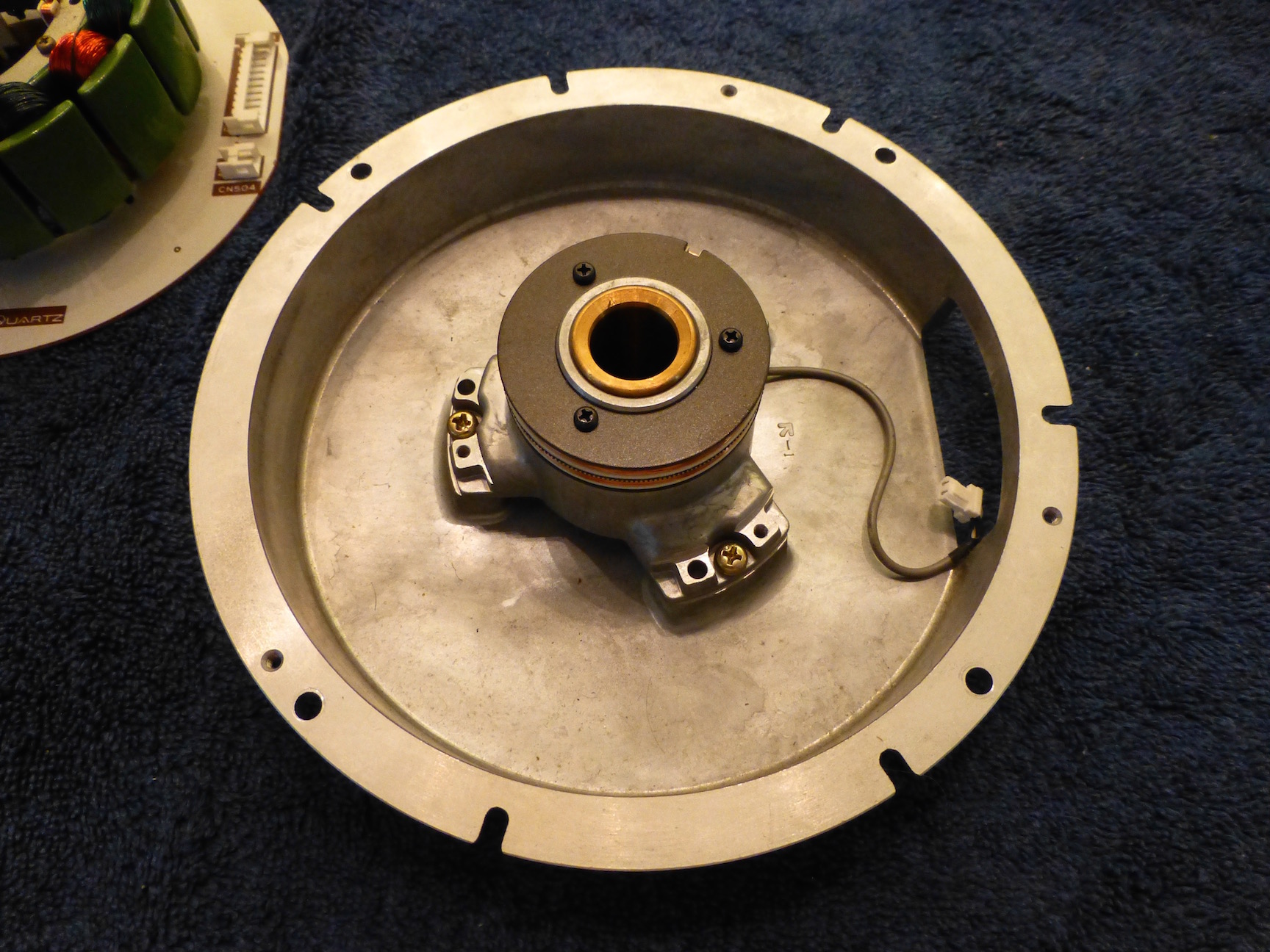

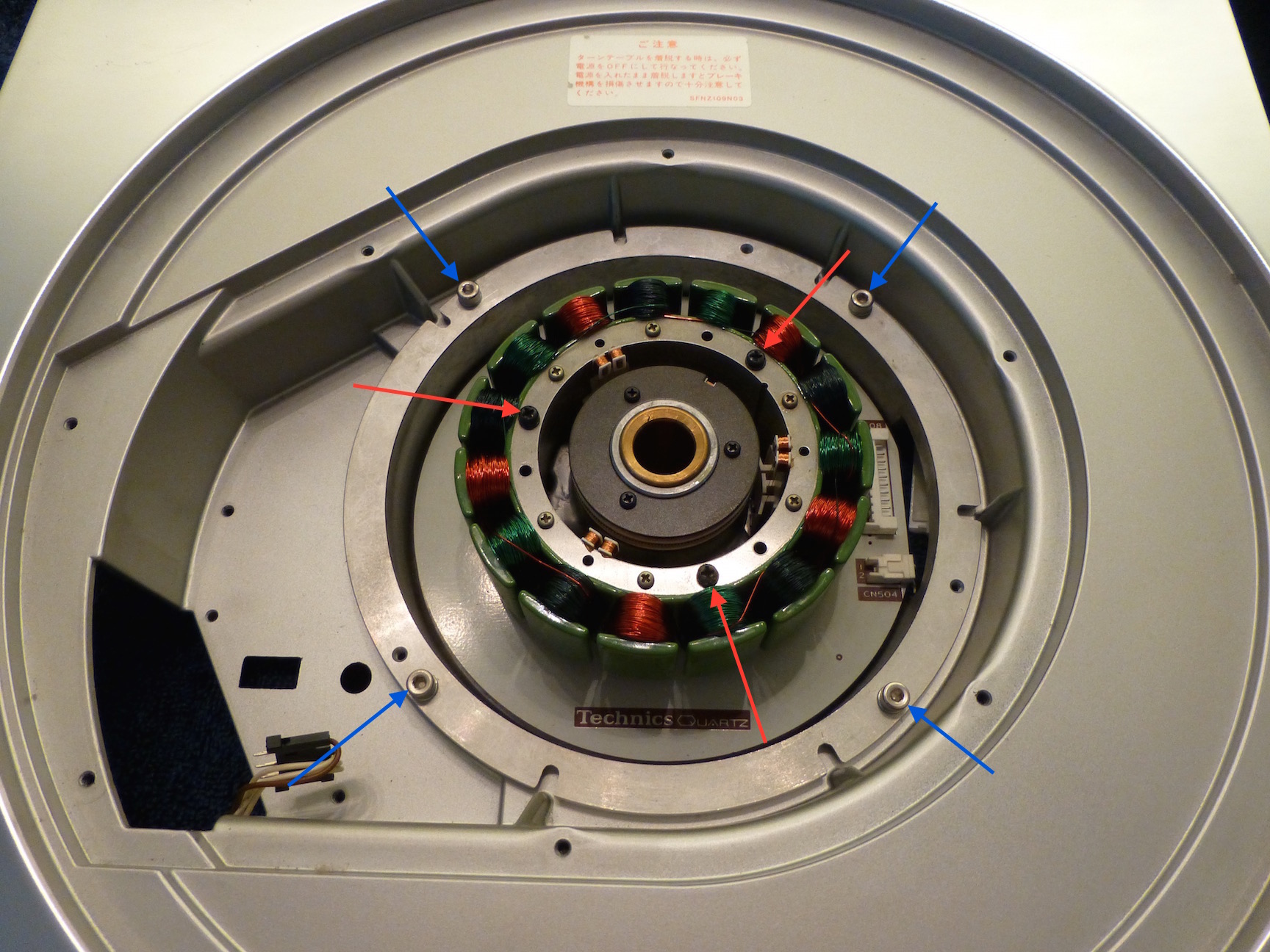

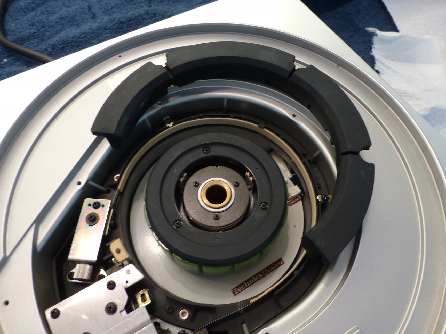

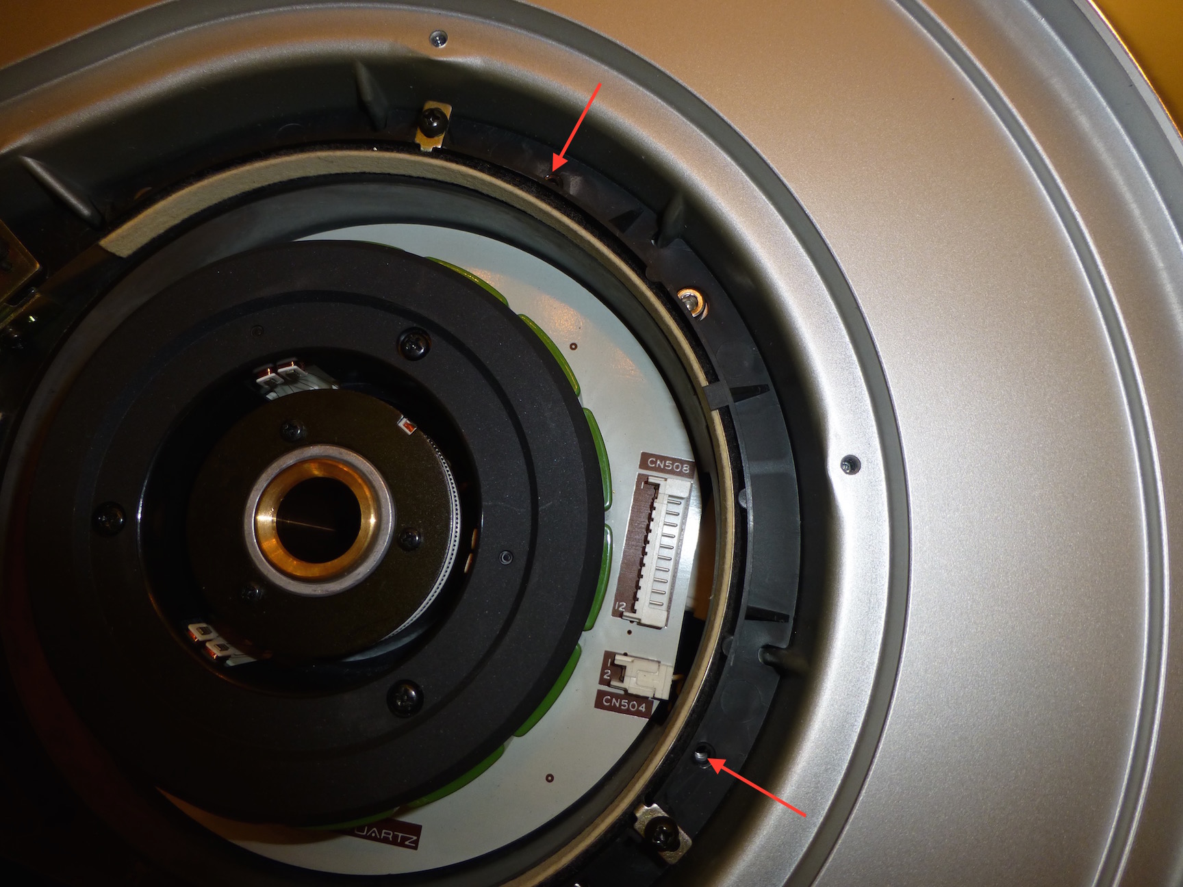

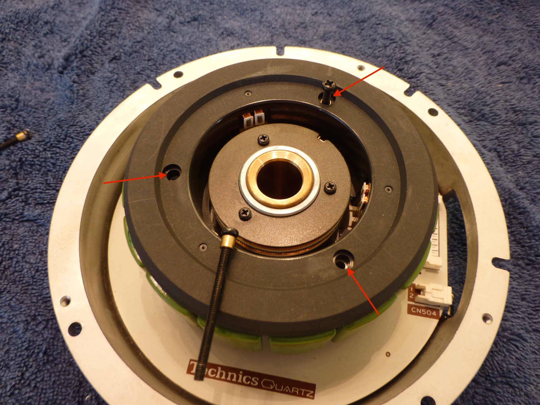

Last night I took apart the motor to inspect and clean it. After removing the plastic cover, simply pull out the rubber dampening block around the platter.

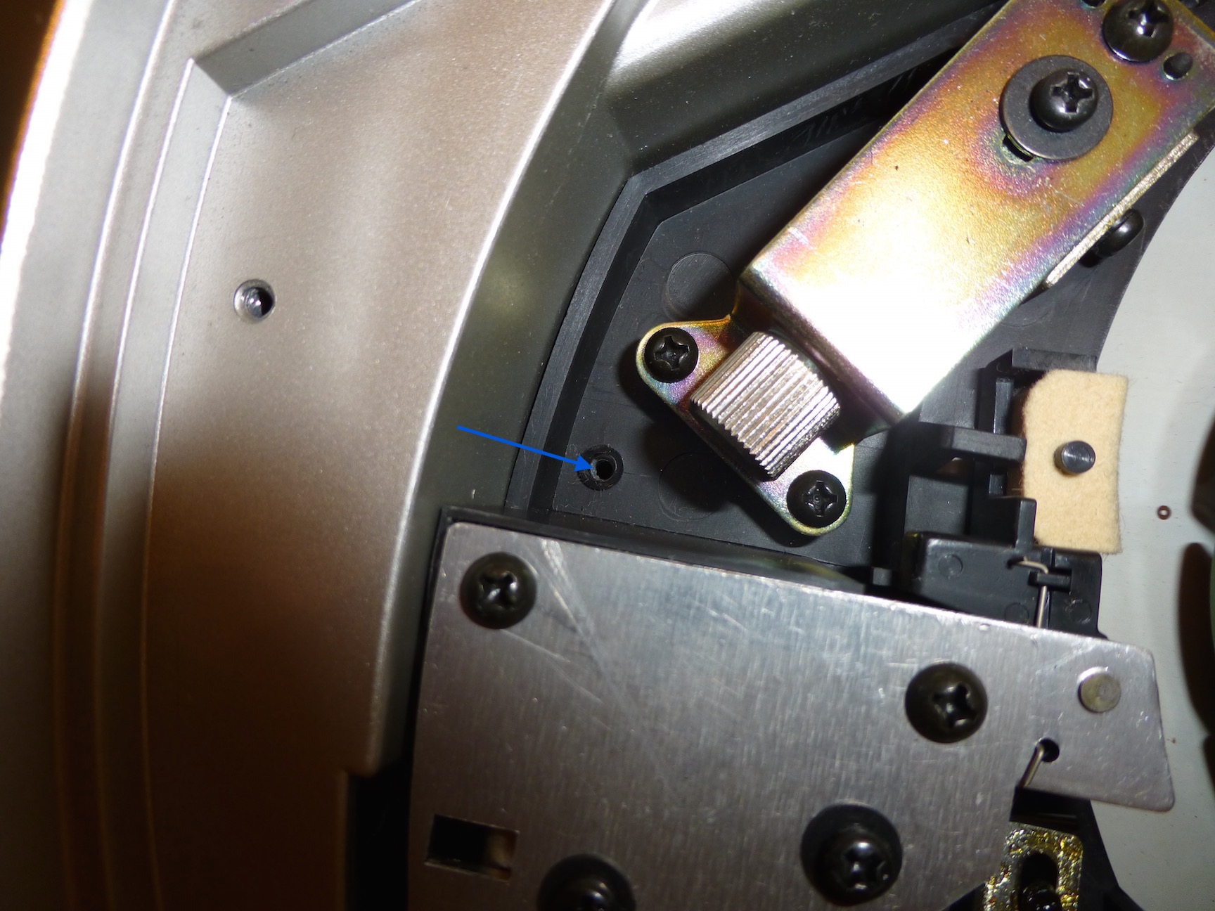

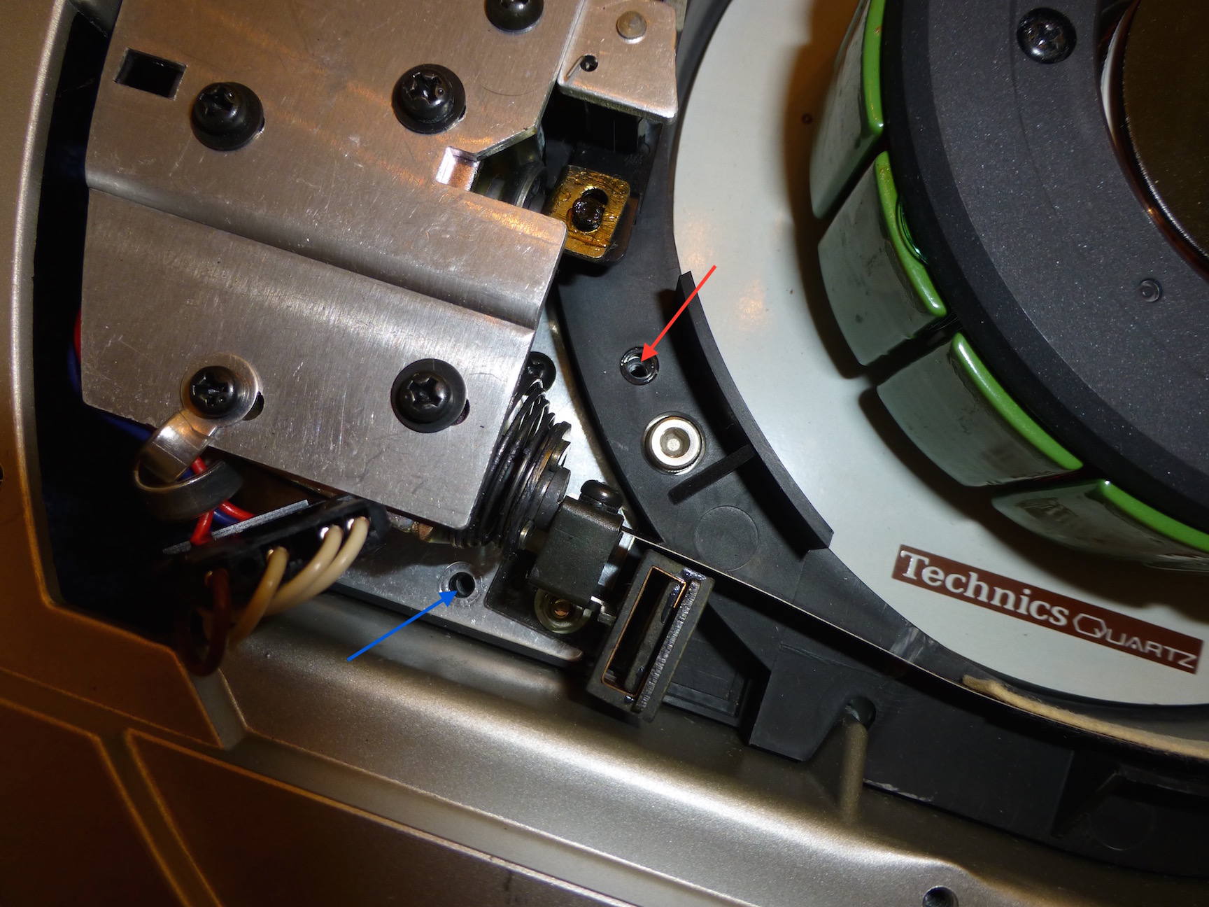

To remove the brake assembly, disconnect the cable by the lower left solenoid, and remove the screws notated below. The read arrows show machine screws, and the blue arrows show self-tapping screws. Note the self-tapping screw through the metal bracket is longer than the other.
The entire brake assembly can then be lifted out. I removed the motor pan from the chassis, but you don't need to do this. The red arrows denote screws that need to be removed to pull the stator assembly, and the blue arrows are the four screws that attach the motor pan to the chassis. Be sure to unplug both cables to the PCB.

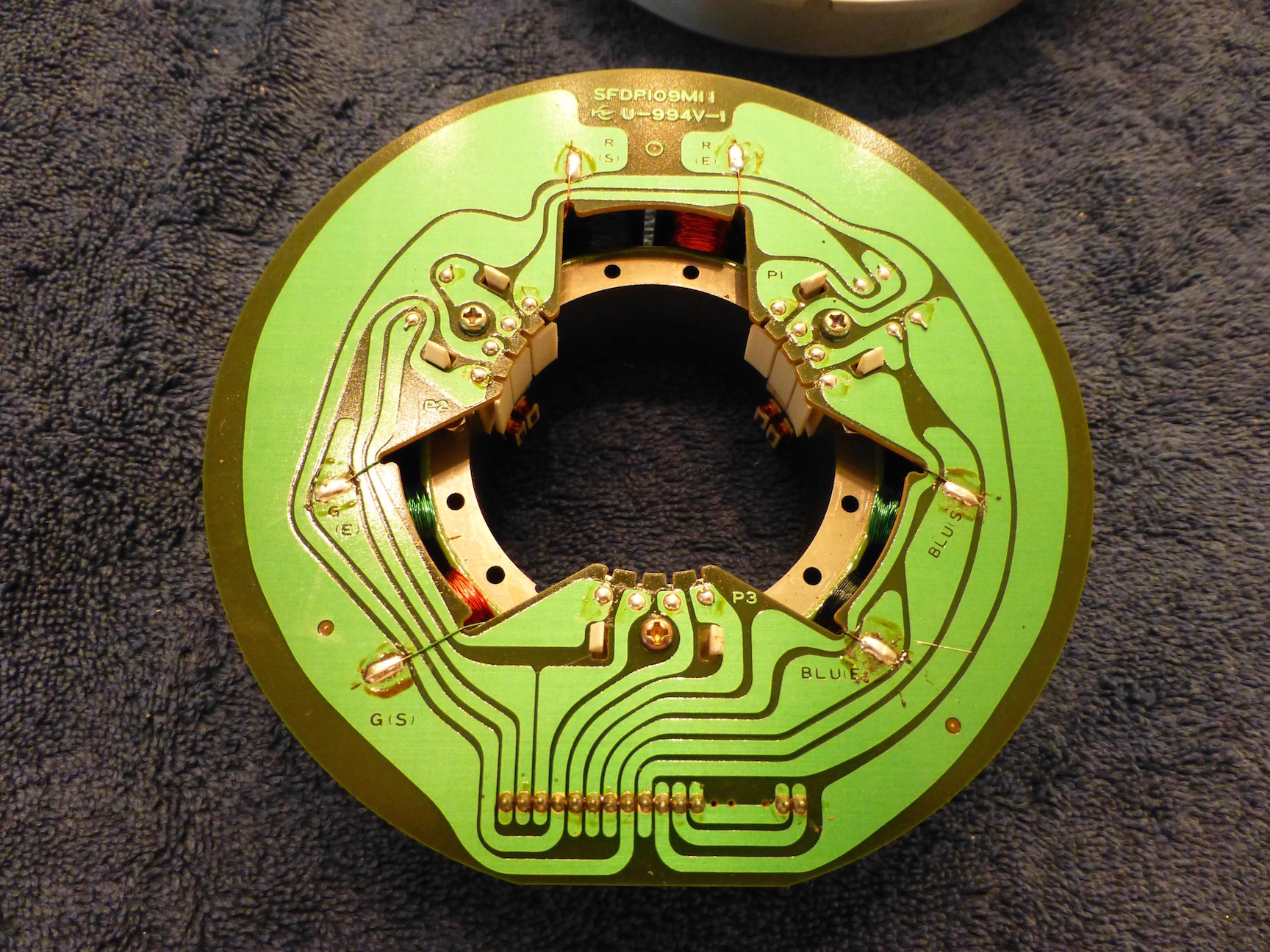

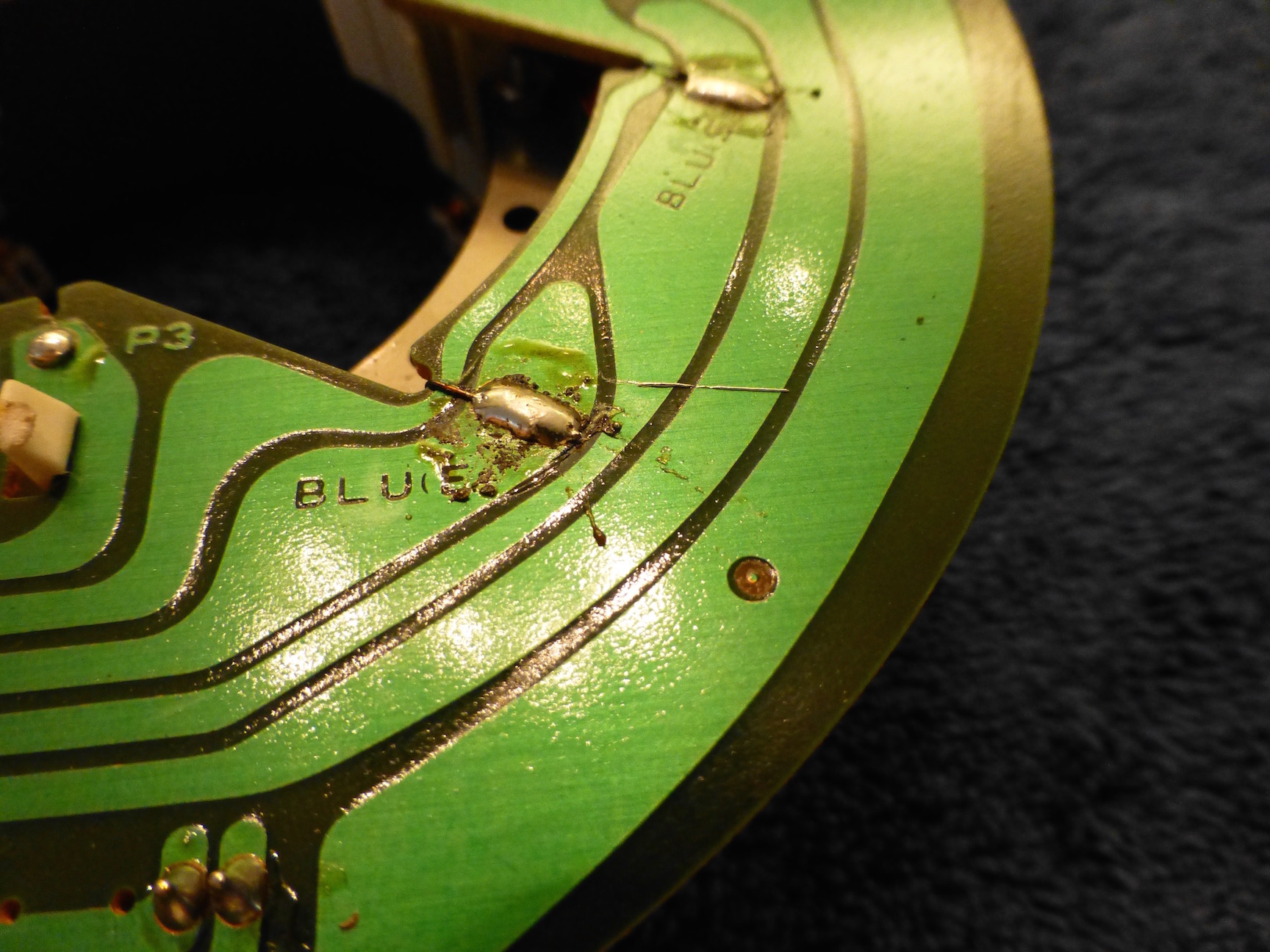

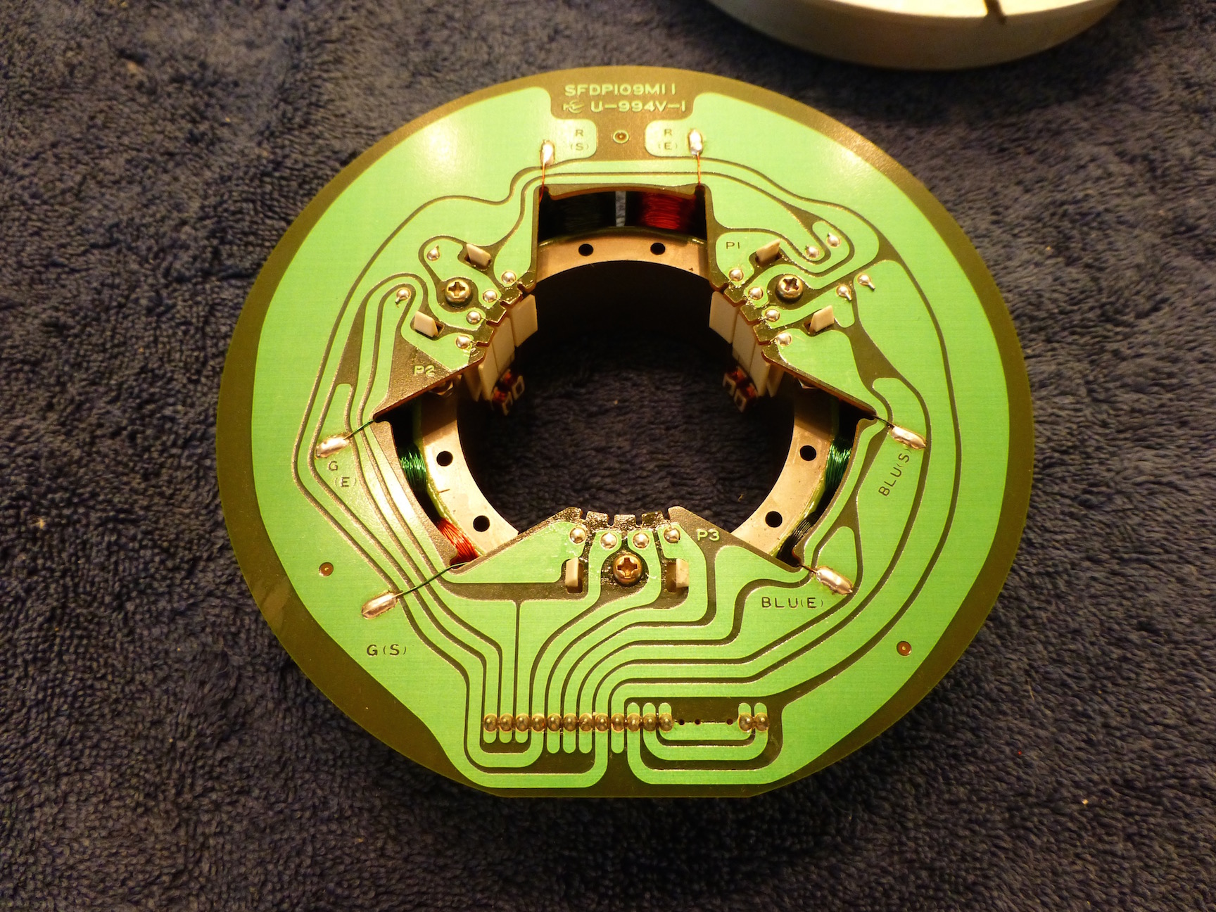

Next I cleaned the dust out of the pan, and washed most of the flux off the PCB, not getting too aggressive near the fine wires of the position detection coils. Note the solder splash.
I didn't see any reason to take the bushing mount or servo coils out (you need to desolder them to remove them).
Simply follow the steps in reverse-order to put it back together.
