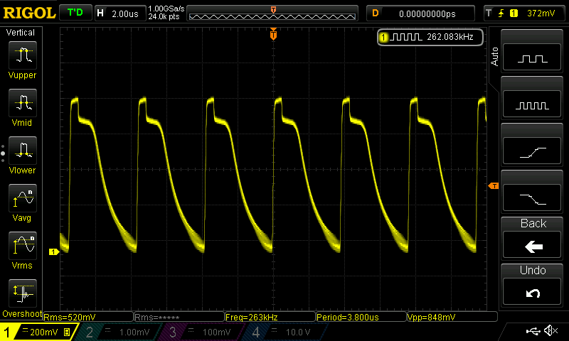

Well, all good things must come to an end...
After the recap I was going through the checks and adjustments, and have ran in to rather significant issues. I don't believe this has anything to do with the recap, but sure speaks to checking everything out thoroughly before doing any work. I did a very fast check when the table arrived as I didn't want to run it with leaking caps. I ran it at 33 and checked the strobe to make sure everything looked okay, 45 went faster, and 78 went faster yet.
Upon putting it back together I adjusted the +/-32V supply voltages to spec, and verified the 12V and 5V supply voltages. All good.

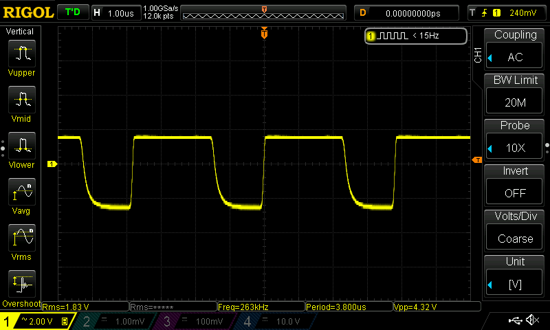

The oscillator is running at 3.82µs vs. 3.8µs spec, so I left it alone.

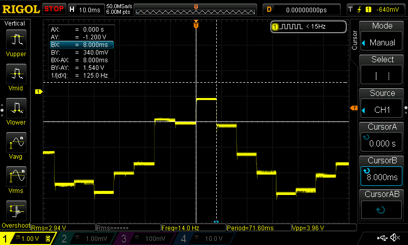

Synchronization was really interesting, pictured below. This is the only 'waveform' I could find.

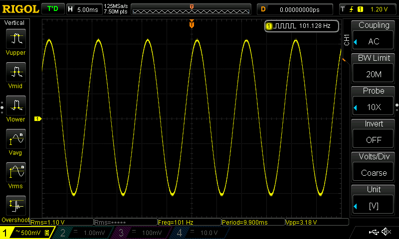

The FG signal at pin 16 of IC203 (AN660) looks good, though a tad low at 3.18Vpp/3.5Vpp. The frequency is also off by 0.1ms, which is a common thread throughout my measurements.

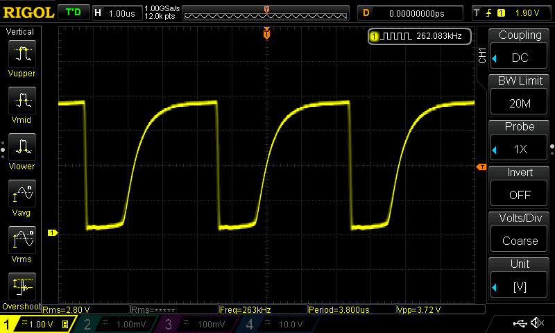

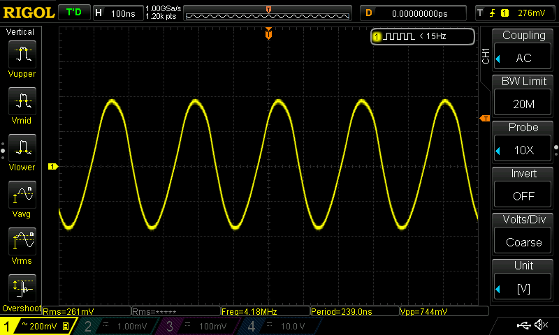

The oscillator at IC203 pin 2 (X1) looks okay though it's supposed to be 1.2Vpp according to the service manual. X2 voltage is low by approximately the same percentage.

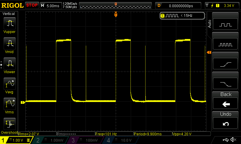

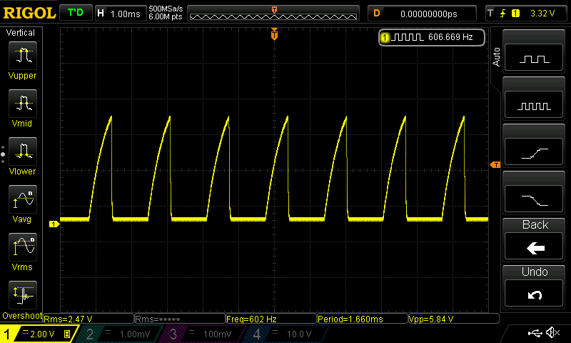

This is where things get really interesting. IC201 pin 9 should be a 20ms 4.2Vpp square wave, however it appears to be glitching every other cycle.

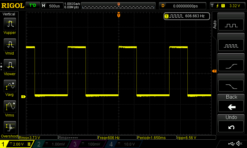

IC201 pin 15 and 16 should both be 20ms at 33rpm, but they're ~1.66ms. Also, the positive cycle of pin 16 (VS) appears too short.
