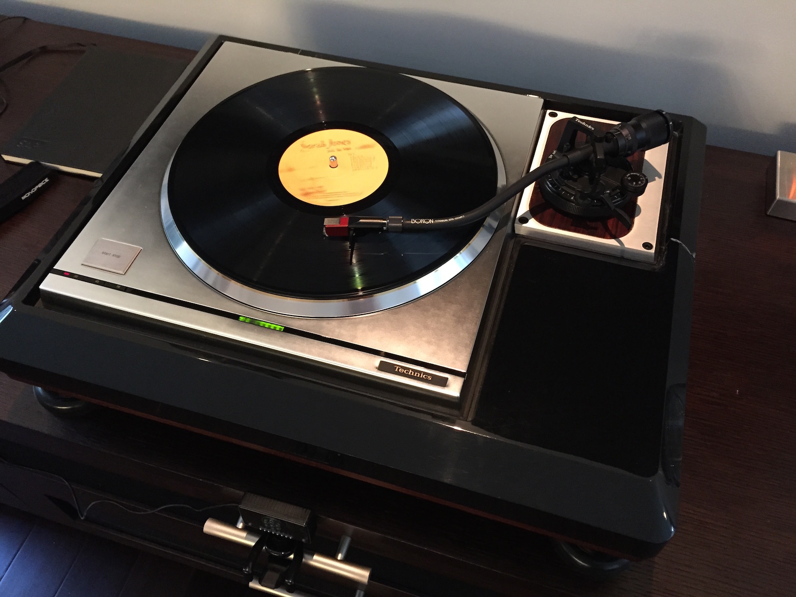

Mine was a bit nicer looking than that - close to what I recall my MKII looking like.
Here's my mock-up for now. The broken plinth is courtesy of from japan.co.jp, who think one layer of bubble-wrap should be fine. However, they did package the table exceptionally.

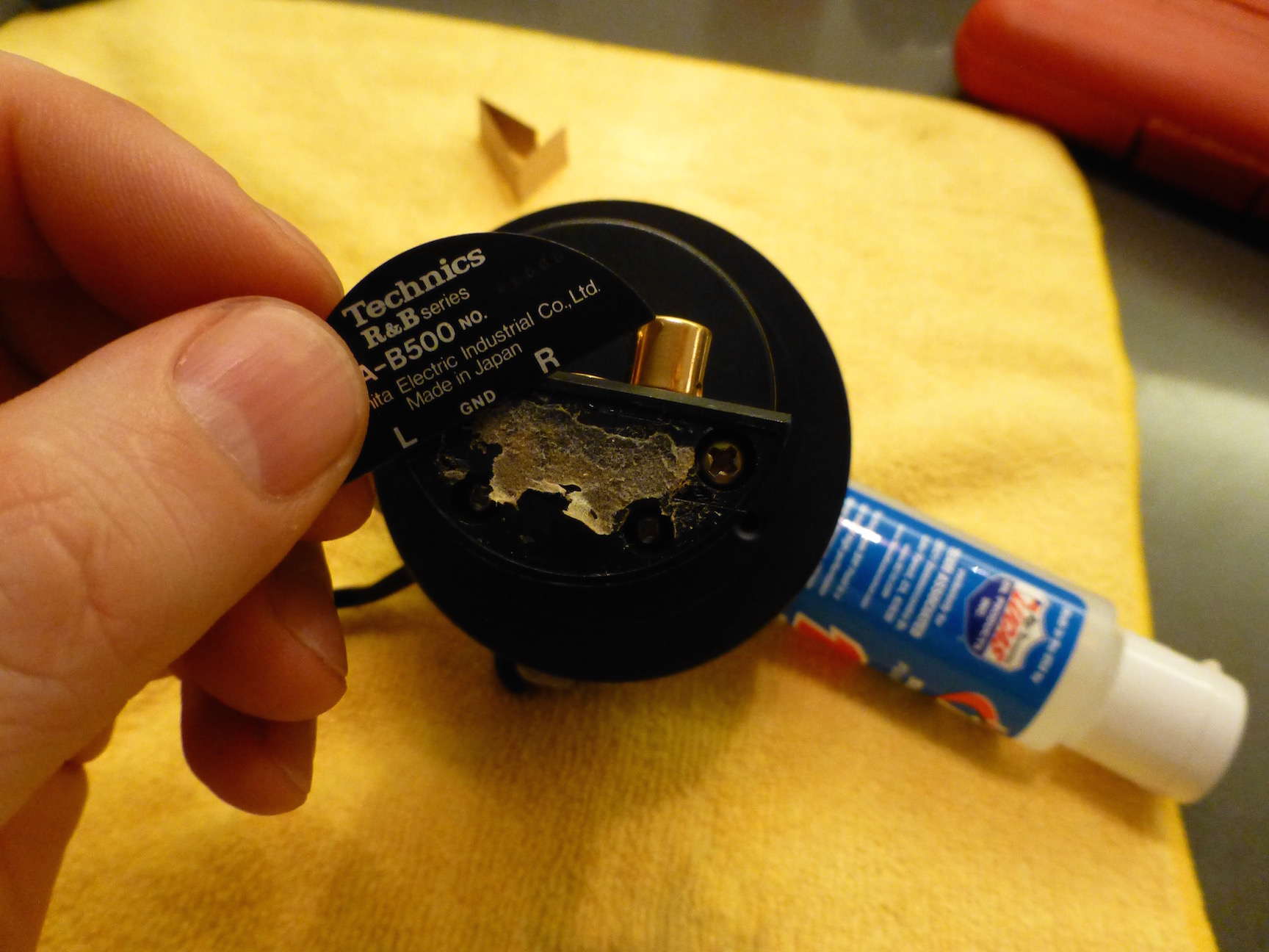

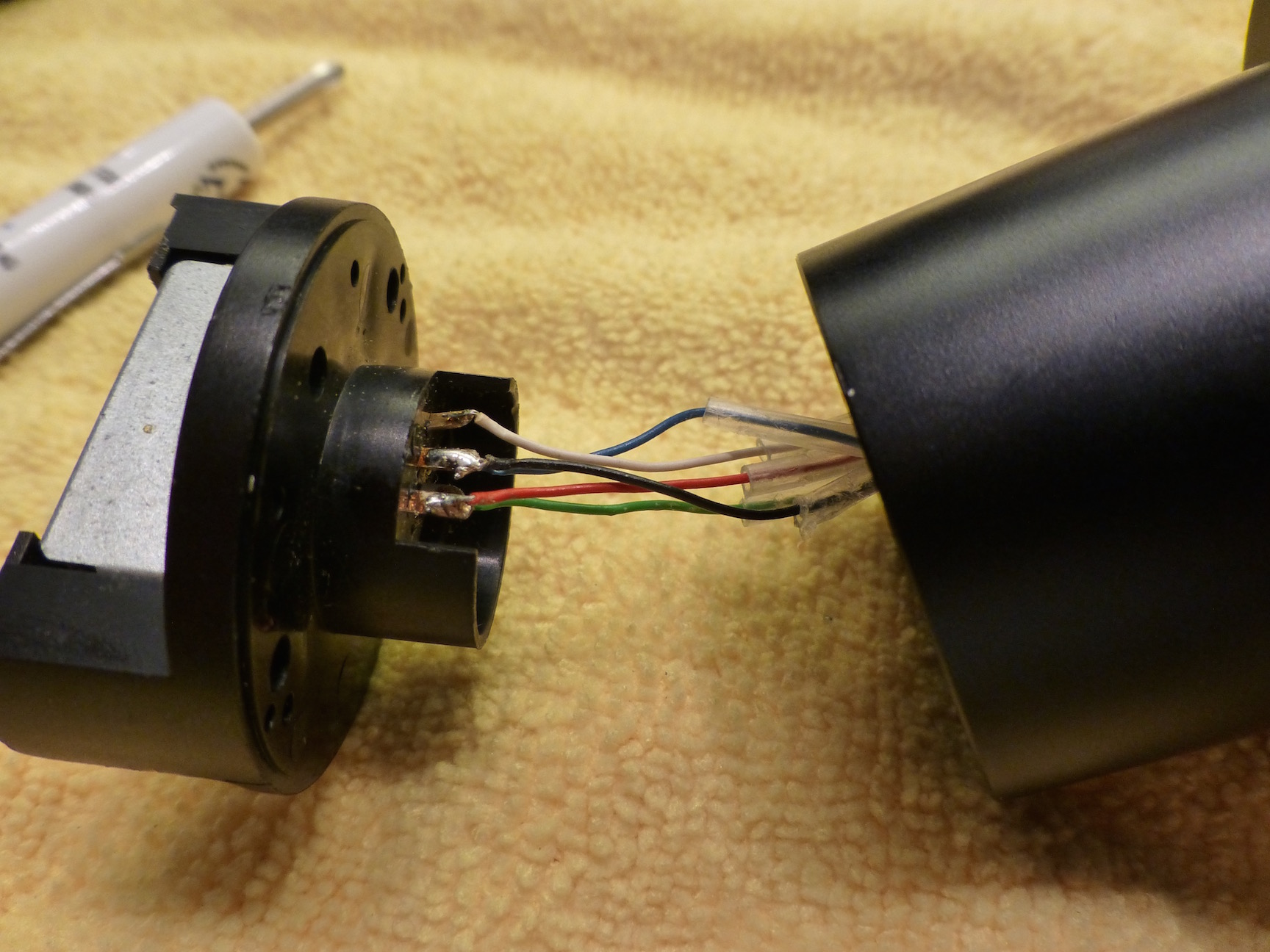

I stumbled across an EPA-A500 series wand I thought I'd never find, so I've been dying to give it a try. However, the anti-skate dial on my B500 base wouldn't budge, so I cracked it open last night. I wasn't able to find any information or pictures in regards to working on one of these, so perhaps this will be useful to someone down the road.
The nameplate at the base of the pillar needs removed to get in to the arm. I used a hair dryer to heat it up to soften the adhesive. Using a razor blade I was able to slowly work my way under the plate and lift it. This was an iterative process of heating and prying. You want to be careful to not scratch the paint, or bend the plate.
attachment.php

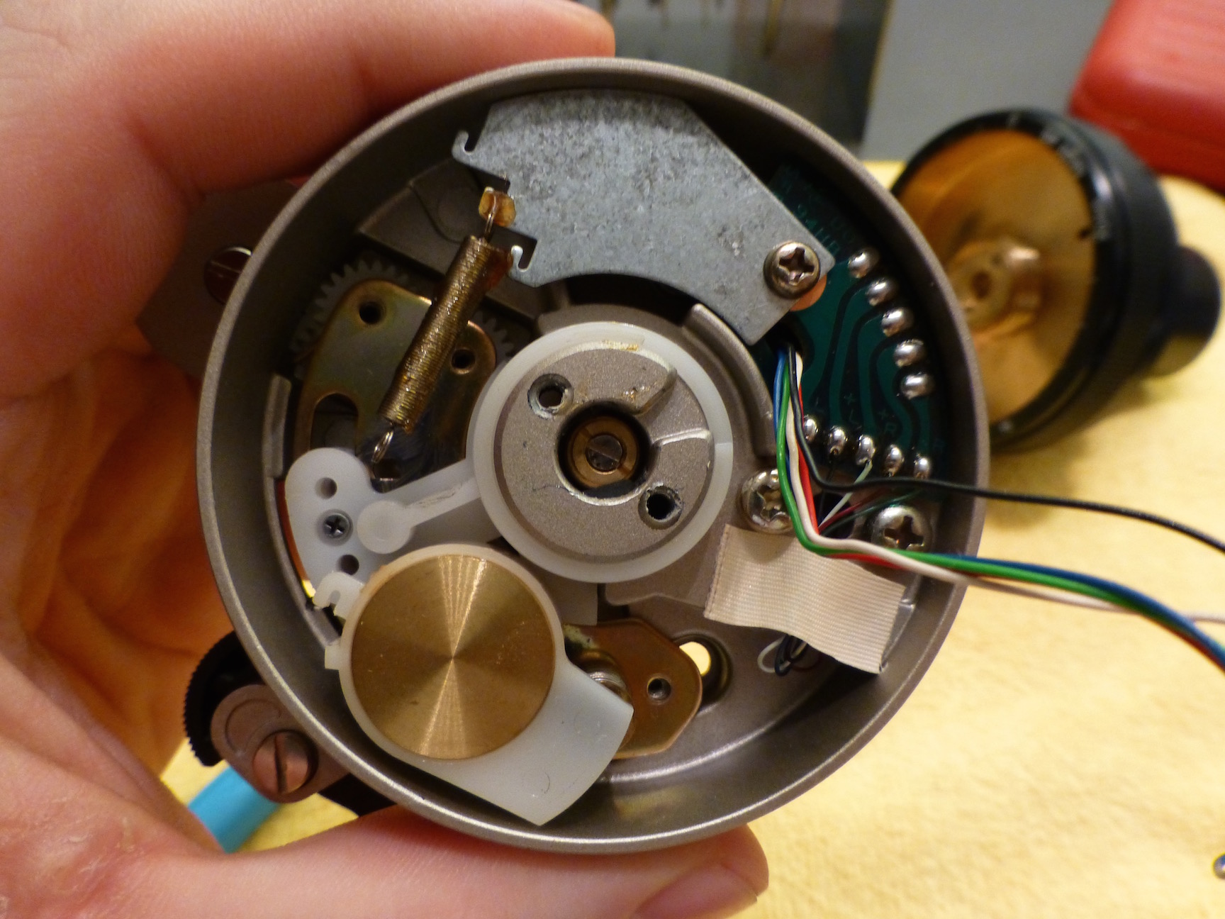

Remove the two larger screws and wiggle the connection block out of the pillar. You'll need to desolder the wires from the connection block.
attachment.php
There are two screws in the pillar that hold the pillar to the base of the arm. These have very strong thread-lock on them, so it's very important to make sure you've the correct size driver and are able to apply enough pressure to break them loose. It's quite difficult to find a good way to hold the base and do this without applying pressure to the bearings.
attachment.php

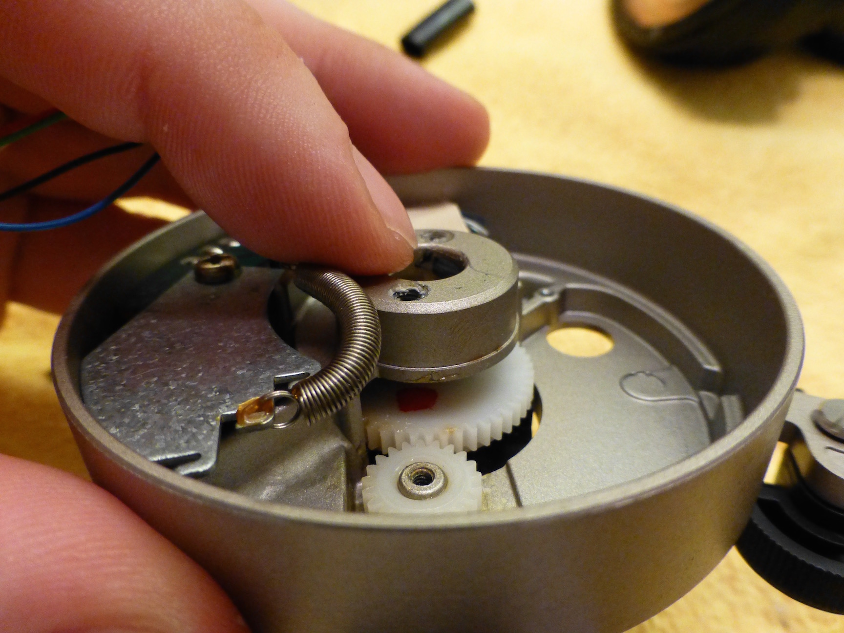

The two screws by the lift handle hold it in place, and three screws (one is under the spring) hold the zinc colored plate down which is the entire lift mechanism. You also need to remove the little rubber block (it's glued in, so be careful) that the wires go under, and the lift arm from the top in order to remove the lift mechanism. The lubricant-turned-glue on my arm was only at the anti-skate dial itself, so it wasn't necessary to do this.
attachment.php
attachment.php

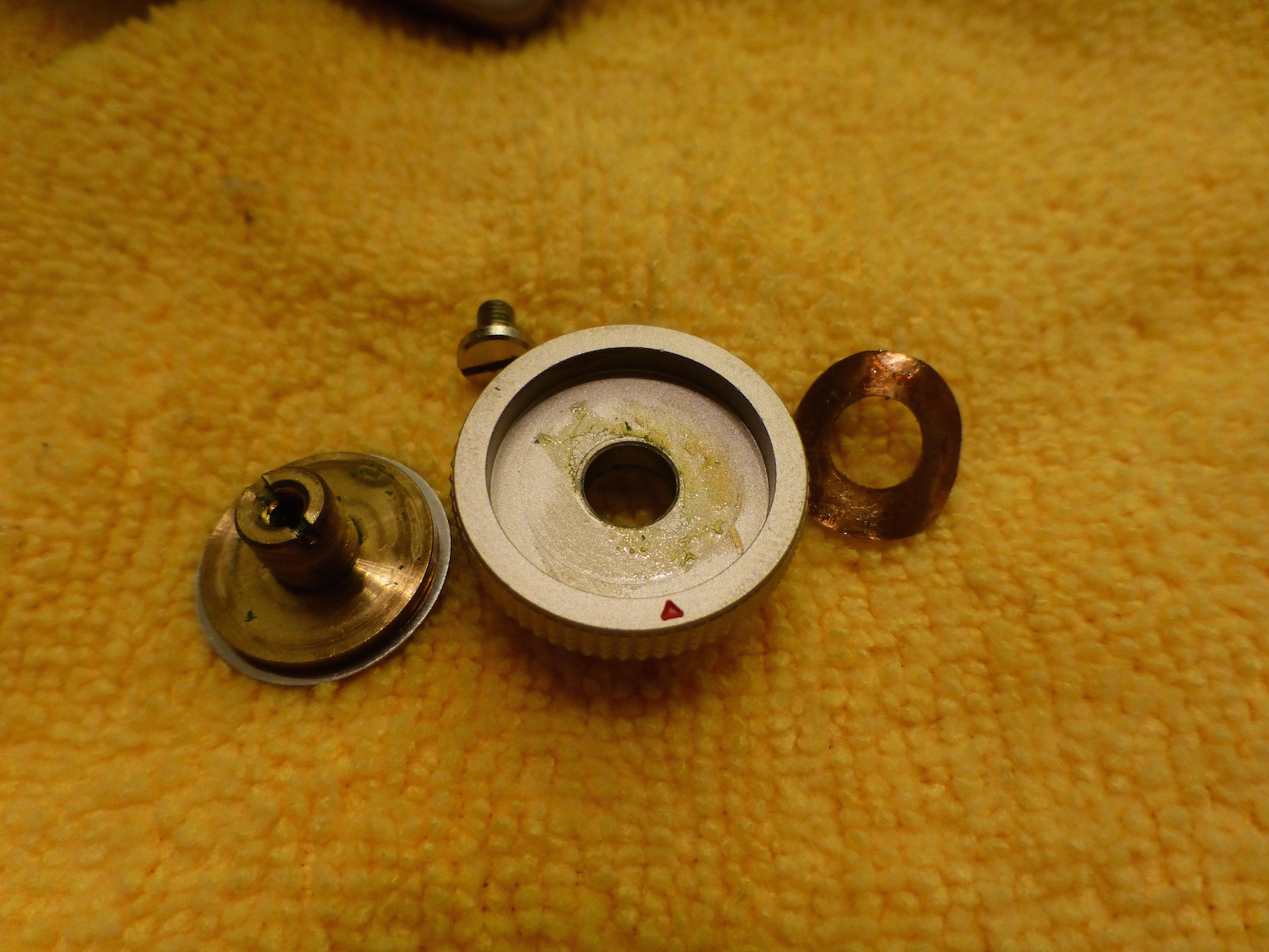

There's a screw under the dial that needs removed to lift the dial off. I cleaned mine with IPA and used a little white lithium grease before putting it back on. The actual dial is keyed and there's a stop for adjustment, so you'll need to observe those for reassembly.
There's also what I assume to be an alignment mark on the main gear. I placed it in-line with the other gears which seems to be correct. At least on my arm the setting behaves as I'd expect it to.

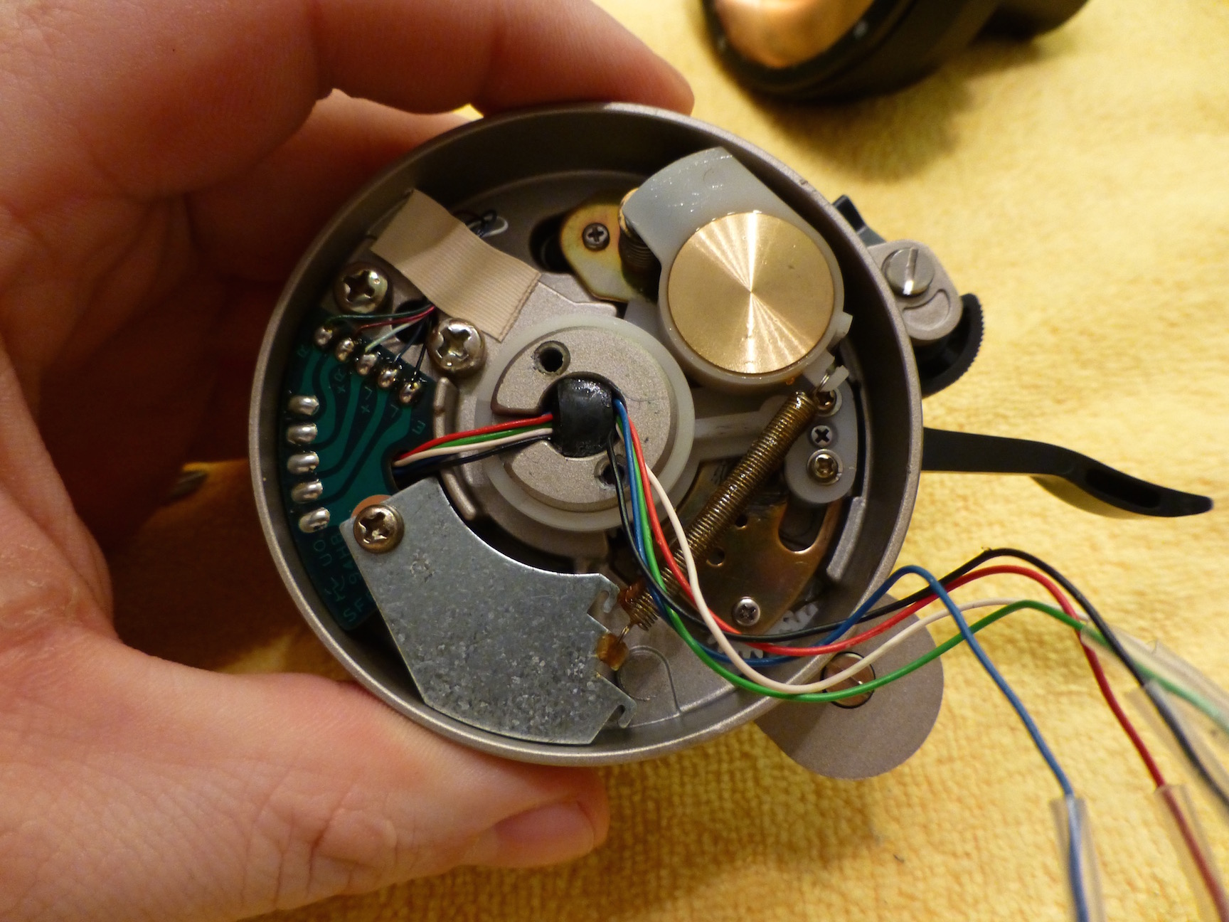

When I put the lift mechanism back in the lever would start to bind toward the up position. To fix this I loosened the three screws that hold the mechanism in the arm base, put the lever in the up position and pull outward on it, and tightened the screws. Problem solved.

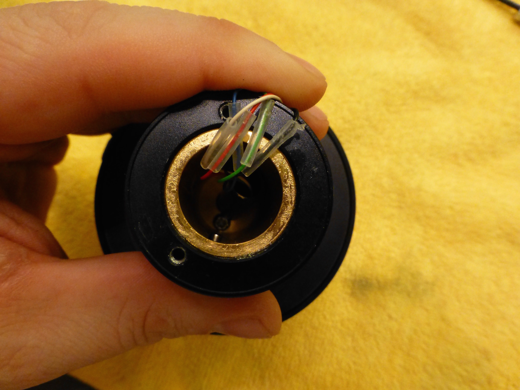

I used a dab of 5 minute epoxy on either side of the rubber block to put it back in place. As you have to tug the wires fairly tight when aligning the pillar base, the rubber block will come out if it's not glued back in.
To re-solder the arm wires to the connecting block I cleaned the old solder off the tabs, and put flux on the tabs and the ends of the wires. I then loaded a little solder on the tip of my iron, held the wire to the tabs, and touched them with the iron. Done right the flux will draw the solder on to the tabs and wires and you'll have a good joint.
