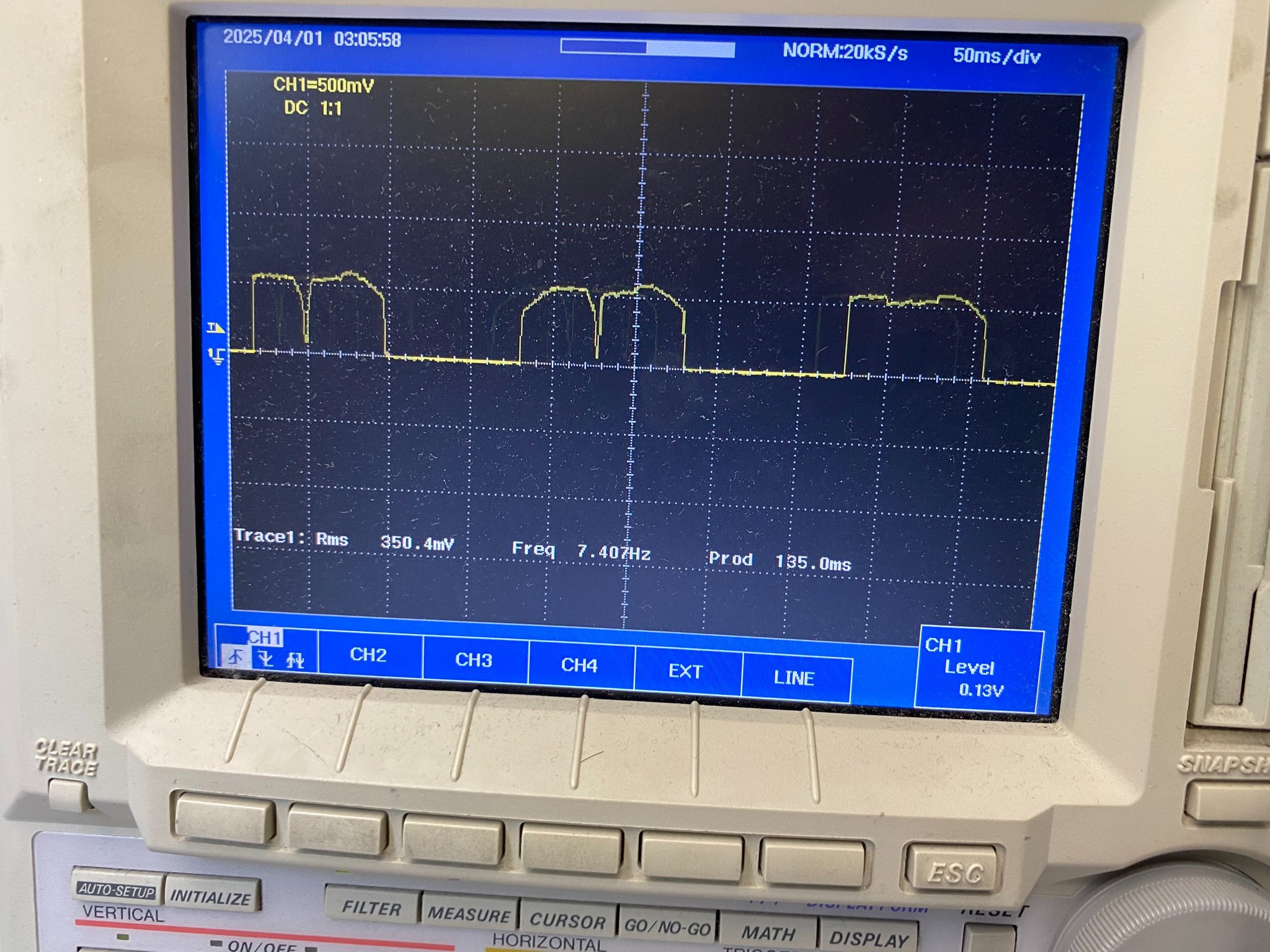

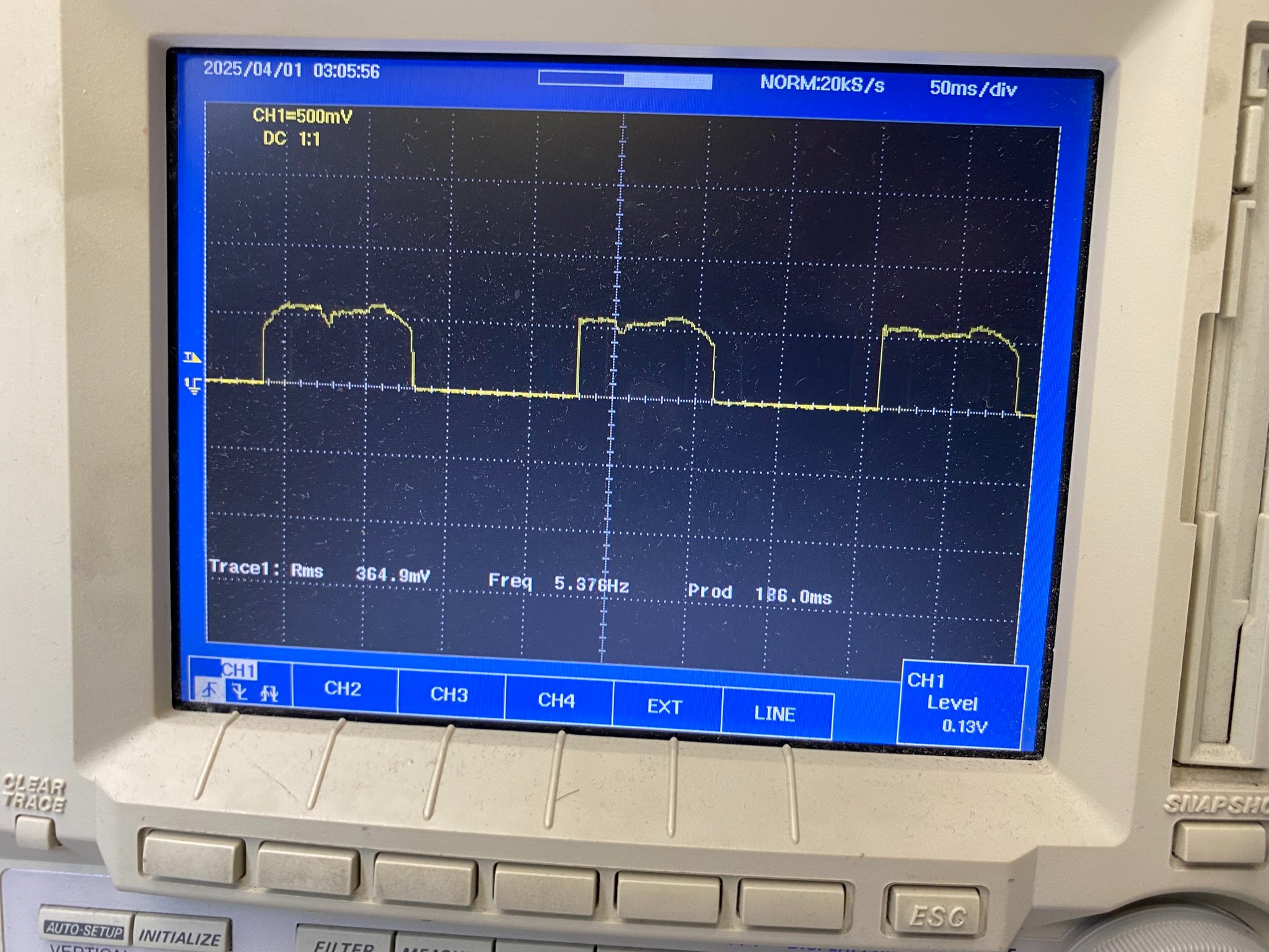

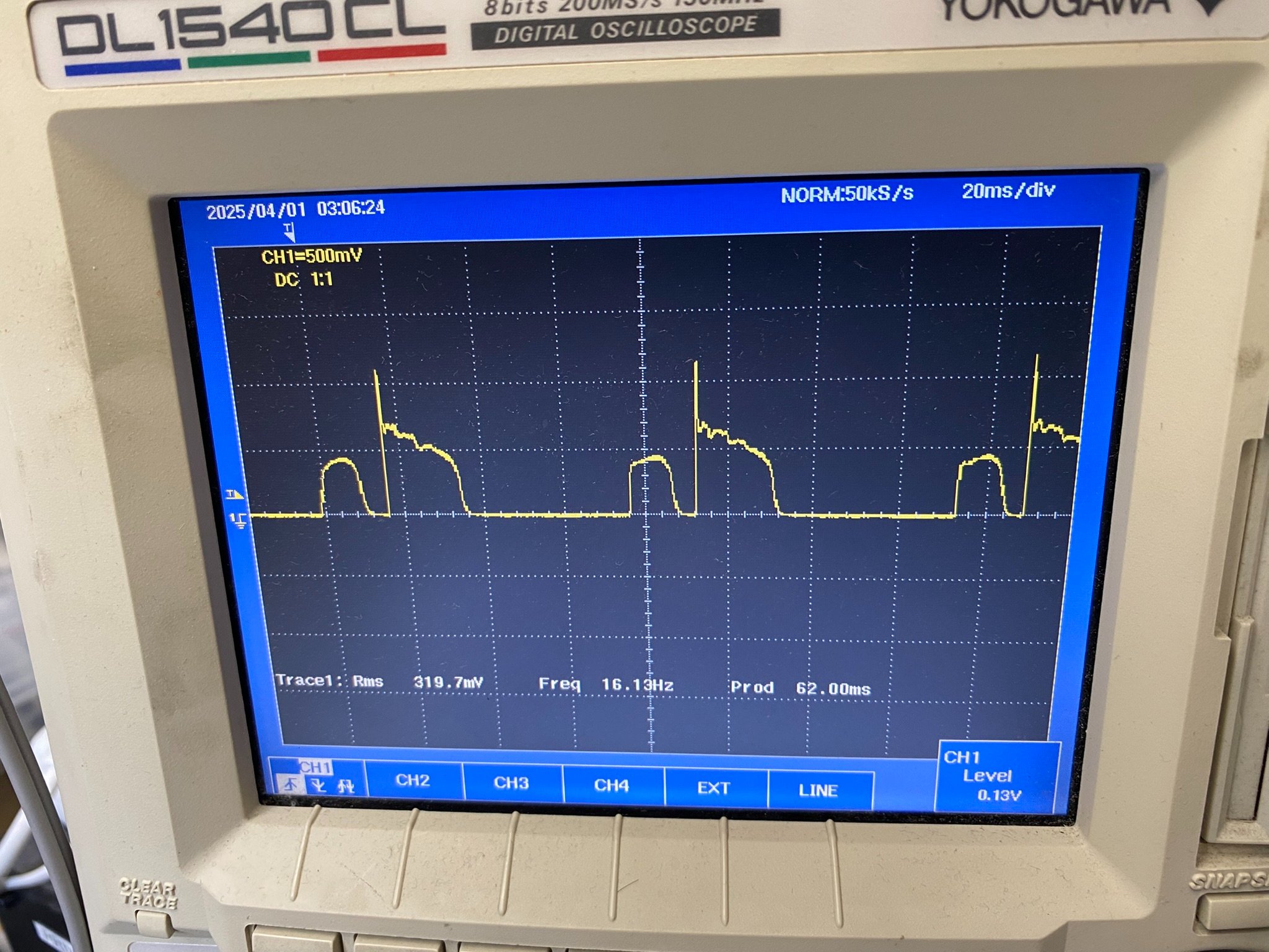

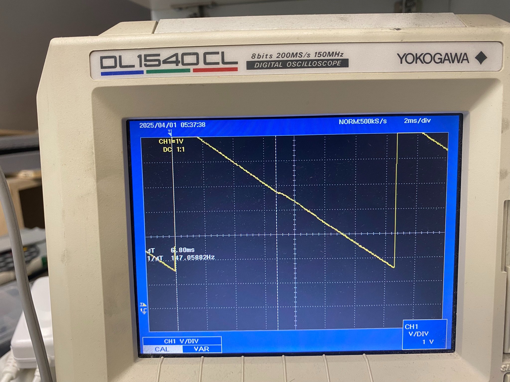

Need some help. I am repairing SP10-MK3.
All modes recommended in the service manual are adjusted.
Speed capture is fast at all speeds.
But at 78 speed there is a sound from the engine.
This sound appears when there are current surges on the motor coils.
Oscillogram in collectors of output transistors at 33 and 45 speed is normal, but at 78 speed there are emissions and needles both on the upper and lower wave.
Also on the control outputs 1,2,3 of chip AN640 form of the control voltage has the correct form only at 33 speed.
At 45 speed partially appear dips in the control pulses.
And at 78 speed the control pulses have a strong distortion and emissions.
Accordingly, the driver output transistors also produce artifacts on the control coils.
Capacitors of AH640 chip and output transistors are replaced.
Who ever faced with this problem?

Pictures of the waveforms would help quite a lot.
Did you figure out the errors in the service manual for the adjustments?
This is a contradiction. If there's an issue in the pre-drive waveforms, there'll be an issue in the drive output waveform as well.
How fast? Have you determined where this is coming from? What's frequency of the output of the MN6042, and what is the frequency of the FG and how is the stability of the FG waveform?

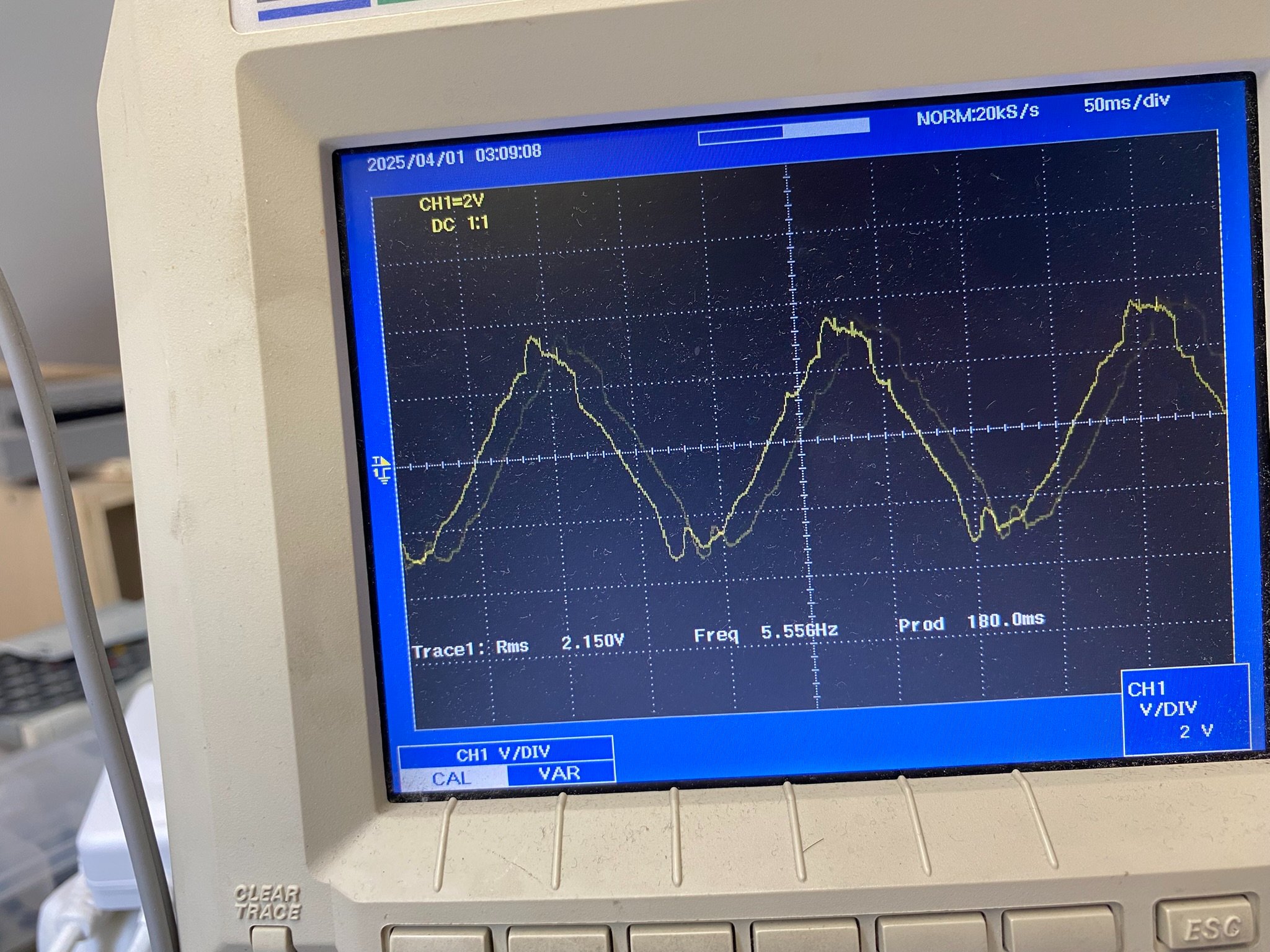

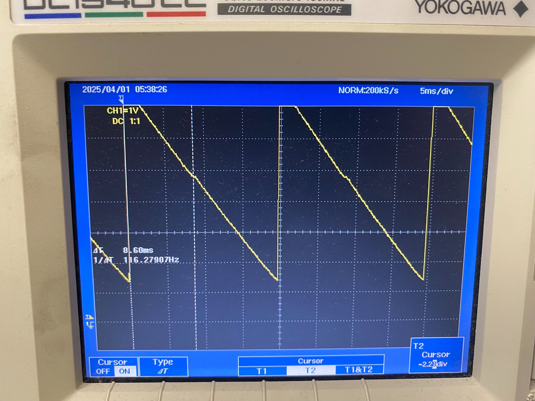

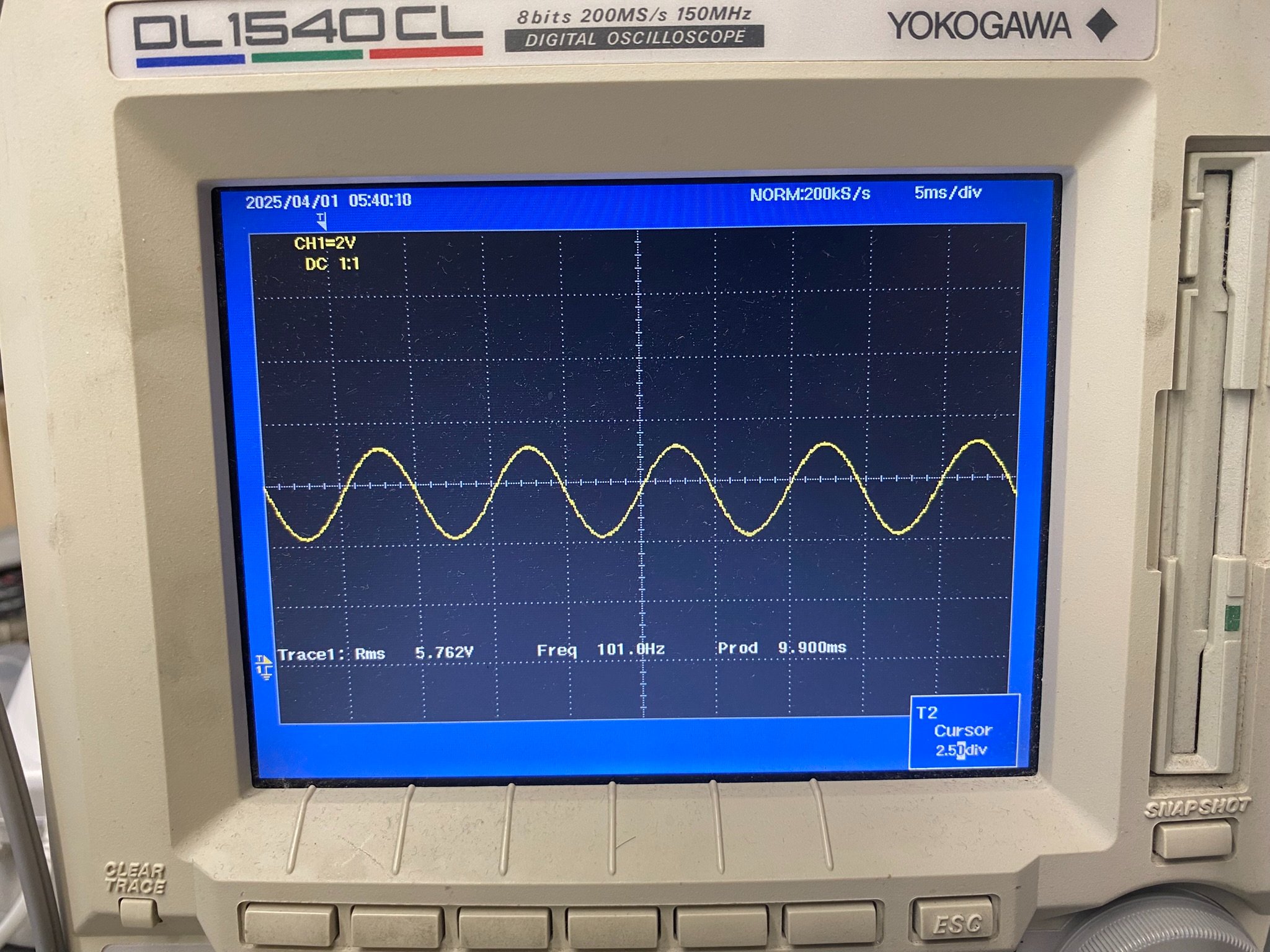

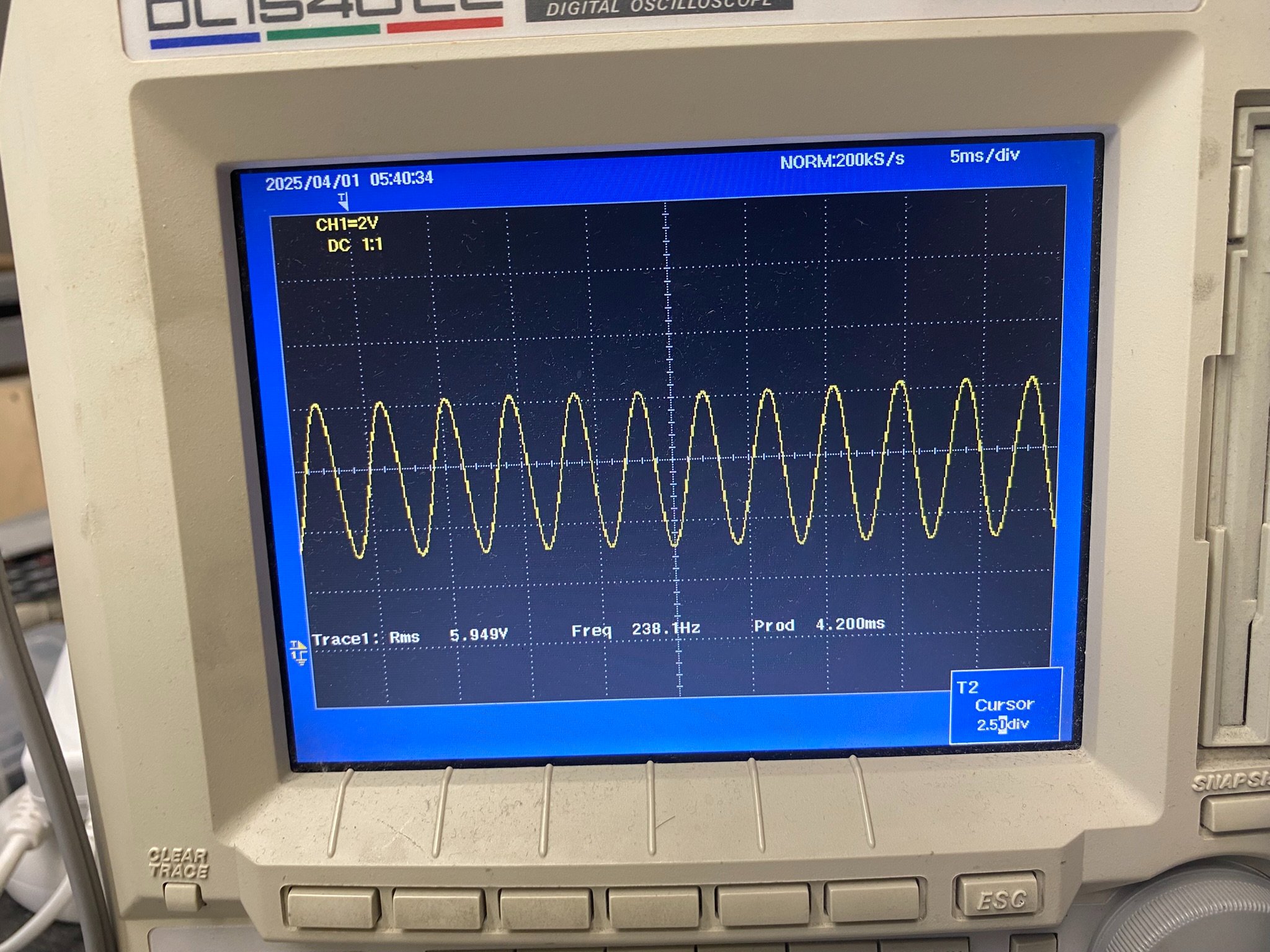

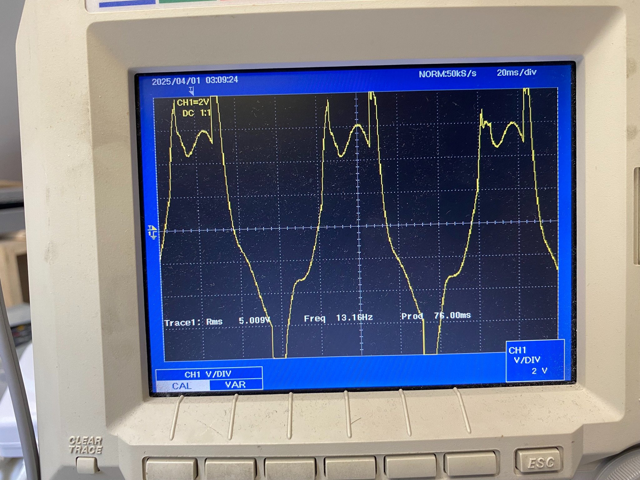

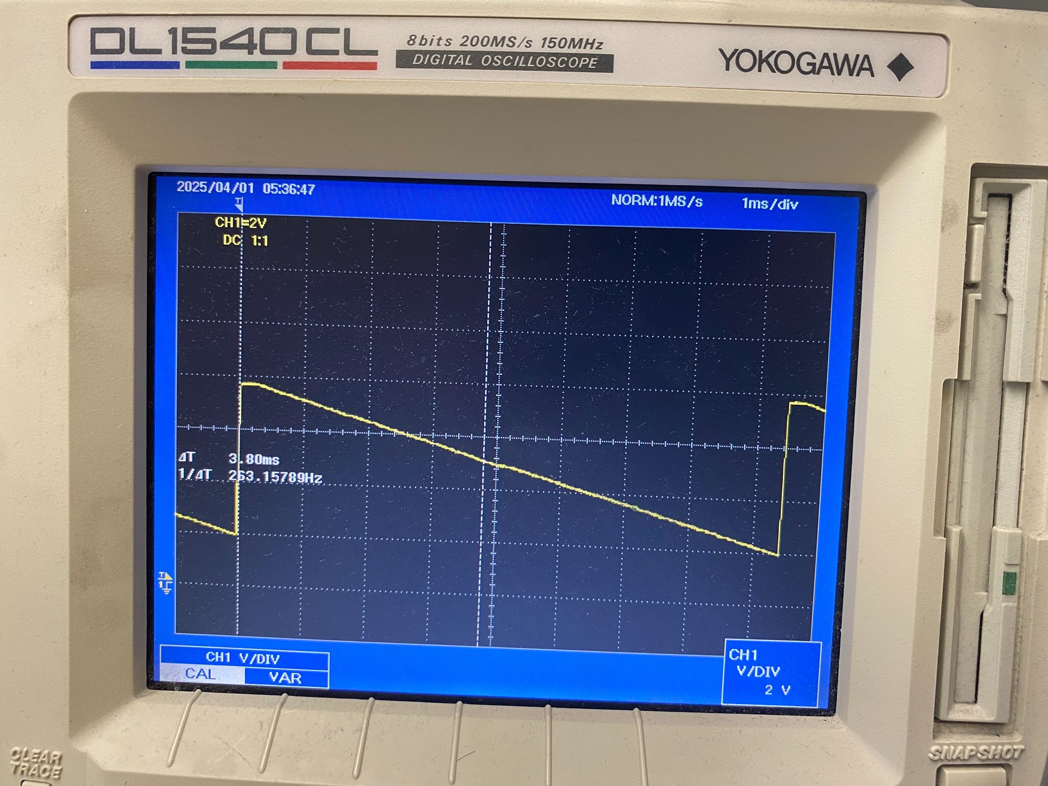

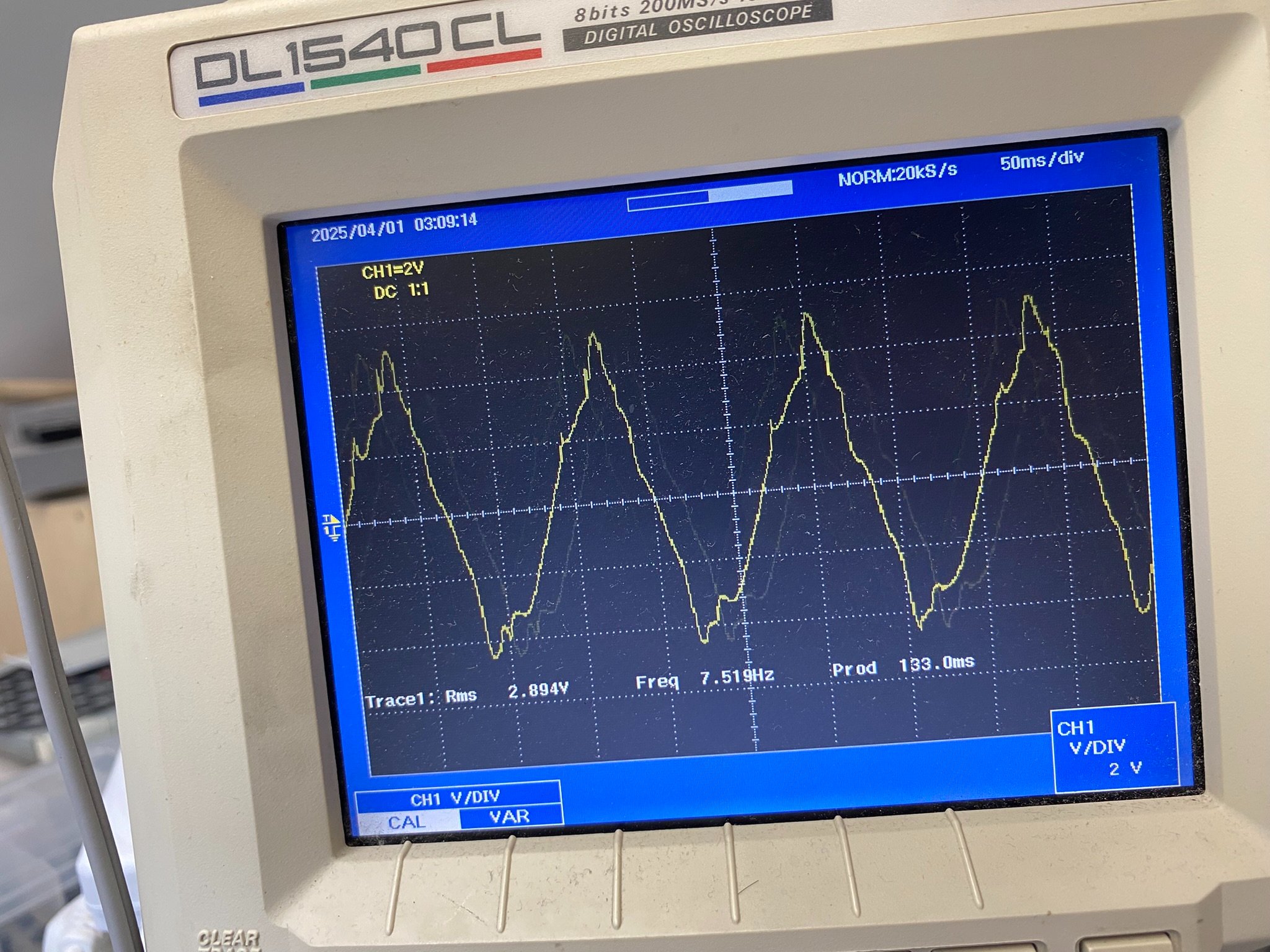

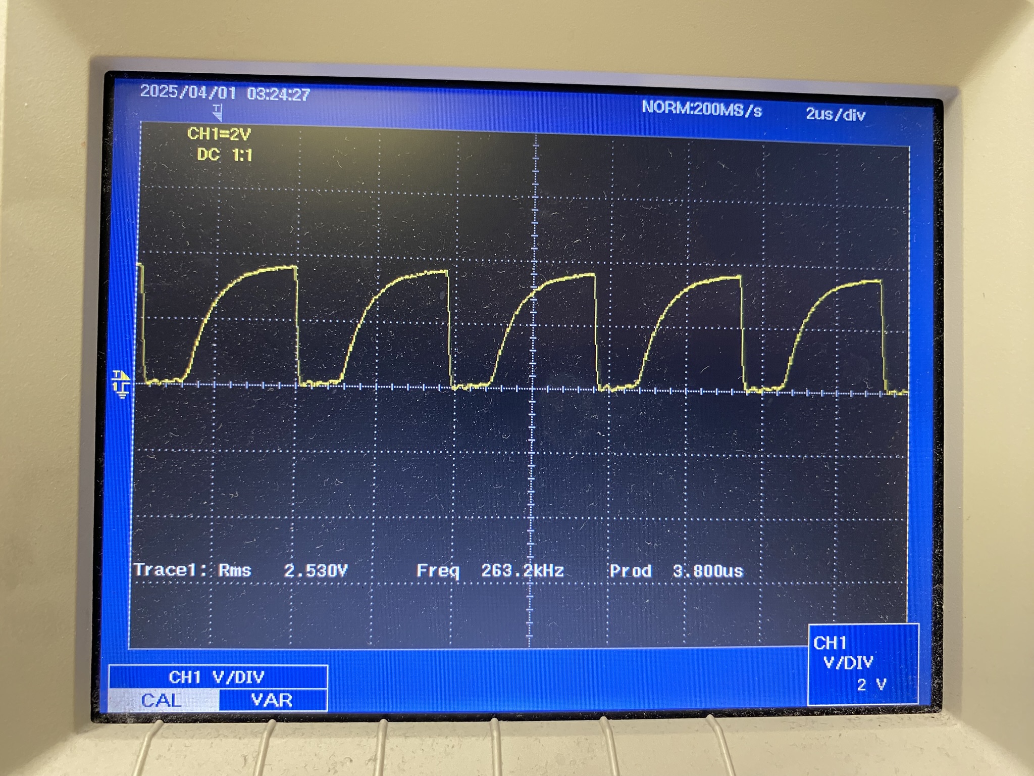

Interesting.
At a glance the drive waveform for all three speeds is abnormal, and gets worse as you progress through the speeds. It's handy if you've three scope channels to see how all three drive phases are interacting.
Not sure how accurate the hardware counter is in your scope, but IC201 FI should be 262.08kHz and FG at 33 should be 101.11Hz. However, drive frequency at 5.556Hz is correct.
I'd think from the drive waveforms that the notch in ST2 isn't stable? Can you record the FG signal from CN205? An audio ADC works fine though you'll likely need a series R on the input to not load down the FG circuit. 33 and 78 would be good.
