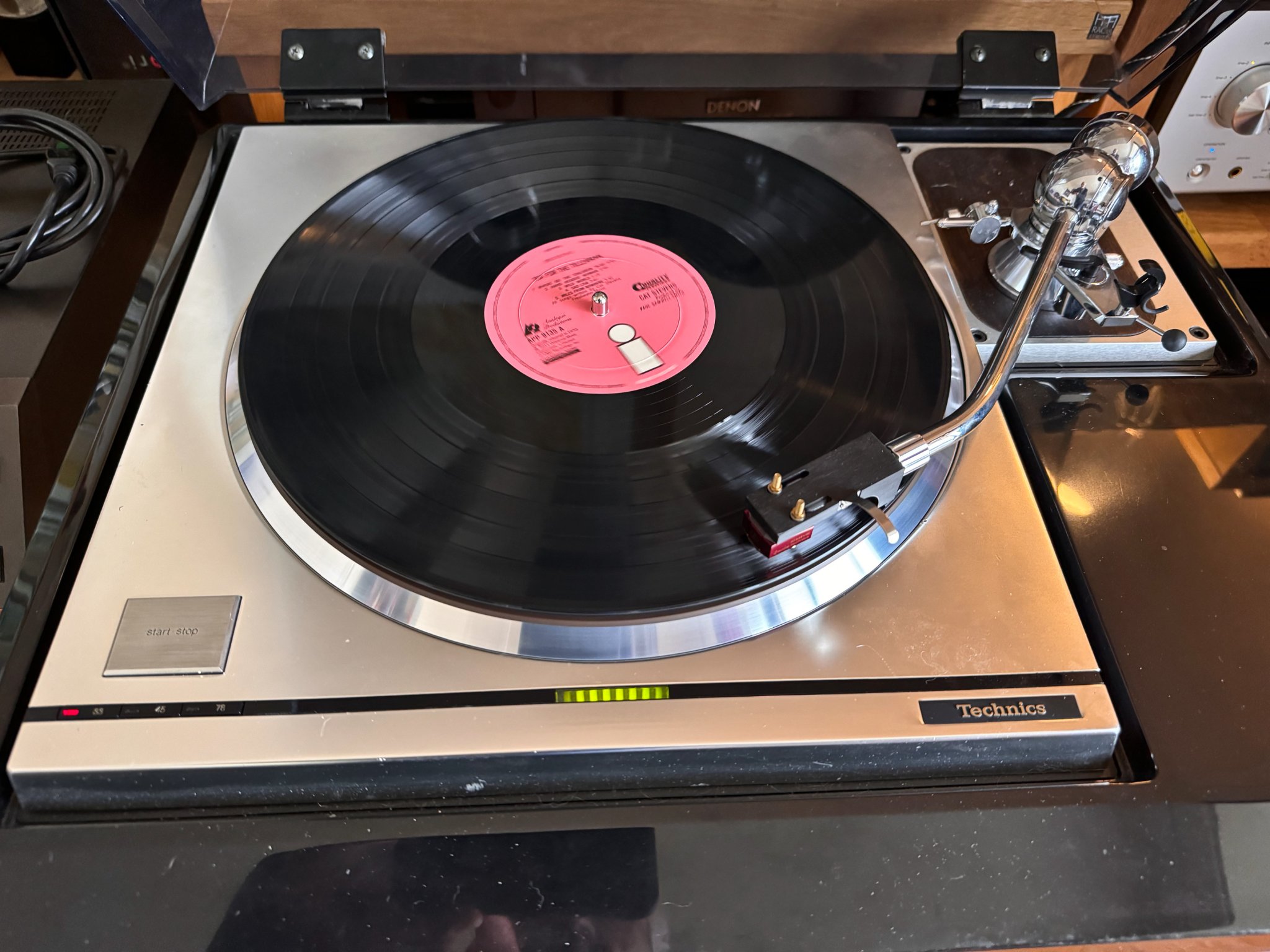

This maybe the last time I see this one. First in for 100V to 240V transformer conversion. A few years later the JP Chip, and now the LED digits sorted and also the hinge modification. It's going to be collected by a chauffeur tomorrow. Oh BTW he kept his headshell and cartridge at his home, this is a spare AT-33EV that's none too shabby.
I did the cap replacement of all the electrolytics. Seemed to go well. Then went on to the measurements and adjustments.
Seemed to go well in the beginning although quite the learning curve the first time around. Certainly couldn't have done it without the blog help of JP and Dave so thank you for significant contributions. Especially with Vs and Rs but throughout..
Unfortunately things went really bad when I checked Vcc on ICs 201,202 and 203. IC203 has 0.00V at pin 5 vs ground.
Checked and re checked it. Voltage at IC206 is exactly 12.0V with nothing visible on the board. All the pin voltages are crap for both stop and start. All negative something. Can't get anything meaningful on the scope. I looked around and couldn't find any source for an AN660. I need suggestions.
I have no Idea If I buggered the IC myself or if it came that way. The table runs perfectly smoothly at all three speeds and the "strobe" lights are steady and hang on very well if I try and drag it down with my finger. I only ran it briefly before the recap but it appeared to run the same then. Actually amazes me how well it runs considering.
I have recapped two MK2's in their entirety and set them to spec and they run perfectly.
This is clearly a different animal but I am essentially a novice at electrical engineering and IC's.
Maybe TMI but wanted to give some background.
Thank you for any help or advice.

I agree, I honestly think this is "operator error". Look again but maybe on another day with at least one other instrument. Also the pins may have corroded and although they may be OK where they are soldered, a probe may not work properly on the top.if it’s running and locked there’s no way those ICs are bad.
Don't panic !
@JP, @Dave Cawley
Thanks for steering me in the right direction. I flipped the board over and everything measured correctly. I finished the checklist and all is good. Appreciate the help.
Now its on to the turntable.
